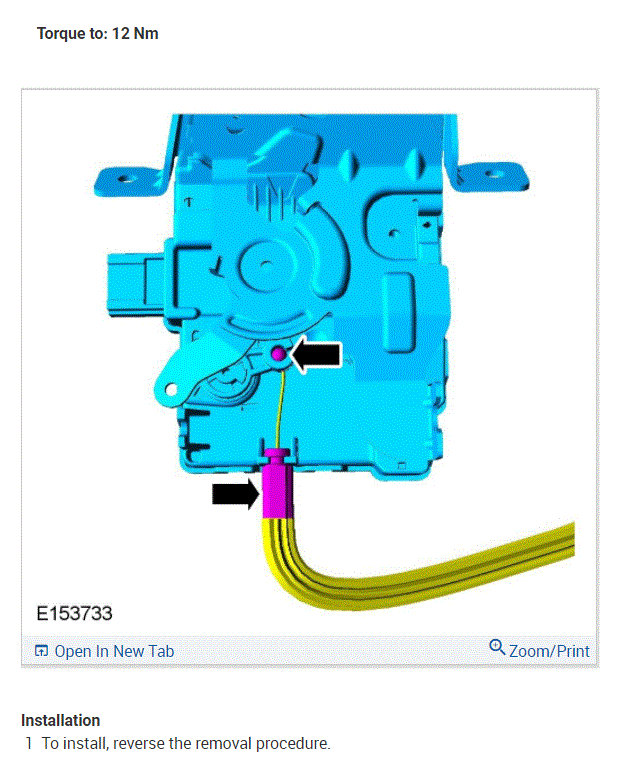

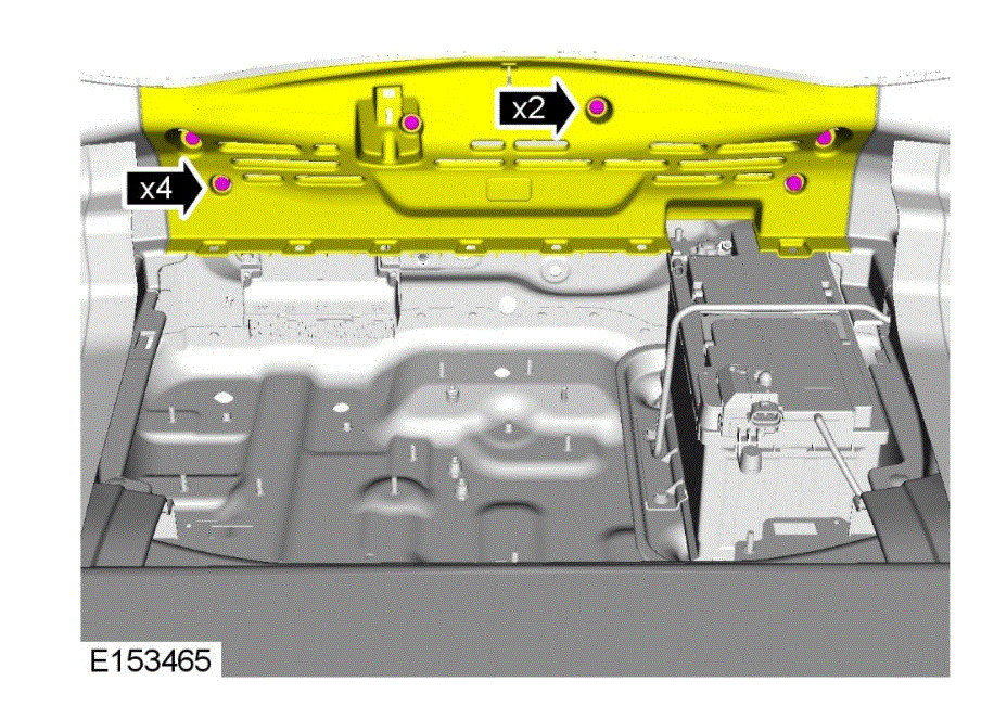

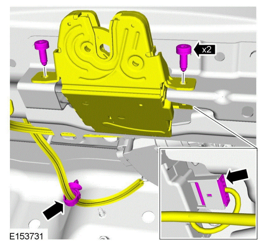

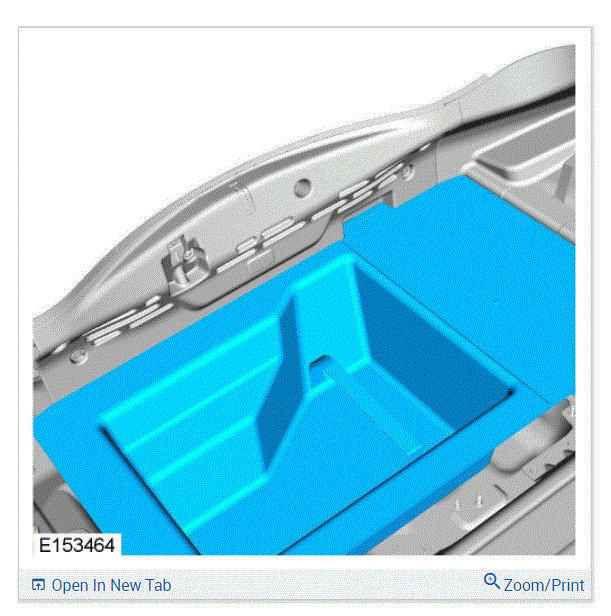

Chances are you are correct. However, you may be able to remove the lid latch motor assembly, clean it, and lubricate it. I have done that in the past and it works.

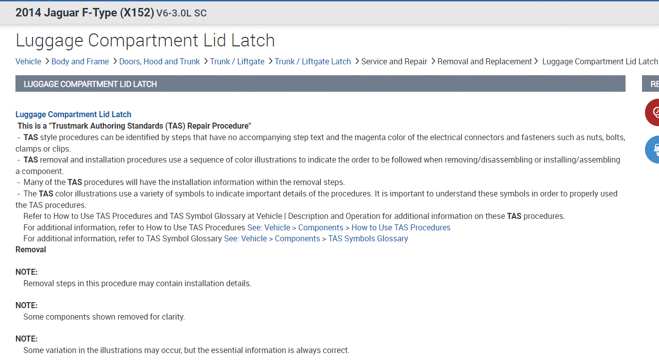

I attached the directions for replacing it. Note these assemblies aren't designed to be serviced, but if you take your time, you can do it.
If you simply want to replace it, I attached the directions below. Also, if you haven't tried lubricating it, do that first.
