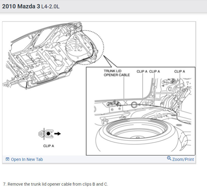

Is cabin trunk release in the vehicle listed above electrical or mechanical?

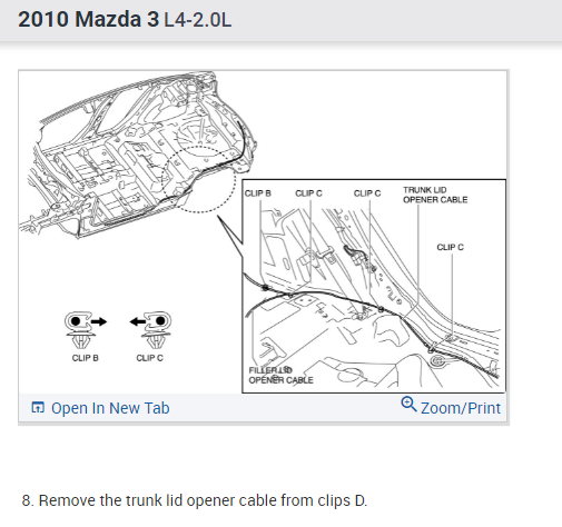

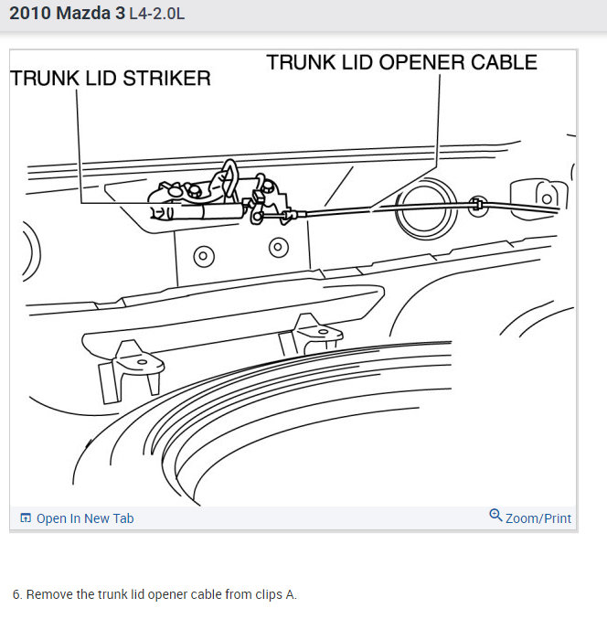

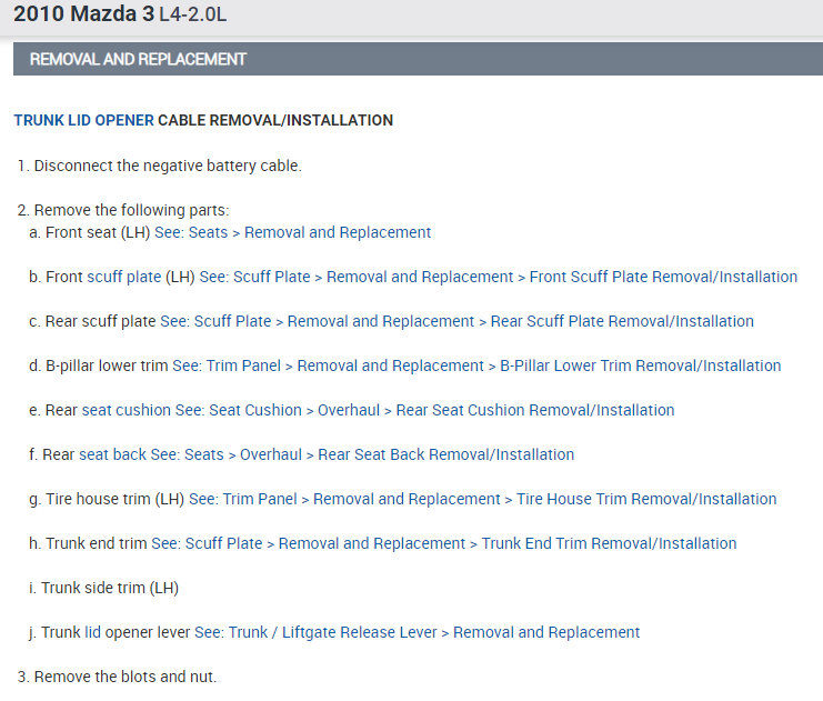

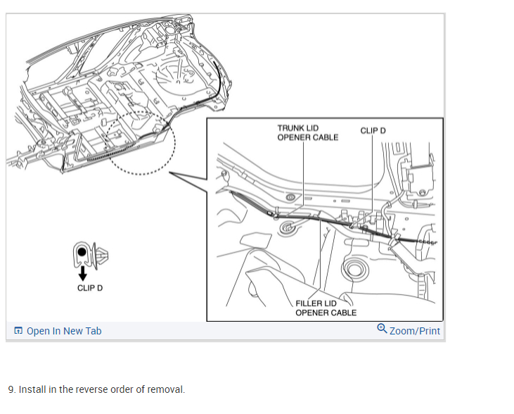

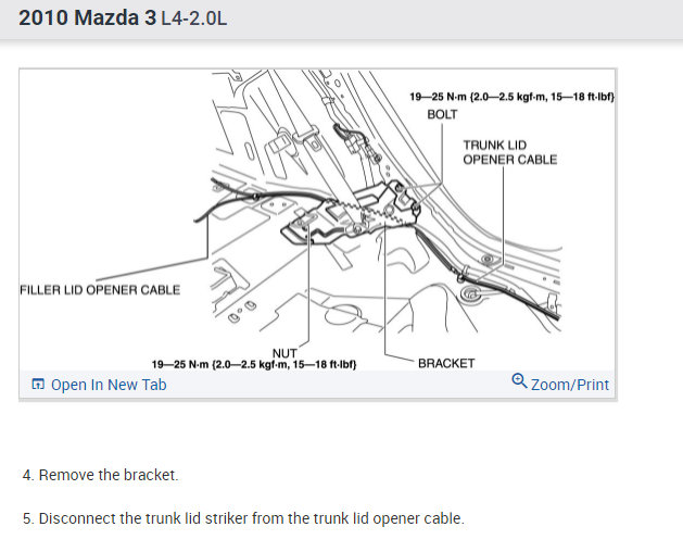

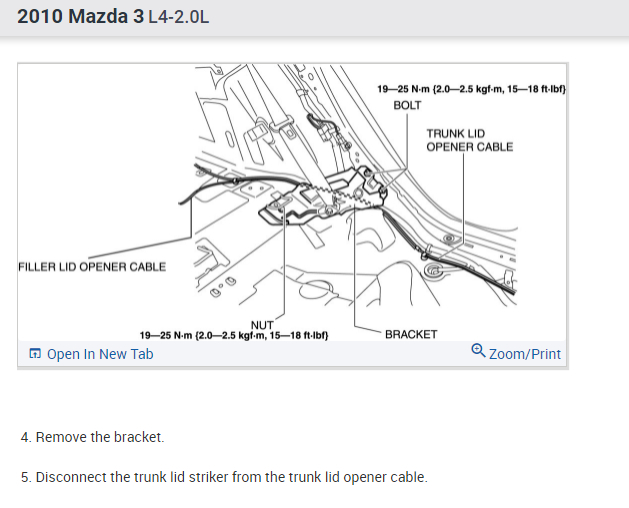

The truck release is operated by cable, so it is mechanical.
Unless something got jammed or broke, you should be able to open the trunk.
See attached for the diagrams.
https://www.youtube.com/c/2carpros/featured
Let me know if you have any questions.
