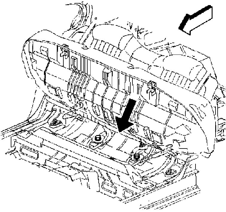

Now you should see a pair of bolts holding the backrest to the body. Remove those bolts, then lift that cushion up off its hooks. Pull the top forward, then that section can be removed from the car.
There is likely to be a silencer pad still hanging there. Remove that to gain access to the trunk. Take a flashlight and a pair of pliers with you. There is usually what looks like the end of a flat-blade screwdriver attached to the lock cylinder. You can see that sticking through the latch assembly. Use the pliers to turn that piece to pop the latch. There may also be an emergency cable to pull once you're in there.
