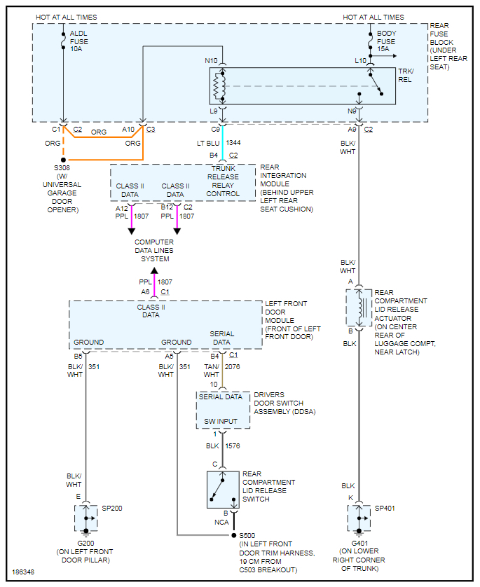

Very odd. The trunk pops open without rhyme or reason. I can shut the car off, lock up, walk away and the trunk pops open. I have tried to hide all the fobs and kept them far away from the car thinking that I could releasing the trunk with the fob, but this does not seem to be the case. I am perplexed to why this is occurring.
In my Google searches, it seems that it can be an electrical problem or a bad latch?
Dec 24, 2017 at 1:58 AM

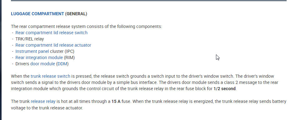

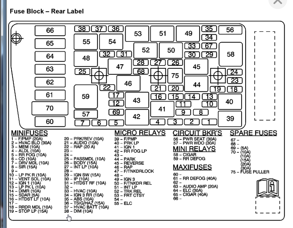

More then likely this is a faulty relay. I suspect the relay is shorted and it making intermittent connection and it pops the trunk.
Here is a guide on how to test the relay:
Also I attached the wiring diagram and location of the relay. If it were me, I would replace the relay and see if it acts up any more. I suspect it won't but we won't know for sure unless it does it again.
Let us know what questions you have and we can go from there. Thanks
