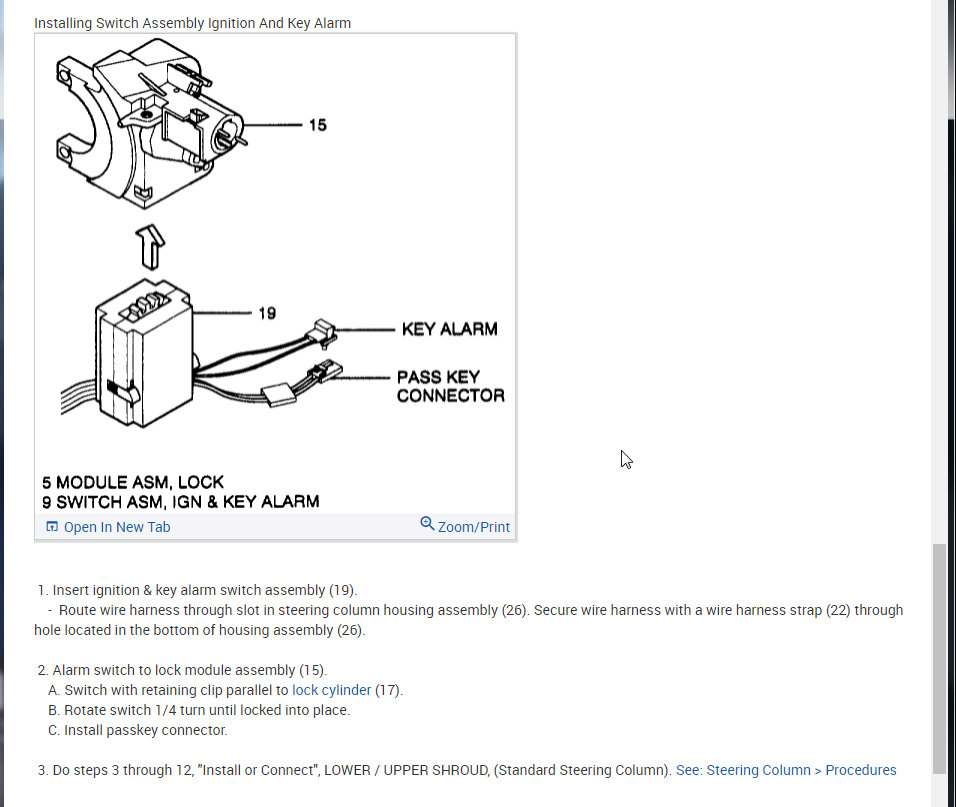

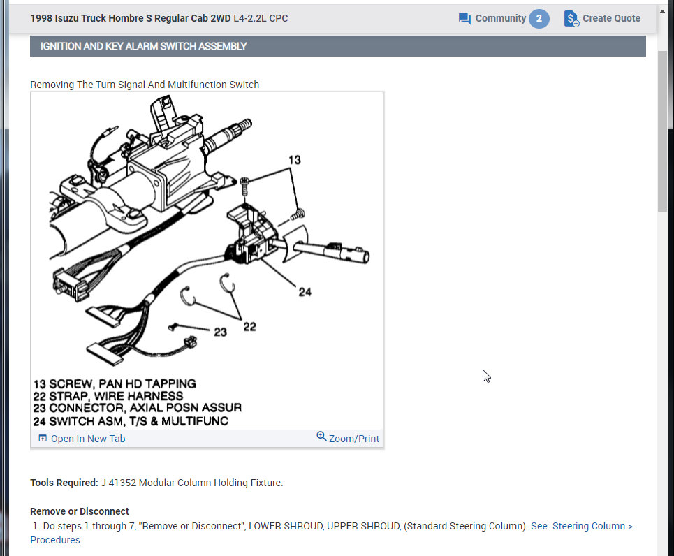

I changed the ignition switch and now it won't crank. what did I do wrong?
Apr 26, 2021 at 10:09 AM

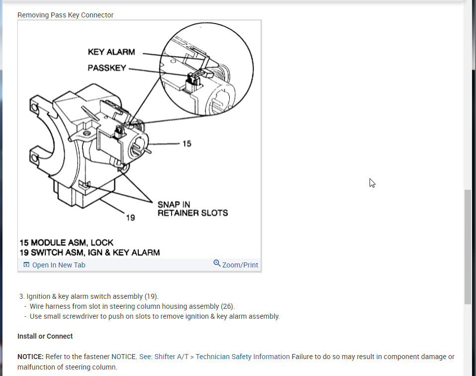

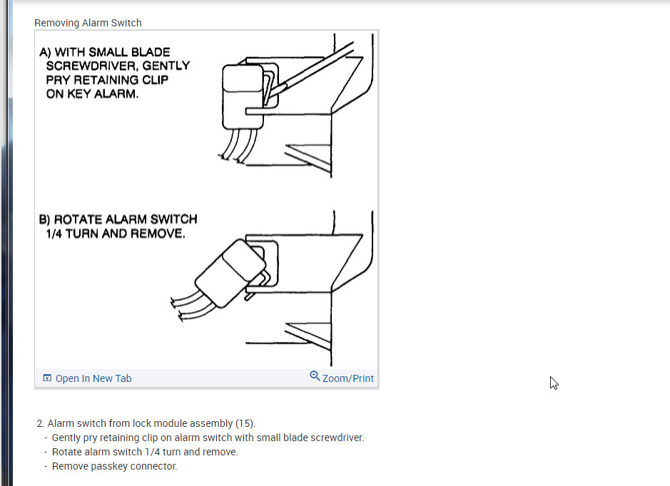

It is hard to know for sure what was done wrong but the most likely thing is the pass key connector was not plugged in.
I attached the process below on how to replace this from the manual. Please look through this and let us know if there was something missed.
If not, we need to know what the voltage is coming out of the ignition switch to ensure there is nothing else going on here.
Let's start with this and go from there. Thanks

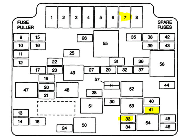

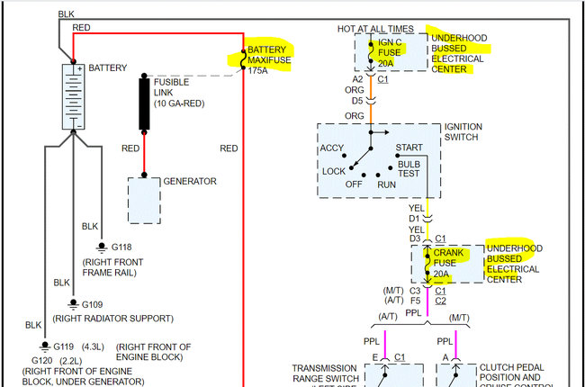

It's possible that a fuse was blown. I need you to check a few different ones. In addition to checking the fuses, confirm there is power to and from them.

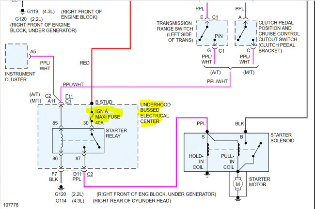

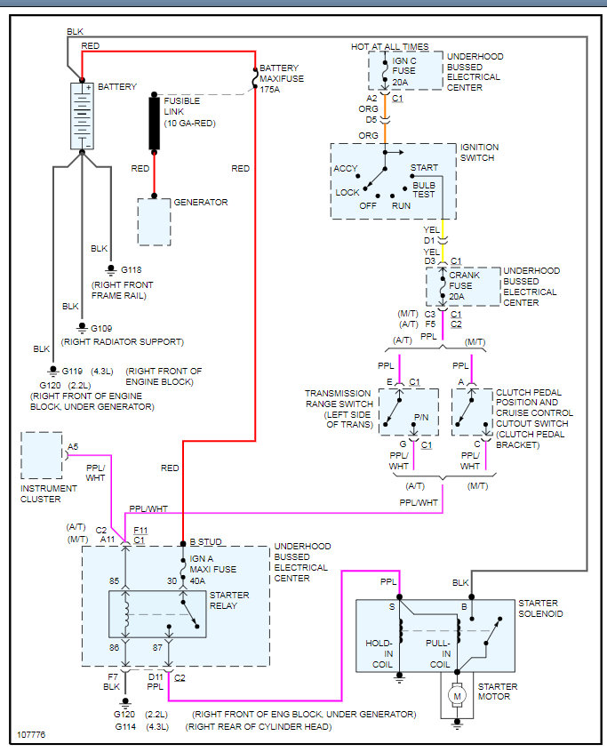

If you look at pics 1 and 2 below, they include the entire wiring schematic for the starting system. I highlighted several fuses. All are in the underhood electrical center but one. The one that isn't is the battery maxi-fuse. Check that one last. However, I don't suspect it is the issue.
In pic 3, I highlighted the fuses to check in the underhood electrical center.
Let me know what you find or if you have other questions. Also, let me know if anything is working.
