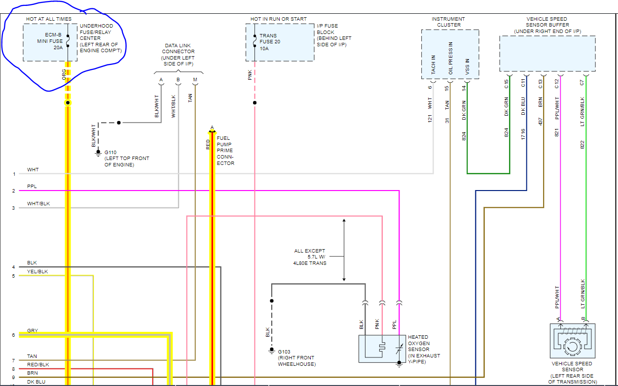

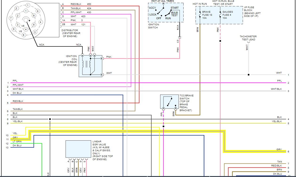

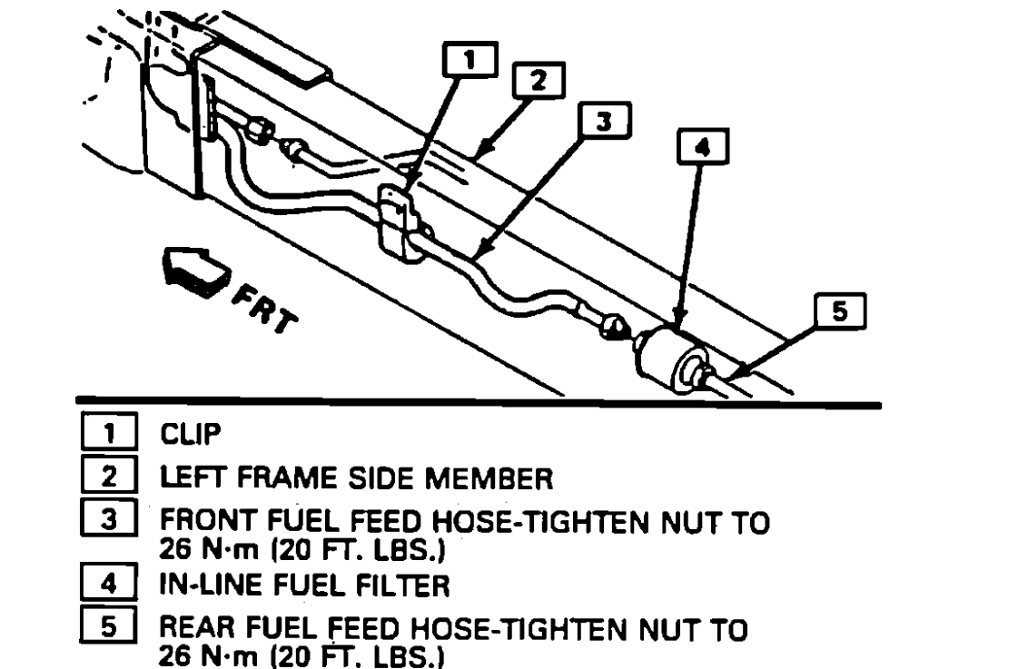

Truck is turning over, wants to start, no fuel coming from injectors and no spark at plugs. Changed distributor cap and rotor along with coil pack. No change. Fuel does come through filter under drivers door side, not sure on PSI.
Had a hard freeze since the last time it was started only thing I can think of that is different since last start.
Last time I started it, 1-2 months ago, there was a backfire in the engine compartment but kept running. Has exhaust leak and a bit of white smoke when first started.
Truck has been sitting up for several years but always starts. Sometimes has needed a jump or new battery.
Sitting up due to transmission problem.

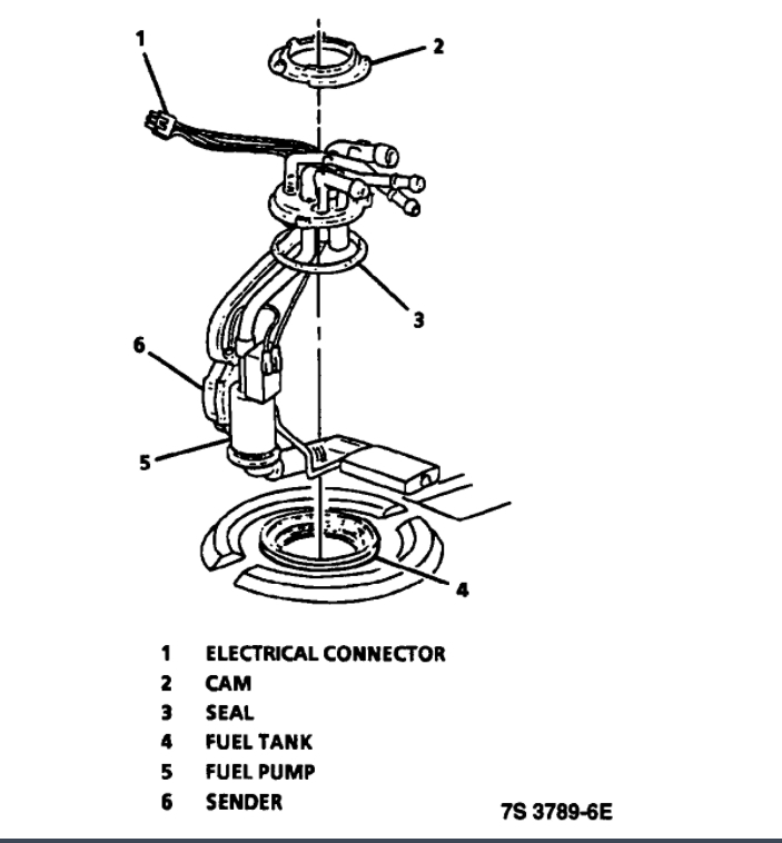

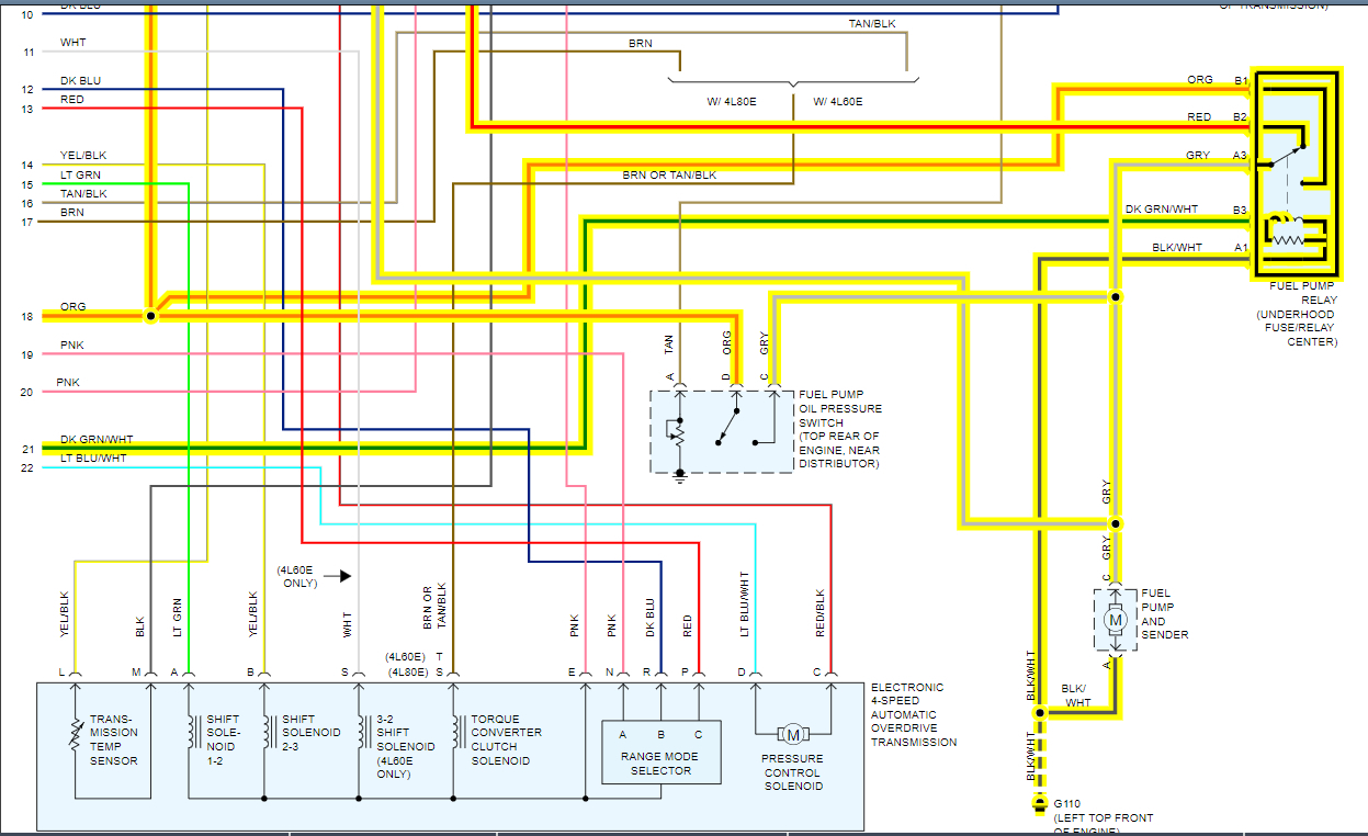

Fuel that is several years old is not good.
I would drop the tank, flush out all the old fuel and replace the fuel pump as well. Add fresh fuel when completed.
https://www.2carpros.com/articles/how-to-replace-an-electric-fuel-pump
Change the fuel filter as well.
https://www.2carpros.com/articles/how-to-change-a-fuel-filter
The pump should run for 2 seconds when the key is turned to the on position. Then it will turn on full when cranking.
Check the pressure when completed. You should have 9-13 pounds of pressure.

4. Fuel tank.
5. Sender unit and pump by turning the cam lock counterclockwise using tool J 36608 or J 24187.
6. Fuel pump from the sending unit.
- Pull the fuel pump up into the attaching hose while pulling outward from the bottom support.
- Do not damage the rubber insulator or the strainer.

REMOVE OR DISCONNECT
1. Relieve fuel pressure.
2. Fuel filler cap.
3. Fuel feed nuts.
4. Clamp bolt.
5. Filter and clamp from fuel lines.
6. Clamp from filter.
INSTALL OR CONNECT
1. Clamp to filter.
2. Filter and clamp to fuel lines.
3. Clamp bolt.
4. Fuel feed nuts.
5. Fuel filler cap.
6. Check for leaks.
