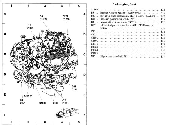

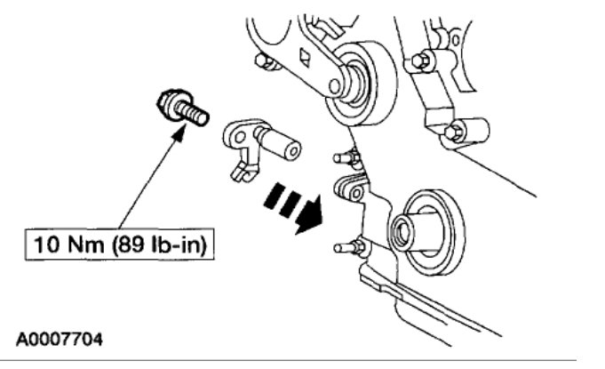

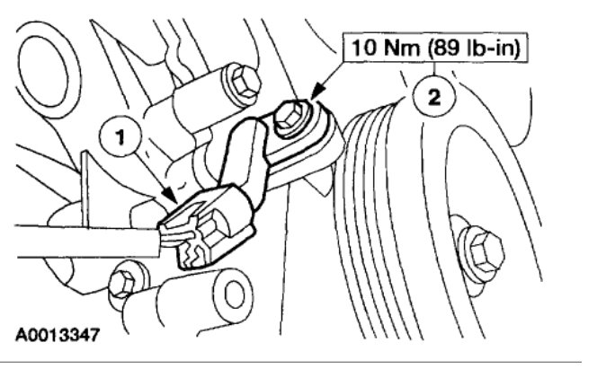

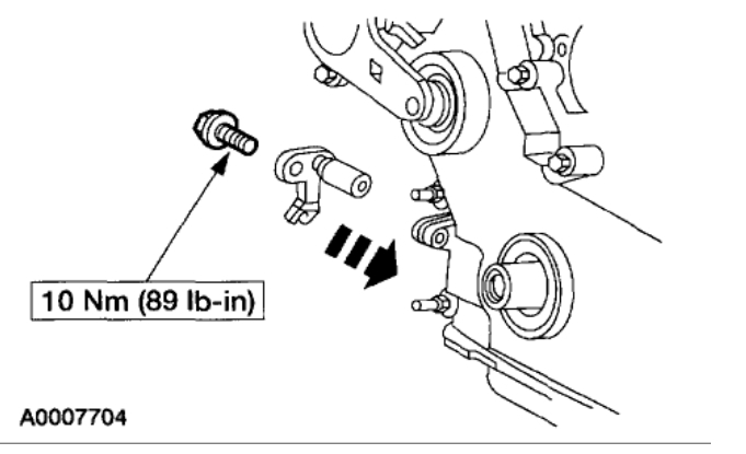

KEN L
  • MASTER CERTIFIED MECHANIC
  • 48,363 POSTS
To me it sounds like a classic crankshaft angle sensor that is going which most of the time will not set a code.
Here is a guide to help you see what you are in for when doing the job:
Below is what it will be like for your car.
Please let us know what you find. I'm interested to see what it is.
