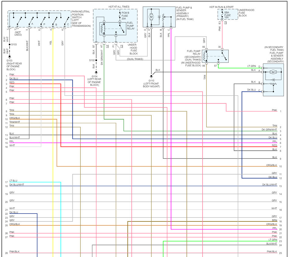

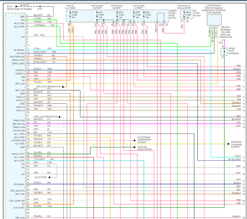

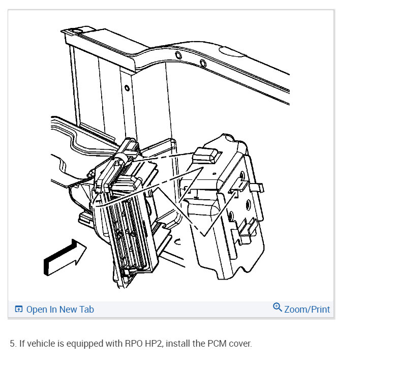

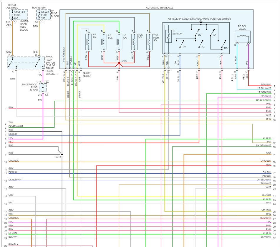

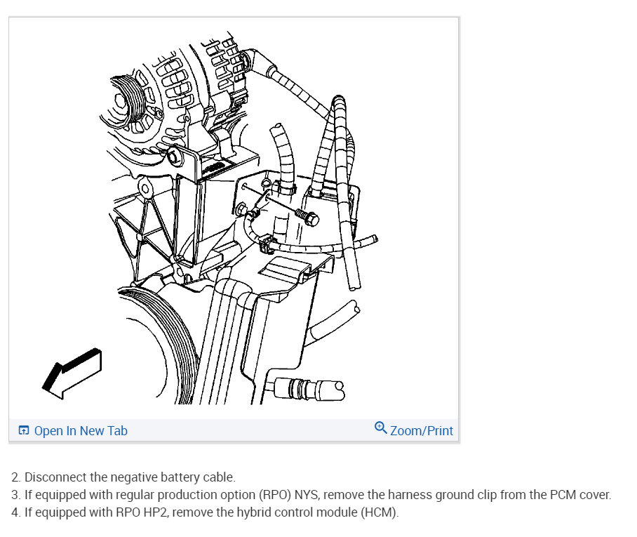

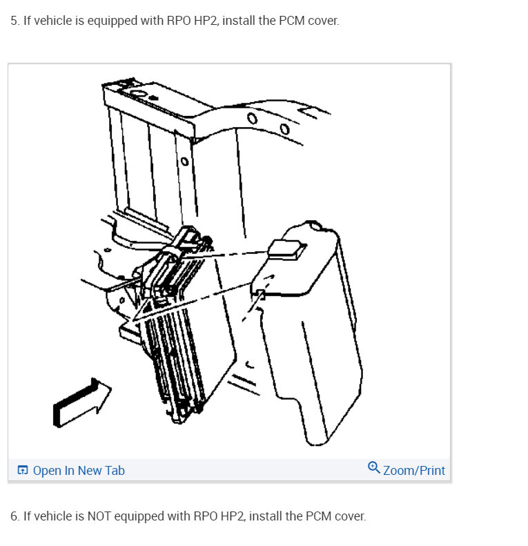

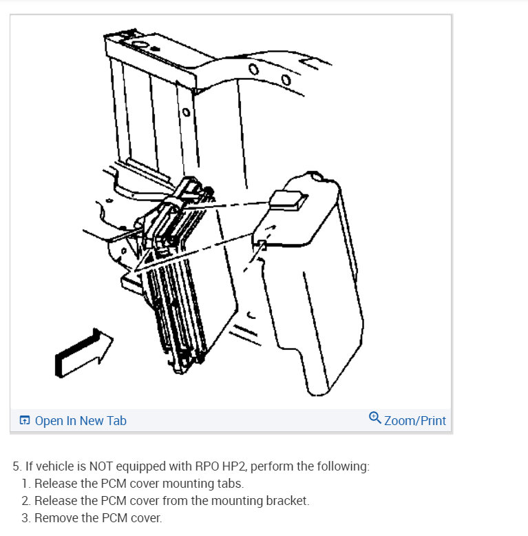

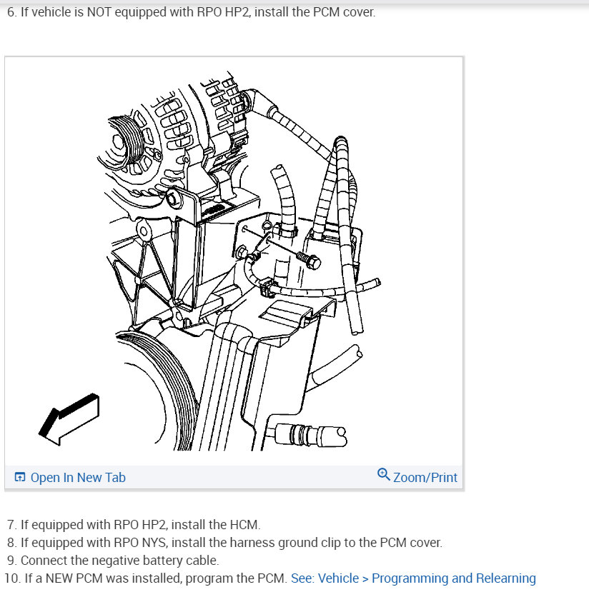

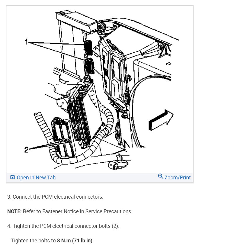

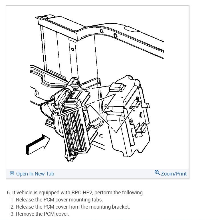

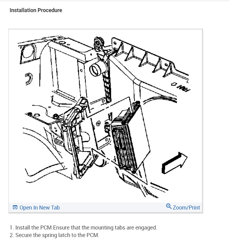

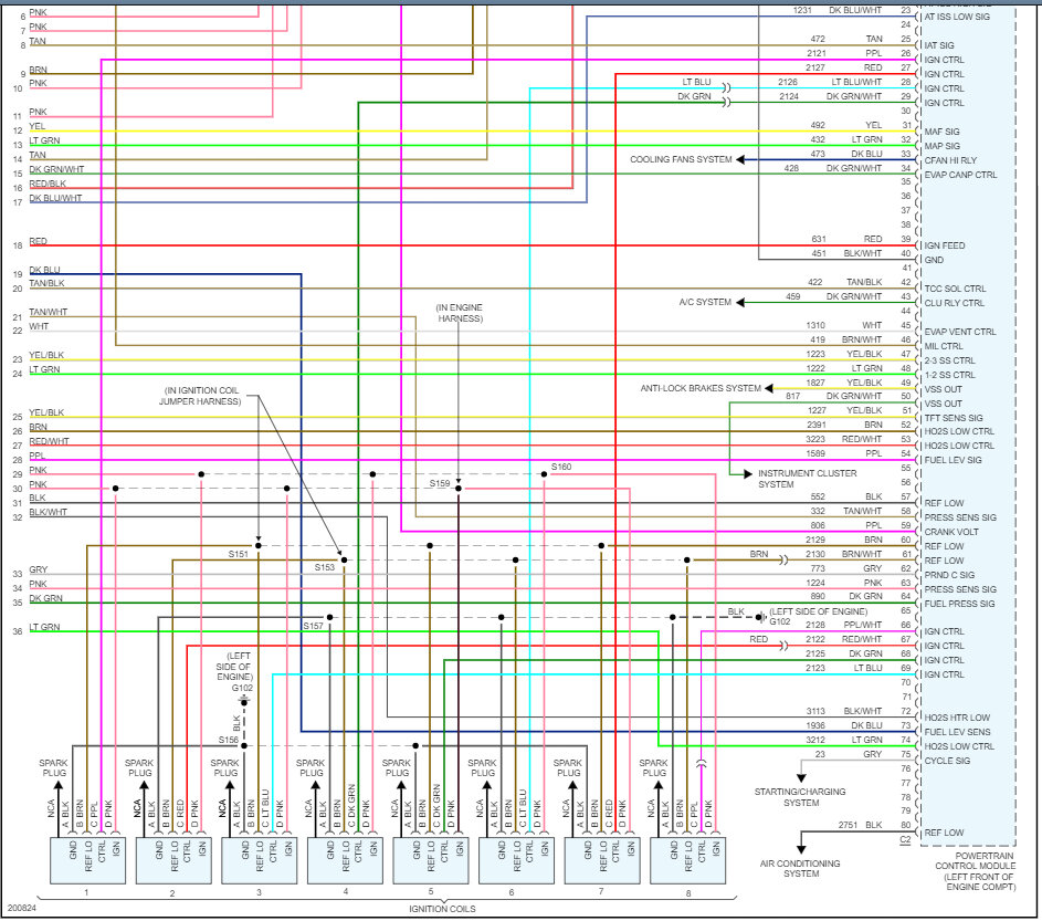

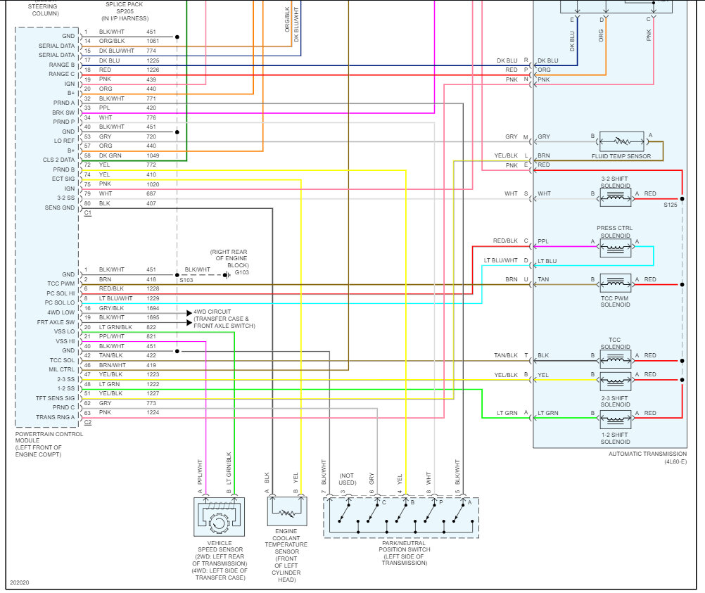

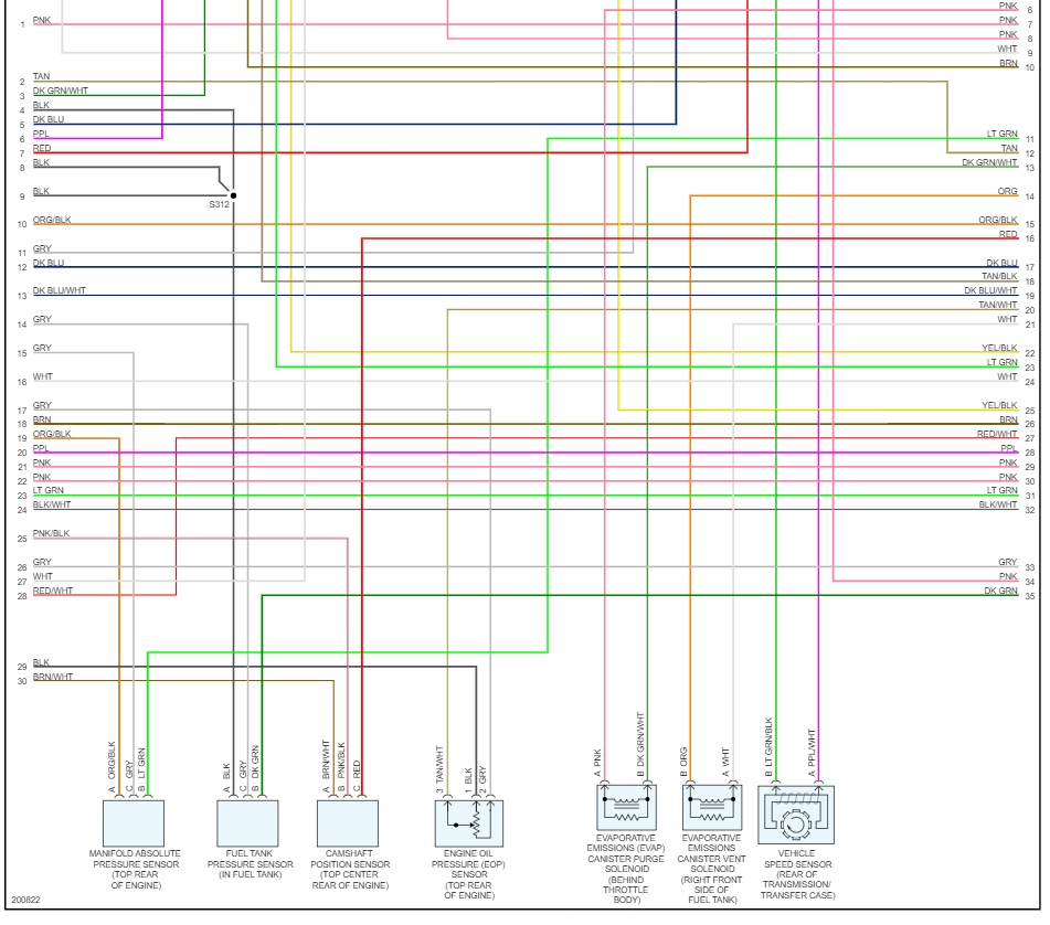

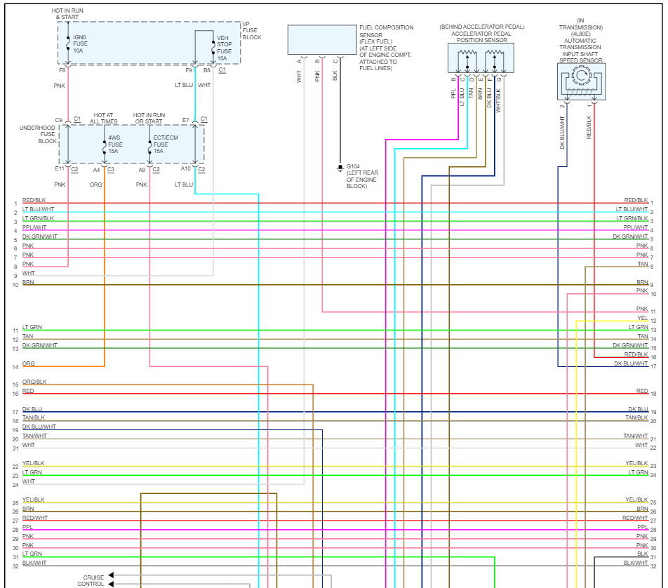

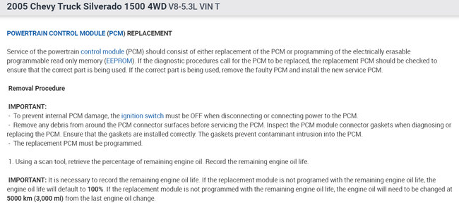

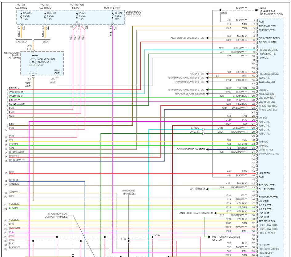

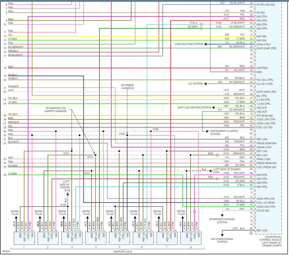

I would start by checking the power and grounds to the PCM which this code is pointing to. Also, you can send the PCM in for testing because it sounds bad, the fact you can reset the system and it works for a while is a classic sign the PCM is bad.
The U0107 error code communication problem between the Engine Control Module (ECM) and the Transmission Control Module (TCM).

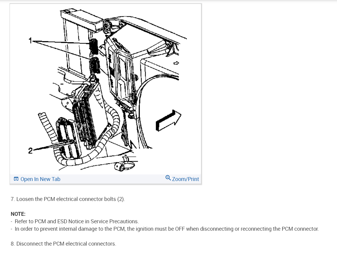

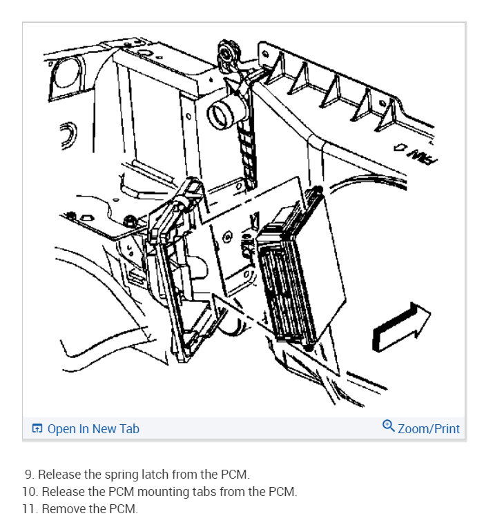

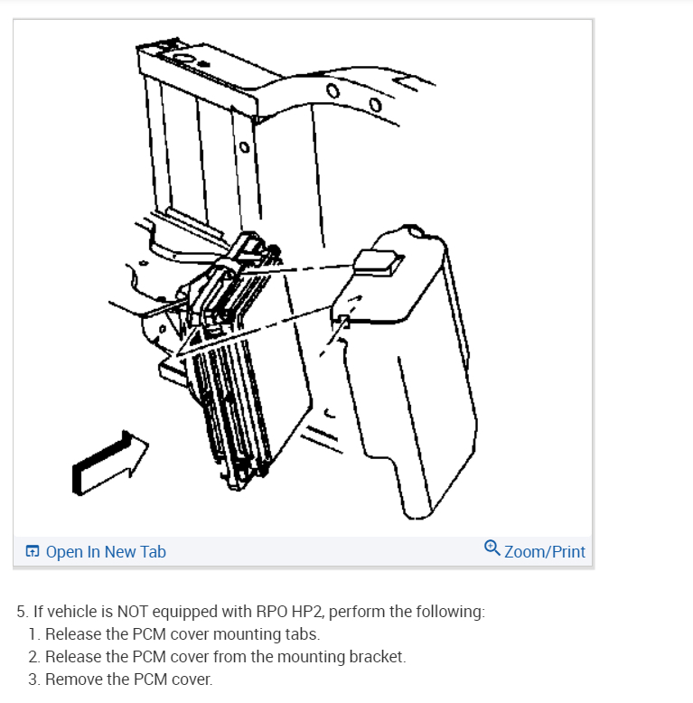

Here is how to change the PCM out, you can get a preprogrammed unit by searching Google or Ebay.

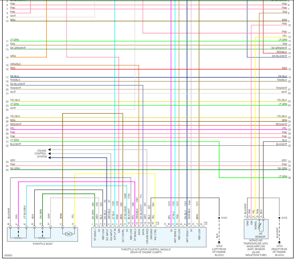

I tried my original ECM that has been reprogramed and passed the testing when it was done, and there is no change. I actually had to clear the code when I installed it, which seems strange to me. When I cleared it, it ran for a couple seconds, and the code appeared again. When I look it up it says lost communication with Throttle Actuator Control Module, not Transmission Control.
Jul 28, 2023 at 1:03 PM
  • 55,433 POSTS

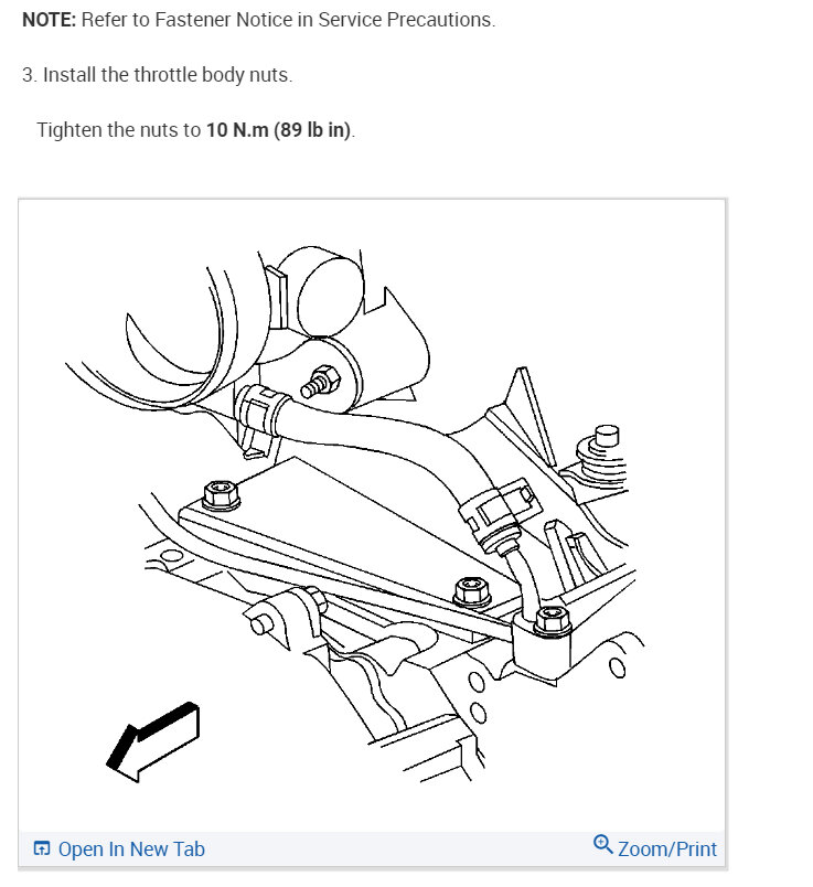

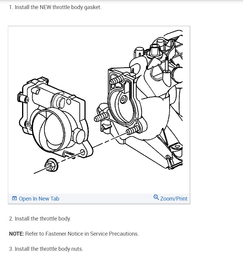

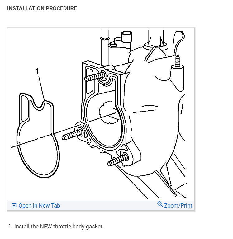

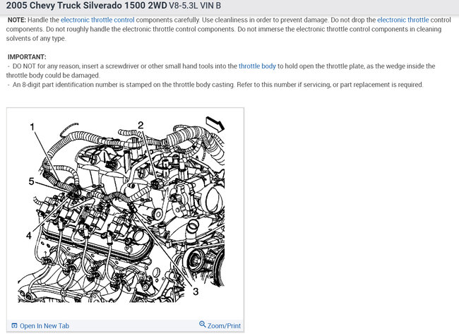

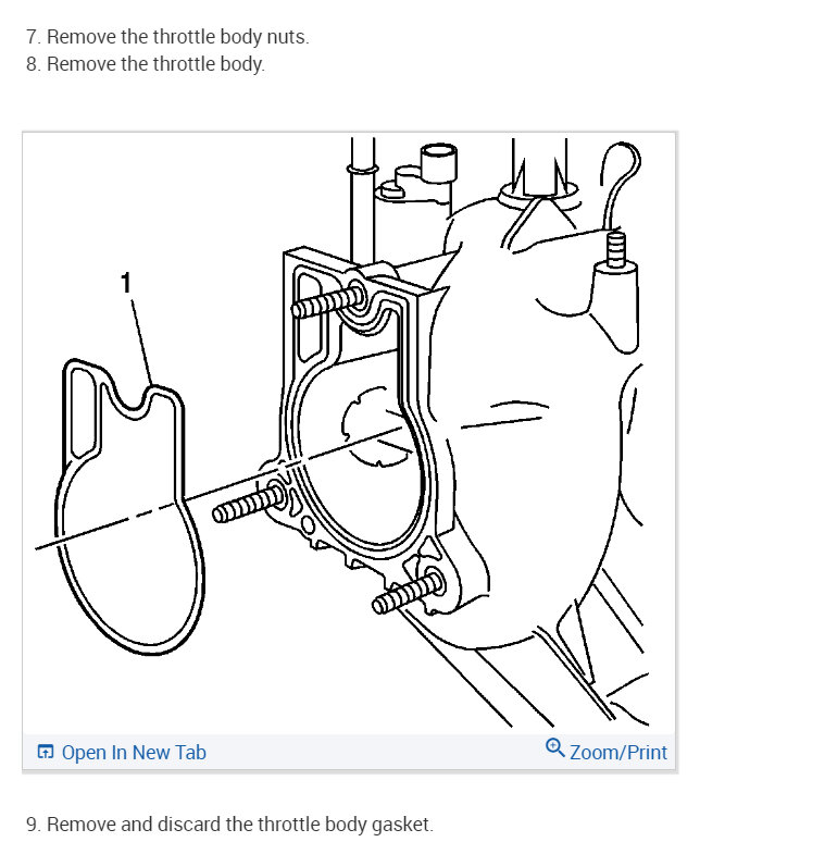

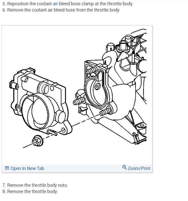

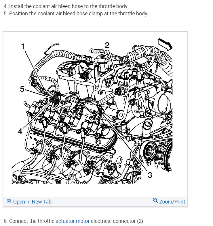

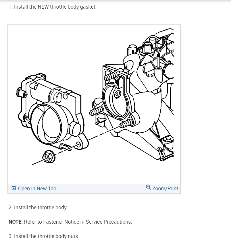

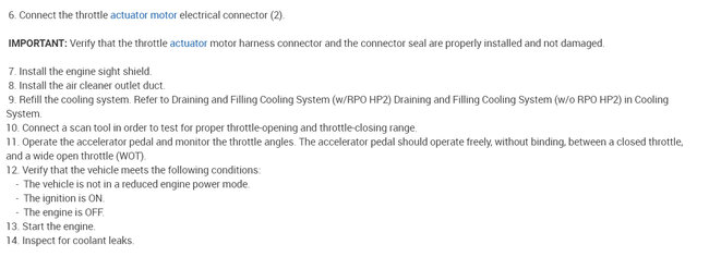

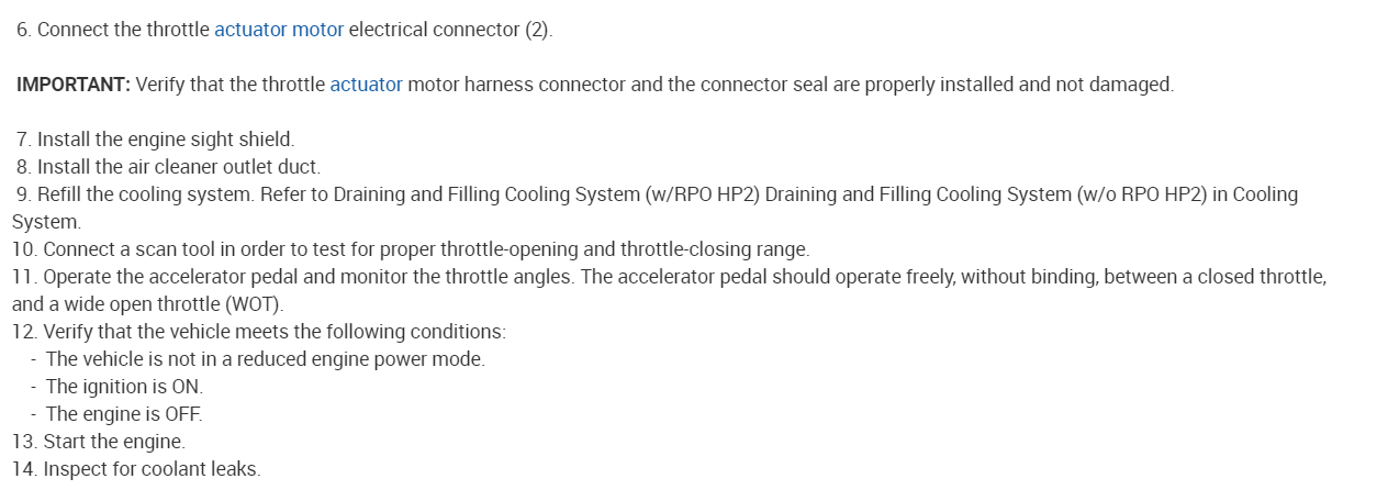

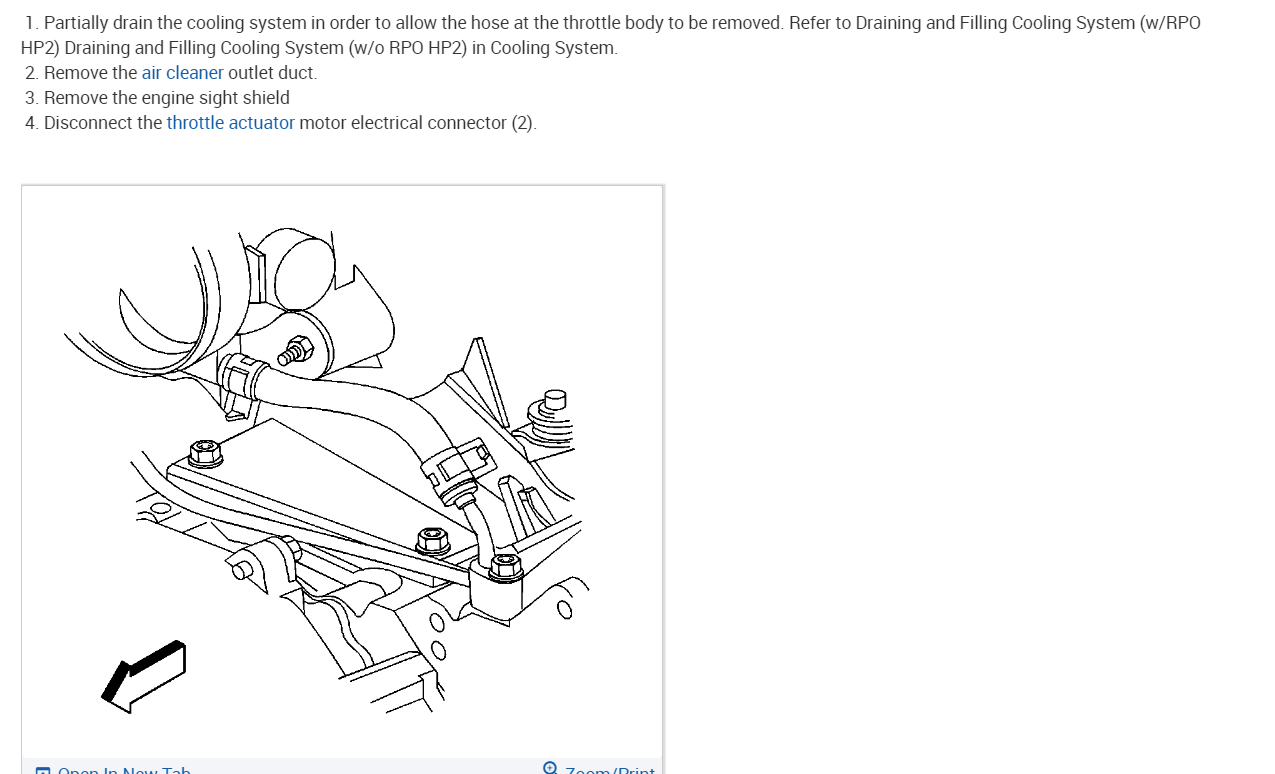

Okay, we are getting closer I would replace the Throttle Actuator Control Module. Here it is for $78.00:
https://amzn.to/43Rzn4e
Here is a video to help with the replacement:
https://youtu.be/eI9aH1r_yc8
Jul 29, 2023 at 5:59 AM
BRENT STROCHER
  • 9 POSTS

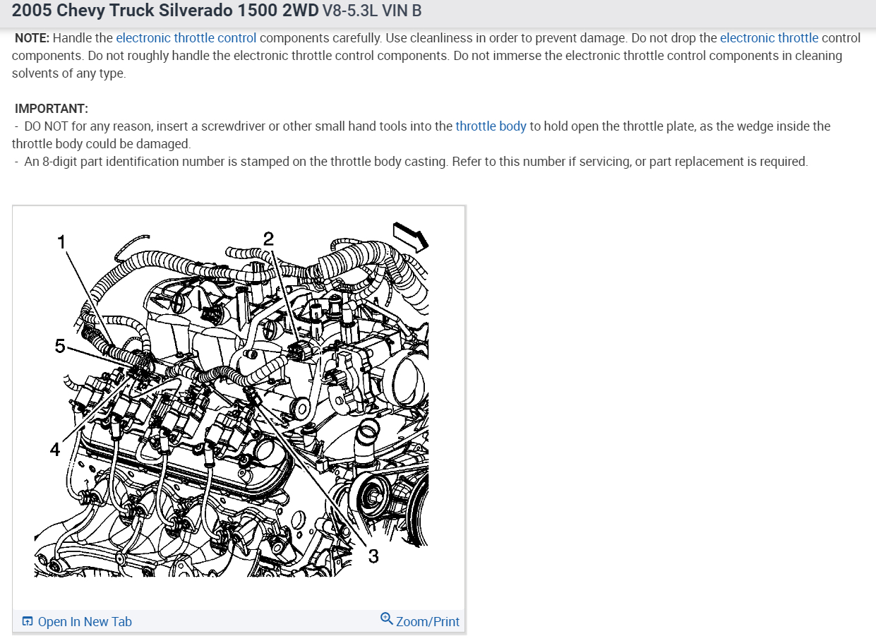

I tried a different Throttle body, and it made no difference. That link is for a throttle body, not the Throttle actuator Module. I just got back from a auto salvage yard and grabbed a used TAC module. it has the same numbers on it so i'm going to try it with out programming.

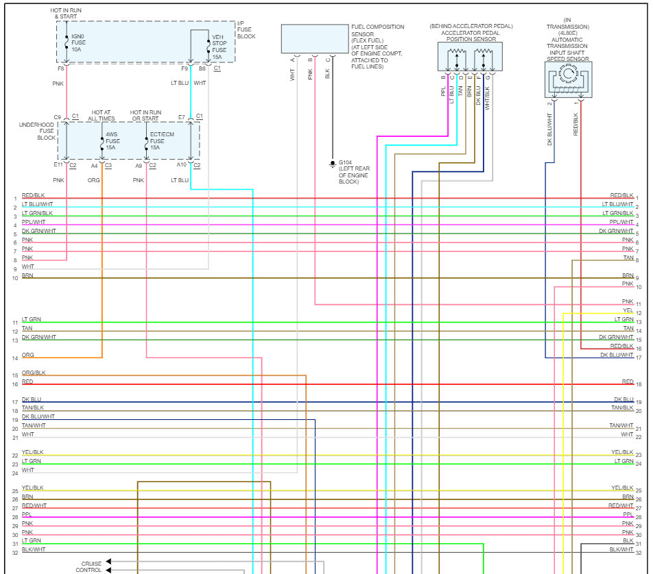

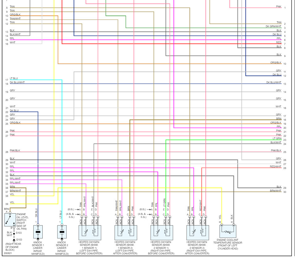

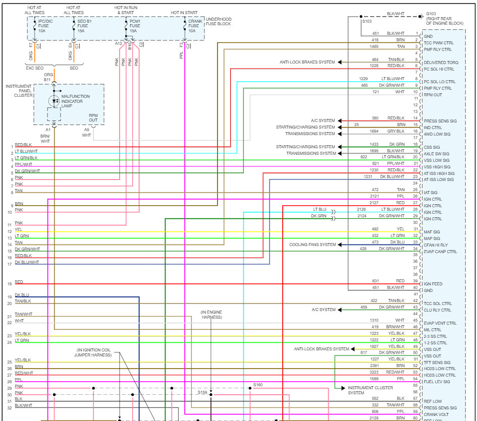

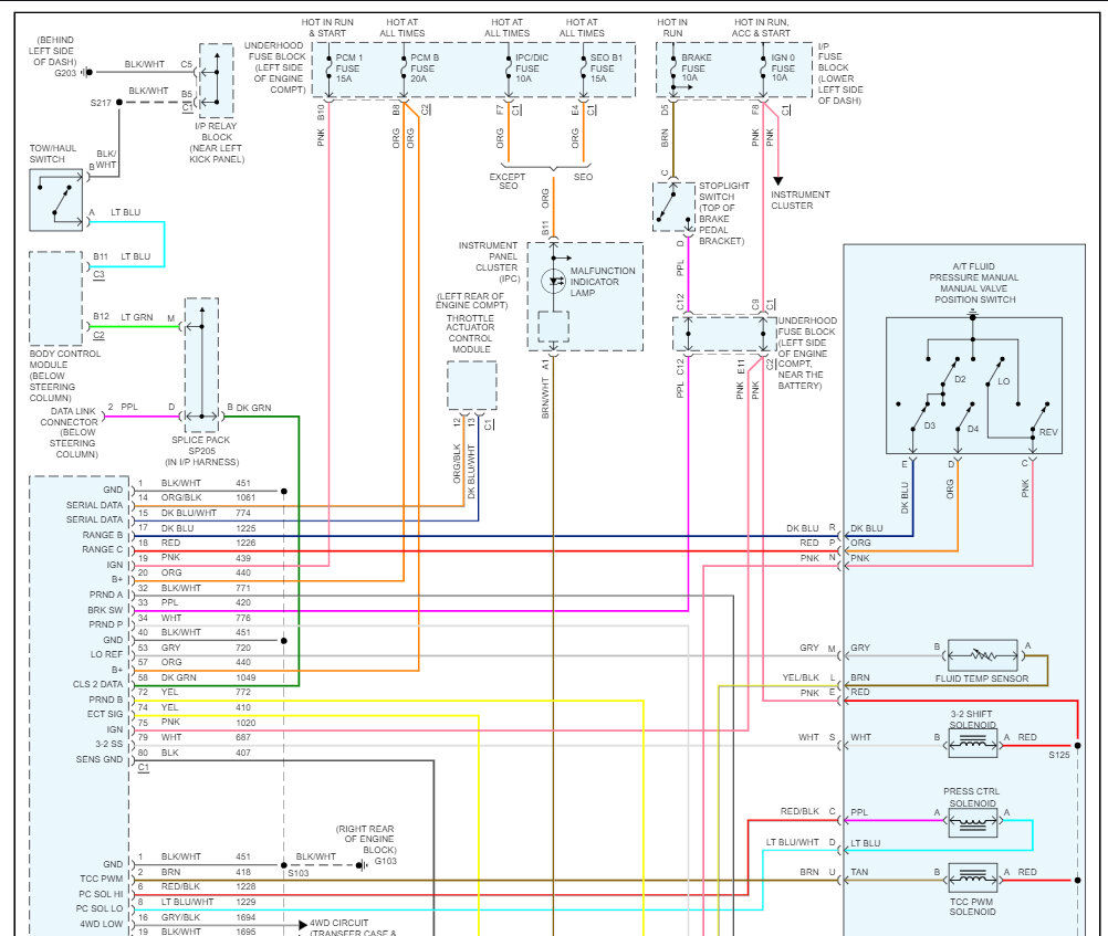

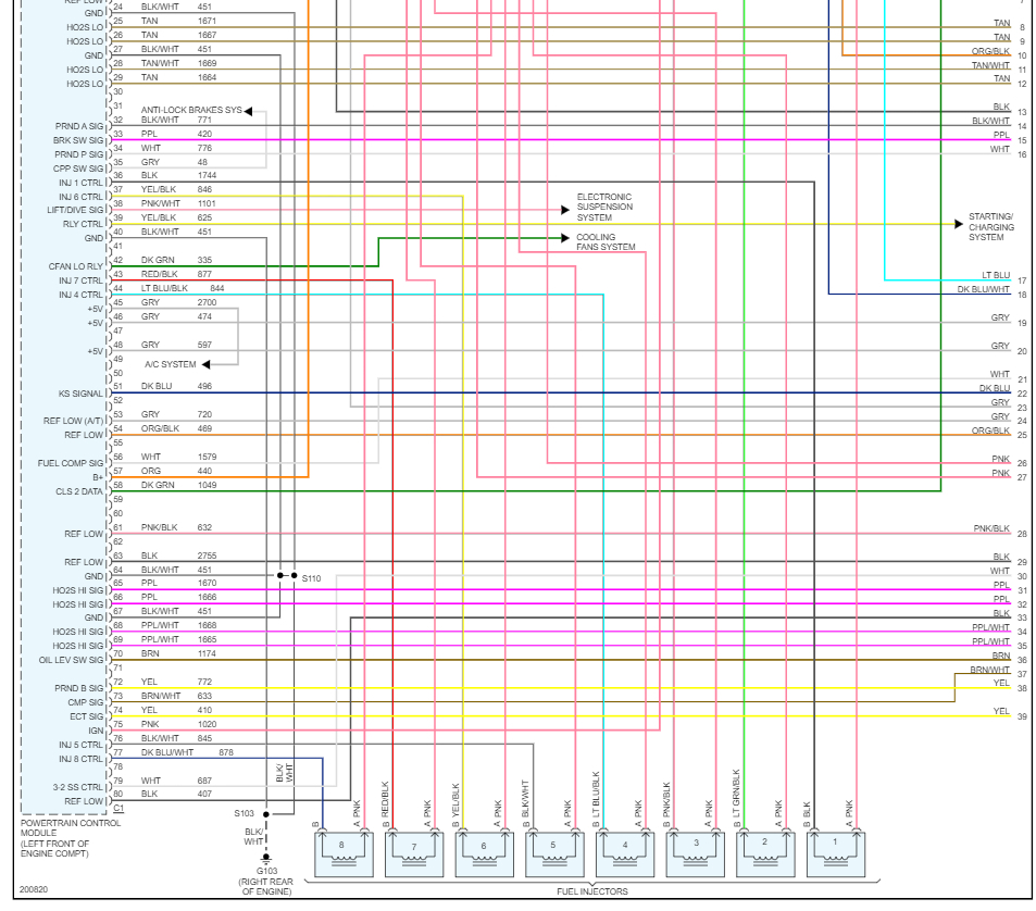

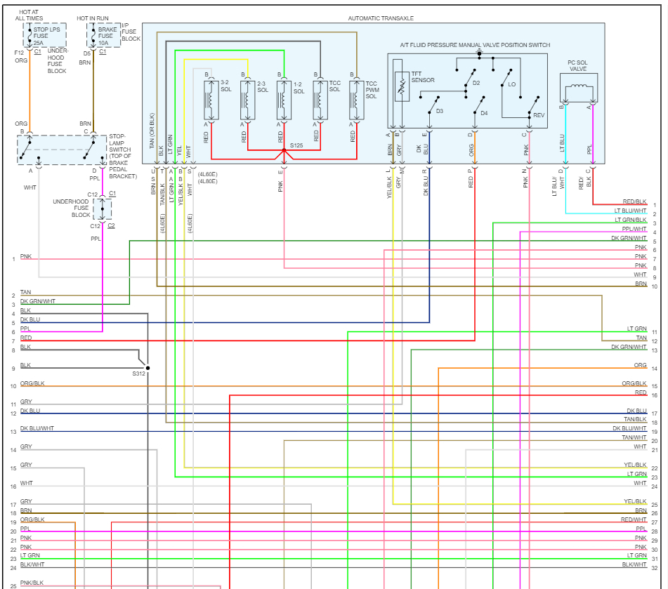

It sounds like the PCM is bad, but here are the grounds and power inputs to be sure.
This guide can help:
Jul 31, 2023 at 3:43 AM
