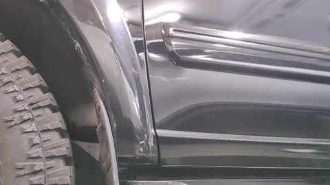

My vehicle listed above shakes (not terribly, but enough to be concerning) while in gear, and shakes much less when in park or neutral.
This happened suddenly, as I parked the truck after getting home from work then by the next morning it was shaking.
There also is a kind of knocking (low, almost like rod-knock) noise coming from the muffler. The timing, water pump, and radiator were all replaced within a year. No knocking noises were observed near the engine.

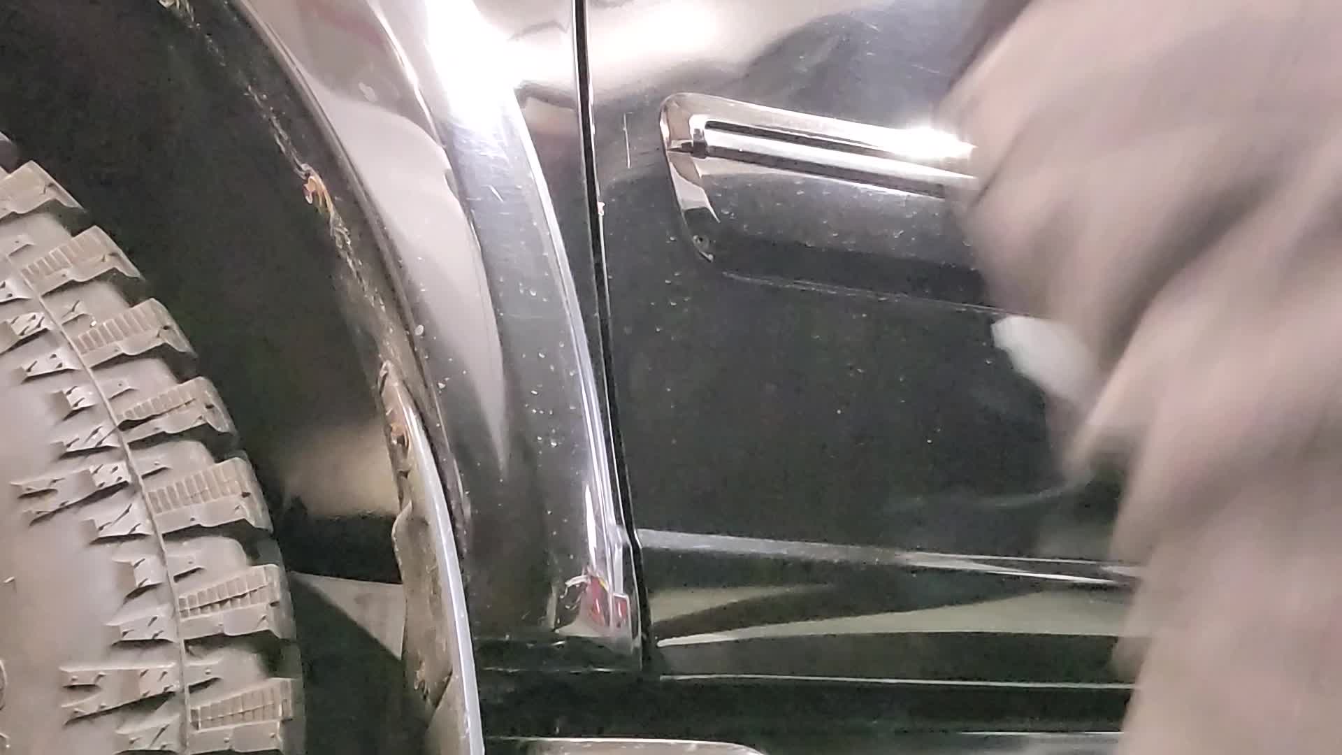

Here's a video of the noise.
Aug 25, 2023 at 10:59 AM
  • 110,248 POSTS
I'm not hearing anything from the exhaust as far as a knocking sound. Try taking a rubber mallet to the exhaust in different places to see if you hear anything rattling inside. It did sound a little odd when you placed it in gear. Have you noticed any power loss or lower fuel economy?
