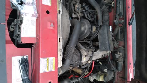

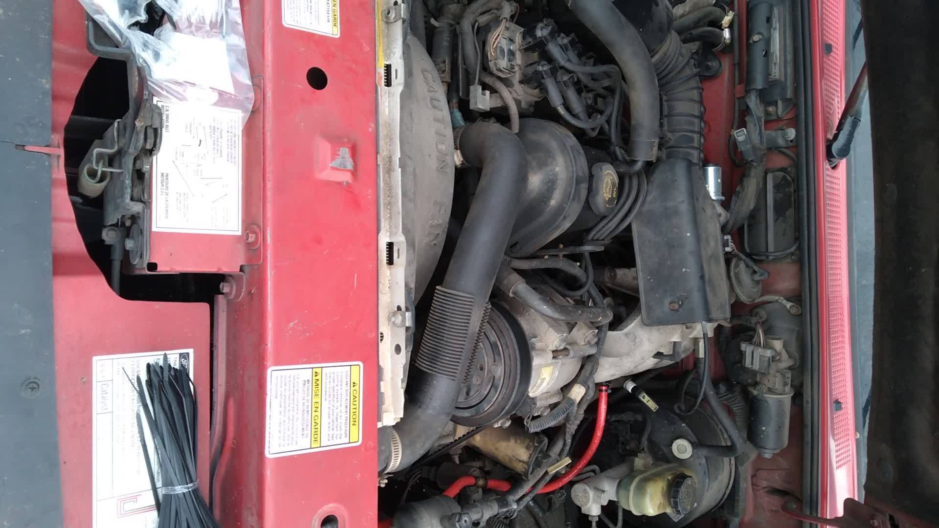

It is getting spark and the fuel pump kicks on. only problem I found was a vacuum line coming form the purge value but replaced it but the truck still wont start.

Does the engine sound differently since this happened? I'm asking because there could be a timing belt issue. If possible, record the engine cranking so I can hear it. I can usually tell if it is a timing-related issue.
If you have spark and fuel, it should run. Do me a favor. See it if will start for a couple of seconds using starting fluid. If it does, then we know it is a fuel related issue.
