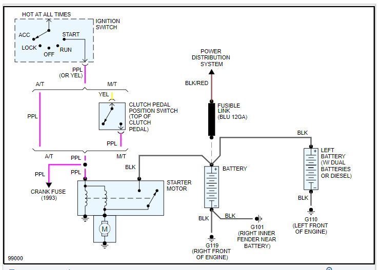

This is a pretty simple system on this engine. So we need to start with checking power on both wires at the starter when cranking the engine and go from there.
If it is not spinning the engine then we need to find out if we have 12 volts at all times on the black wire and then 12 volts on the purple wire when you are in the start position.
Below you will see the wiring diagram. Let me know if you have 12 volts on both wires. If you do then the starter is the issue. If not, it is most likely an ignition switch.
