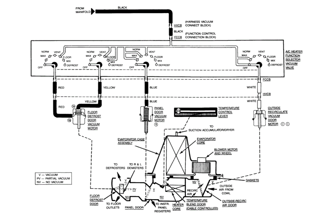

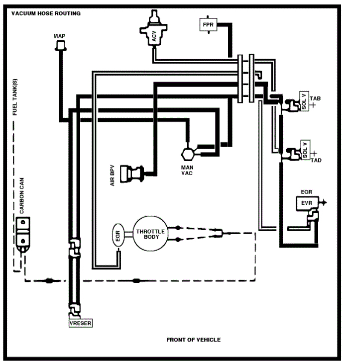

You've been through a lot. I attached the only vacuum schematic I could find for a 1989. Take a look through it and see if it helps.
Here is a link to help with finding a vacuum leak:
The vacuum is slightly lower than I would expect. Usually, it is between 18 and 22hg. Does it stay steady when the engine is loping?
Have you checked for codes that may help? Here is a link that shows how to retrieve codes on a Ford OBD1 system. I realize you indicated you can't find where to check it. According to my manual, (F-Series), the Self Test and STI connectors and are located in the area of the EEC system charcoal canister.
https://www.2carpros.com/articles/ford-lincoln-mercury-obd1-1995-and-earlier-diagnostic-trouble-code-definition-and-retrieval
Also, the HVAC mode is controlled via engine vacuum, so check that as well. If you look at pic 2, it shows the vacuum schematic for the system.

Leaving the MAP sensor vacuum hose connect all other vacuum hoses where disconnected and caps placed over the ports. The PCV hose was left alone.
There is a vacuum hose routing decal on the truck, I will compare with the one sent (thank you).

First, you're welcome for the pic. I have a question. If you plug the PCV vacuum, what does the vacuum go to?
