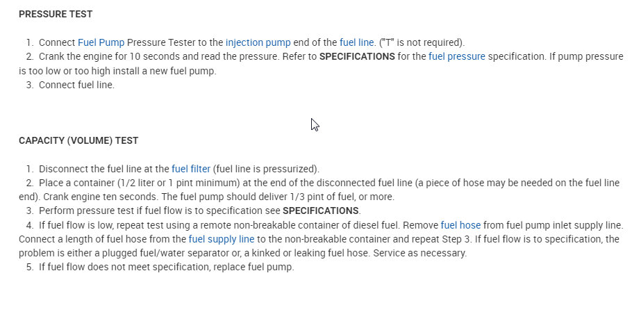

I was driving then the truck started losing power and shutting off. if I let go off the pedal and gets hard to start.
Aug 1, 2019 at 11:12 AM
Hi Ruben,

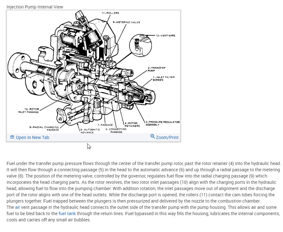

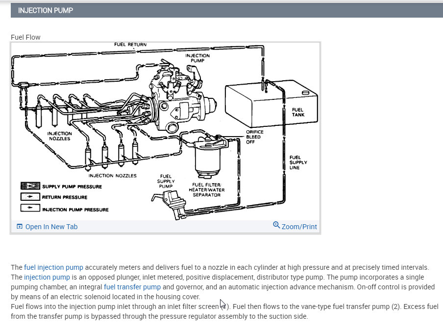

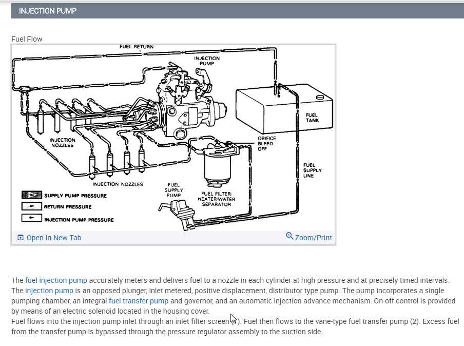

This sounds like a fuel delivery issue. The issue is you need to determine if this is fuel supply or the high pressure side. You technically have two fuel pumps. One is more of a traditional fuel pump called the supply pump and the other is the injection pump that creates your high pressure.

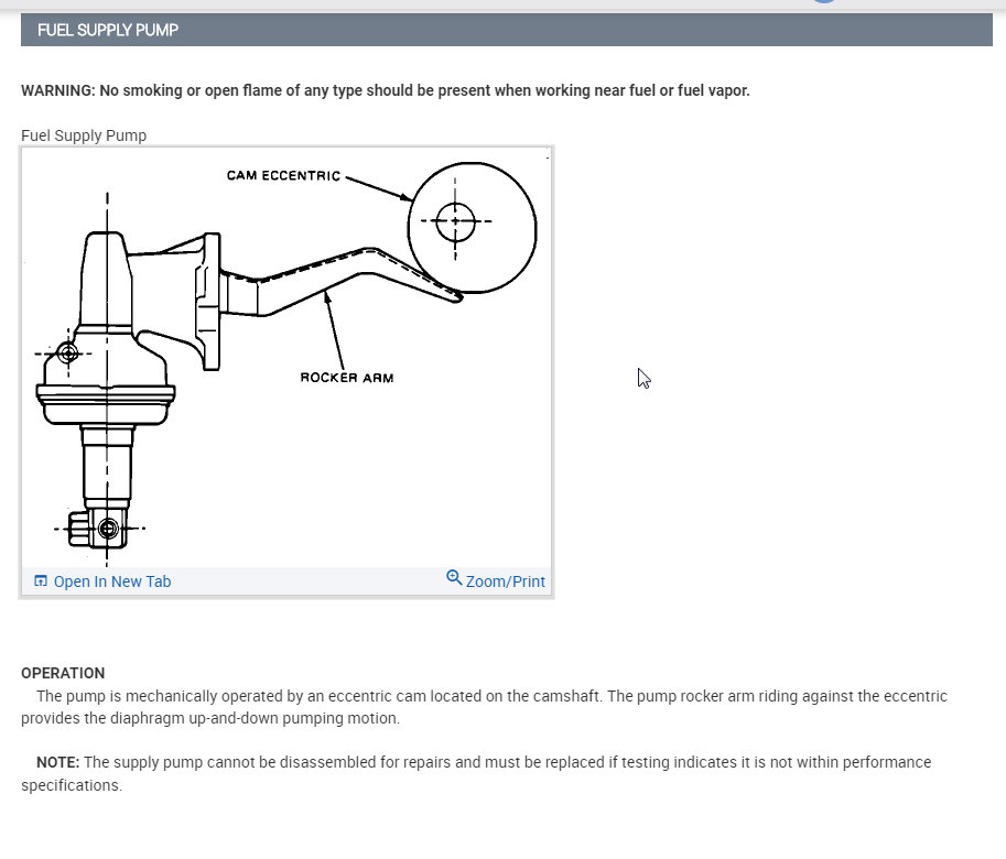

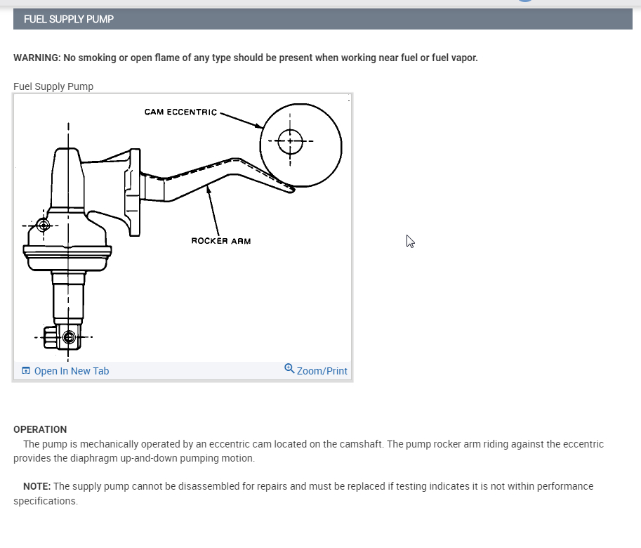

I would suspect the supply pump diaphragm is leaking because it is driven off the cam. So when you pick up the RPM the pump supplies more fuel.
I attached the information and how to test fuel pressure. Let me know if you have questions. Thanks
