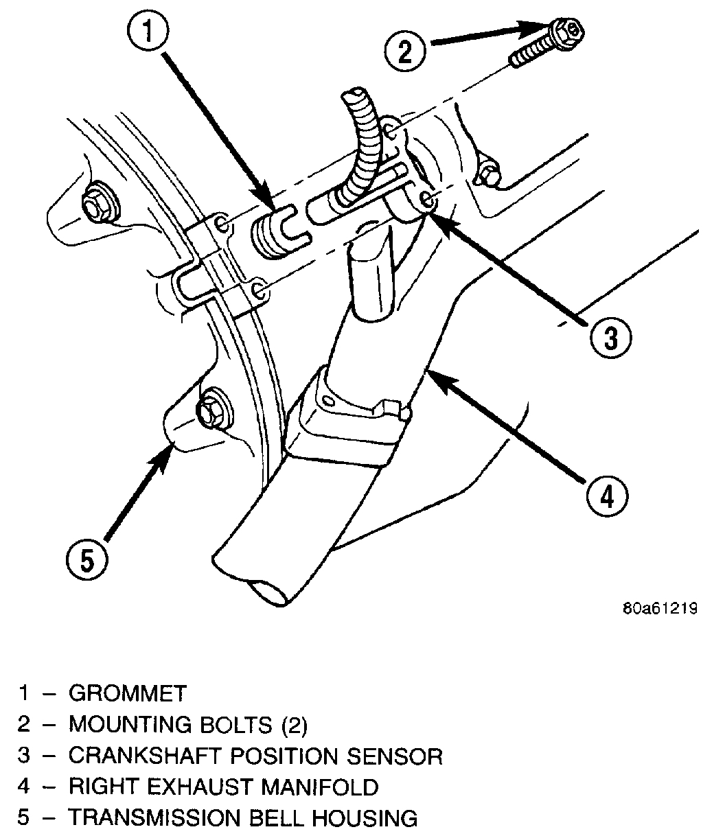

What you are describing sounds like a bad crankshaft position sensor. When they go bad, often times the vehicle will stall and then you can restart it. Also, they usually they are affected by heat. If this happens when the vehicle is warm, that can be a contributing factor.
Take a look through these links. They explain symptoms, the sensor purpose, and in general how one is replaced.
https://www.2carpros.com/articles/how-a-crank-shaft-angle-sensor-works
Here are the directions for replacement specific to your vehicle. If you have a live data scanner, plug it in and drive. When the engine shuts off, my guess is that you will loose the RPM signal to the scanner. Have a helper hold and watch it while you drive.
PROCEDURES
Crankshaft Position Sensor
Pic 1
REMOVAL
The sensor is bolted to the top of the cylinder block near the rear of right cylinder head.
1. Remove the air cleaner intake tube.
2. Disconnect Crankshaft Position Sensor pigtail harness from main wiring harness.
3. Remove two sensor (recessed hex head) mounting bolts.
4. Remove sensor from engine.
INSTALLATION
1. Position Crankshaft Position Sensor to engine.
2. Install mounting bolts and tighten to 8 Nm (70 in. lbs.) torque.
3. Connect main harness electrical connector to sensor.
4. Install air cleaner tube.

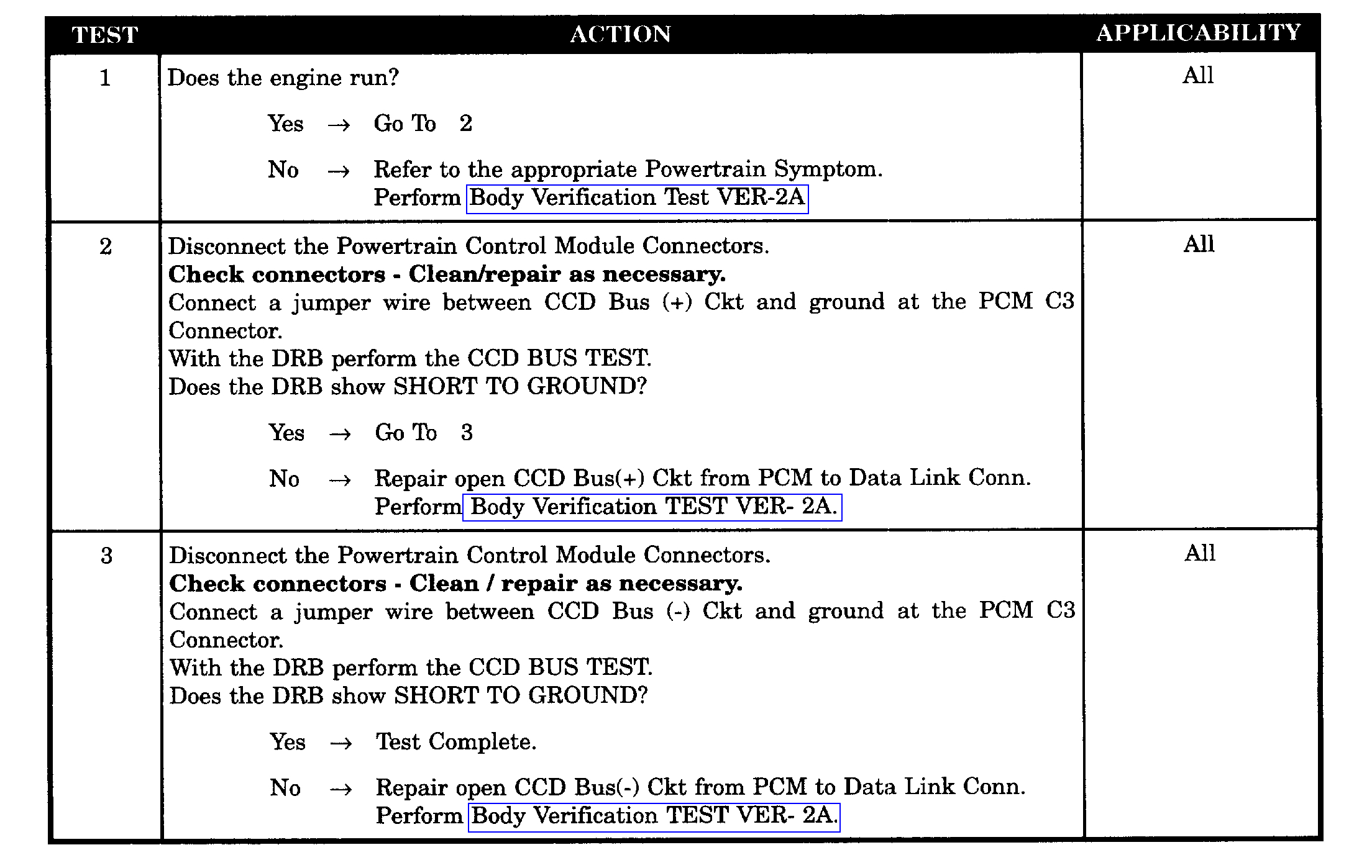

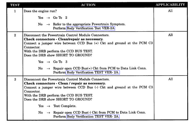

Welcome back:
When you get that message, is that when the engine stalls? No bus simply means a loss of communication between modules. Since the engine stalls, I suspect it has to do with the power control module. I attached a brief diagram which is a flow chart to help identify that type of issue. Also, the following was listed below the flow chart.
______________________
SYMPTOM
NO RESP POWERTRAIN CONTROL MODULE
POSSIBLE CAUSES
- No response PCM bus(+) CKT open
- No response PCM bus(-) CKT open
- Does engine run
_______________________
Now, the first thing I would check is to make sure the connector at the PCM is tight, clean, not corroded, or damaged. Also, don't disconnect it until the battery is disconnected and the PCM must be reconnected before the batter gets reconnected.
Start there and let me know if this helps.
