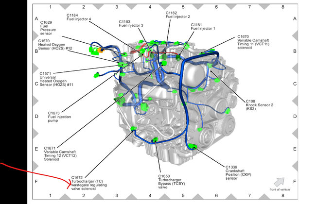

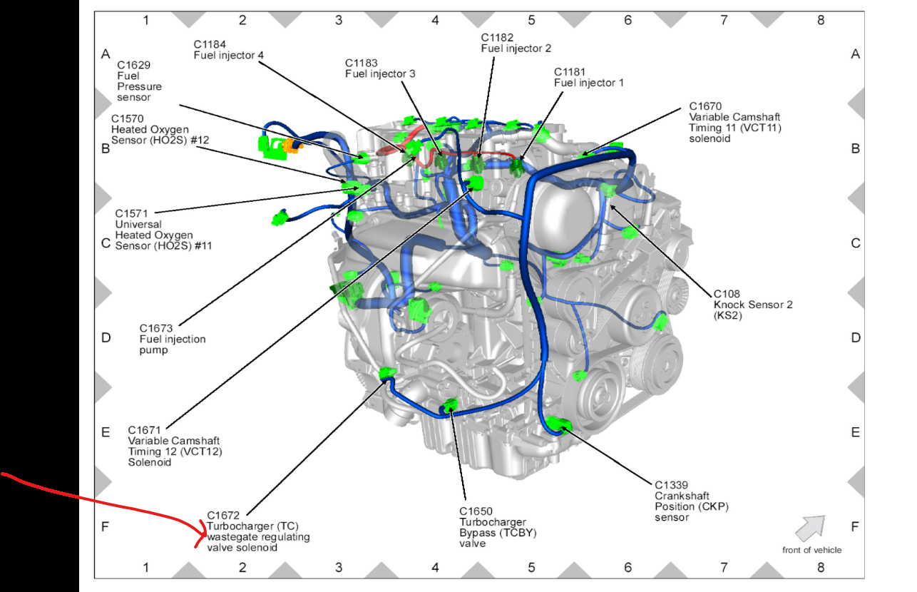

Turbocharger Wastegate Regulating Solenoid Valve Stuck. Here is the location of the wastegate regulating solenoid so you can make sure it is plugged in and if so, replace het solenoid because they can stick.

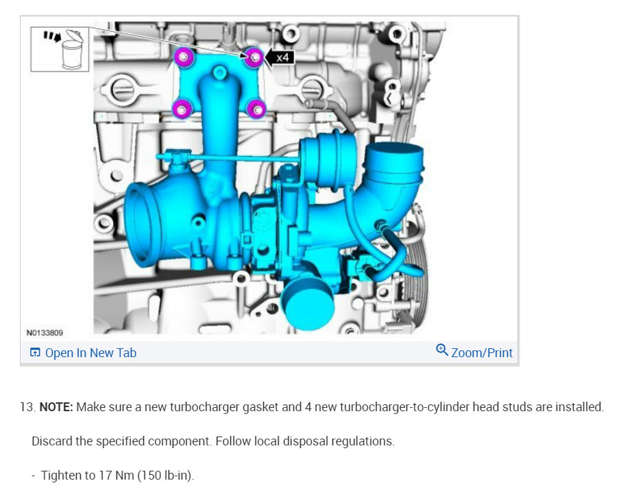

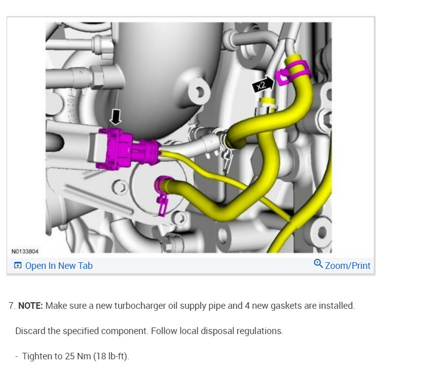

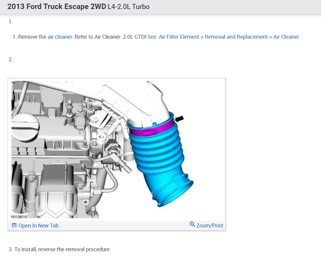

I think you may have a turbo that has gone bad, I would remove the intake and outlet tube to check the turbo endplay and if excessive replace the turbo, I am not sure about the vacuum bleed but I did find this test procedure for the system.

HN16 CHECK TURBOCHARGER PRESSURE WASTEGATE ACTUATOR OPERATION
NOTICE:Do not exceed 103.4 kPa (15 psi) of pressure applied to the turbocharger actuators, excessive pressure will damage the actuators.
- Disconnect the turbocharger wastegate control hose from the turbocharger wastegate actuator.
- Record each of the turbocharger wastegate actuator linkage positions.
- Using a suitable hand pump with pressure gauge, pressurize the turbocharger wastegate actuator to 48.3 kPa (7 psi).
Does each turbocharger wastegate actuator linkage move from the starting position and does the pressure remain steady?
- GO to HN17.
- GO to HN18.

HN22 CHECK THE TURBOCHARGER WASTEGATE SOURCE VACUUM
- Disconnect the vacuum supply tube from the vacuum pump.
- Using the DSL ENG Pressure Test Kit 014-00761 or equivalent, measure the vacuum at the vacuum pump.
