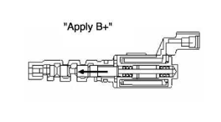

The code is related to the intake valve control solenoid. Is that what you replaced? It may be bad again. Here is a test to check it for operation without using a scanner. The attached pictures correlate with the directions.
_________________________________________
[Without Scan Tool]
1. Ignition "OFF".
2. Remove the intake valve control solenoid from the engine
3. Visually check the Spool Column of intake valve control solenoid for contamination
4. Connect 12V and a ground to 2 and 1 of the solenoid (Component side). Verify that spool column move to left as shown in the figure.
5. Disconnect 12V and verify that spool column move to original condition
Pic 1
6. Has a problem been found ?
- Repair or replace as necessary and go to "Verification of Vehicle Repair" procedure
- Go to next step as below

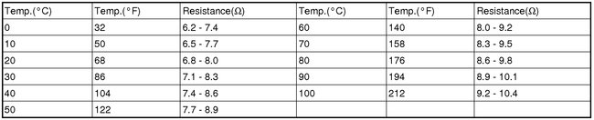

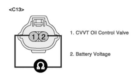

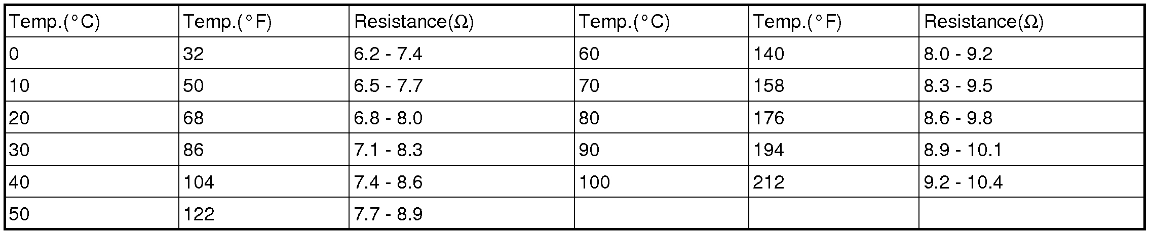

Check Intake Valve Control Solenoid Resistance
1. Ignition " OFF".
2. Disconnect intake valve control solenoid connector.
3. Measure resistance between terminals 1 and 2 of the CVVT oil control valve connector. (Component side)
A. Specification
pic 2
pic 3
4. Is resistance within the specification ?
YES
1) Go to next step as below.
NO
1) Replace the CVVT oil control valve and go to "Verification of Vehicle Repair" procedure.
