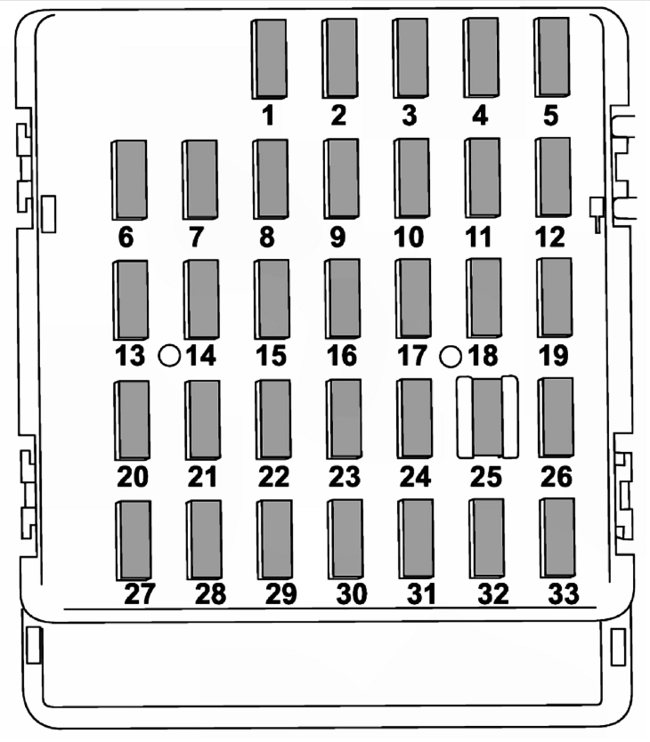

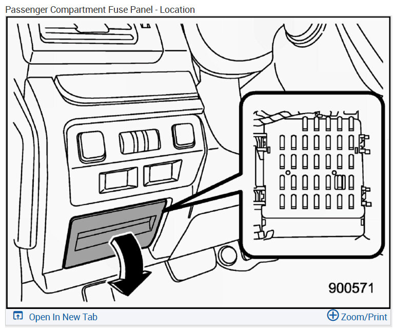

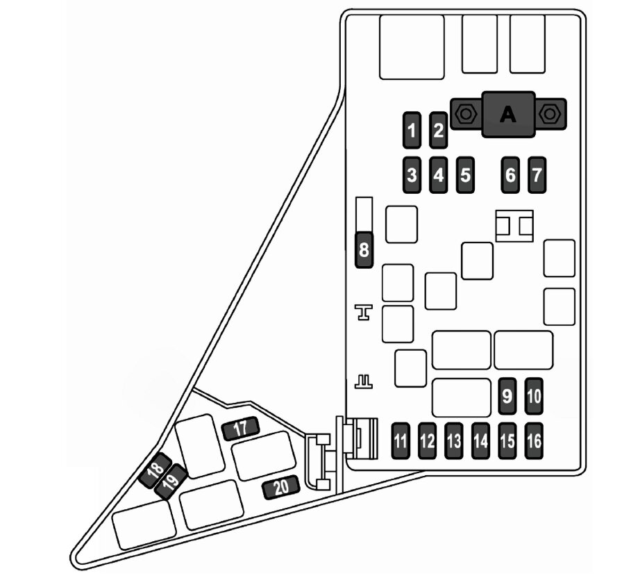

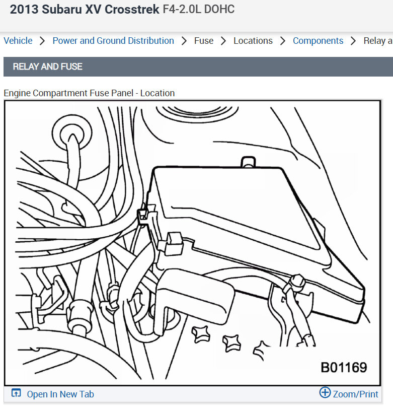

Not all of these can come up at once unless you have many fuses out so, please check those first. Also, has the wiring been messed with?
Here is a guide to help you check the fuses:
Here are the fuse locations. If the fuses are okay, clear all codes and then turn the key on without starting the engine and run the codes again, this will give you the hard codes only. Check out the images (below). Please upload pictures or videos in your response of any problems so we can see what to help you with.
