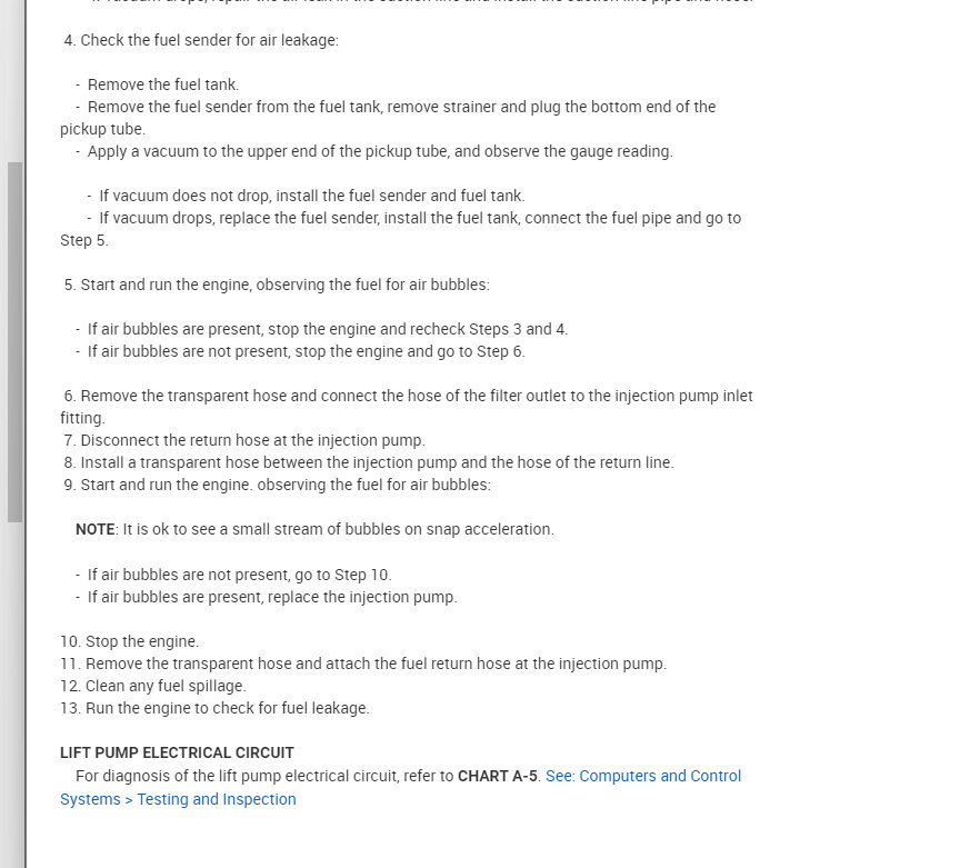

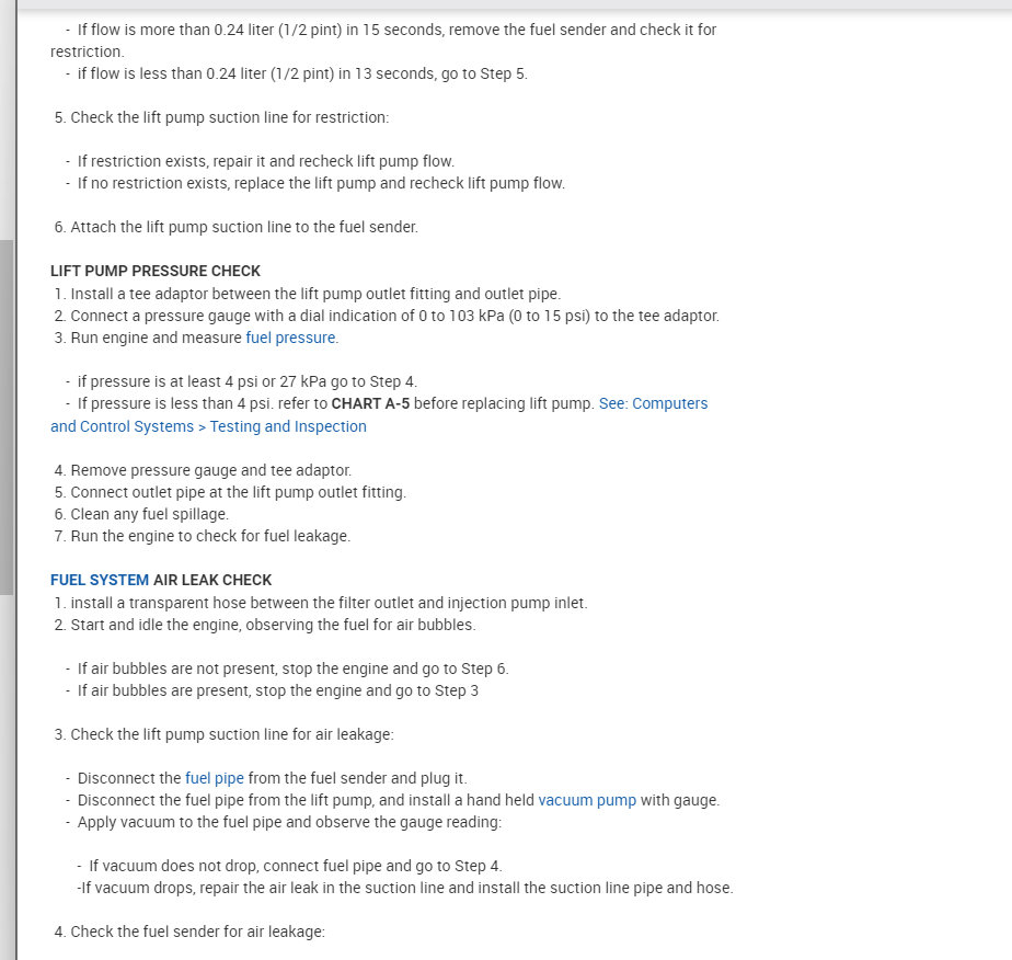

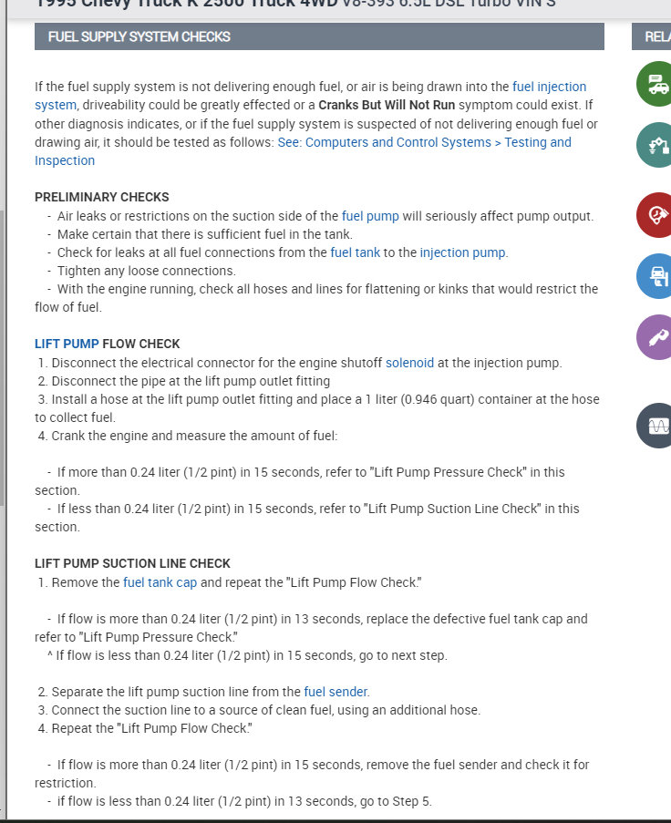

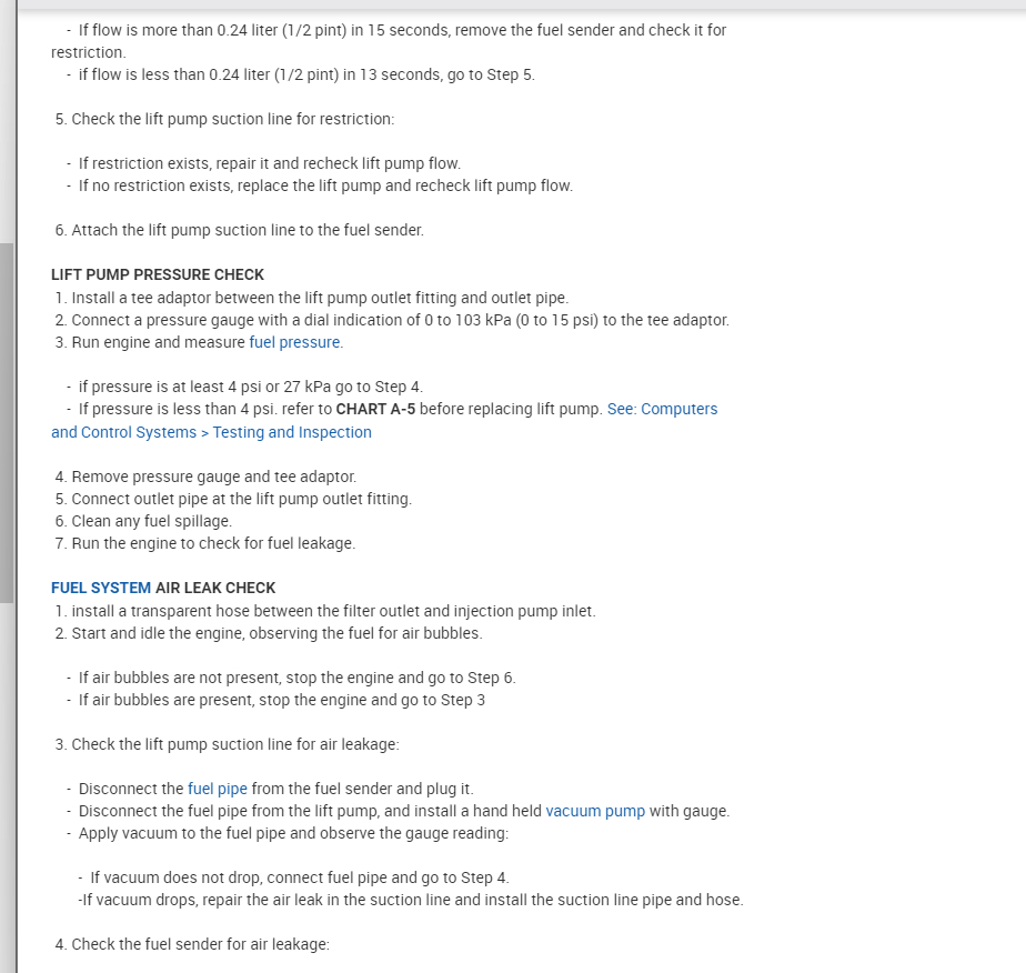

Diesel trucks rely on fuel pressure to start and run so we need to check the fuel flow and pressure.
I am attaching the testing below that we need to run through.
Here is a guide that will help others but your truck being a diesel is slightly different:
The codes are most likely as a result of the engine shutting off and not the cause so the fact that it will turn over but not start points us to a fuel issue.
So, let's start with this and then go from there.
Thanks
