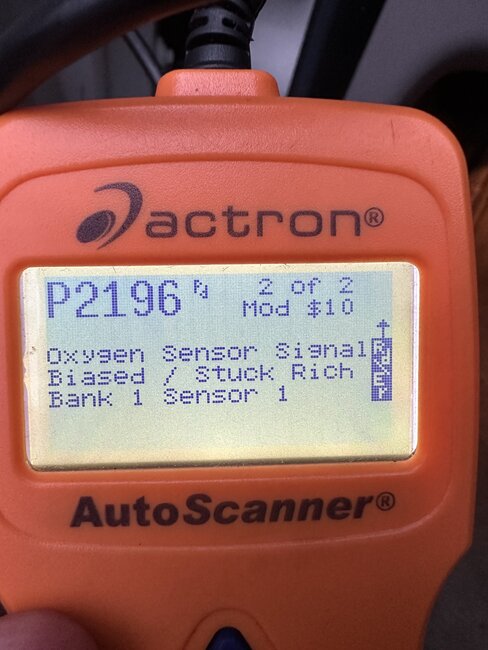

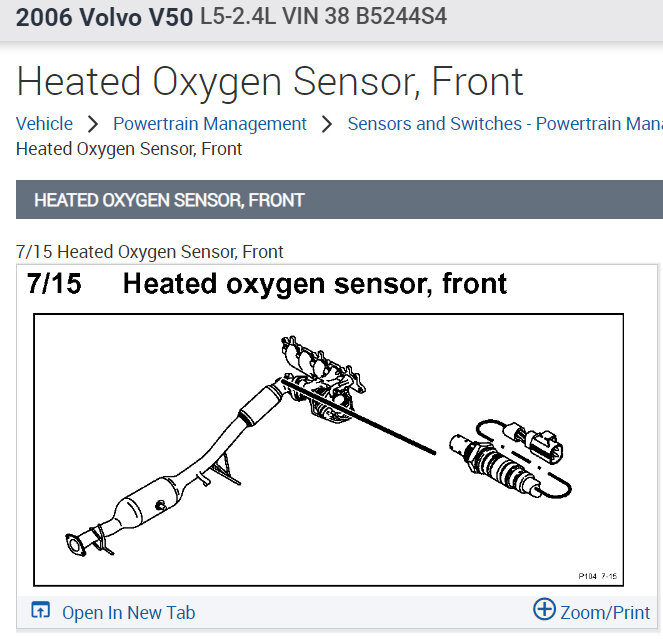

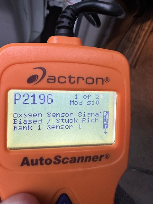

My vehicle listed above T5 is throwing code p2196. The engine seems slightly noisier/rougher at idle than usual also (up under hood and not exhaust). Miles per gallon seems about the same. I have checked air filter and air intake, and they are fine. O2 sensors have never been replaced. Suggestions? Go ahead and replace the front O2 sensor? If so, how is the easiest way to get to it? I have looked down in back of engine and have not seen it yet. Gotta go under car? Thanks for any suggestions/info.

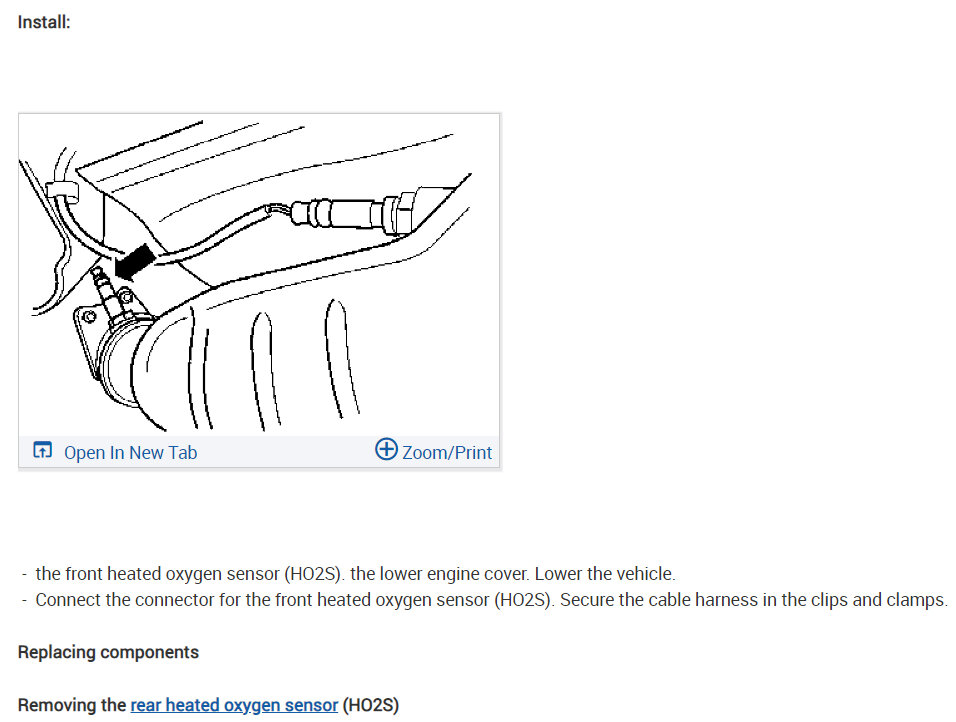

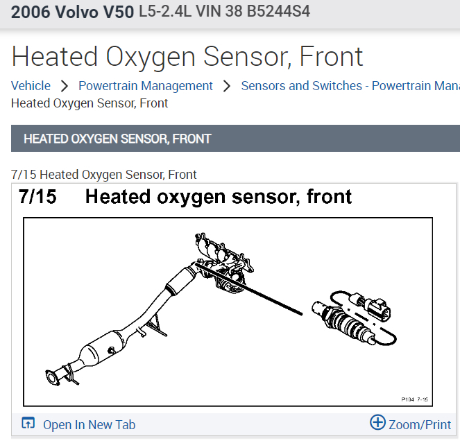

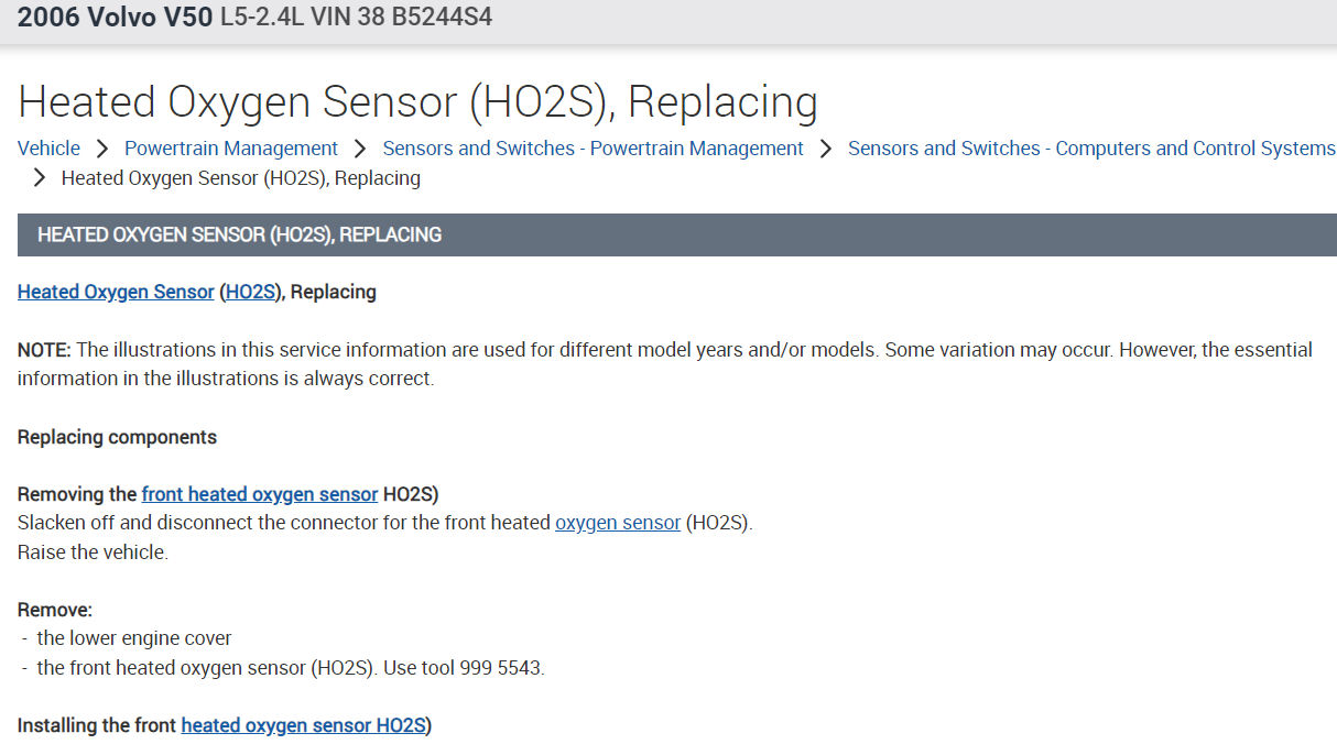

The error code P2196 for a 2006 Volvo V50 indicates "O2 Sensor Signal Stuck Rich (Bank 1 Sensor 1)." If the engine seems to be running okay, then I would swap out the oxygen sensor bank 1 sensor 1. Here is a generic guide to help you step by step with instructions in the diagrams below to show you how on your car:
https://www.2carpros.com/articles/how-to-replace-an-oxygen-sensor

Thanks for the info, Ken. Will be very helpful. I will keep you posted. Meanwhile, after looking at air intake again, I did find that the intake pipe was not connected together properly. I corrected that, cleared the code with my code reader, and went for a 25 mile test drive. The code did not yet reappear. Perhaps reduced air flow was causing overly rich fuel/air ratio and causing the code. I am going to drive the car some more and see what happens. I will keep you posted.
