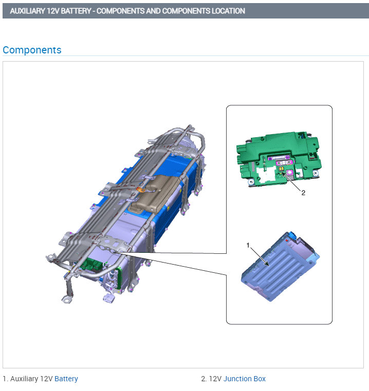

Can you tell me what/where to connect the trickle charger up to? I don't see a positive or negative battery pole under the hood.

The trickle charger needs to be attached to the 12V starting battery. It should be located in the trunk. Since this is a 2022 Alldata does not have the diagrams available just yet. If you refer to your owner's manual it should show you the location.

Actually, from what I read online and talked to other people the battery is under the seat and "part of" the hybrid battery so not easy to get to. I was just hoping you had more current info.

I was able to find the diagram of the battery. And yes, as you stated it is part of the hybrid battery system and yes you cannot put a trickle charger on it.
You might want to contact your local Hyundai dealer and see if they have any trick or suggestion for this new type of Hybrid.
