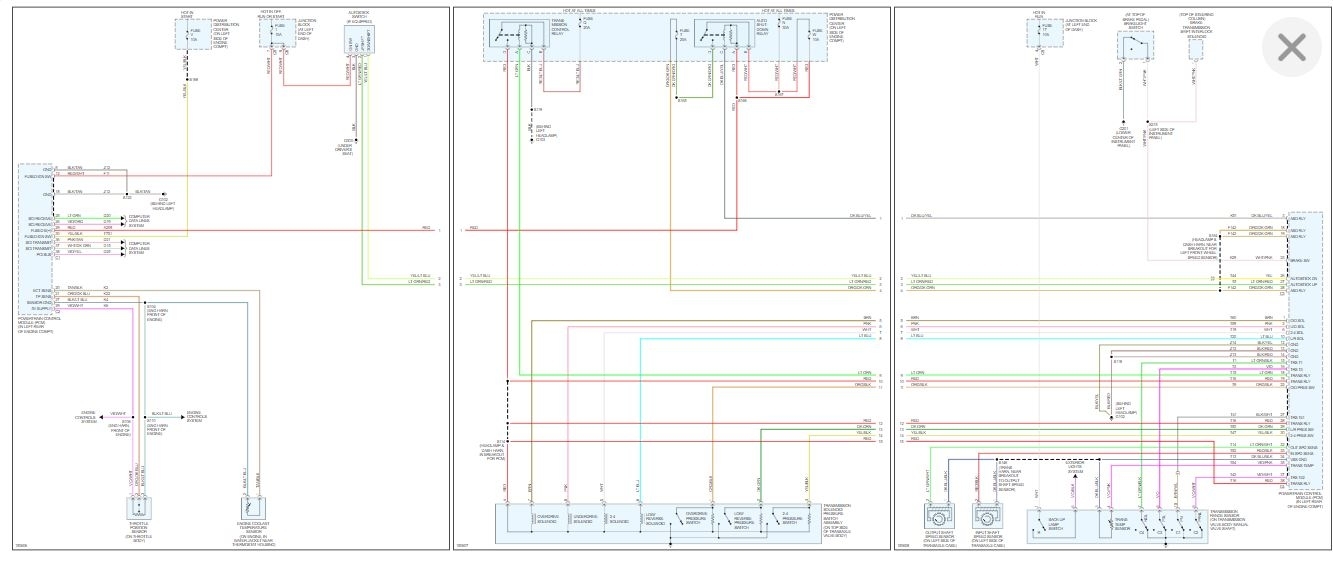

When I'm driving, and go to slow down it chunks and wont let me in 4th. I rest the computer. And it didn't do it again for maybe an hour. But as soon as the check engine light comes back one it starts doing it again. I had a guy I know who is a mechanic tell me that Chrysler is real bad about there ground wires messing up. And about have of the codes are for low voltage. Is it possible for that to make theses codes pop. The codes are po736, po841, p1776, po300, po700,. Thanks

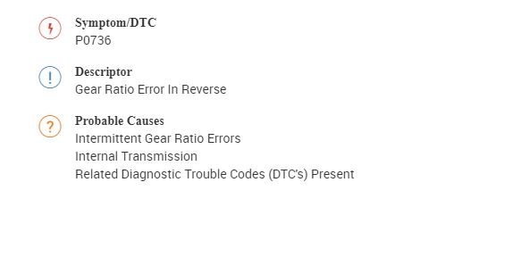

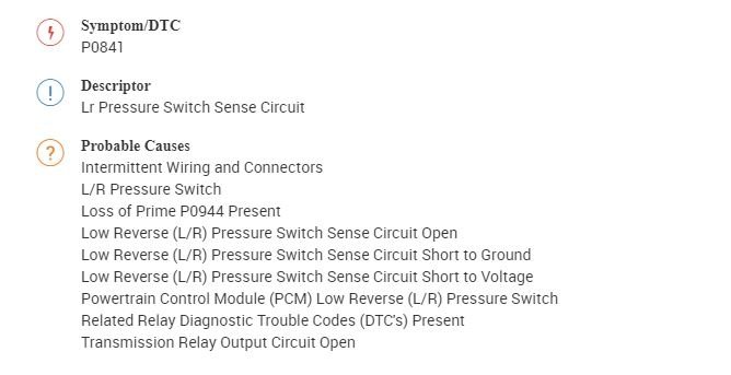

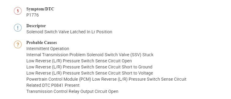

Good morning,
I attached possibilities for you. The gear ratio concerns me. That is an indication of slipping internally.
There are codes for electrical but they need to be tested.
My opinion is it could be the valve body.
I would start by changing the fluid and filter and see if that helps. It could be a sticking valve.
