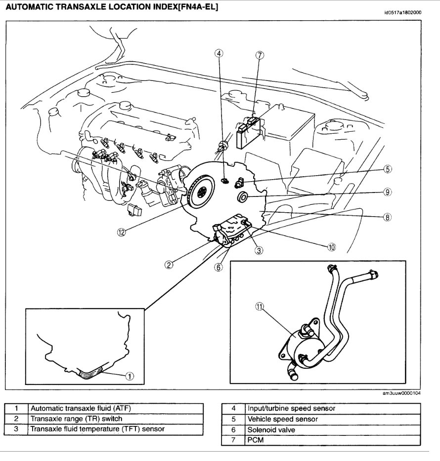

The p0715 is what I would concentrate on first because this can cause the entire issue which is the turbine shaft speed sensor. Here is the location and a video so you can see what you are in for when doing the job:
https://youtu.be/f3bETtCIdxM
Here is the location of the turbine shaft sensor for your car. Check out the diagrams (below). Please let us know what happens. Make sure to clear the codes after you change the sensor out.

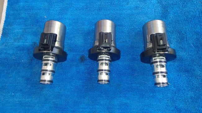

What is the range of ohms in the shifting solenoids to test if they are in range for my Mazda 3 2006 2.0l. How do I test if the solenoids are working properly out of the test in ohms? I take out of the valve body, how do I test them and what can I spect in the test? Thanks.
Jul 4, 2018 at 1:35 AM
  • 55,433 POSTS
They are a simply sonilond apply 12 volts and ground and you should hear them work. Either polarity.
Jul 4, 2018 at 8:27 AM
MONCHO6685
  • 118 POSTS
I need new shifting solenoids. I do it. Non of it make anything. I think I have a big problem. Thank you Ken. I am going to buy the set (6).
Jul 4, 2018 at 9:18 AM
  • 55,433 POSTS
It will be weird if all of them are out so you put 12 volts and they do nothing? Sometimes it is a little tick can you put your ear near them when you try it?
Jul 5, 2018 at 3:58 AM
MONCHO6685
  • 118 POSTS
Yes is weird, but truth Ken. Nothing else to do, Ken? right? Thanks for the help.
