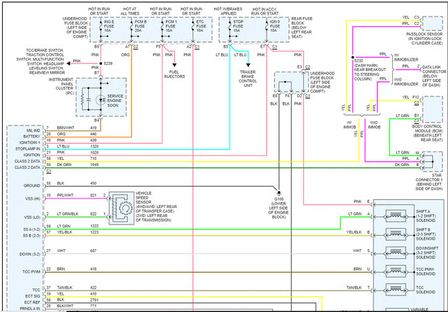

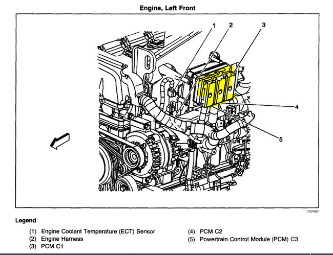

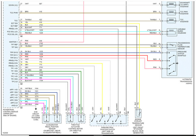

The transmission is controlled by the powertrain control module (PCM). It is what communicates with the transmission.
If you look at pics 1 and 2, I included the wiring schematic for the circuit. Pic 3 shows the PCM location.
Based on what you described, you should have a code. Are you scanning the can-bus system? Here is a link showing how to do what I'm asking:
Also, based on your description, I'm thinking it is a line pressure issue. Does the vehicle have a remote transmission cooler or is it part of the radiator?

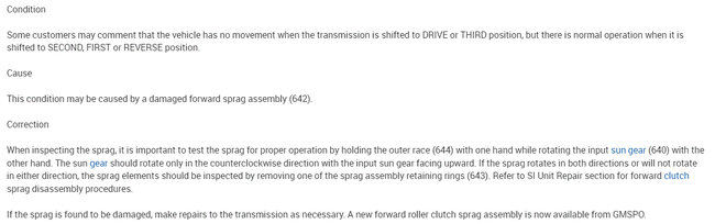

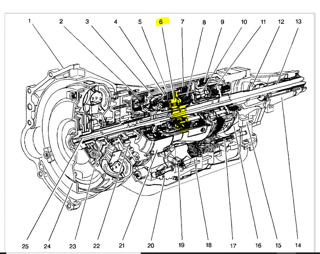

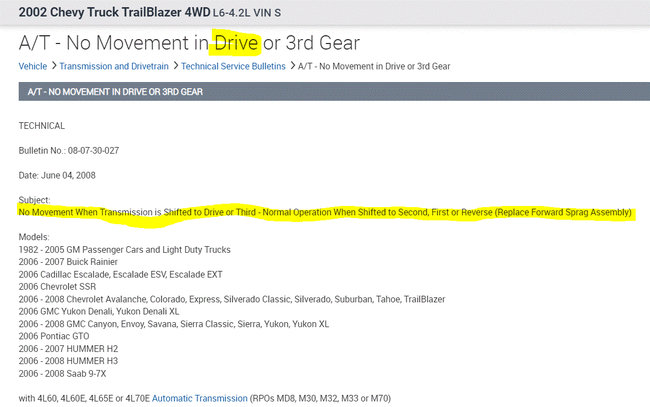

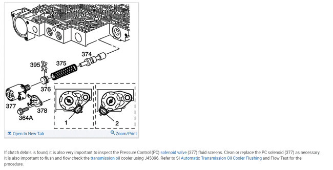

I reread everything, and it clicked for me. Back in 2008, there was a technical service bulletin on this issue. The forward sprag gear assembly would fail causing no movement in drive. Sorry it took a while to remember, but this was a long time ago.
Now that we know what the likely cause is, I have to tell you the bad. This is an internal component in the transmission. If you look below, I highlighted its location in pic 1. It requires the removal and disassembly of the transmission to access the component. Is that something you are comfortable doing? I would be happy to supply the rebuild directions for you. It doesn't require a full rebuild, but the disassembly and reassembly are included in the directions, so let me know.
Also, starting at pic 2 below, I provided the original technical service bulletin. Note that it says normal operation in reverse, and you have a hard shift. This is likely the result of debris getting into the pressure solenoid or other components.
Let me know if this helps or what I can do to help.

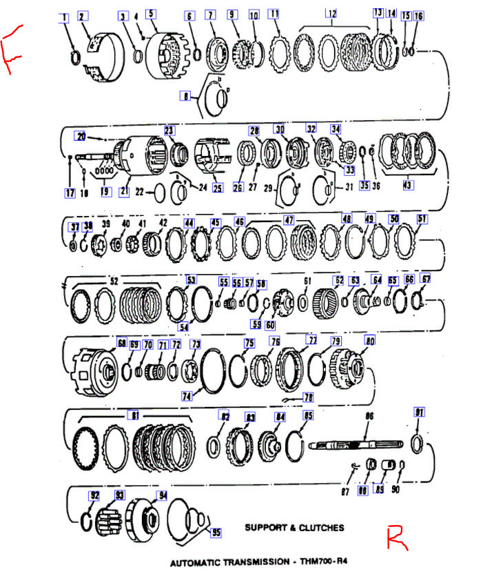

Does the TSB mirror what you have experienced? If so, then the transmission needs to be removed and inspected. I would suggest testing first. The test for the sprag gear is listed in the TSB above. Let me know if you are comfortable doing that.
I was certain the manual had directions A-Z for a rebuild, but I was wrong. Since you are a mechanic, I should be able to walk you through it.

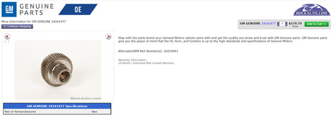

If you look below, I attached the exploded view of the internal components. Use that as a guide. Pic 2 shows the part I feel has failed. I attached a pic from Rockauto.
As far as gaskets, filters, and so on, Rockauto has a rebuild kit for under $40.00. However, before I recommend getting it so you can have all the seals and gaskets, I need to know which of these RPO's is related to your vehicle.
(RPOs MD8, M30, M32, M33 or M70) This will help me identify the specifics for your transmission. The RPO list will be either in the glove box or where the spare is.
Let me know what I can do to help. Also, let me know if you can complete the test listed in the TSB.
