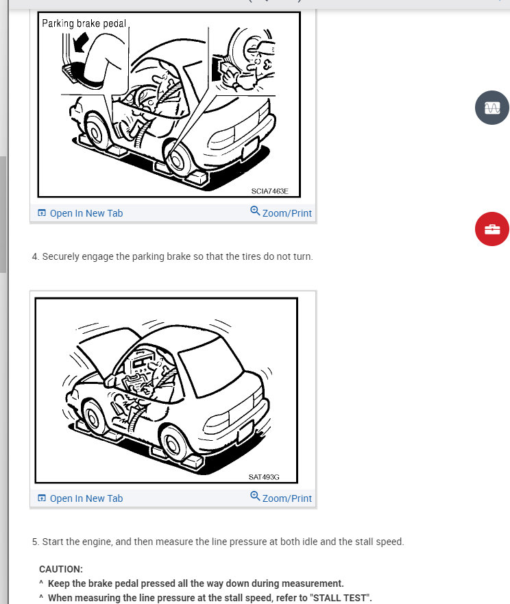

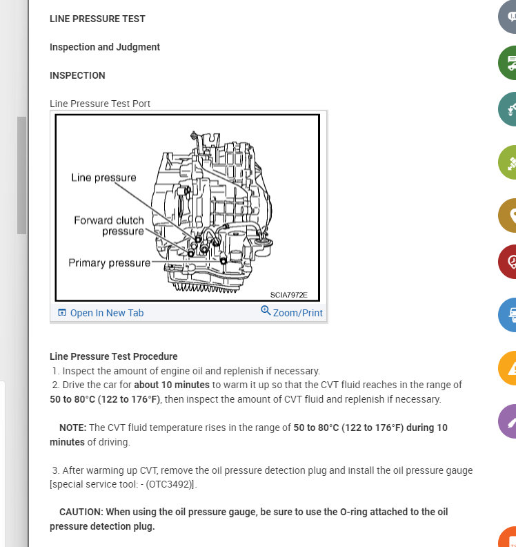

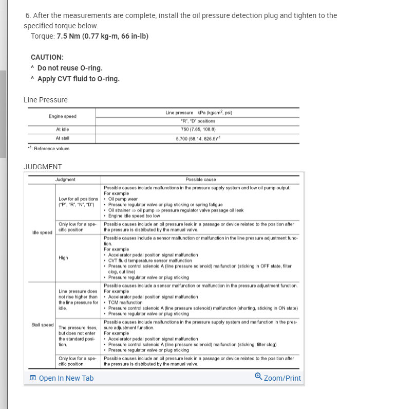

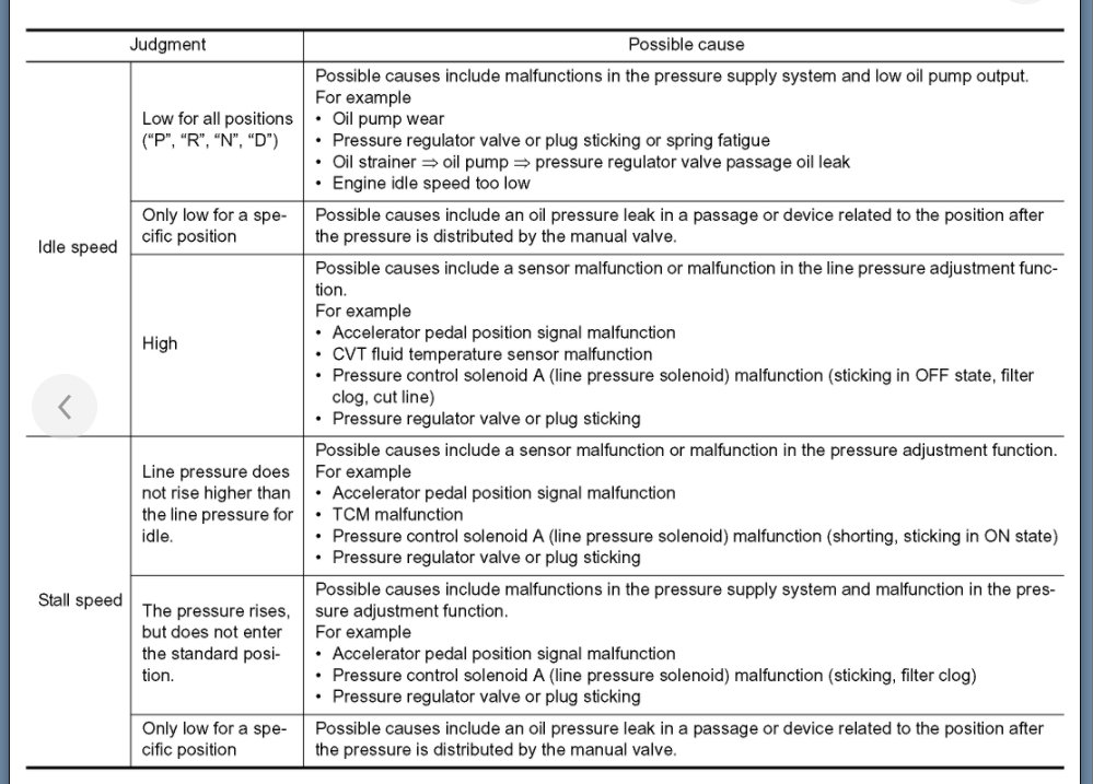

This could be a solenoid issue but more than likely this is a TCM issue.
However, we want to check and make sure the code is still the same.
Here is a guide that will help with this:
I am attaching the info below on the testing that we need to run through and the way to perform the line pressure test.
Please run through this and let us know what questions you have on this, and we can go from there. Thanks
