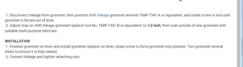

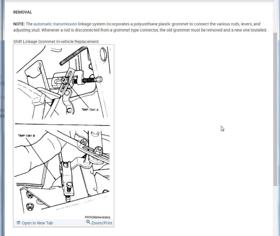

My transmission won't shift into reverse or neutral but will shift into drive and park. What could it be?

More then likely you have a shifter that is out of adjustment or damaged. Basically there is a linkage that connects the shift arm in the truck to the shifter on the side of the transmission. When this gets out of adjustment or damaged it will not put the vehicle in the correct gear. Normally reverse and neutral are the most common to not engage. Drive has a detent that can normally be found even with it is out of adjustment.
I attached the process for replacing the linkage. We need to remove and it make sure it is not damaged and the reinstall following the process so that it gets adjusted correctly.
Let us know what questions you have. Thanks
