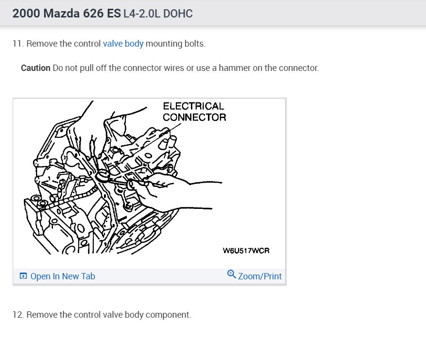

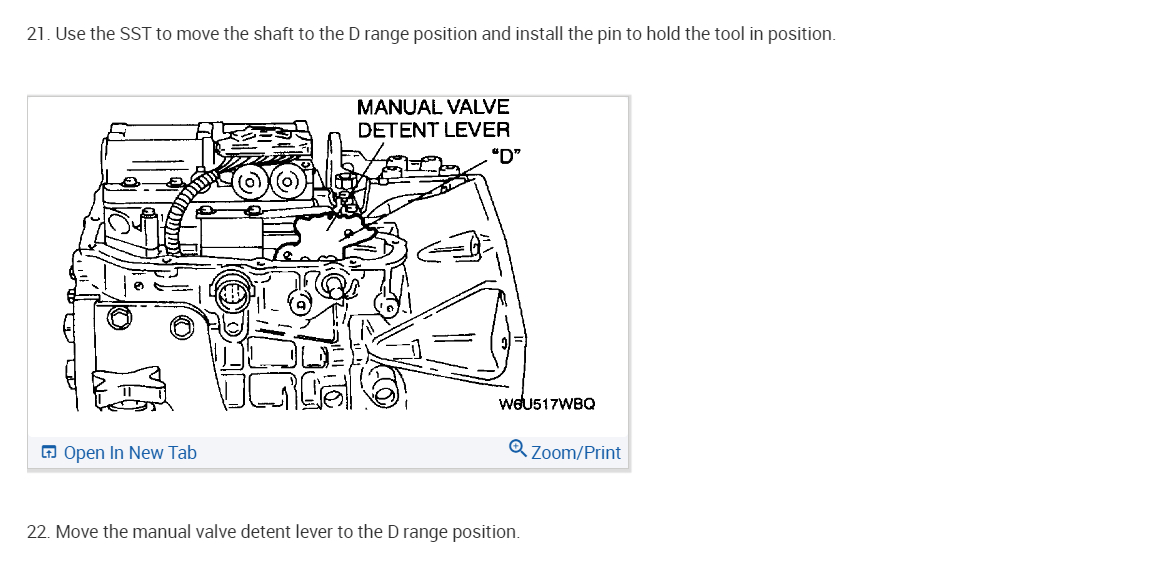

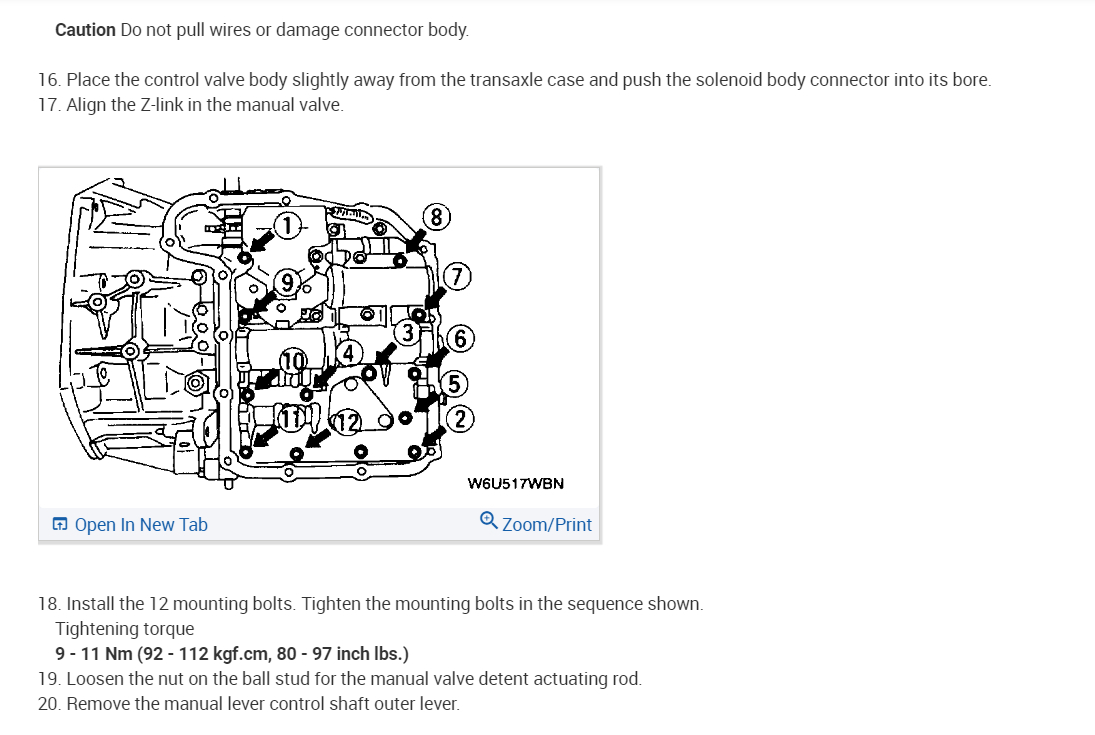

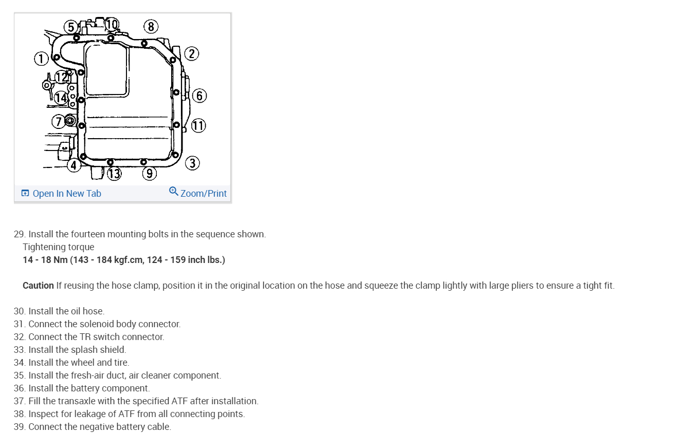

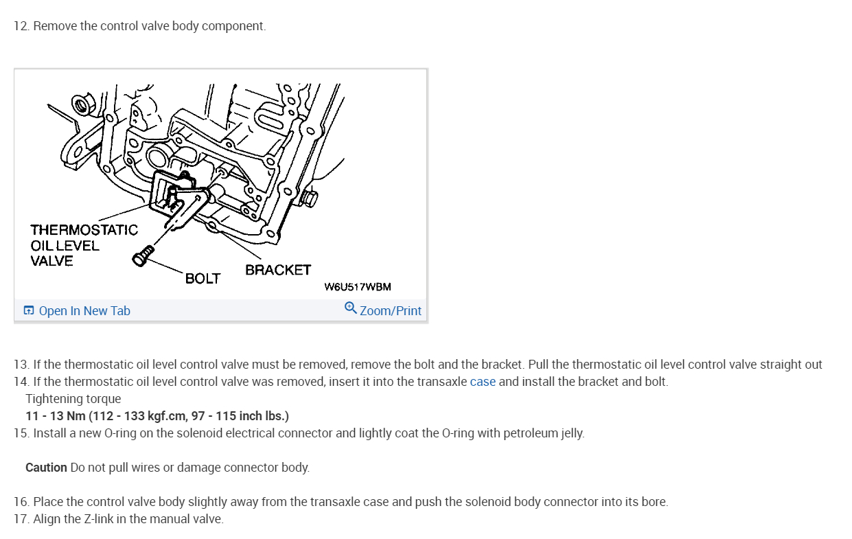

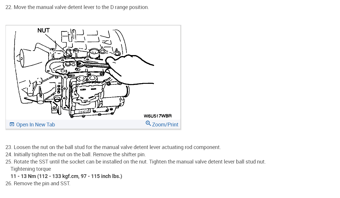

So, either the transmission has had an internal problem or the PCM has gone out. Can you check the fluid condition? This guide can help. It could be the last code causing the first two so I would try a rebuilt valve body
https://www.2carpros.com/articles/how-to-check-and-add-transmission-fluid

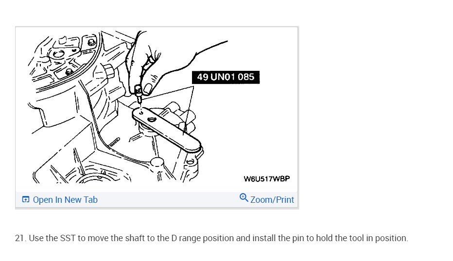

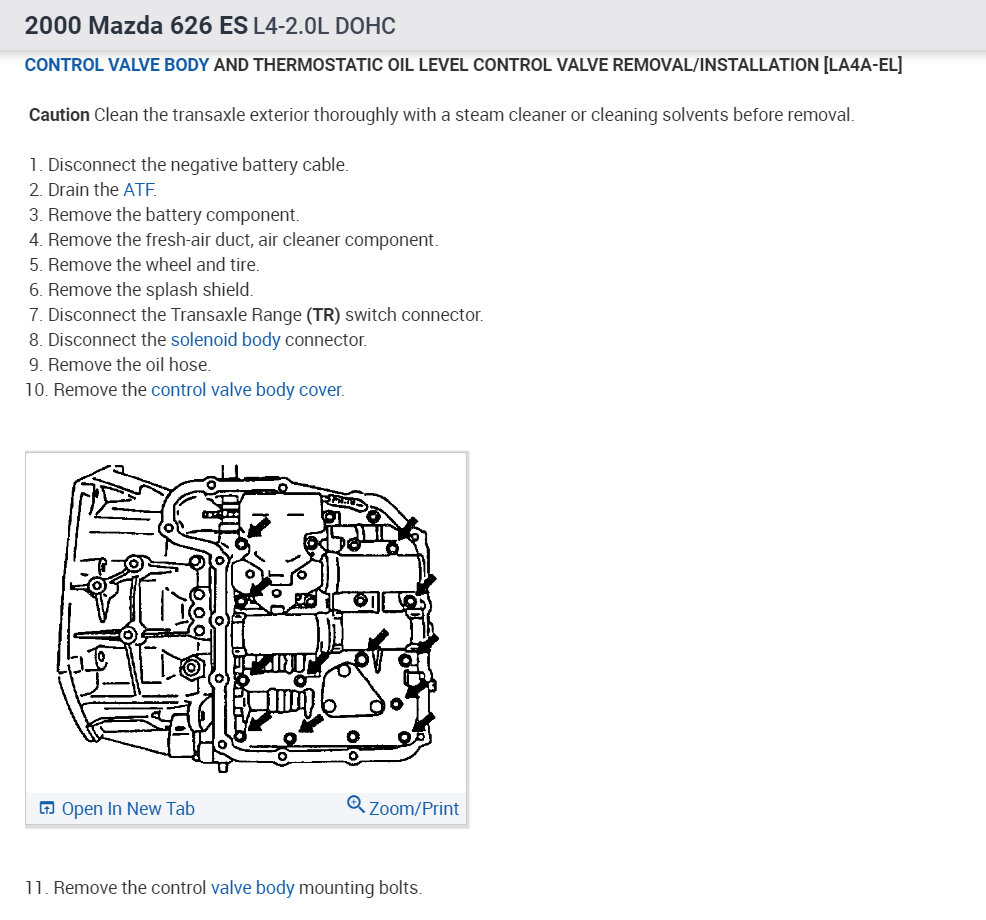

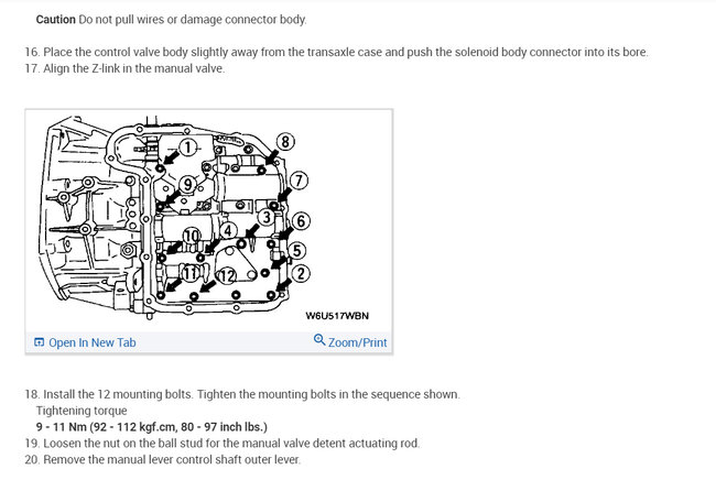

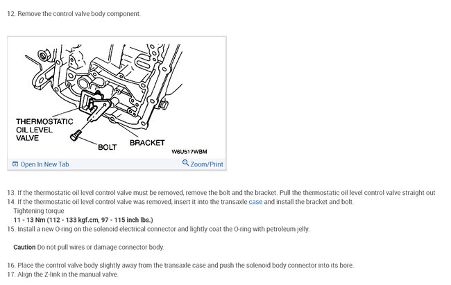

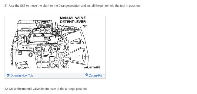

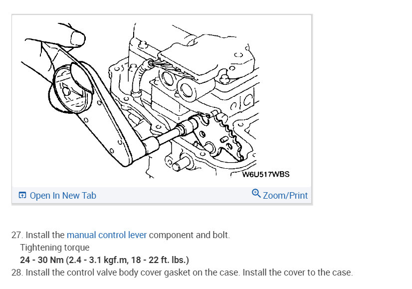

Here is how to change out the valve body below.
