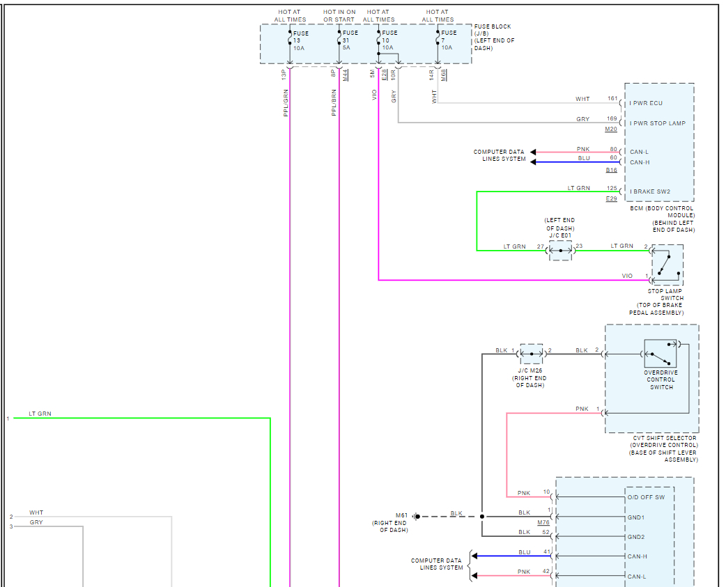

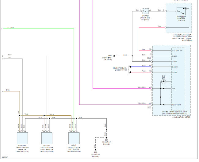

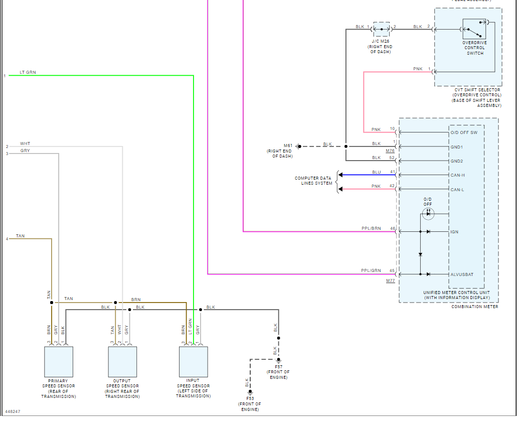

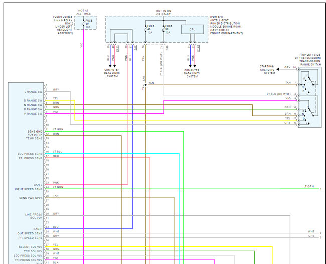

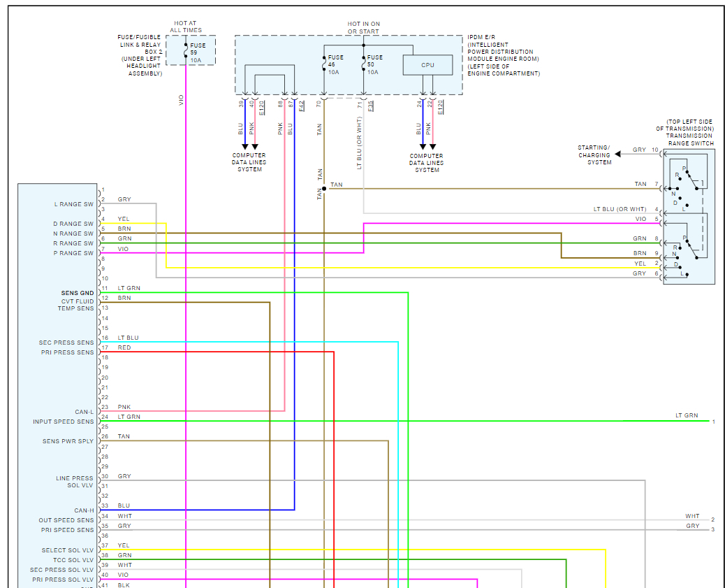

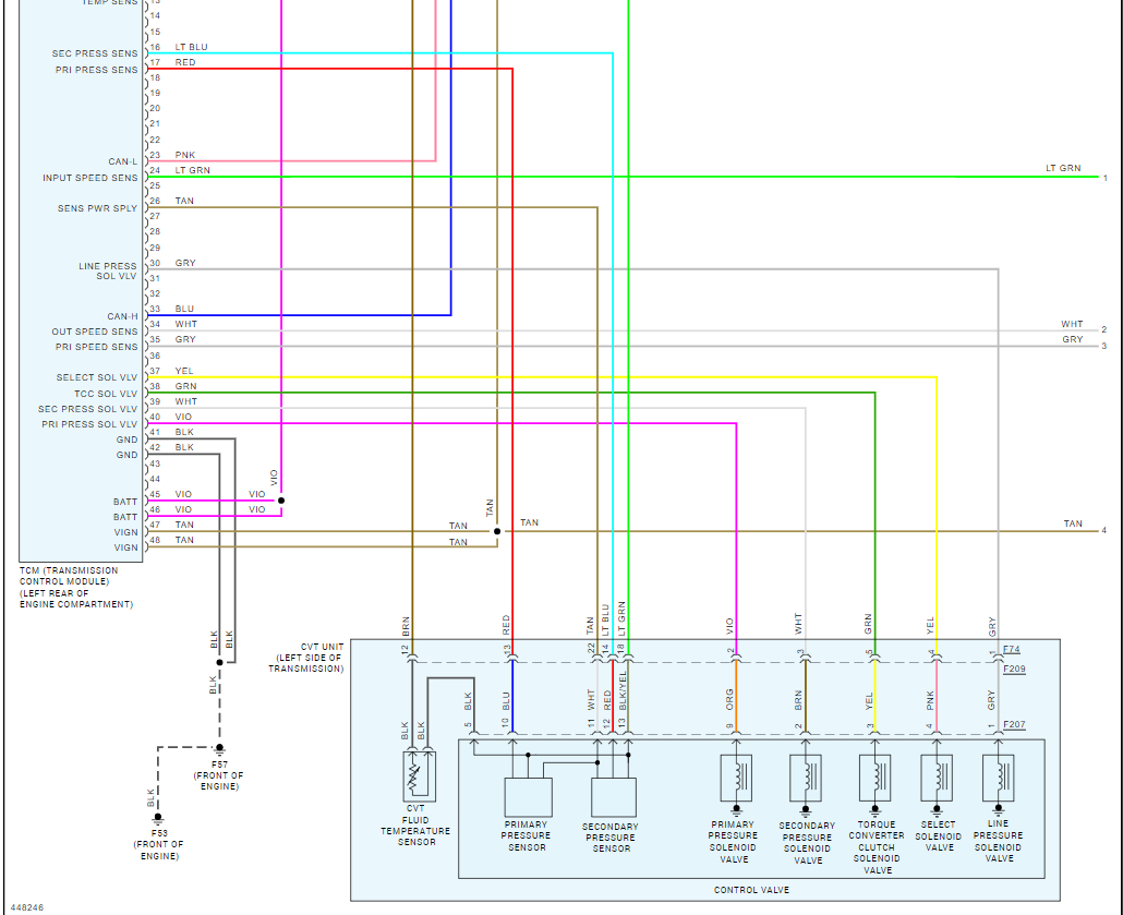

Transmission was replaced on this vehicle fault code P0890, P0847, and P084C, can I get the TCM connector view, TCM wire diagram and fuse box diagram for this vehicle?
2014 NISSAN X-TRAIL
56,067 MILES • 2.5L • 4 CYL • 4WD • AUTOMATIC
MALLYBOY
  • 329 POSTS
Transmission was replaced on this vehicle, and it was not driving fine. Then i began to access the fault p0890: transmission control module using test lamp and i notice that there was no battery voltage to illuminate the test lamp on the TCM connector but there was ignition, so i have checked the fuse location that powers the TCM battery voltage line but i didn't see. I also used diagrams for a 2013 Nissan Rogue fuse box diagram, but they are not the same.
Please i need the TCM connector view, TCM wire diagram and fuse box diagram for this vehicle for me to solve this problem
Dec 17, 2023 at 4:03 PM
  • 55,423 POSTS
P0890: This code indicates an issue with the Transmission Control Module (TCM)
P0847: This code signifies a problem in the transmission fluid pressure sensor/switch "B" circuit, pointing to a low circuit condition in this system.
P084C: This code generally denotes an electrical issue within the transmission fluid pressure sensor (TFPS) sensor circuit.
Below are the transmission wiring diagrams for further reference. Please keep us updated on the developments.
