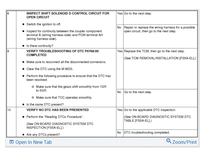

The TCM was replaced a year ago, the car still shifted roughly and then the AT light came on and it was the shift solenoid d stuck in off position. We had that replaced and now it says it is stuck in the on position and it still shifts hard. After they replaced it, it was pulling the solenoid d stuck in on and ECM issue (I can't remember right off) and it doesn't want to go into the passing gear. It will drive fine then randomly the AT light pops on and it goes into limp mode. What could be the issue? I don't want to replace the transmission and it be the ECM and still have issues.

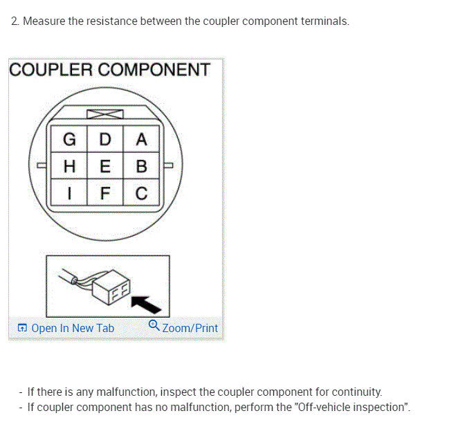

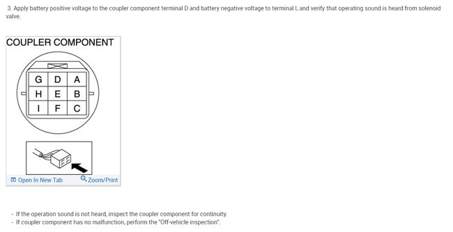

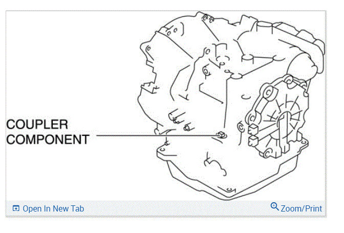

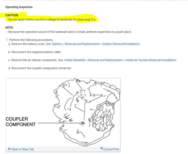

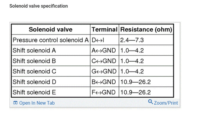

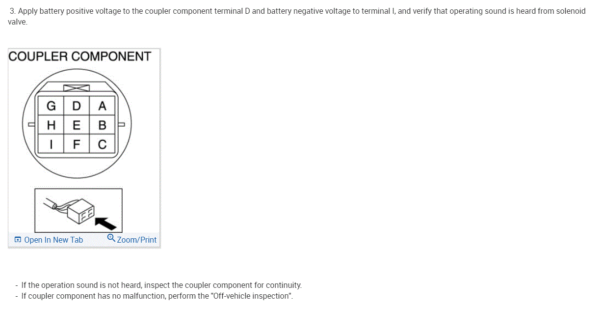

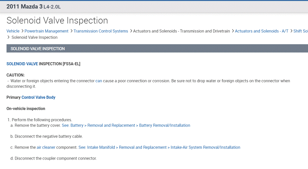

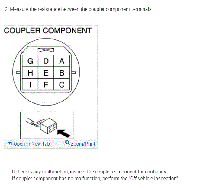

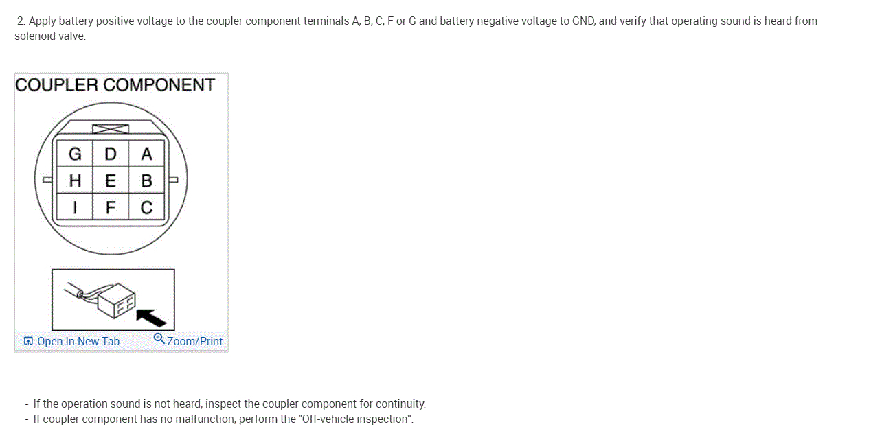

Were they able to provide you with a diagnostic trouble code for the solenoid issue? I ask because this sounds like it could be related to a wiring issue and not the solenoid. A specific code would point me in the right direction.

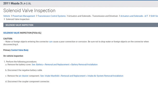

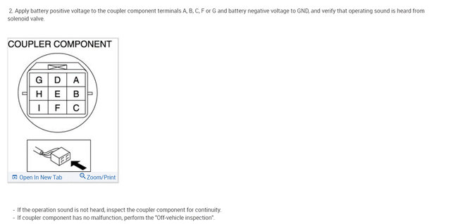

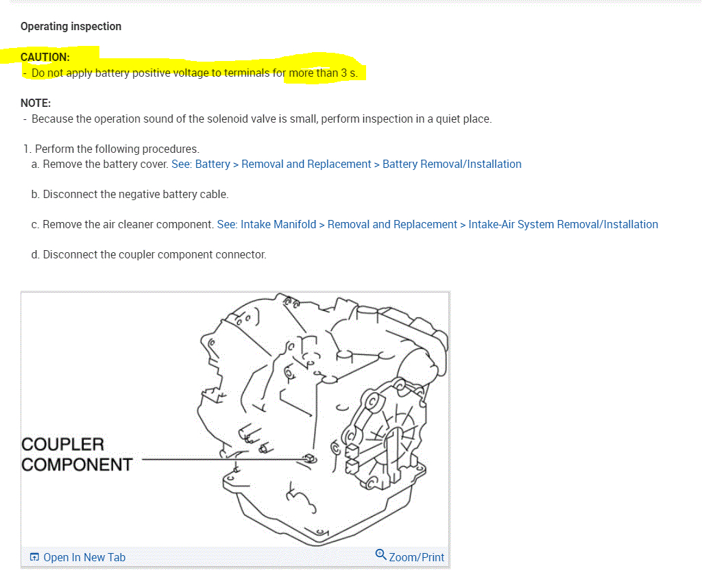

As far as the solenoid, it can be tested without removing the component. I have provided the diagnostics below for testing. Take a look through them and let me know if it is something you are comfortable performing. Also, here is a link you may find helpful

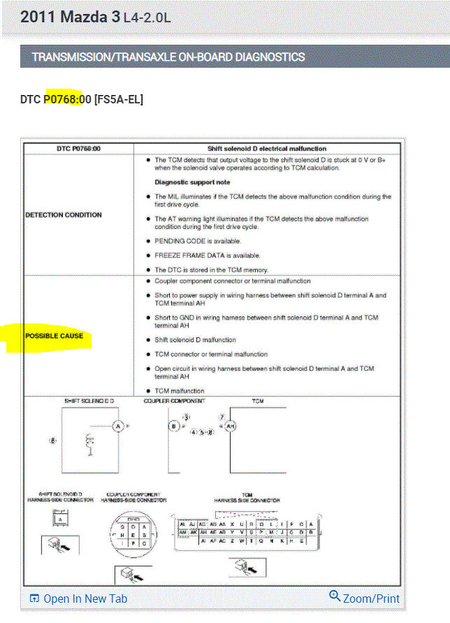

So the codes it is pulling are P0768- shift solenoid D electrical and P0773 TCM shift solenoid valve E on or off. And it has P0134 O2 sensor... That one has been on.

The O2 sensor isn't related which I believe you are aware of. The problem doesn't appear to be a mechanical issue related to the transmission. Instead, either there is a short to power for solenoid D or there is no power, open circuit. To me, it seems there is a wiring issue. The P0773 for valve E is the same. Has anyone inspected the connection at the TCM or at the transmission? I suspect that is where the issue is and not the transmission itself.

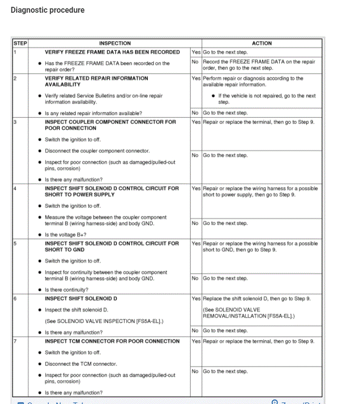

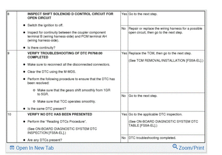

Yes, there is a possibility that one or more of the pins in the connector are bent, damaged, corroded, and causing a short. The idea that it is stuck on leads me to believe there is a short to power.
I attached the diagnostics for code P0768. Take a look through them. Note that the tests all include checking voltage signals (electrical concerns).
Let me know if this is something you would feel comfortable doing. I can try to help from here if you have questions.
