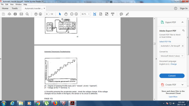

When I checked the following test, my TT and E1 terminal voltage increases up to eight steps but voltage is the problem. Here unlike in this graph voltage does not increase in 1V division but a value between 0.1 to 0.4 V division.
I checked the TPS, TPS values are within the range.
May I know the reason of this problem? Highly appreciate your knowledge.
