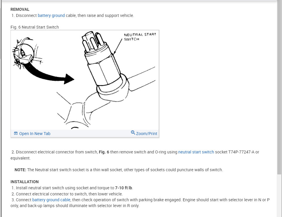

My truck listed above has a 4r55e transmission that slips and lurches on deceleration around 55-60 MPH. I found a used transmission in a 2001 Ranger 4.0 engine, either a 5r44e or 5r55e. can I swap these out and if so, do I have to change the bell housing or any wiring?
Feb 28, 2022 at 11:32 AM
Yes. There are many people that have done this over the years, and it does work but you may run into one-off issues based on the unit that you are getting. Clearly, we don't know the condition of the unit that you are getting, and I am not sure I have seen it done with that year's transmission.
I would suggest trying to find a 95-96 trans as I am sure the only thing that you need to swap is the neutral safety switch.
So, I am attaching that info below. Please let me know what questions you have on this and how you make out.

Thanks for the reply, but how is this a neutral safety switch? It only does it on deceleration and around the time that it should be dropping into 2nd gear...I have had it looked over by a transmission shop and was told that it needs to be rebuilt. If it's just a neutral switch that's easy to find online, and cheaper than a replacement or rebuild...but I want to be sure...thanks
Mar 1, 2022 at 5:22 PM
Sorry for the confusion. You originally asked if you could swap this transmission for your vehicle's. I informed you that you could, but you may have to swap the neutral safety switch as I think they are different so the other will not plug into your harness.
If you are looking to repair this issue, we can help with that, but I was only addressing the ability to swap the units.
