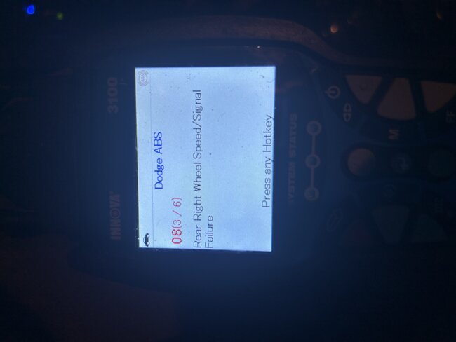

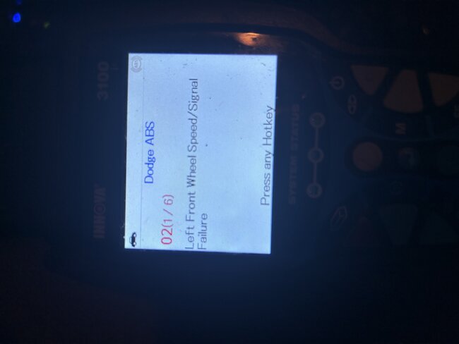

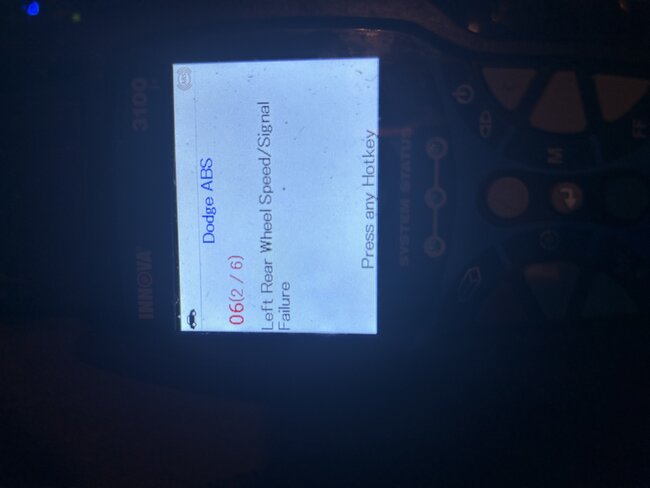

Also have ABS code errors telling me all wheel speeds they have a signal failure.

It sounds like this is a sensor-related issue. Could you send me the codes that you are getting for the wheel speed sensors? It may help me figure things out or at least point me in the right direction.

Sorry for the late response. I decided to change the transmission fluid and filter. Also changed both input and output speed sensors. Seemed okay till vehicle warmed up and started having same issues. First with the speedometer being erratic and surging until triggering the check engine light. Again, giving me codes P1790 and P0720. My ABS light has always been on since I’ve owned the vehicle. I’ve been told the previous owner had the wrong size tires on it, but I’ve been driving for over a year without a problem till now. I had a couple other ABS codes, but they disappeared on the last reading.

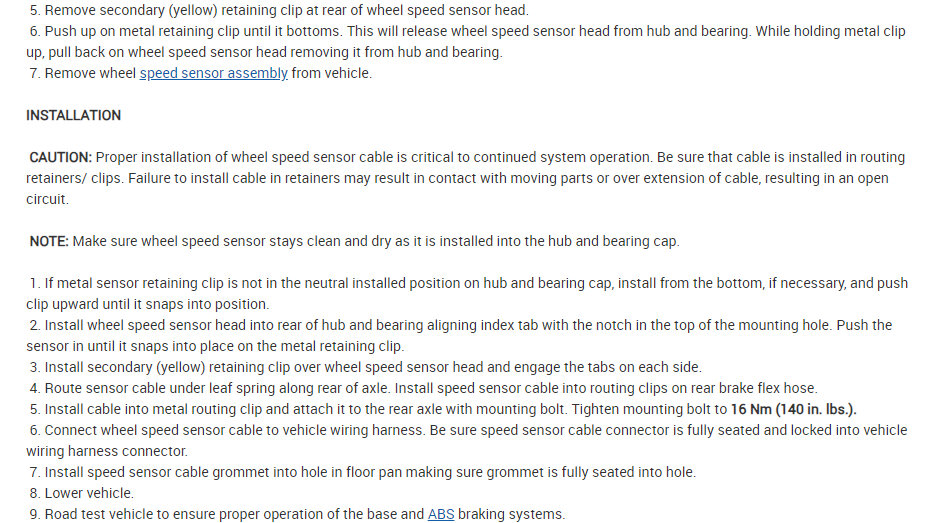

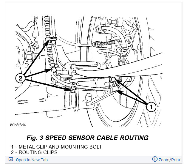

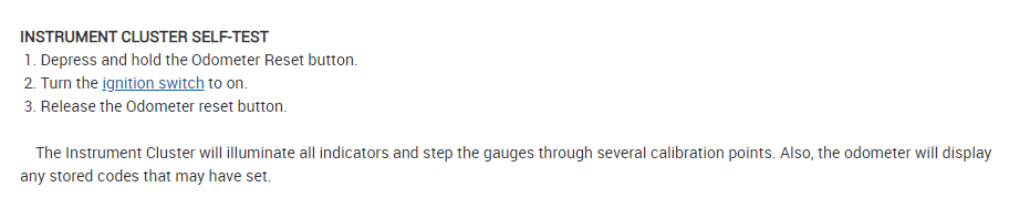

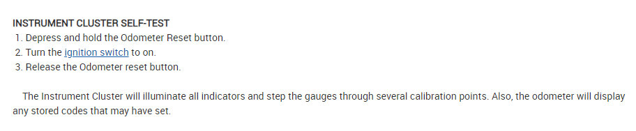

Did you inspect or replace the wheel speed sensors that are indicated? Also, try resetting the cluster to see if that changes anything. I attached the directions below.
See pic below.
Nov 26, 2023 at 4:35 PM
DOT2DOT
Hi Joe,
I reset the cluster and no change. I’m currently waiting for my order for the wheel speed sensors. I’ll let you know how things turn out once installed. Thanks again.

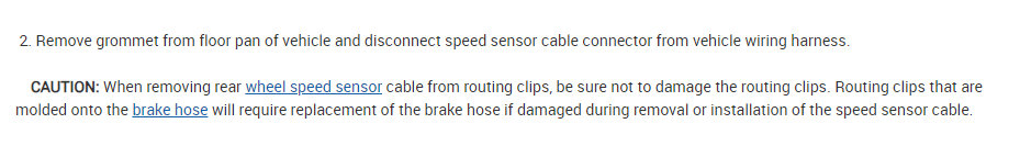

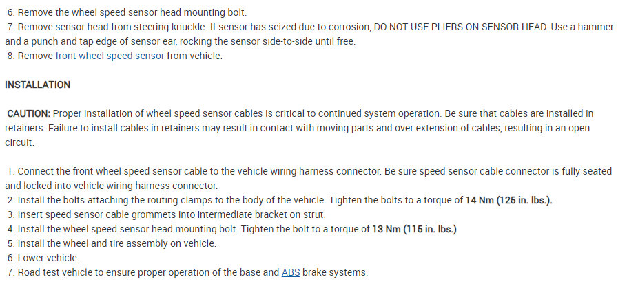

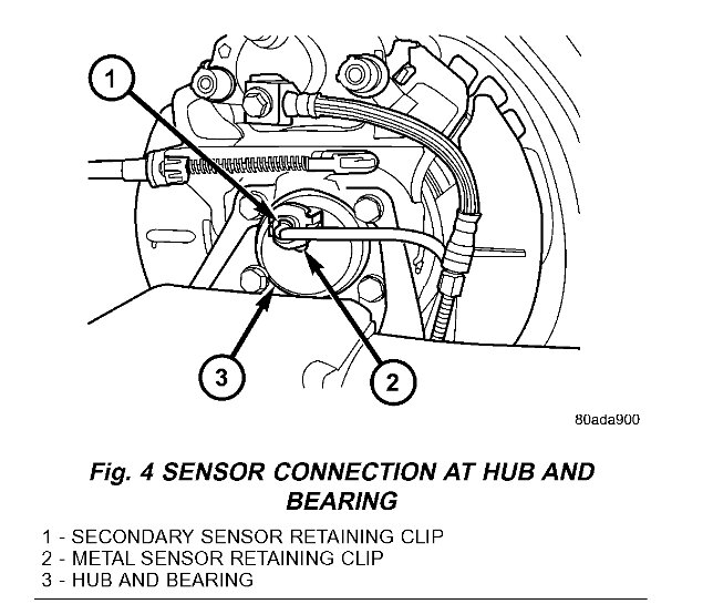

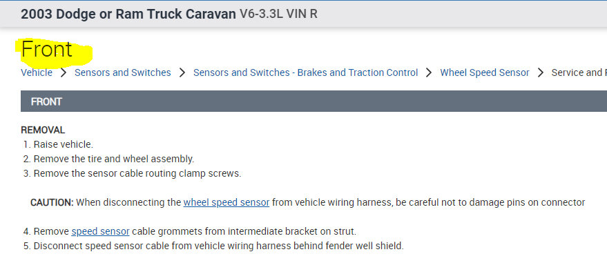

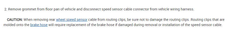

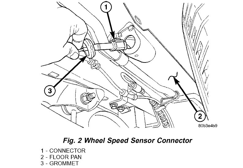

As far as the wheel speed sensors are concerned, here is a link that explains in general how it's done. I don't know if you need it, but thought I would add it. If you have any specific questions, let me know.
https://www.2carpros.com/articles/how-to-replace-an-abs-wheel-speed-sensor

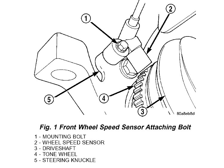

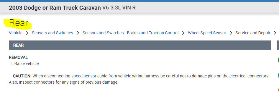

I also attached the manufacturer's directions below. When you remove the original ones, chances are they will be corroded and difficult to remove. Take your time. If you have penetrating fluid, you may want to start spraying them down now, so it has a chance to work.
Make sure you don't pry the sensor on an angle. It will break and then it will be much more difficult to remove. Gently twist it back and forth once it starts to move, then while twisting it, gently pull it outward.
Let me know how things turn out for you.
