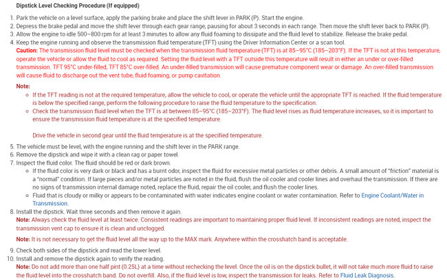

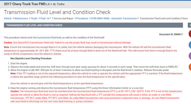

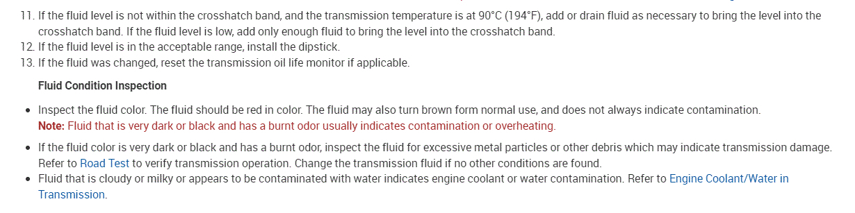

I'm not sure how the transmission shifting as described is caused by spark plugs.
Have you checked the transmission fluid level and condition? It sounds as if the fluid is low. Also, the spark plugs are iridium, and shouldn't be bad yet. They are getting close, but I believe GM indicates changing them at 100,000.
I attached the directions for checking the transmission fluid below. Do this and let me know the results.

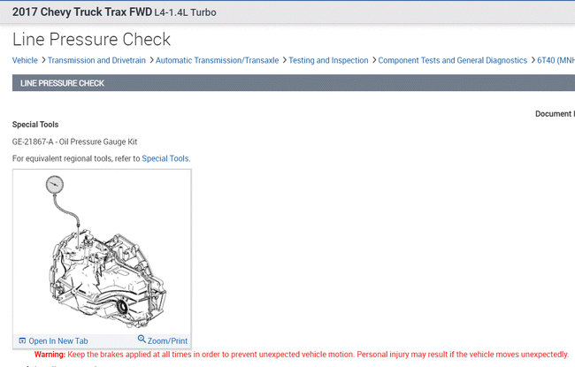

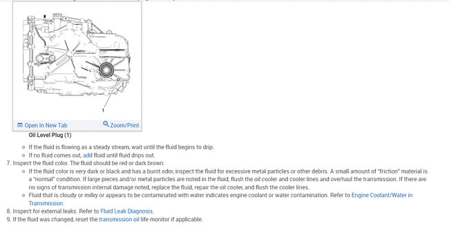

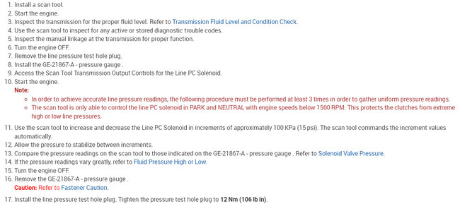

I have to agree with you. Things are changing. Over 41 years in the business, many things have changed and have presented new challenges. However, I never (in 41 years) heard of a transmission issue being caused by spark plugs that are not causing a misfire. Actually, even if they were causing a misfire, I don't see how it would cause this.
Based on the description and symptoms, I suspect it has something to do with transmission line pressure. In the transmission, there is a transmission fluid pressure switch, pressure solenoid, and several other electrical components.
Not being there does make it a bit more difficult, but based on the delayed engagement, the first thing I would check would be line pressure. If it is low, it would cause delayed engagement and delayed shifts.
If you want to see what's involved, I attached the diagnostics below for your review.
Let me know what I can do to help.
