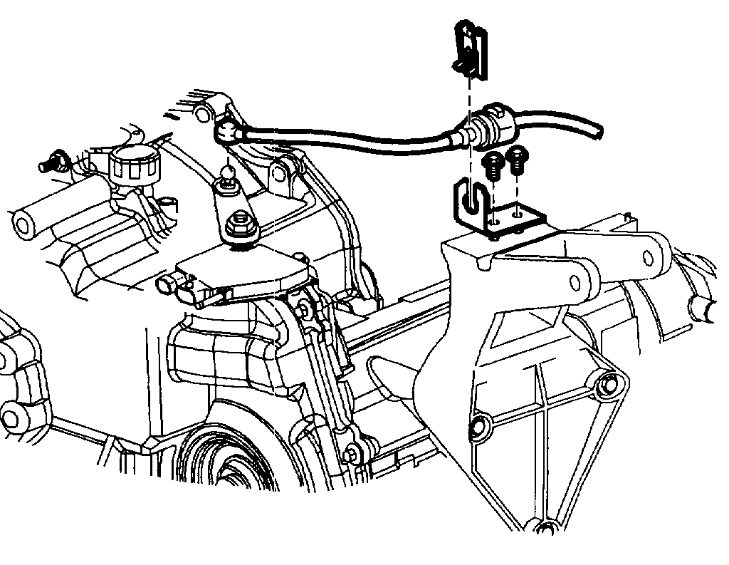

Just finished replacing the catalytic converter, repairing a leaking transmission line (and adding fluid). when we went to move the car it started great, shifted into reverse, and the shifter froze. It will not move out of reverse. But we can take the ignition key in and out of the ignition.
Can you tell me where the "bypass" button is located?
Then, can you give me your best ideas on the problem?
Thanks,
Jon
Feb 27, 2019 at 12:42 AM
  • 110,244 POSTS
First, if you were able to shift to reverse, then it most likely has nothing to do with the park lock solenoid. With that being said, the first thing I need you to check is the shift cable which attaches at the range sensor on the transmission. I have a feeling that something is blocking the cable from shifting the transmission. You did a lot of work on the vehicle, and my first suspect is something is jammed with the cable or at the shift lever.
Take a look at picture 1. It shows where the cable attaches at the transmission. Inspect that area as well as the cable to it which go through the firewall to the inside of the vehicle and let me know what you find.
As far as the shift interlock, there is no button. However, the trans-axle can be shifted out of park without the brake pedal being depressed if ignition key is in ACC.
With that being said, keep in mind that the interlock release is actuated by power from the brake light switch. Check to see if the brake lights work. If they don't, let me know.

Joe:
I was out of town for three days.
Your explanation was extremely helpful, particularly the diagram. The problem is a bad cable end. It slips off sometimes so when the shifter is in reverse. We are getting another cable.

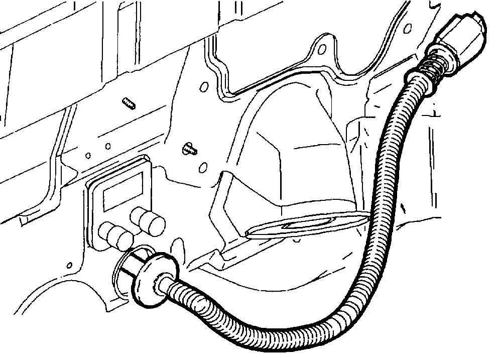

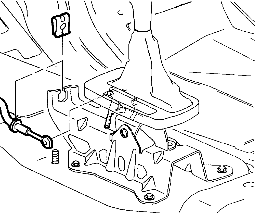

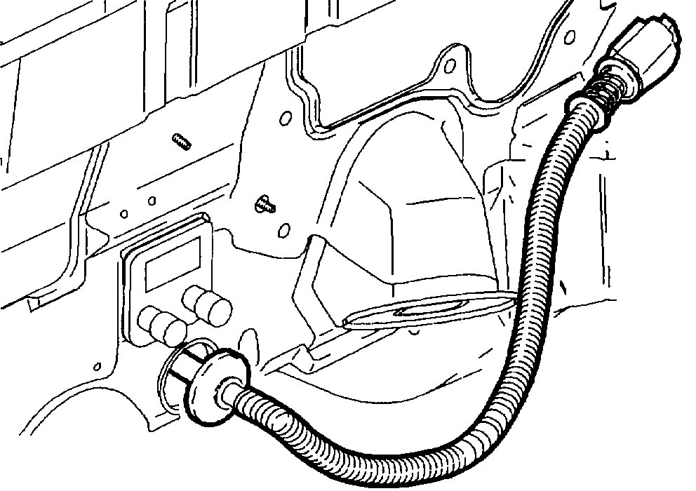

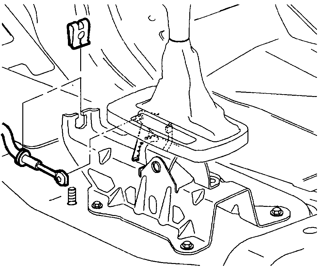

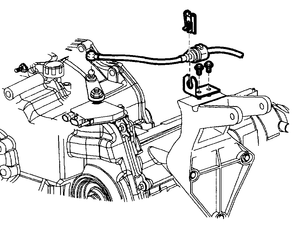

Welcome back, Jon. I'm happy it helped you. However, I can't leave it at that. Here are the directions specific to replacing the cable. The attached pics correlate with the directions. Hopefully this help.
___________________________________________________________
PROCEDURES
CONTROL CABLE ASSEMBLY
REMOVAL
1. Disable the SIR System.
2. Remove console.
picture 1
3. Using a screwdriver disconnect control cable from control assembly.
4. Remove control cable retaining clip.
5. Depress tabs on control cable and remove cable from control assembly.
picture 2
6. Disconnect control cable from trans-axle range switch lever.
7. Remove control cable retaining clip.
8. Depress two tabs on control cable and remove cable from control cable bracket.
picture 3
9. Remove control cable grommet from dash panel.
10. Remove control cable from vehicle.
INSTALLATION
picture 4
1. Guide control cable through pass-through in dash panel.
2. Secure control cable grommet by pressing the cable into pass-through hole in dash panel.
picture 5
3. Route control cable through cable bracket on power-train mount, and secure cable into bracket.
4. Install control cable retaining clip.
picture 6
5. Connect control cable end to control assembly lever.
6. Connect control cable to pin on control assembly.
7. Secure control cable into control assembly by pushing into place.
8. Install control cable retaining clip.
9. Install console.
10. Adjust control cable assembly.
11. Enable the SIR system.
