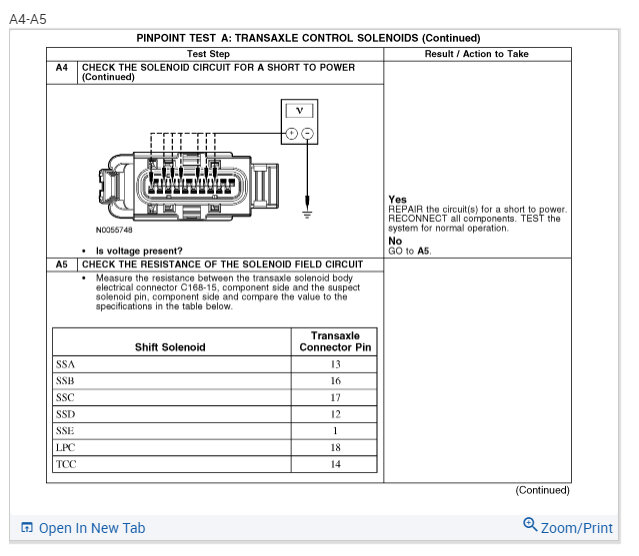

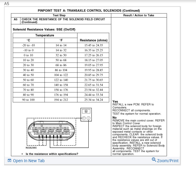

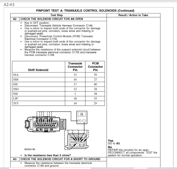

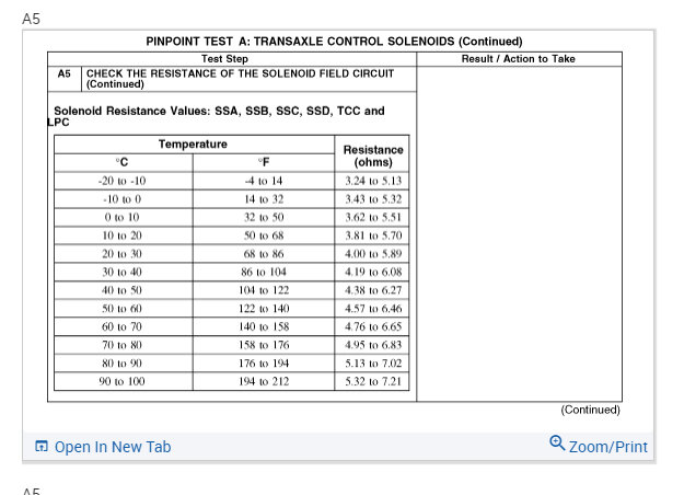

I rebuilt my transmission, never done this before. Everything seemed okay, I only added new frictions and a couple of the metal-clad pistons, and other small parts and seals. After installation, I was getting TSS codes even though it was a new Motorcraft TSS sensor, so I got a second TSS and installed it. Still, the same codes pertaining to TSS. I then got a second allegedly new lead frame solenoid pack. Now, the TSS is good but after doing some of the shifting procedures detailed by Sonnex in the solenoid body installation guide. Everything was smooth at first. Then suddenly it started shifting a little harshly, mainly into reverse and popped this p0765 code. I cleared the code, and started shifting smoothly again but eventually popped the codes again, now adding the p0768. I decided to try using FORscan to monitor and control the solenoids. I activated shift solenoid "d" while in neutral, there was a sudden clunk noise, and threw these codes. p0765, p0768, p0982. I've been attempting to use a multimeter to check the wiring and have only done resistance readings so far. The readings coming from the PCM were all well under 5 oms. My main question is. Was it okay to activate solenoid d while in neutral? The other solenoids seemed to make no noise when manually activating them. Thanks in advance, Jonathan

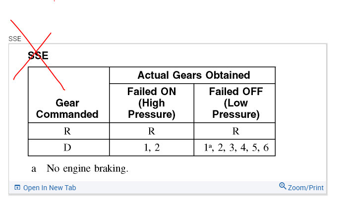

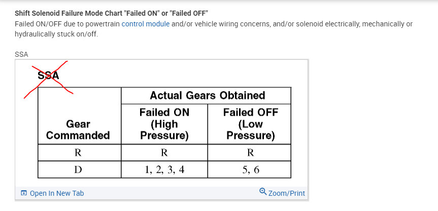

To check the solenoid, it should be in neutral, so I don't see a problem with what you did.
The TSS and OSS are common problems on these vehicles, but since they are new, it sounds like a wiring issue to the SSD (shift solenoid D).

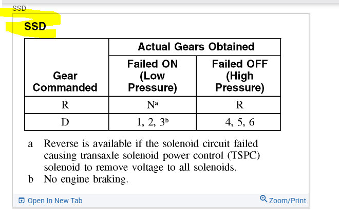

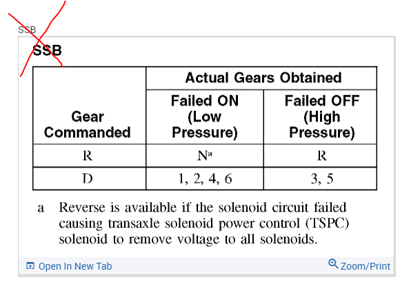

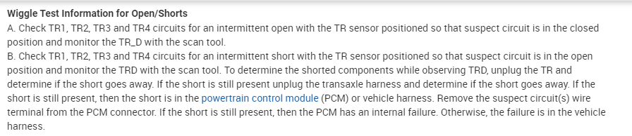

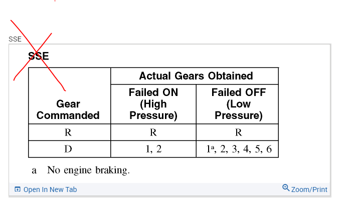

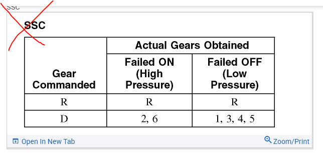

I attached diagnostics below specific to the all of the codes indicated. Each code takes me to the same diagnostics. Again, the code is specific to the SSD. Others are mentioned.
Let me know if this helps.

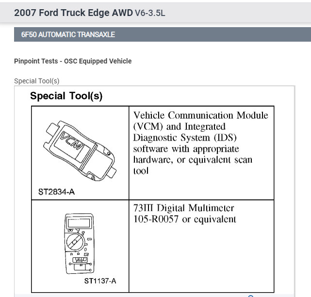

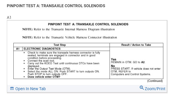

Hello, I decided I better use one of the extra solenoid bodies I have lying around to hook up to the transmission connector externally to test the power of the TSS outlet on the solenoid body. I have a pinpoint test procedure I'm following. One pin is giving me my 5v reference signal, but the main power pin #2, isn't giving me anything, the pinpoint test says to get a new PCM if no voltage is present. So, this whole time it may have been the PCM, I hope so. I already ordered a used one from eBay. I took a small drive since I asked my first question. Now, the shift solenoid d light and codes have stayed clear, but the TSS stuff came back, p0717 and p0705, the faults are electrical, and it seems like the more the transmission warms up the worse it gets. Anyway, have you heard of symptoms like these before from a PCM? Joe, you have been a big help! Thanks in advance. Jonathan

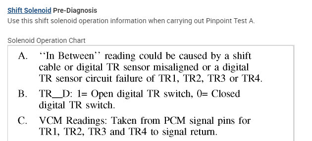

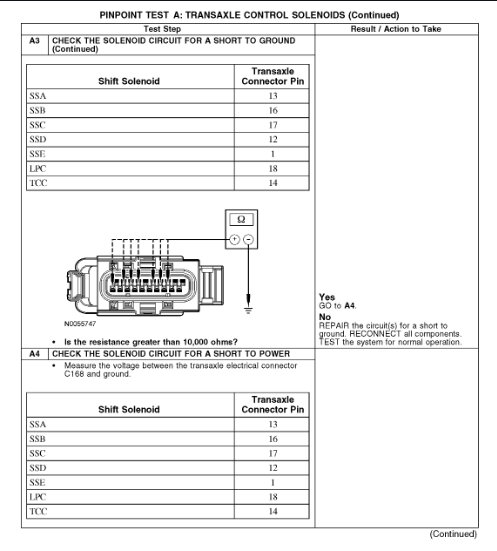

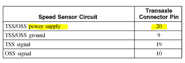

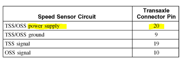

Yep, the TSS signal isn't present when it should be. So, we have an electrical issue or a faulty sensor. I looked at my manual and it shows the power supply as pin 20 to the TSS. See pic 1.
Next, I suspect the wiring issue is before the transmission. The P0705 indicates the transmission range sensor signal to the PCM is wrong. If you haven't already, check the connector for any damage.
