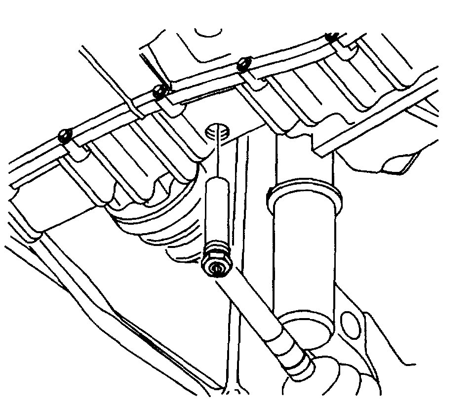

I have a the vehicle listed above had the service engine light checked and was told it needed a throttle positioning sensor, and transmission service. How do I find out what type of transmission I have, and what all is needed for the service?

The vehicle could have one of two transmissions, a VT-25 E CVT transmission or a AF33-5 automatic transmission. The easiest way for me to explain how to identify which one you have is simply by the drain plug at the bottom of the transmission. The AF33-5 is on the side of the transmission on a horizontal axis and the VT-25 is on the bottom on a vertical axis.
Take a look at picture 1. It shows the VT 25. Here are the directions for servicing that transmission. The fluid specifications are included in the directions. Also, pictures 1,2, and 3 correlate with this transmission
__________________________________________________
CVT
Transmission Fluid Replacement
Picture 1
1. Raise and support the vehicle.
2. Place a drain pan under the transmission.
3. Remove the lower tube assembly drain plug.

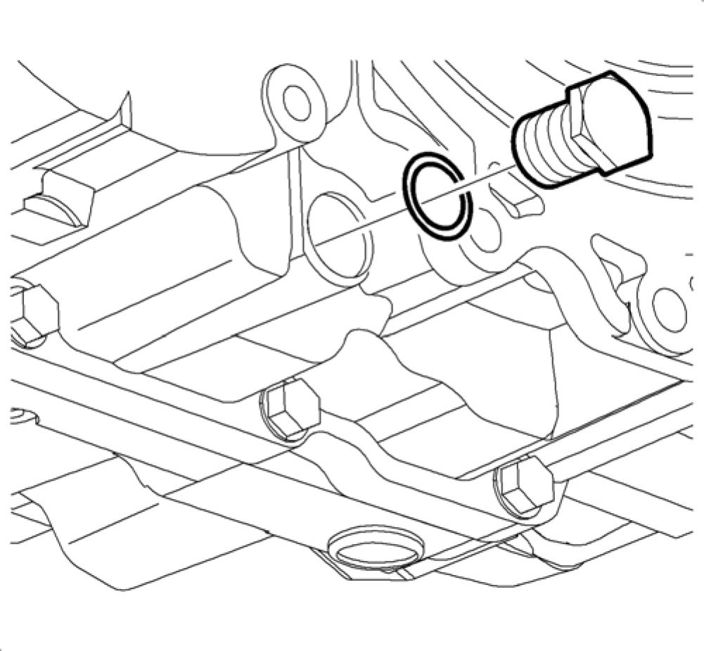

Picture 2
4. Remove the lower tube assembly from the transmission. Allow the fluid to completely drain.
Notice: Refer to Fastener Notice in Cautions and Notices.
5. Install the lower tube assembly into the transmission.
Tighten
Tighten the assembly to 20 N.m (15 lb ft).

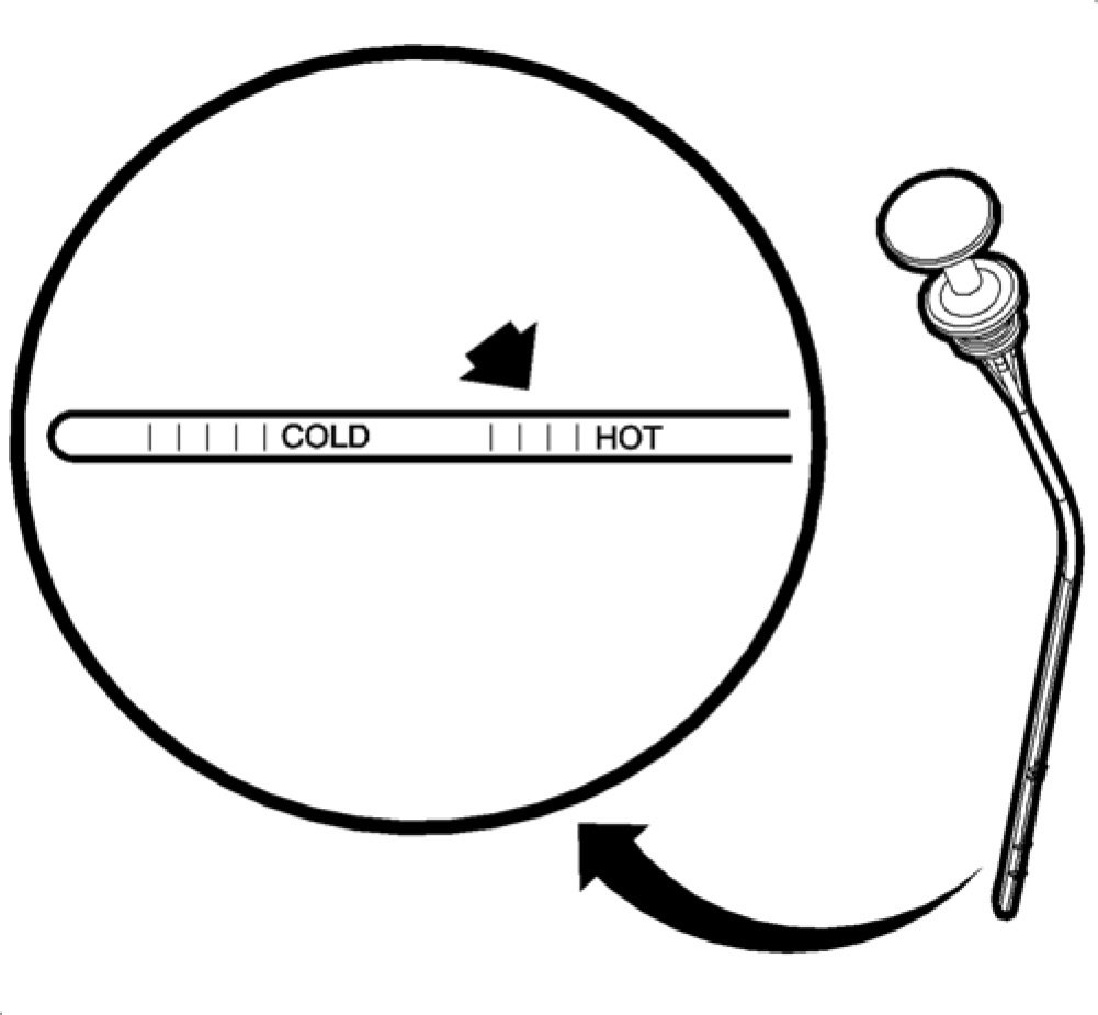

Picture 3
6. Temporarily install the original lower tube plug. Do not tighten.
7. Lower the vehicle.
Important: Do not use ATF P/N 21005966 or P/N 21019223. These fluids are not compatible with this transmission.
8. Fill the transmission to the proper level with Saturn DEX-CVT(R) Fluid P/N 22688912.

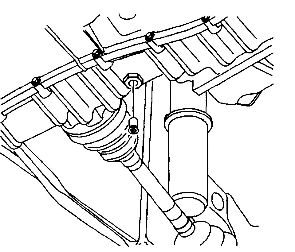

Here are the directions for the AF33-5 transmission. Look at picture 4. It shows the drain on the horizontal axis. Picture 4, 5, and 6 correlate with this transmission and these directions.
Picture 4
Removal Procedure
Caution: Ensure that the vehicle is properly supported and squarely positioned. To help avoid personal injury when a vehicle is on a hoist, provide additional support for the vehicle on the opposite end from which the components are being removed.
Picture 4
2. Remove the drain plug and drain fluid. Allow at least 5 minutes for the fluid to drain completely.
3. Remove the gasket from the drain plug and discard.

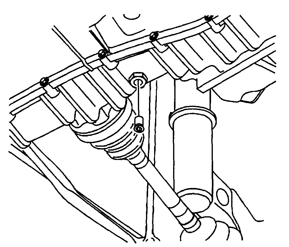

Picture 5
10. Push retaining clip back and pull level gauge out, wipe off fluid with a clean cloth and reinsert.

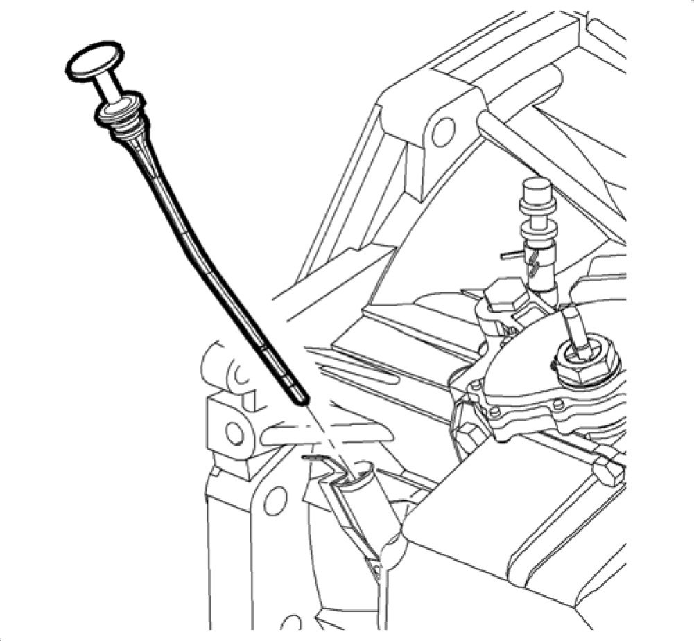

Picture 6
11. Pull level gauge out again and check if fluid level is within the HOT range.
12. If fluid is not within the correct level, adjust accordingly:
12.1 If fluid is below the HOT range, add enough to bring it up to the correct level.
12.2 If fluid is above HOT range, drain excess fluid.
