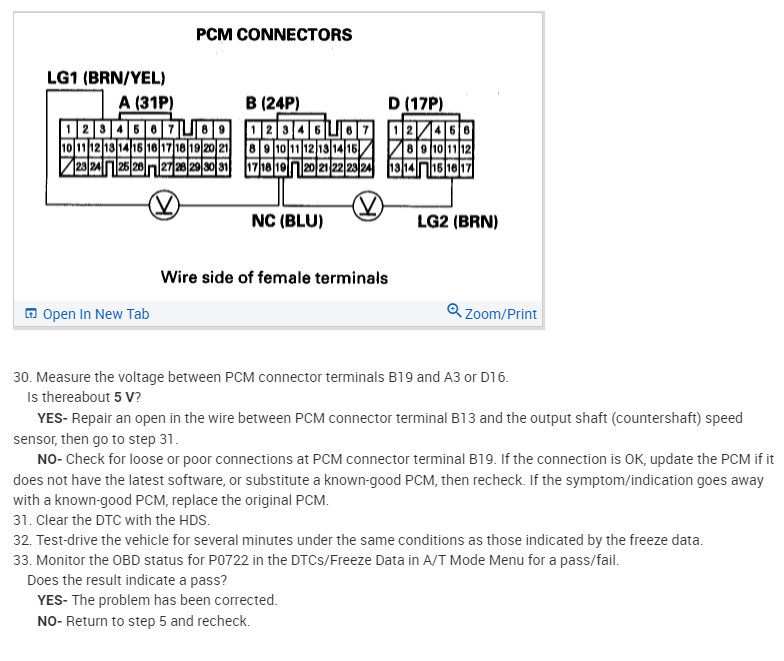

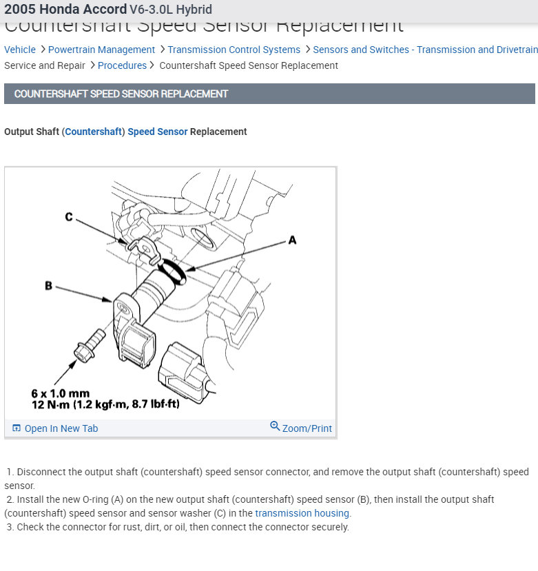

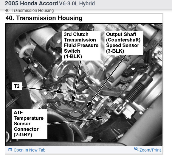

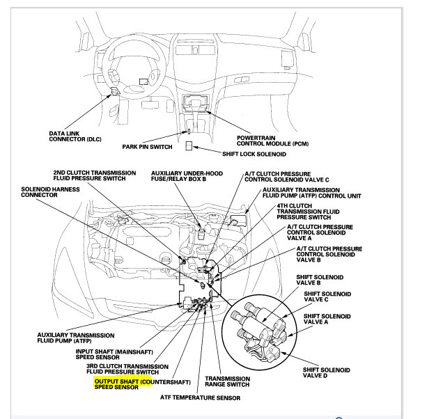

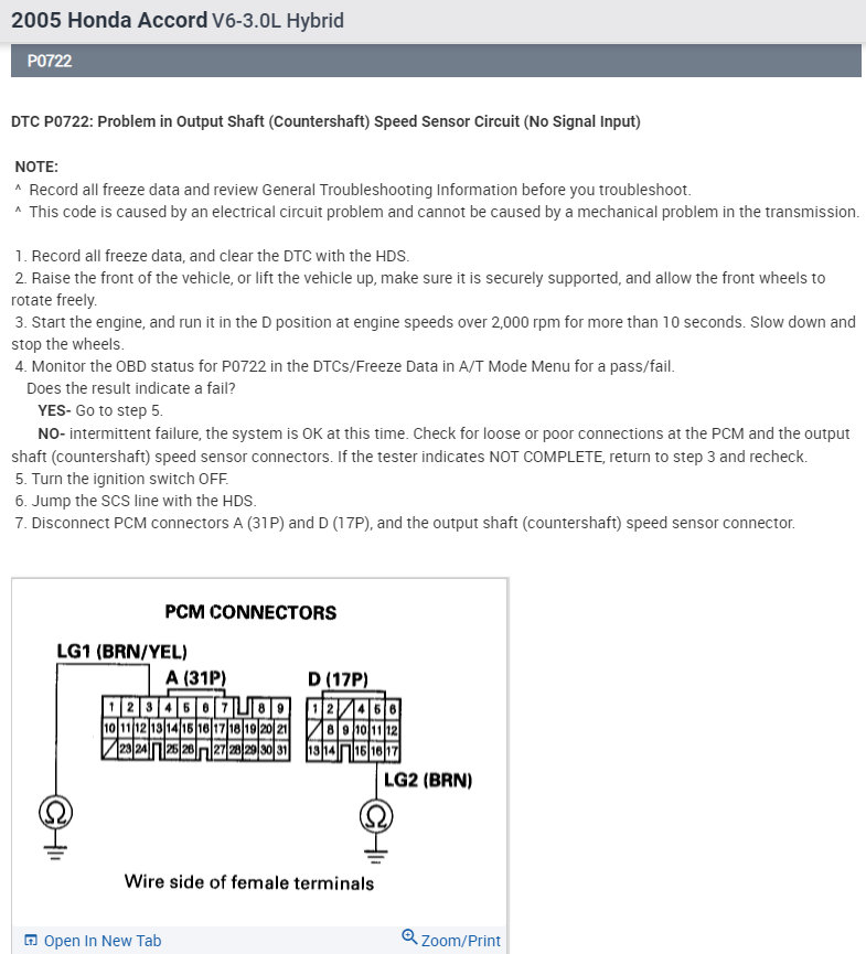

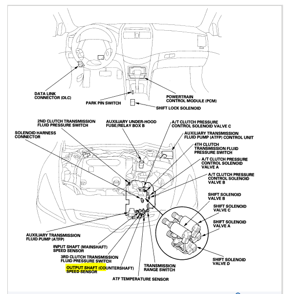

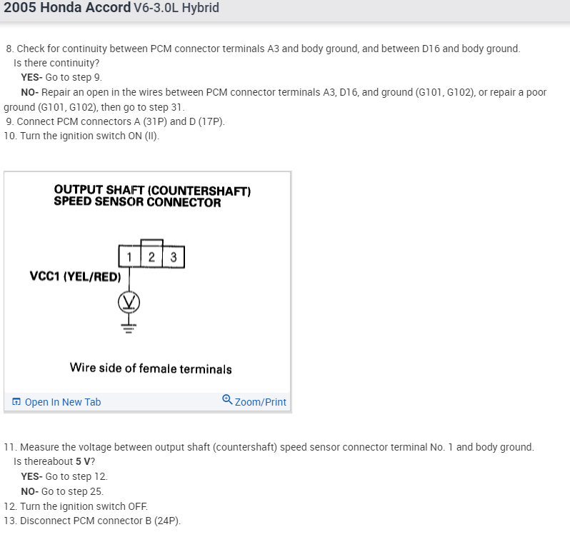

I have a code p0722.
I was wondering where the output shaft speed sensor is located on this model. I want to try and replace it.
Mar 22, 2022 at 5:13 AM
SQM
  • 6,383 POSTS

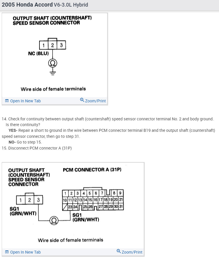

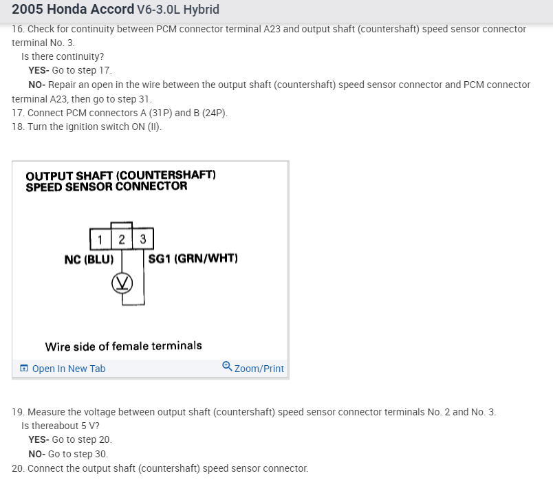

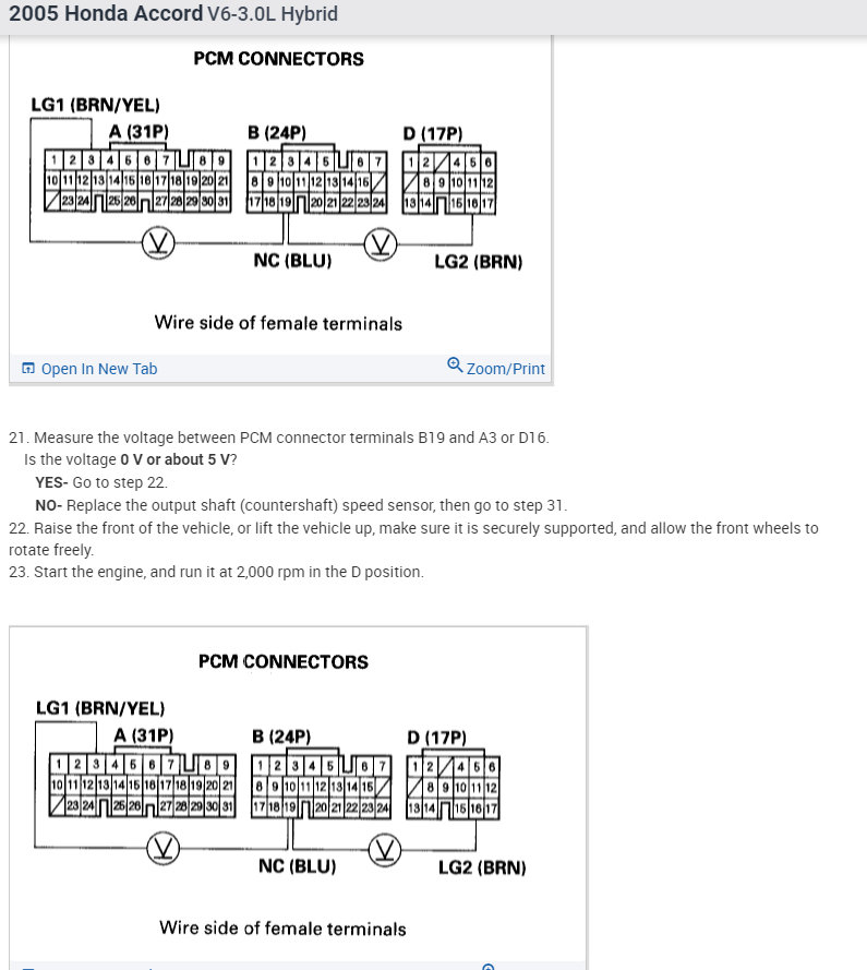

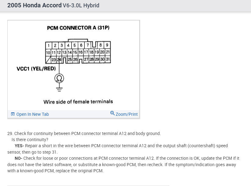

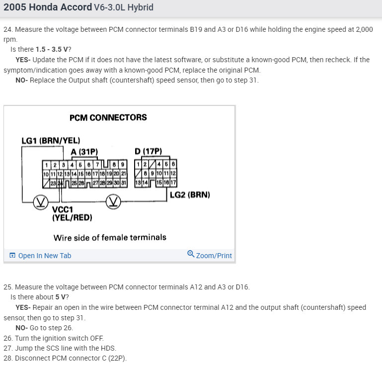

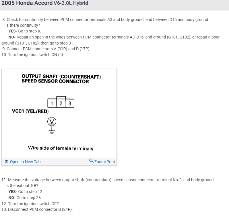

The output shaft speed sensor or the counter shaft sensor is located under the hood on the driver side, close to the starter.
I have attached diagrams below.
Keep in mind the code P0722 could be due to a wiring issue with the sensor or other components. I have also attached the diagnostics steps for the code below for your reference.
This could help you determine the issue.
