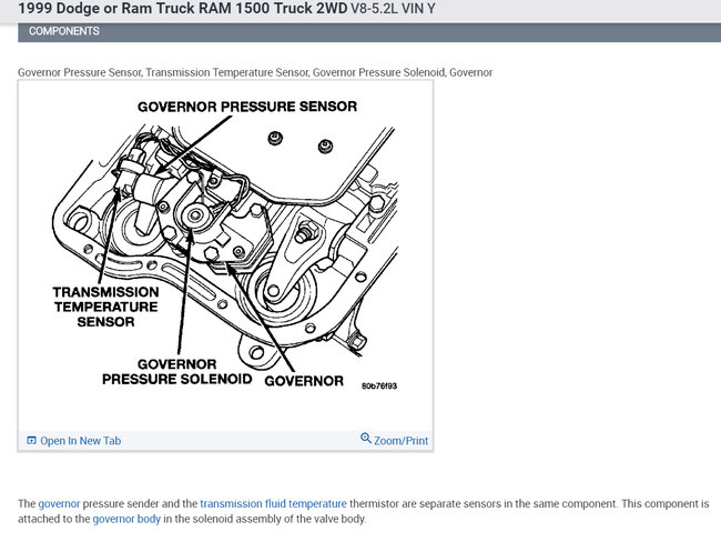

Check engine light was on, got code for bad PCM and Governor Pressure Solenoid. Truck was not shifting properly. RPM's revving to red zone from first to second gear. Originally only happened occasionally then got so bad could not drive the truck. Got new PCM for my specific vehicle (Calif Emissions and programmed to VIN) and also replaced TPS. Truck ran like a dream for three weeks, No check engine light, shifted beautifully. Drove over five hundred miles in three week period. Now check engine light recently came back on for o2 sensor only, but now starting to have the same revving issues again. Not constantly and truck will go into gear when I let the RPM's go down. No code for governor this time though. Hot or cold does not matter also has began bucking just a little. Maybe TPS went bad or I got a faulty part? Truck shifts normally all other times.

They had problems with the Governor Pressure Solenoid in these cars even though you do not have a codes for it this is where I would start. Here are diagrams and a guide to help you do the job:
You must pull the pan to change it.

When this started did you have the fluid and filter changed in the transmission to check if there was a lot of wear material in the pan? It sounds a lot like a slipping transmission. I would probably start by disconnecting the battery and letting it set for about five minutes. Reconnect and see if the issue is still there. The disconnect will erase the learned information the PCM has learned as you drive. If the problem goes away for a while after the reset it is most likely wear inside the transmission. When first powered up the PCM will use default settings to control the transmission and engine. As it learns it will adjust various items to match your vehicle use and to keep the emissions items happy. One of those is the transmission shifting patterns.
Bucking could also be from internal transmission issues if it is only occurring in gear.

Hi, sorry it took me a few days to respond back, I had the flu. Anyway I was figuring it was the governor. I have not changed out the transmission filter yet but that will be done when I change the governor and I am also going to change the transmission speed sensor. I have a scanner and I did erase the codes so C/E light is not on right now. Has been off for the last hundred miles or so. Funny thing is I have not had any issues for at least the past week, been running great. I did notice though that my gear shifter is sort of loose. What I mean is I have to be sure it is actually in drive. The other day it was showing in neutral but was still driving so I may have a shifter issue as well. I am going to drop the pan in the next week or so and change everything and fill up with ATF4. I will keep you posted. Thank you again for the advice.
