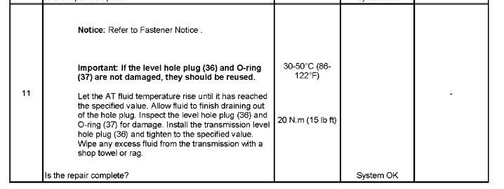

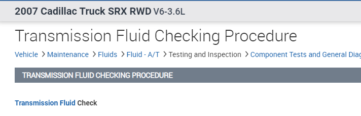

The P0700 is generic. It is a code that the PCM provides to indicate there is a code stored in the transmission control module (TCM).
The code of interest is the P0762. The code indicates the 4-5 shift valve or solenoid is stuck in the on position. So, we could have a faulty solenoid, shift valve, wiring issue, a TCM issue, or even low/dirty fluid.

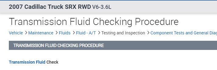

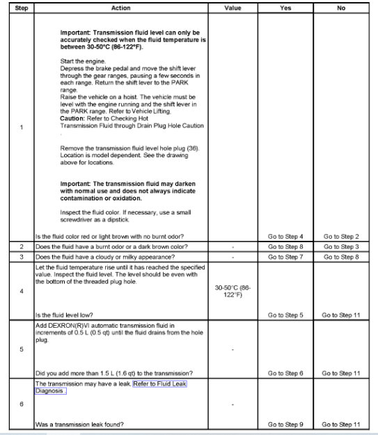

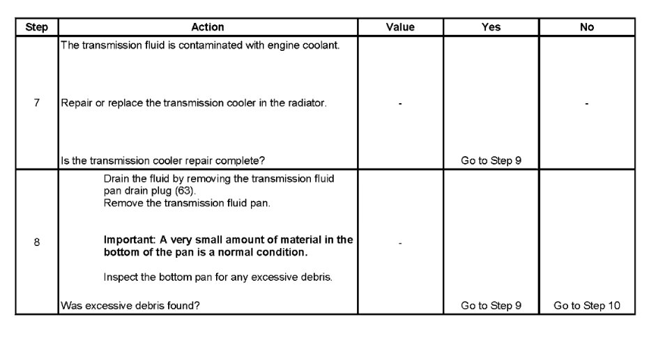

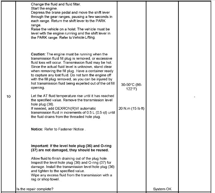

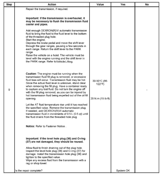

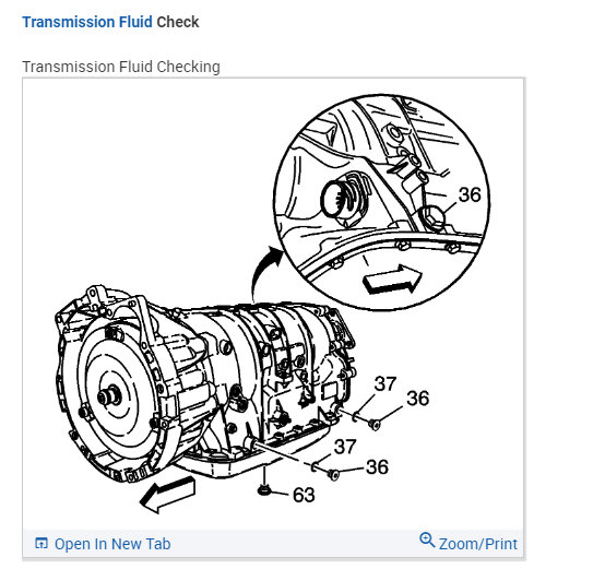

At this point, I need you to recheck the transmission fluid level and condition. I attached the directions below with specific checks. Note the color of the fluid and if it has a burnt smell.
Let me know what you find.
