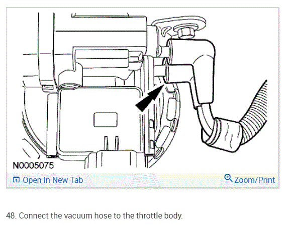

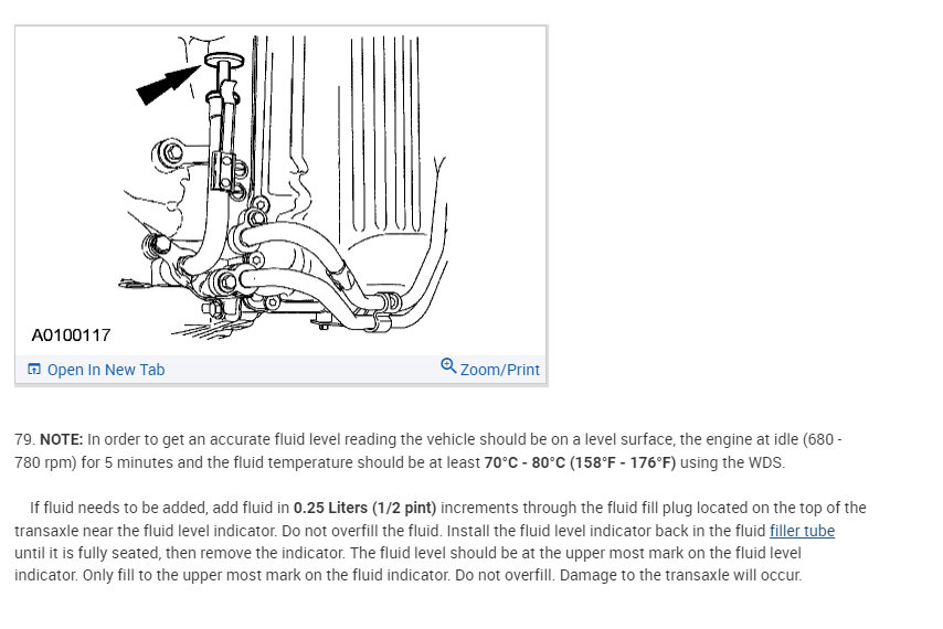

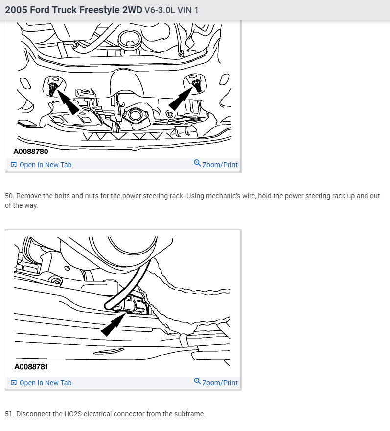

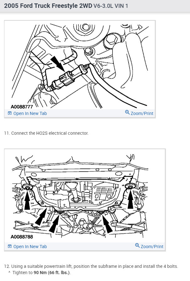

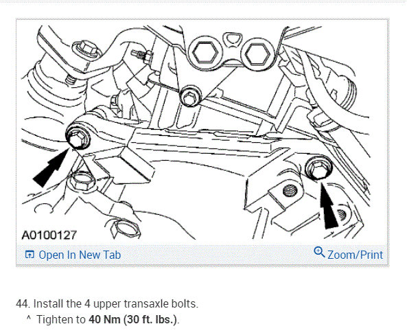

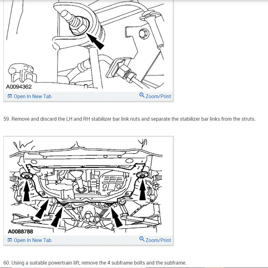

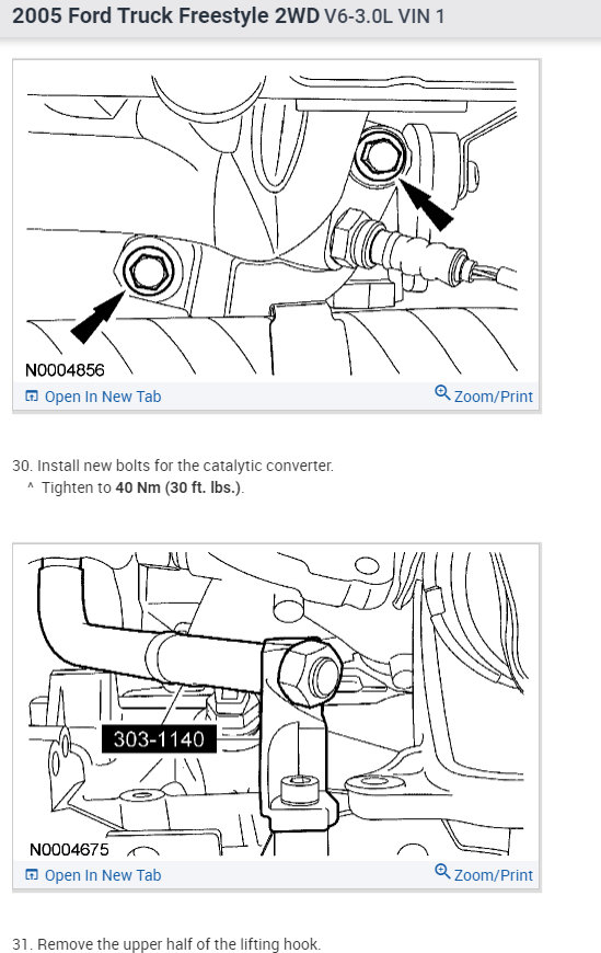

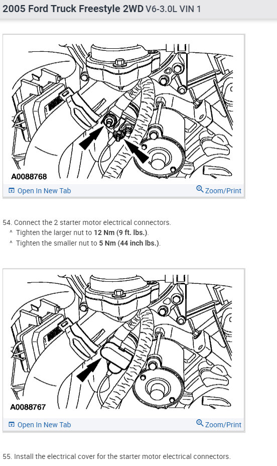

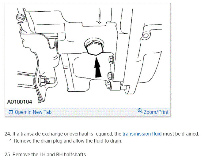

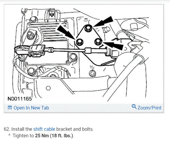

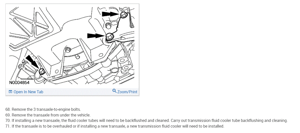

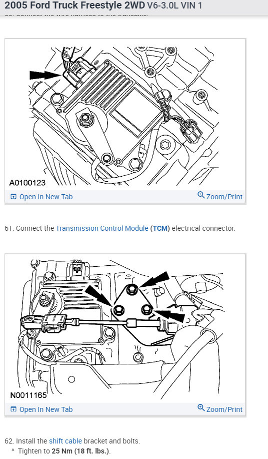

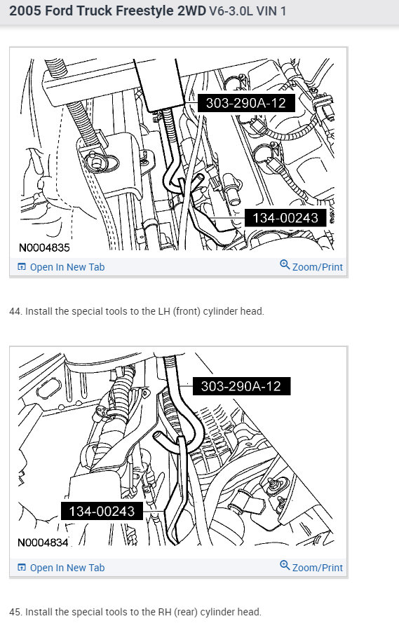

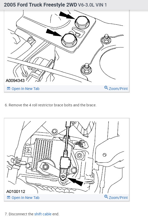

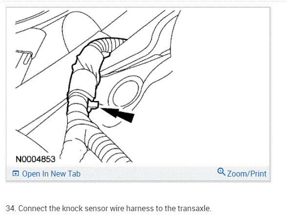

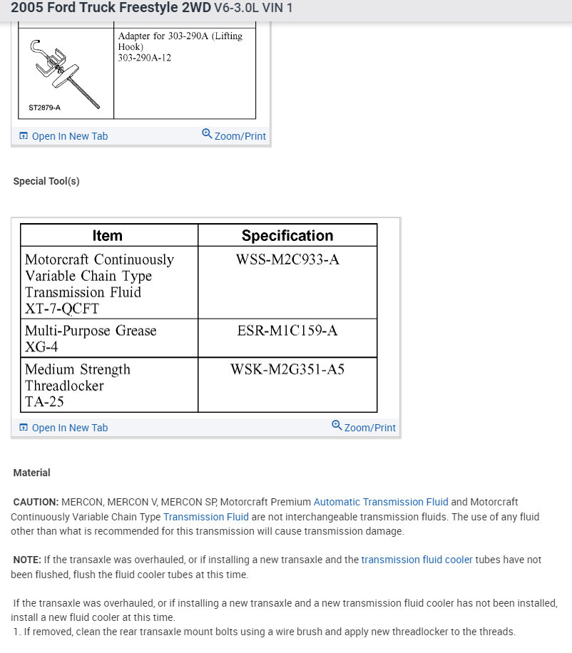

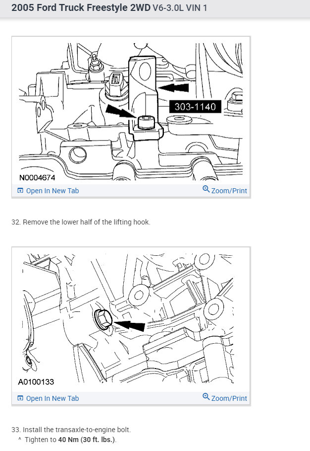

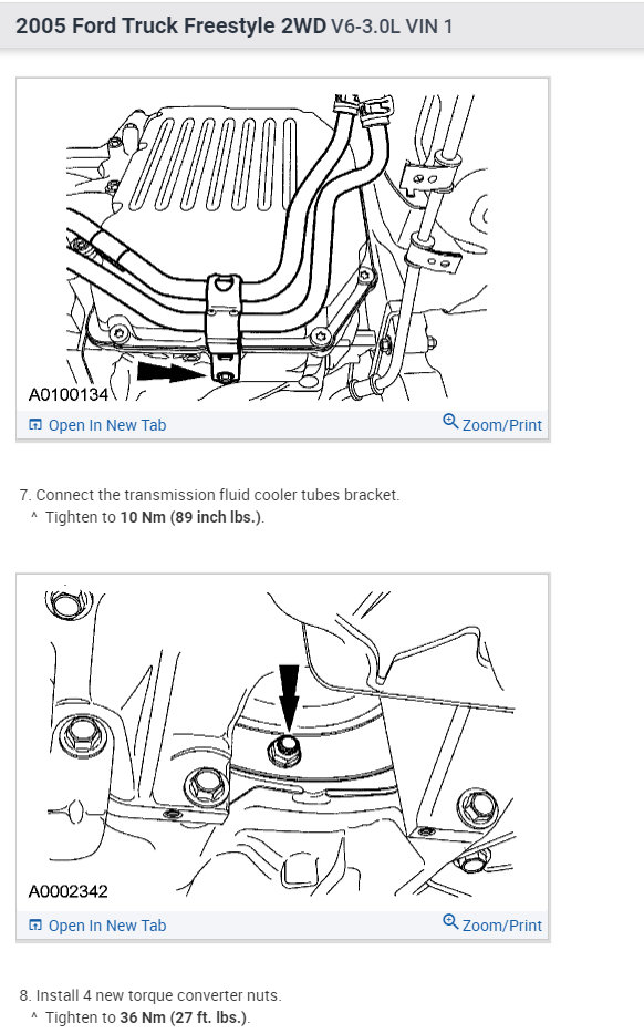

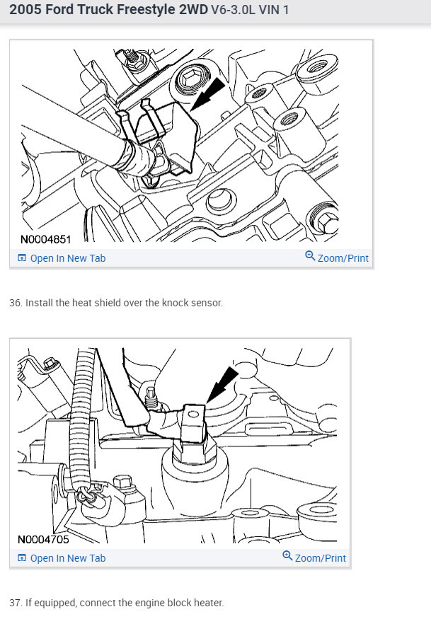

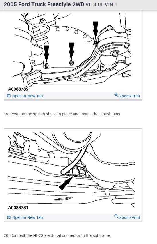

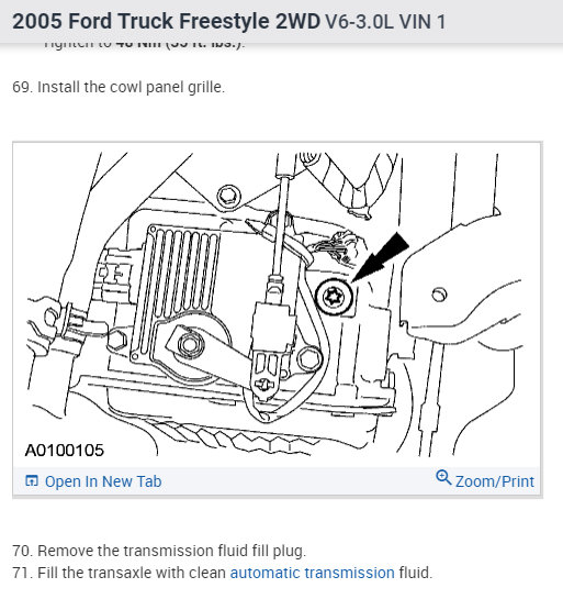

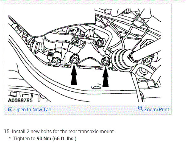

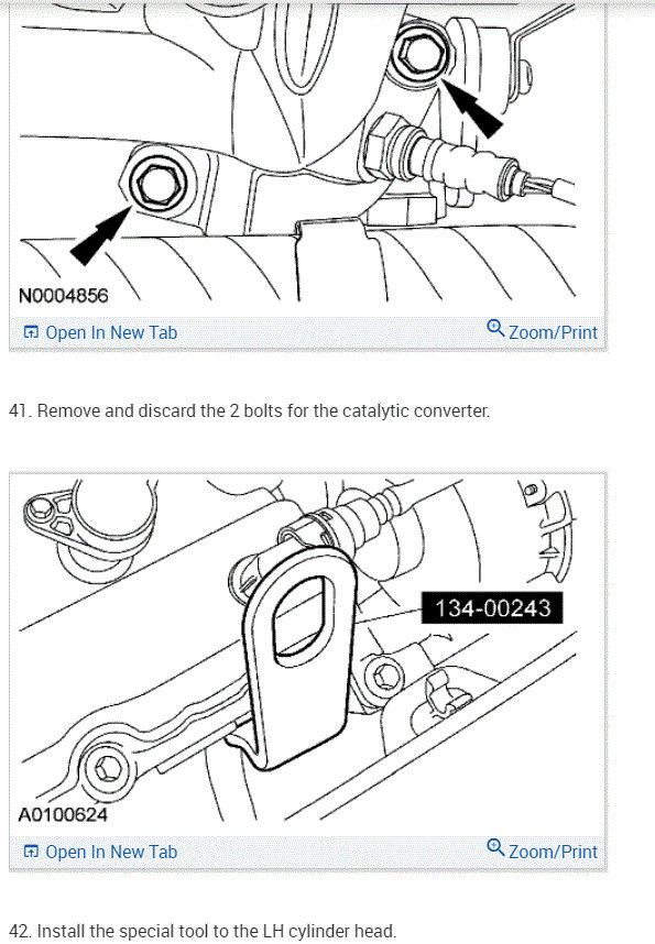

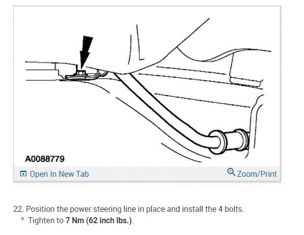

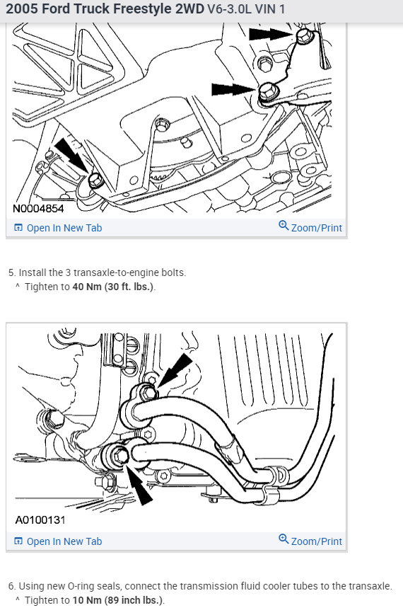

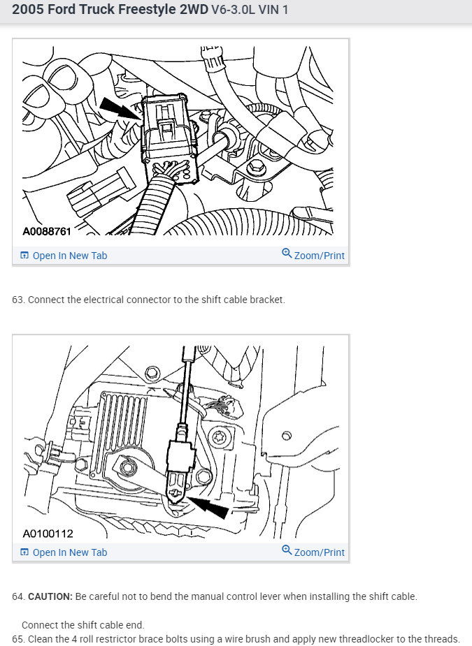

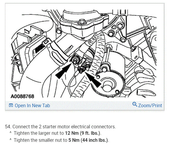

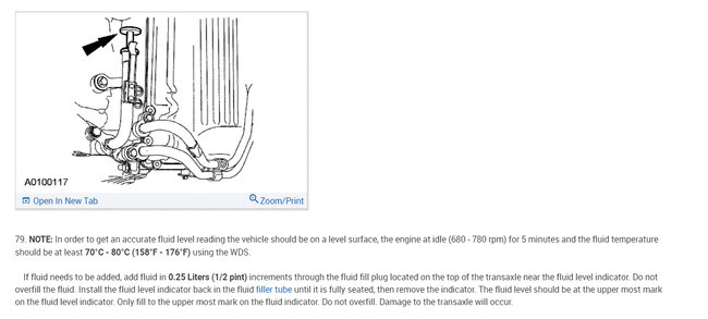

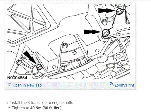

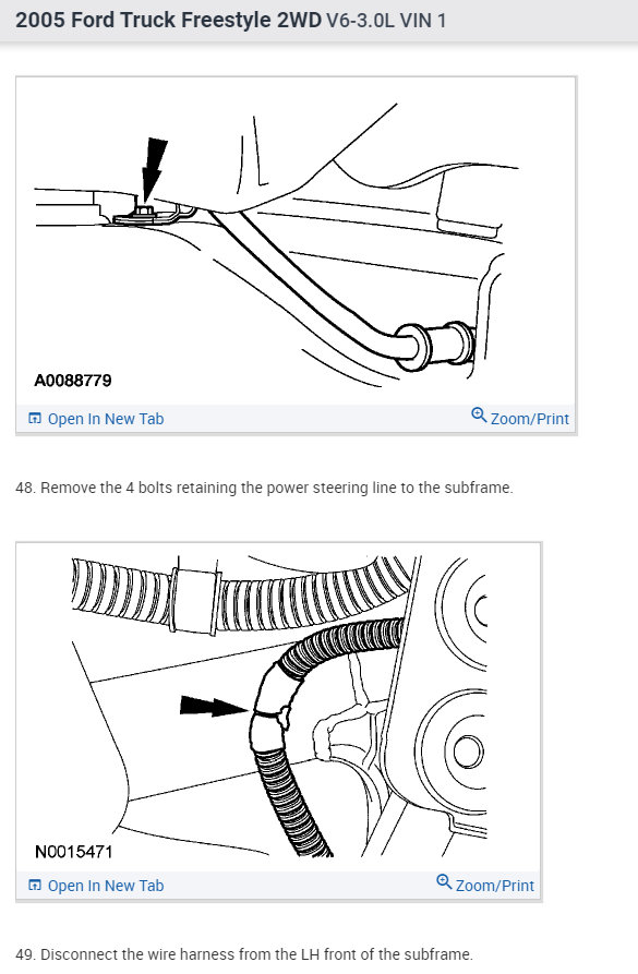

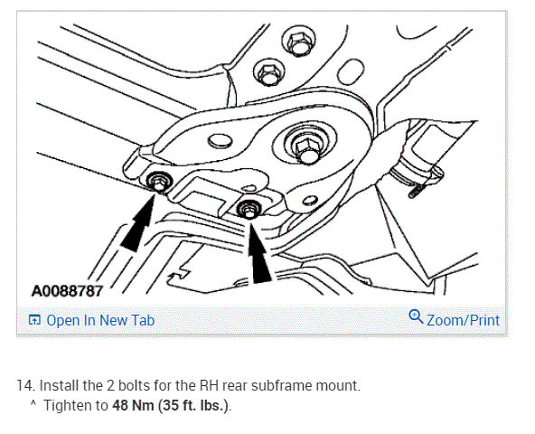

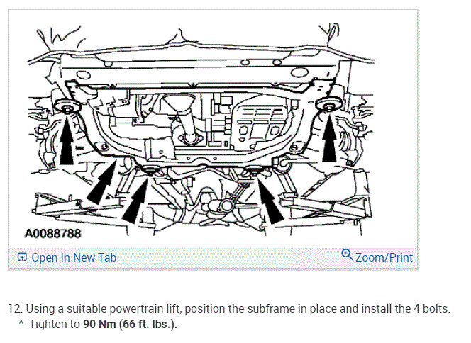

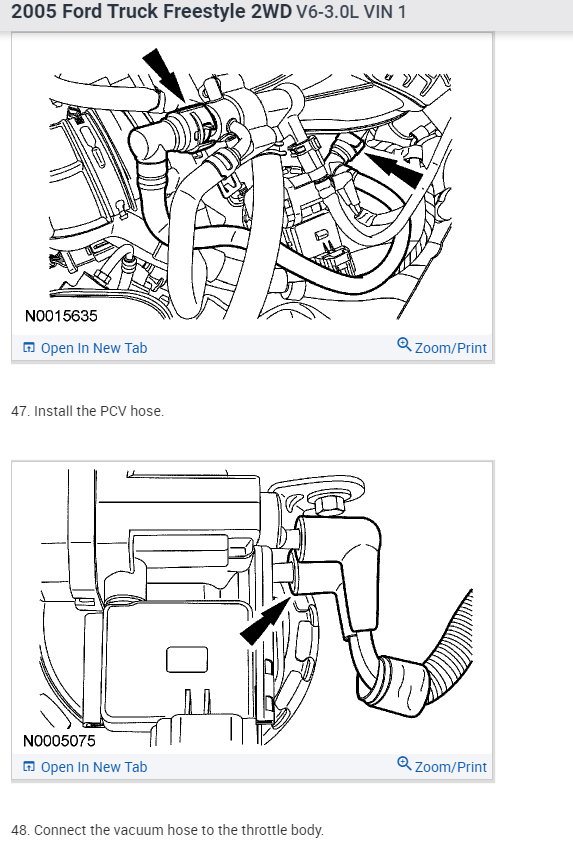

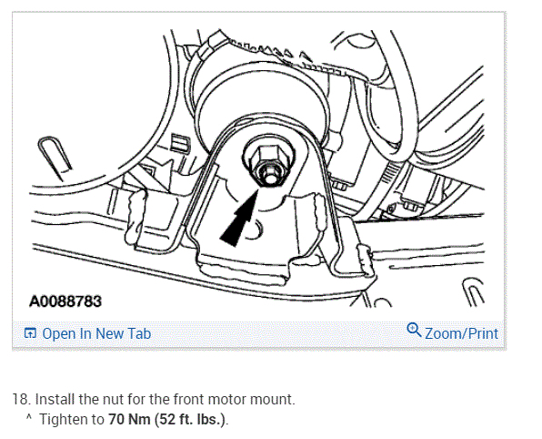

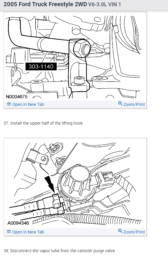

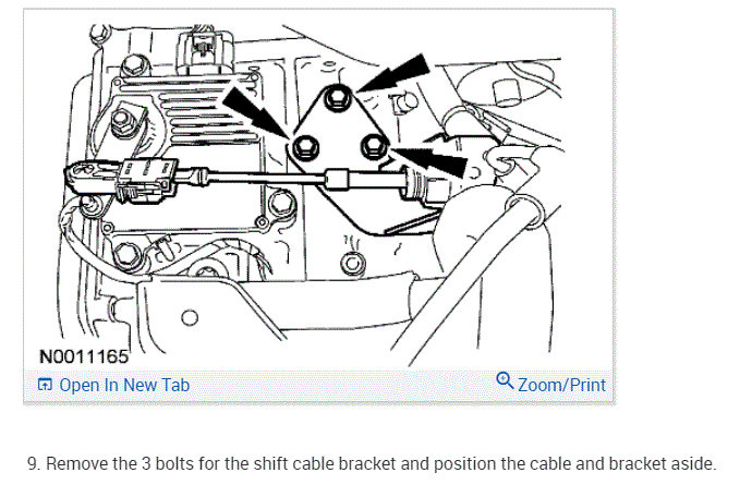

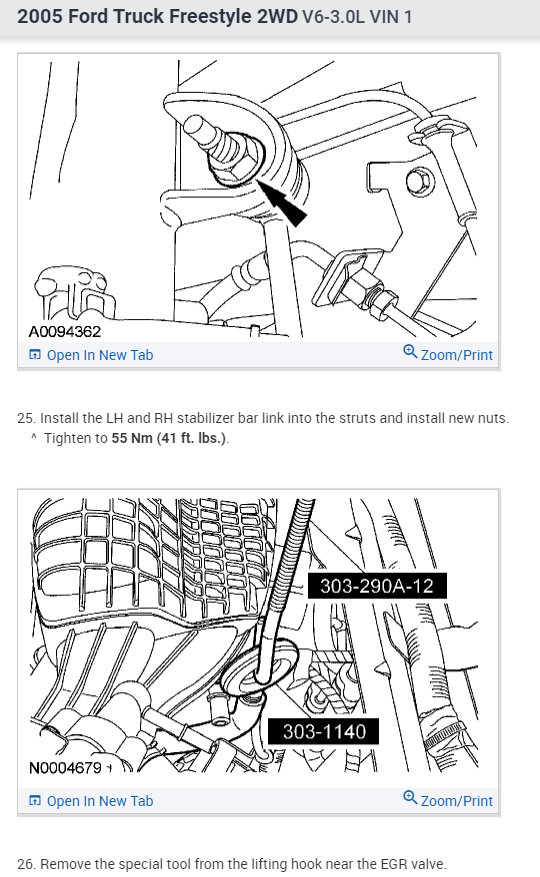

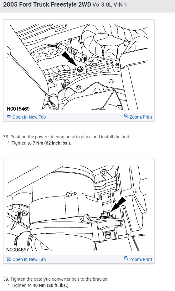

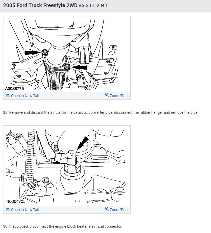

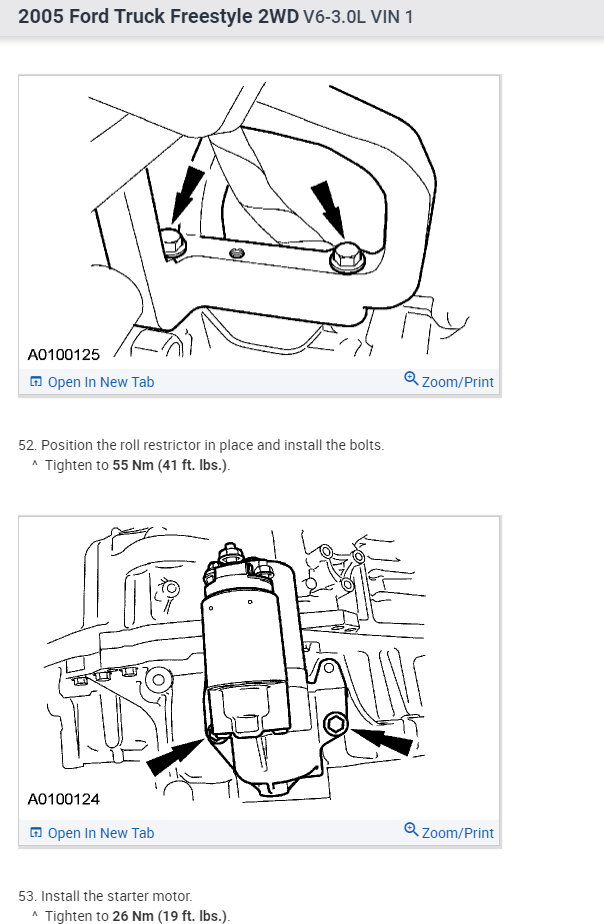

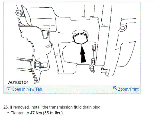

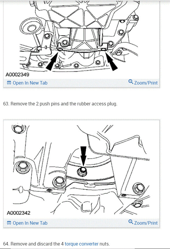

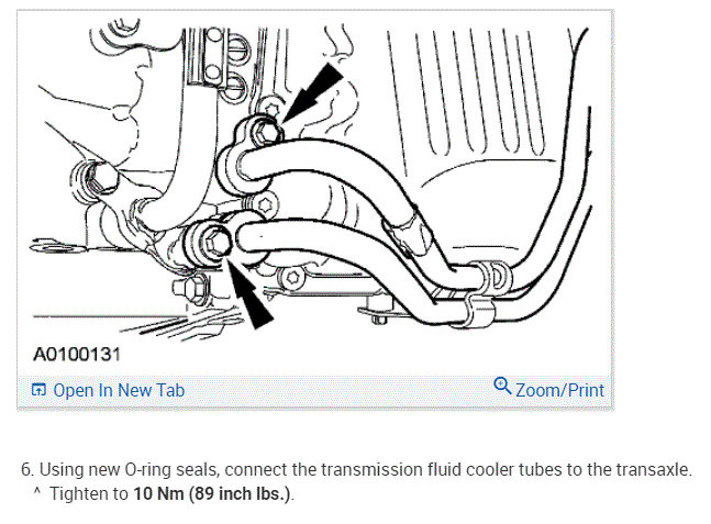

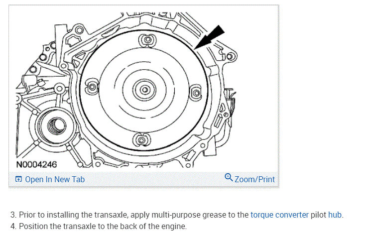

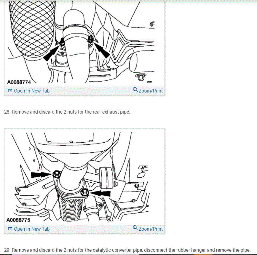

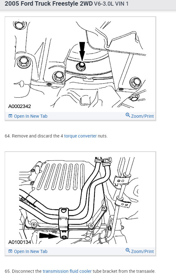

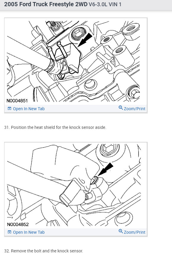

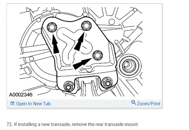

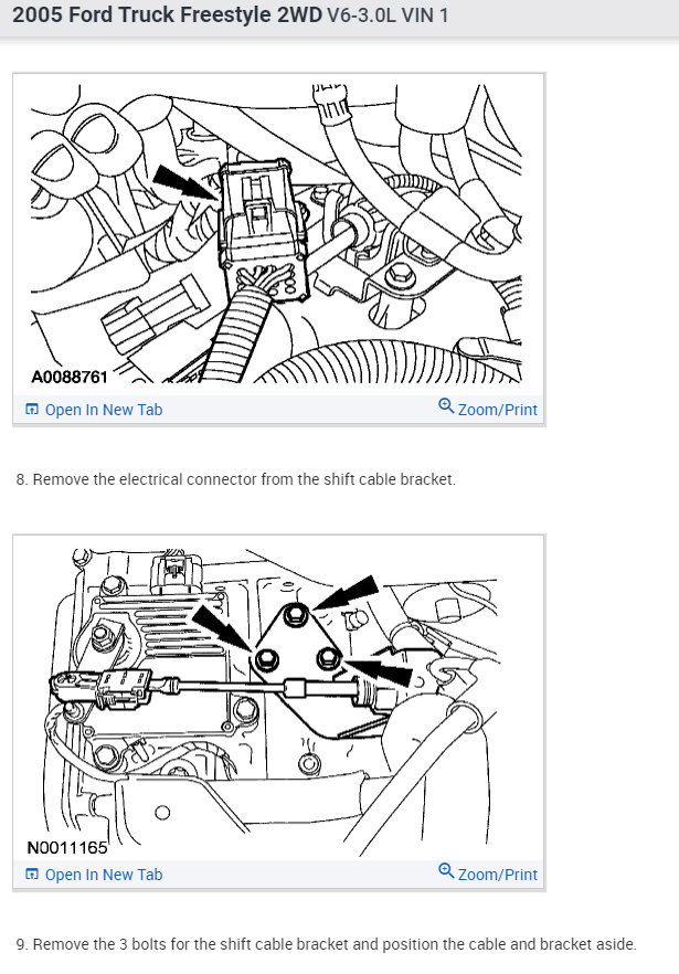

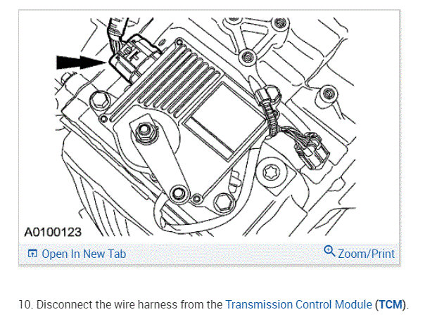

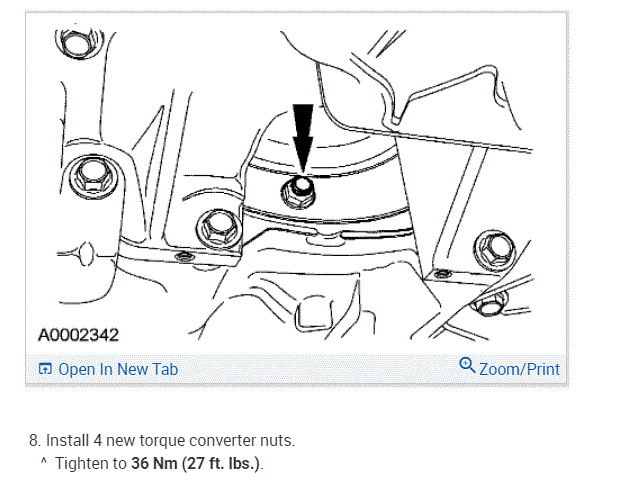

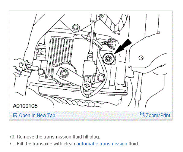

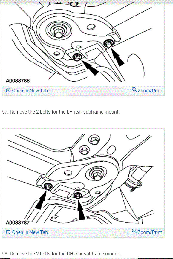

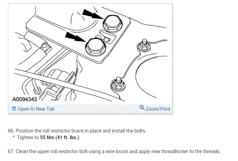

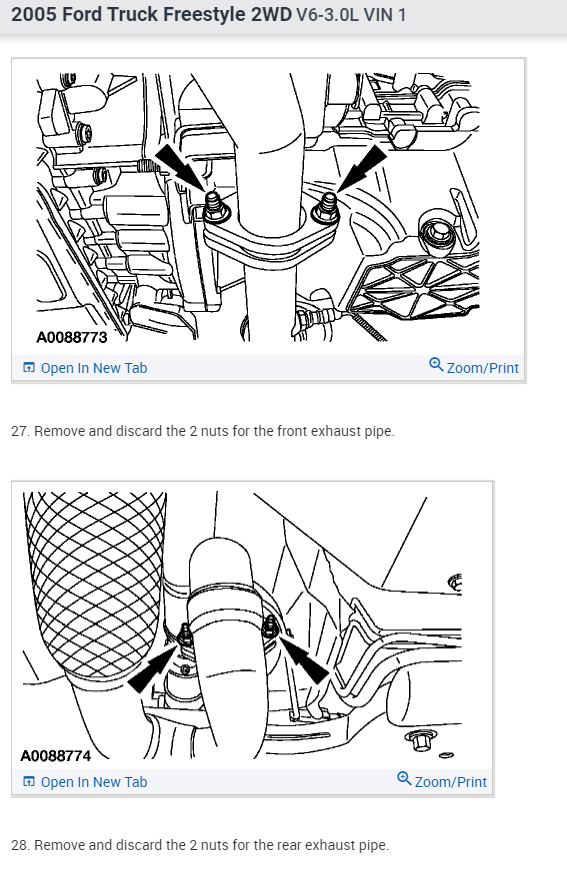

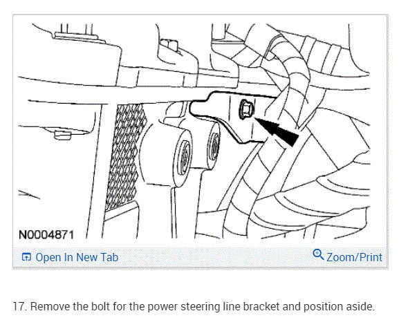

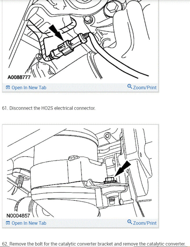

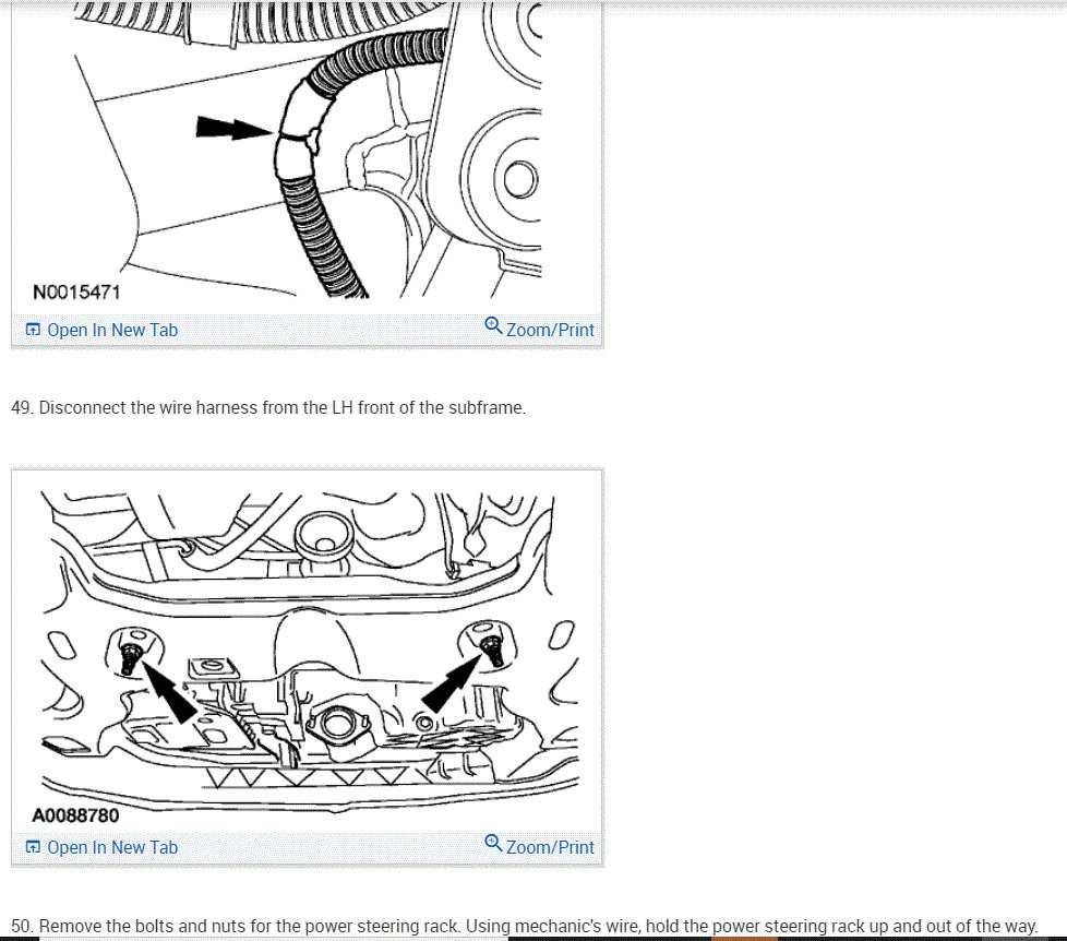

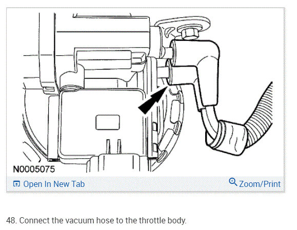

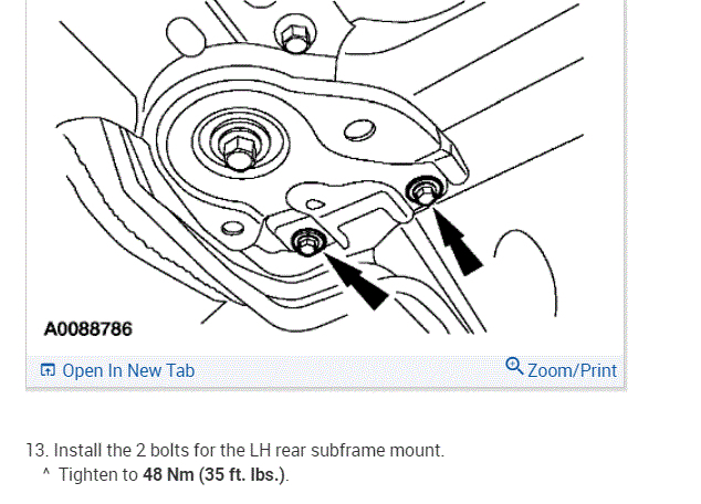

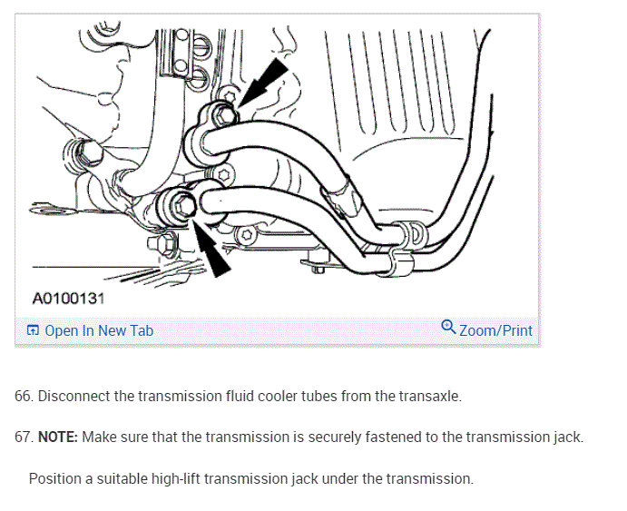

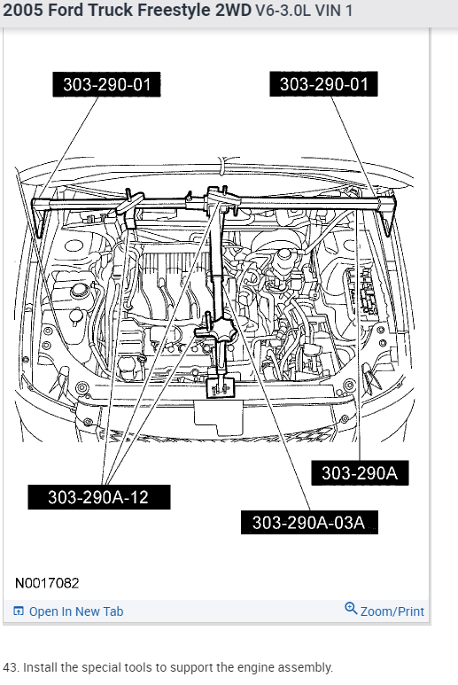

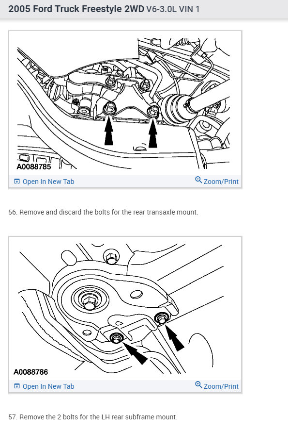

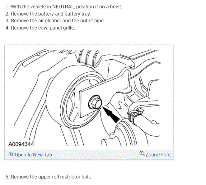

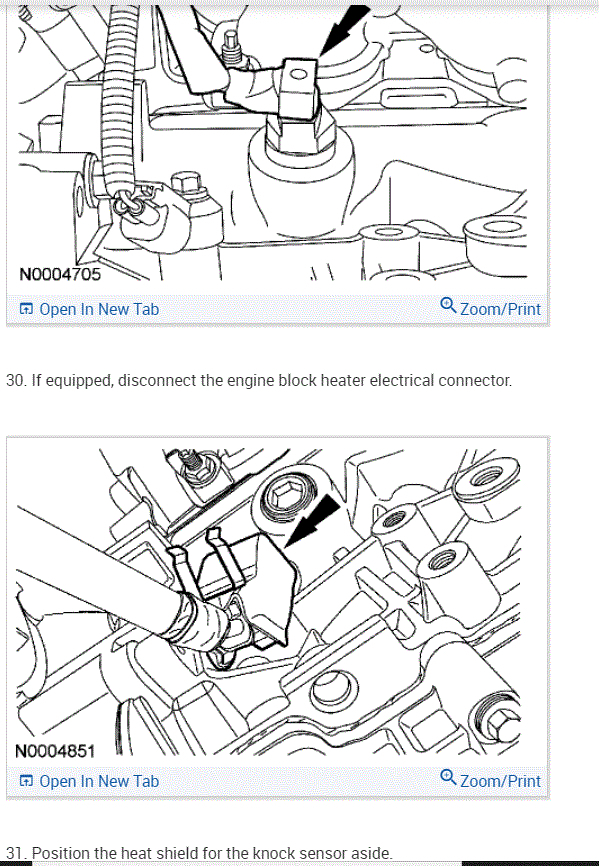

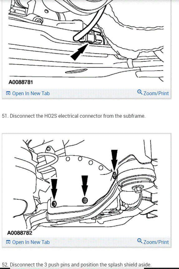

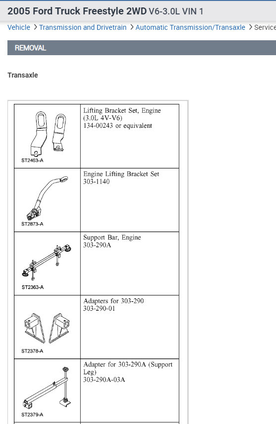

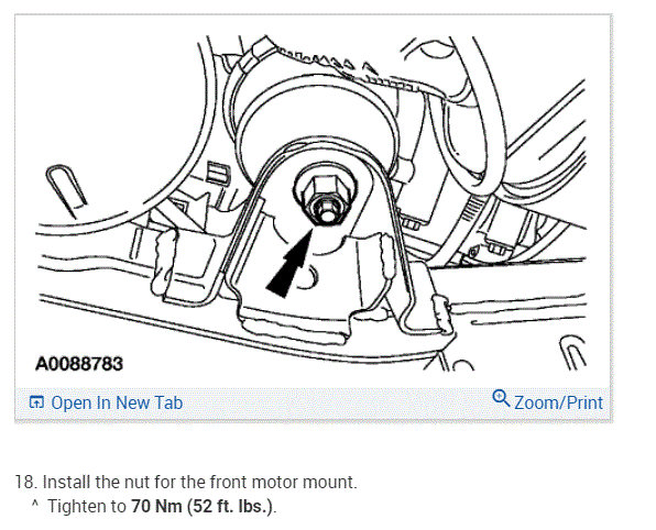

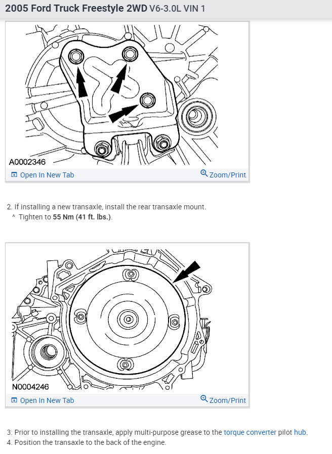

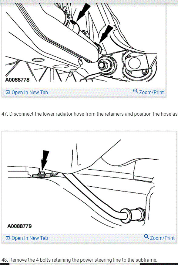

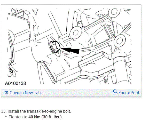

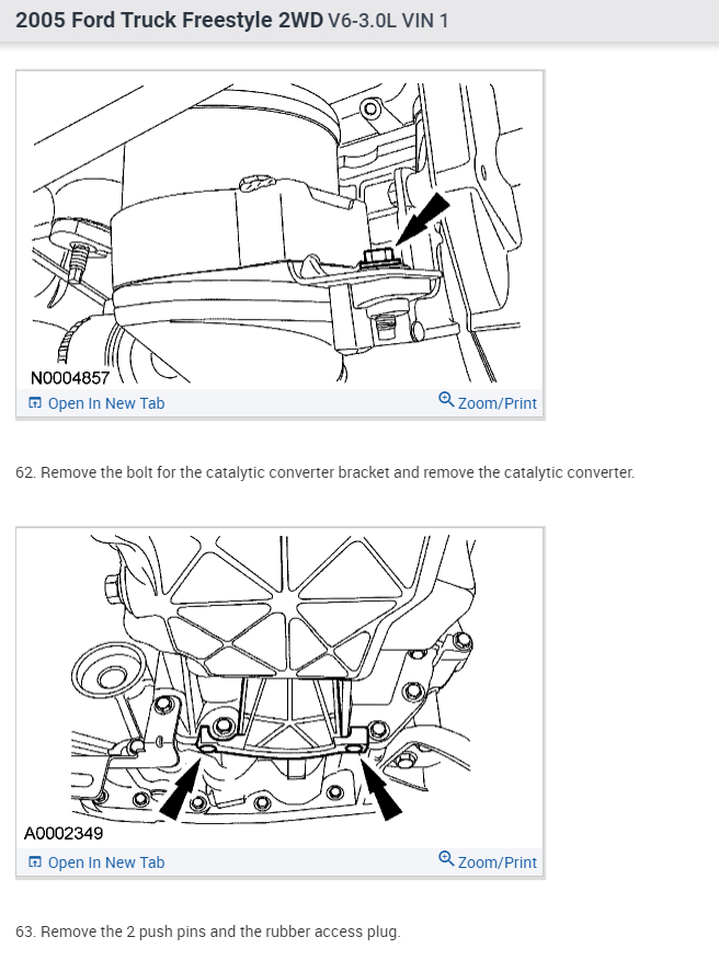

Need step by step instructions on replacing the transmission in my front wheel drive 2005 Ford Freestyle
Monday, April 25th, 2022 AT 4:49 PM
9 Replies
  • 110,055 POSTS

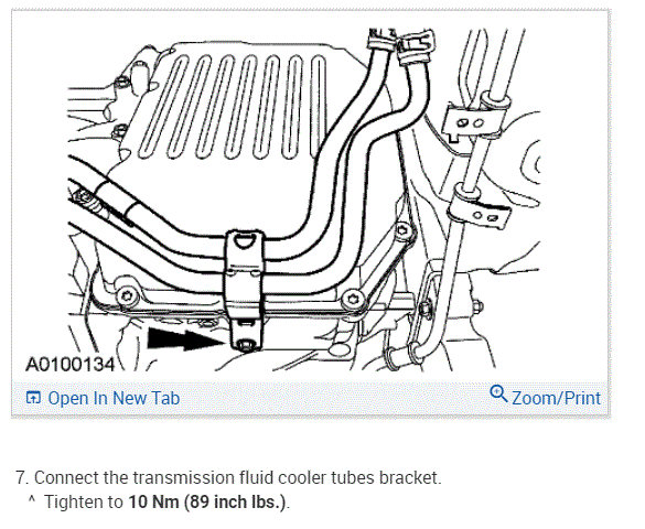

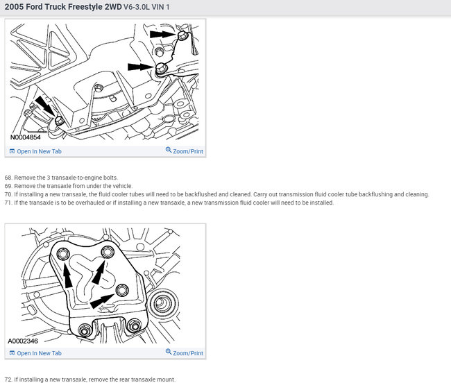

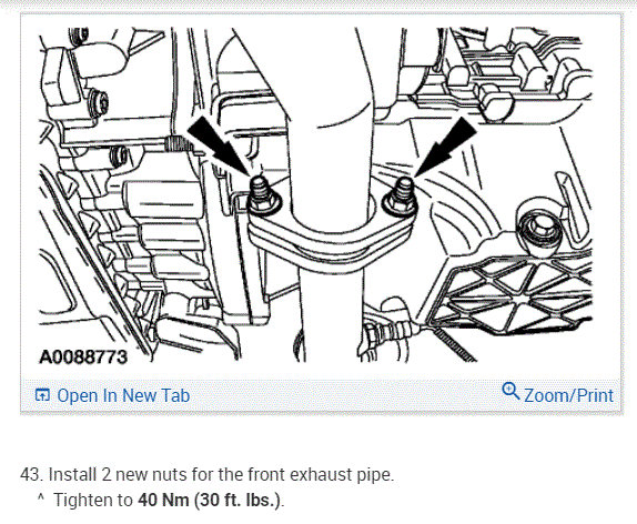

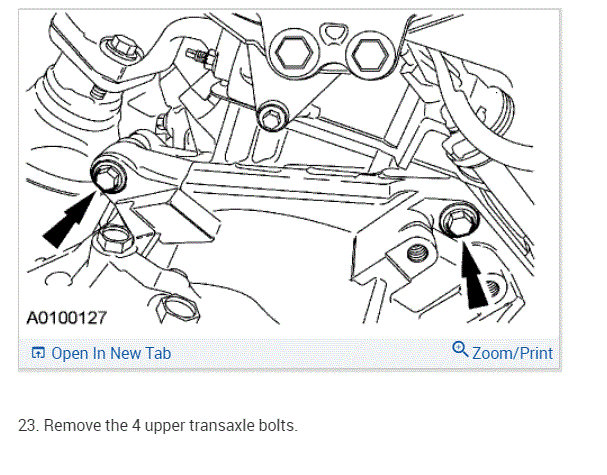

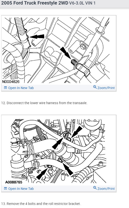

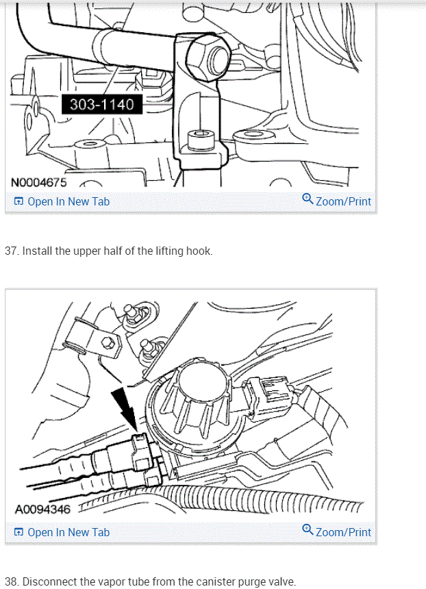

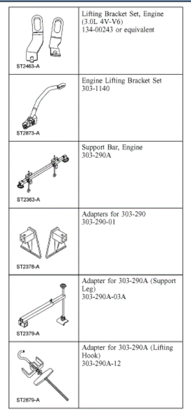

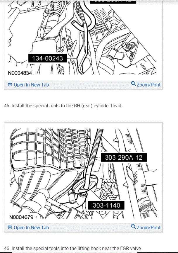

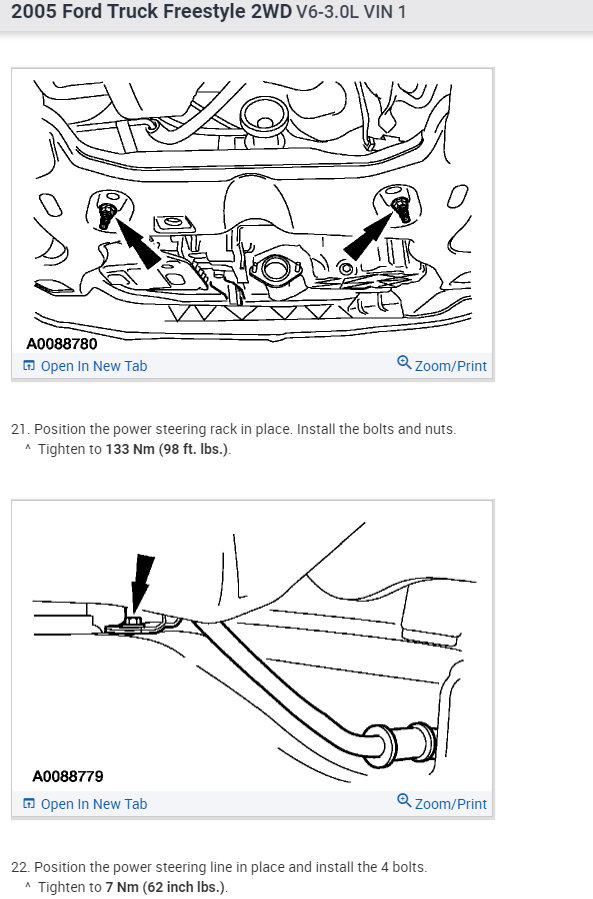

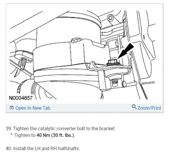

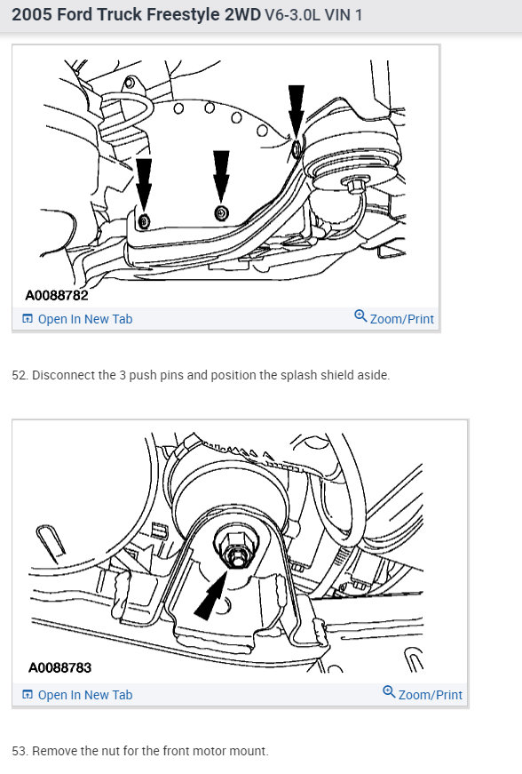

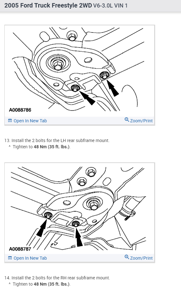

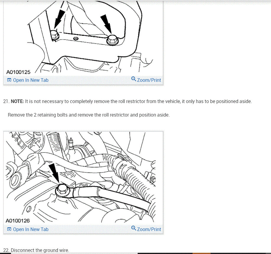

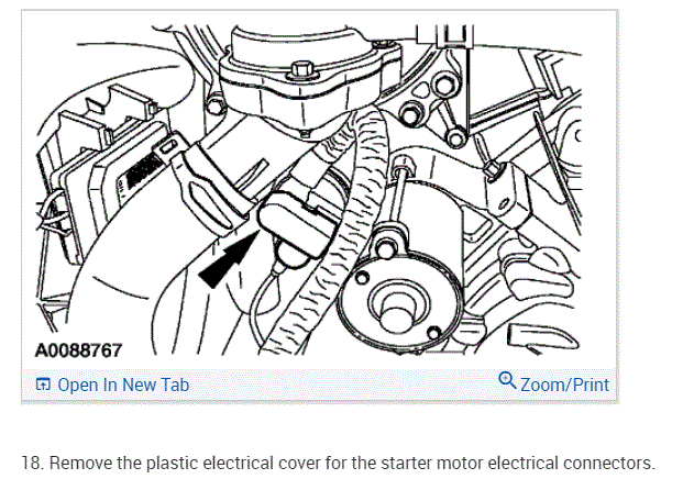

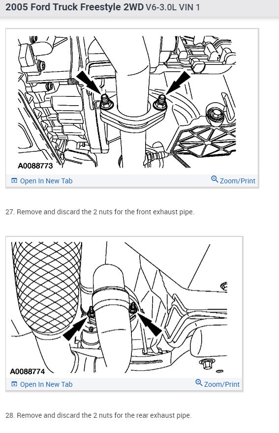

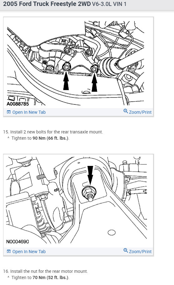

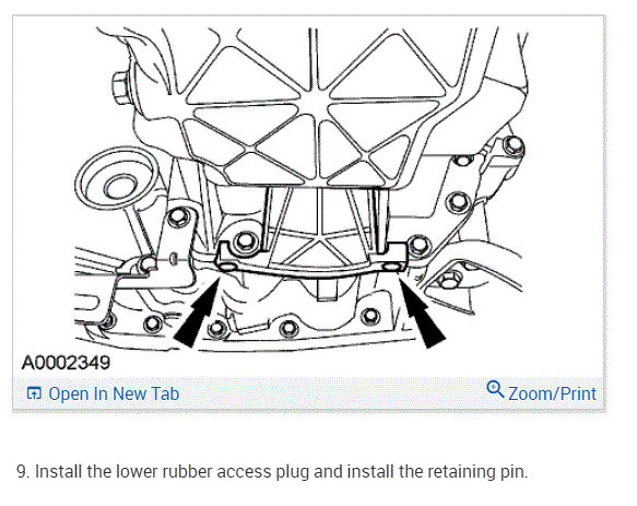

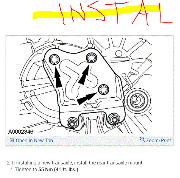

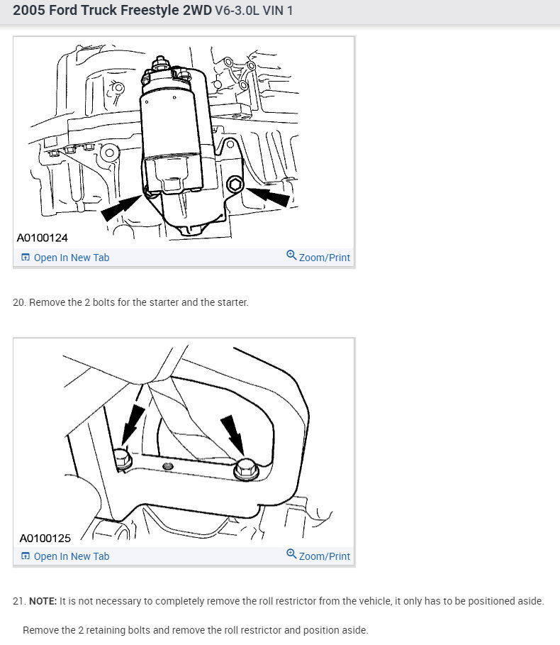

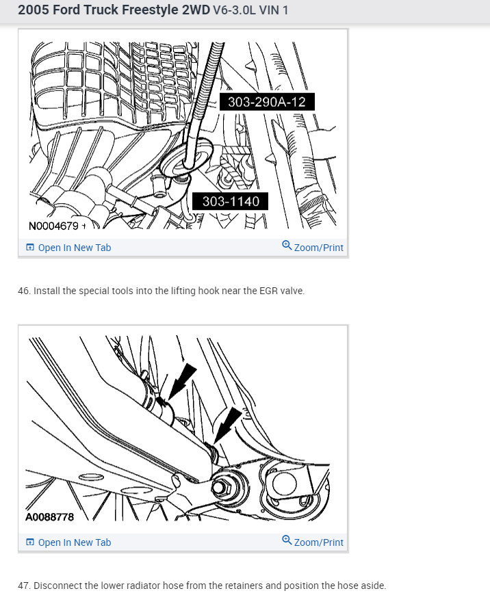

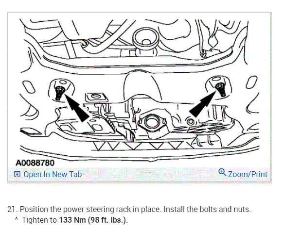

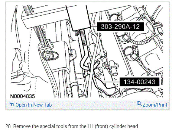

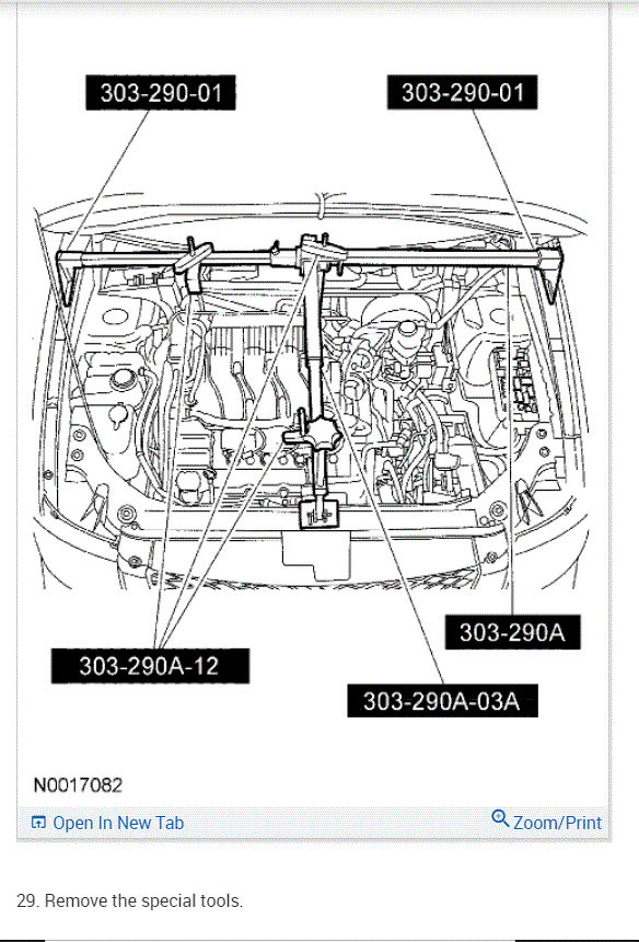

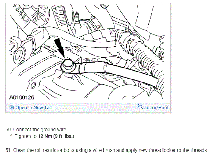

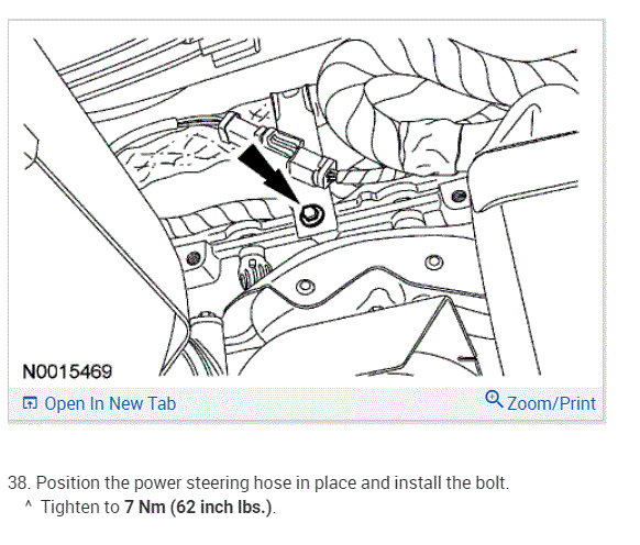

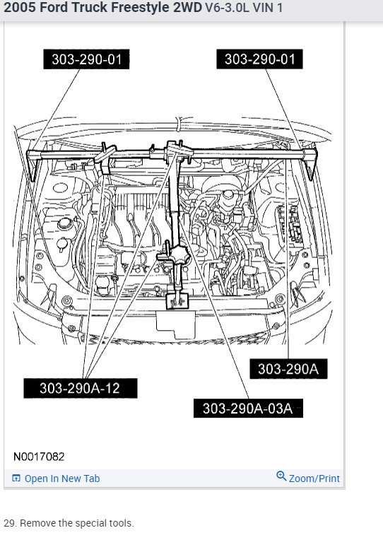

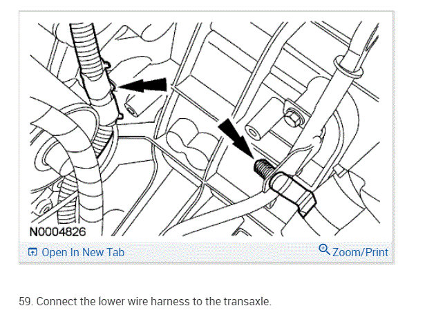

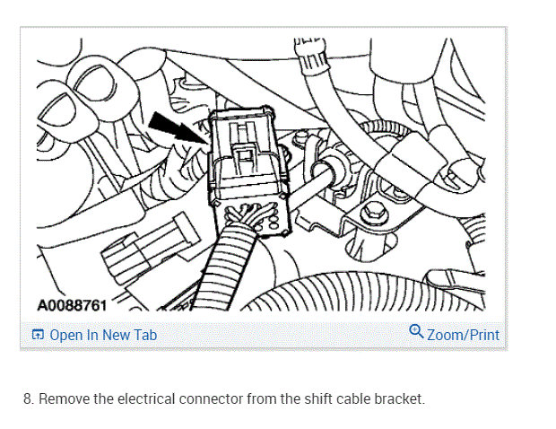

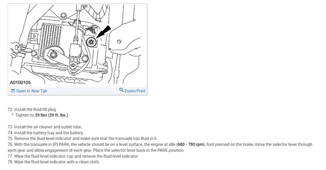

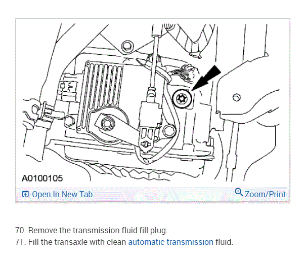

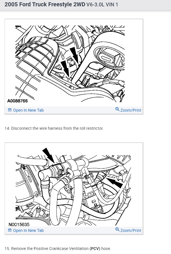

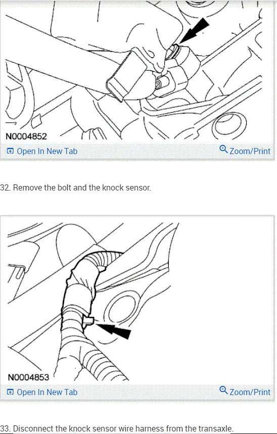

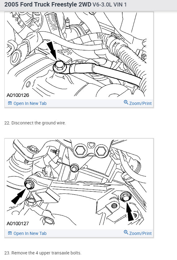

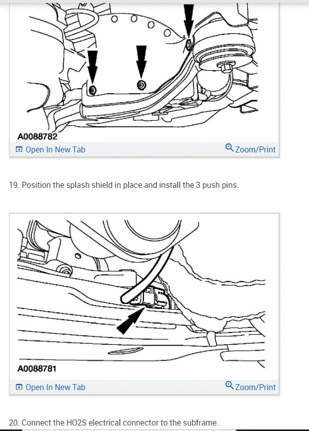

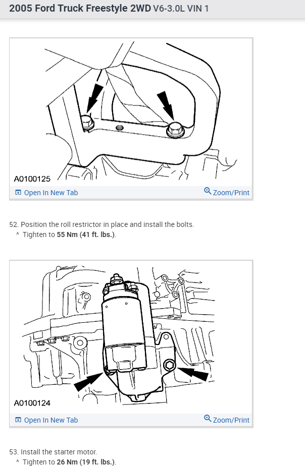

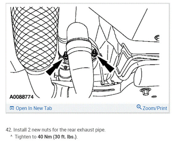

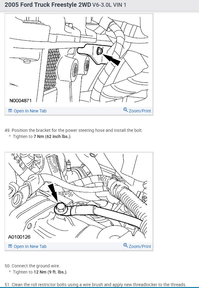

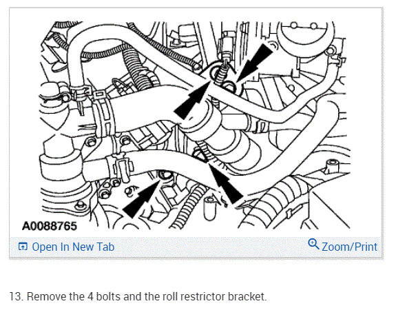

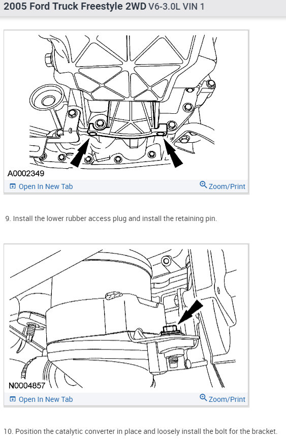

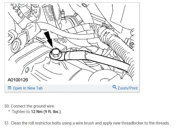

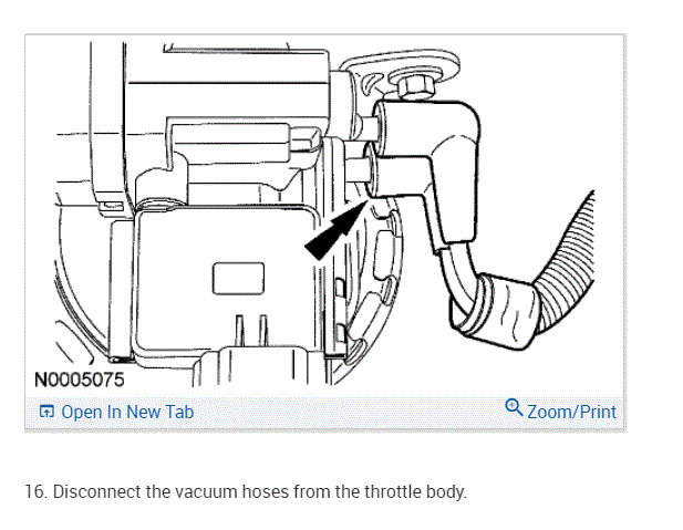

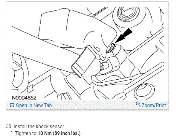

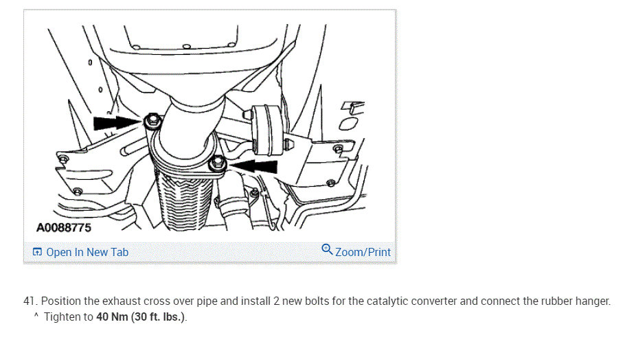

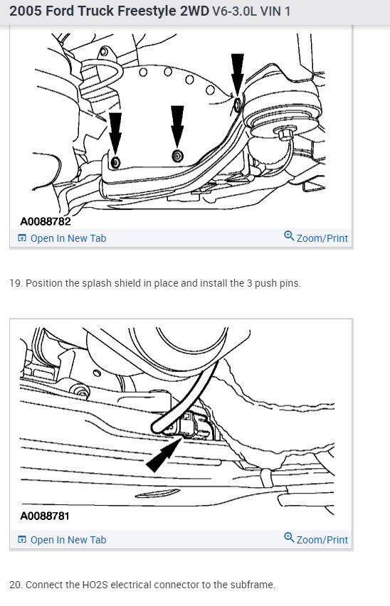

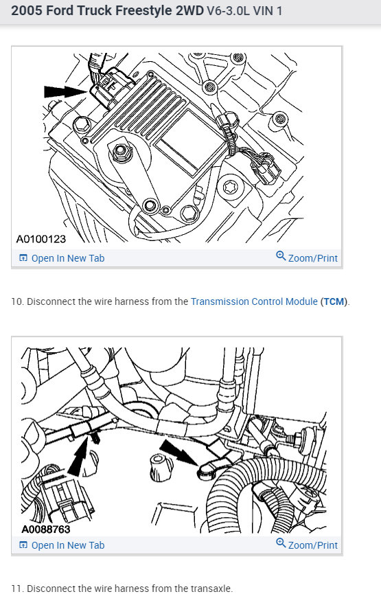

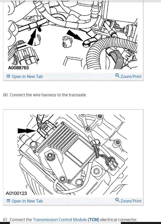

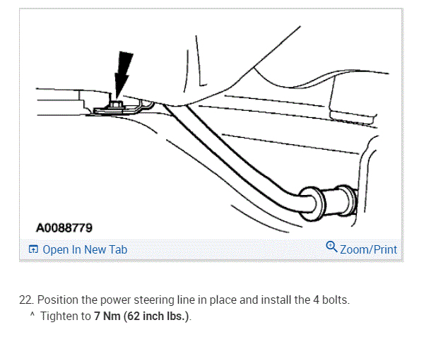

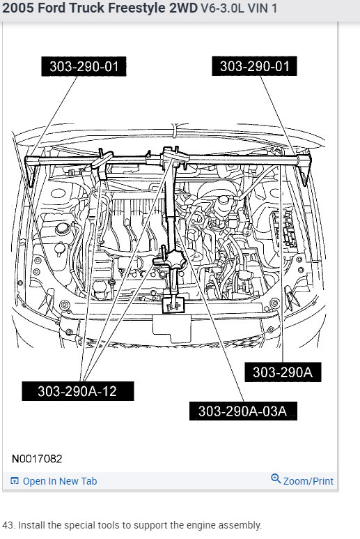

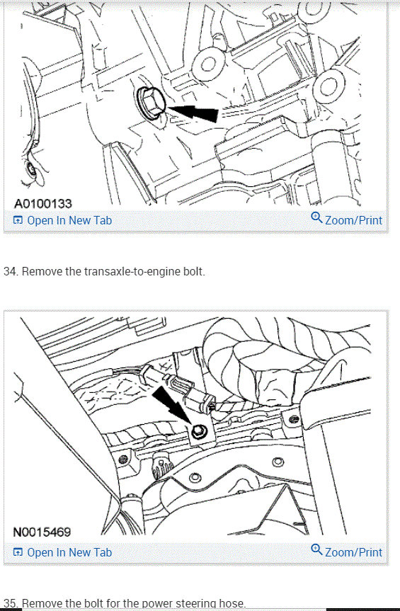

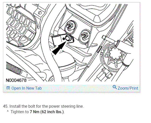

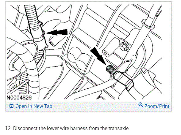

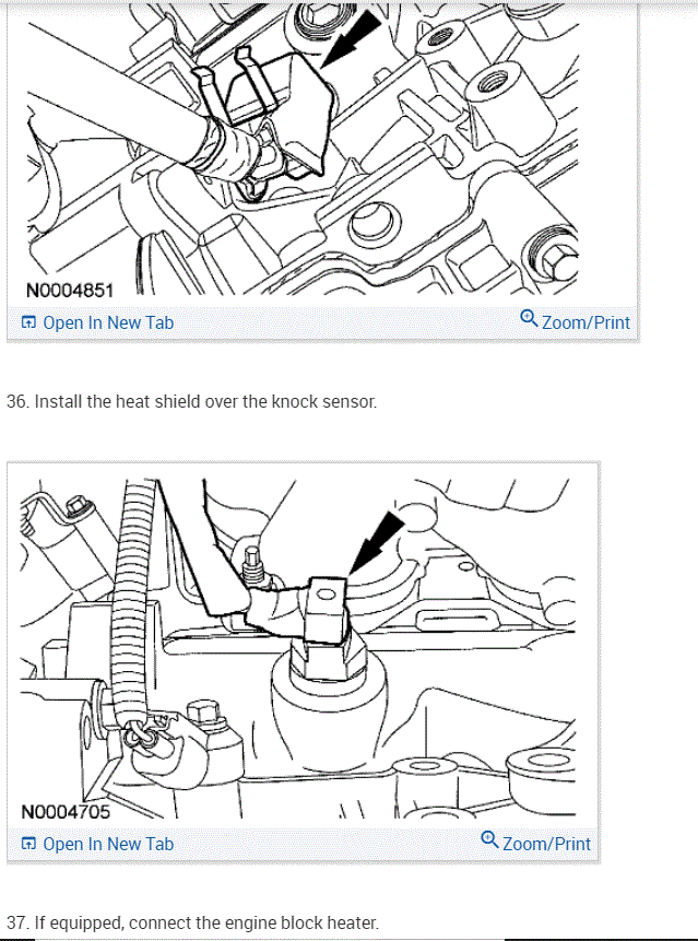

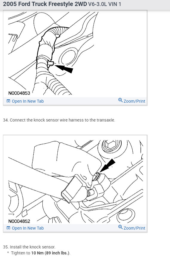

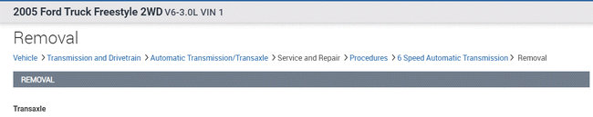

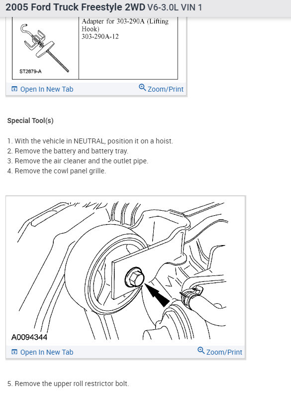

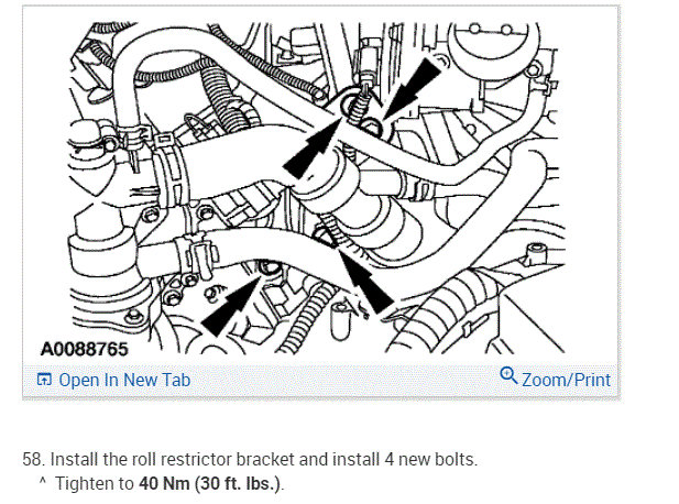

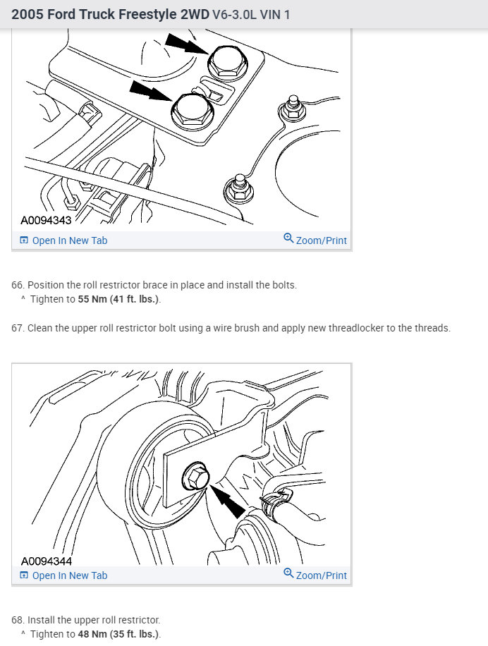

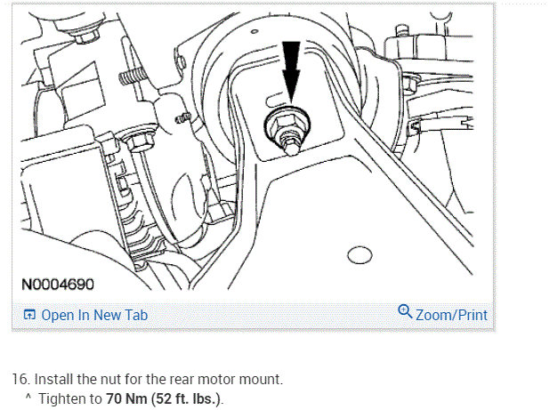

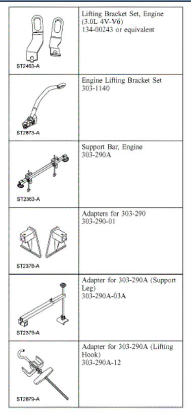

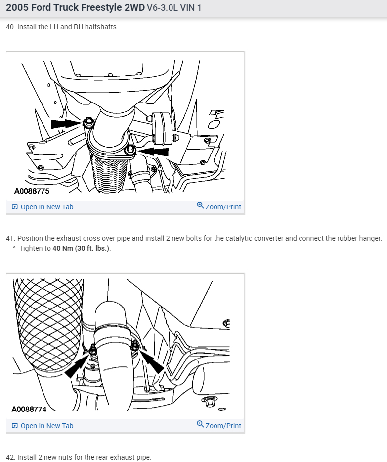

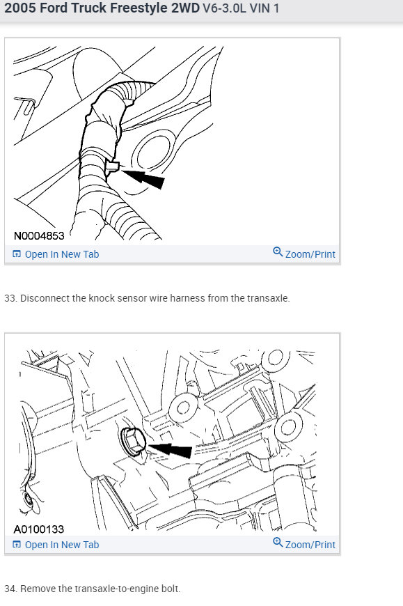

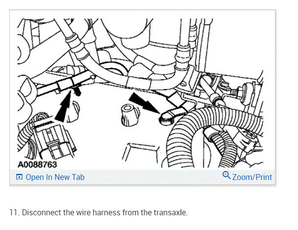

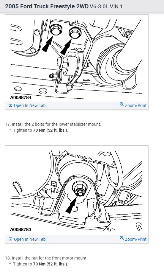

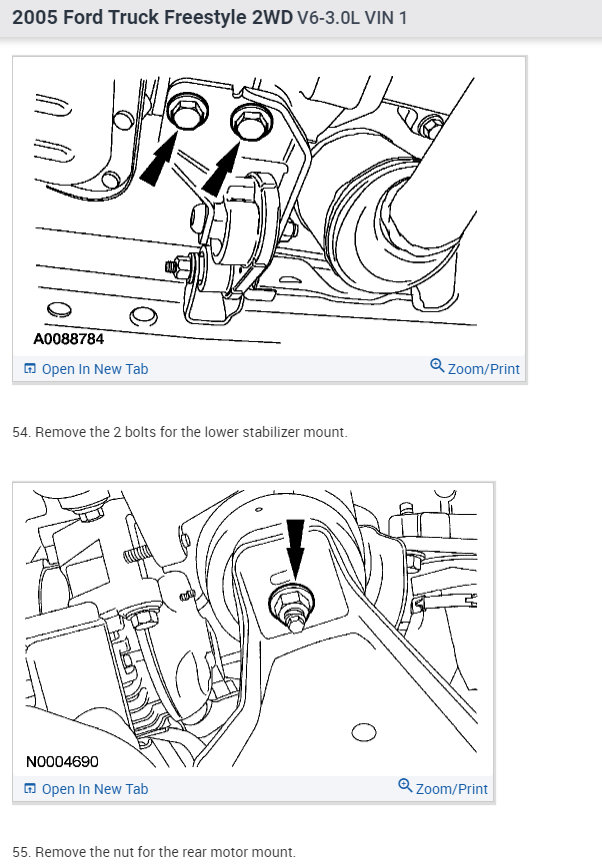

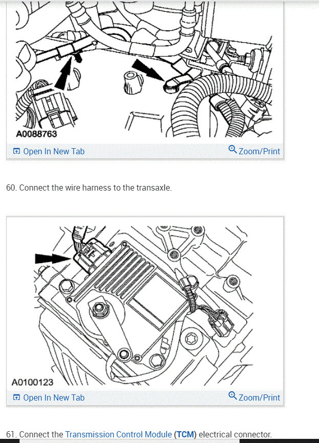

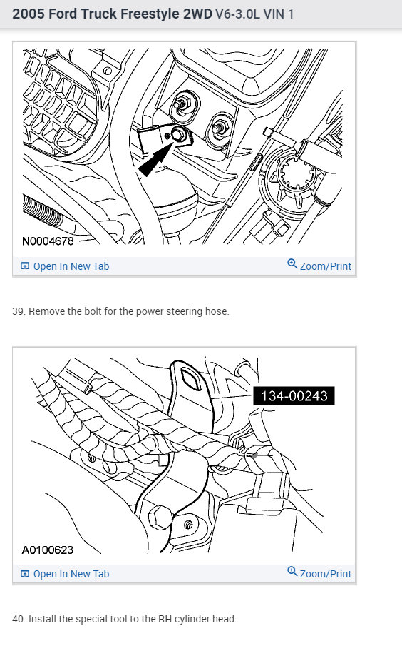

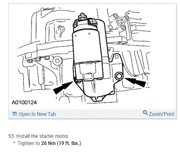

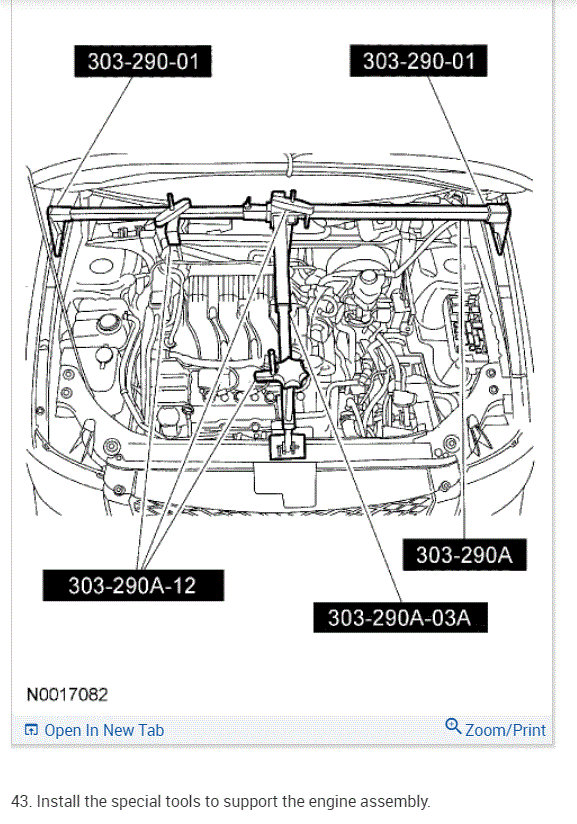

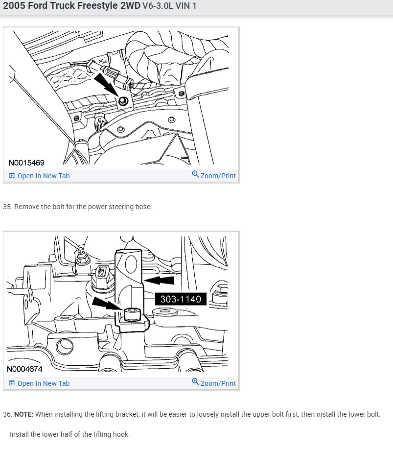

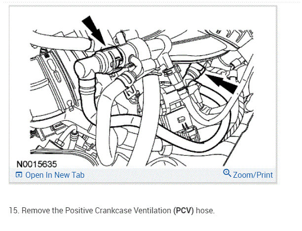

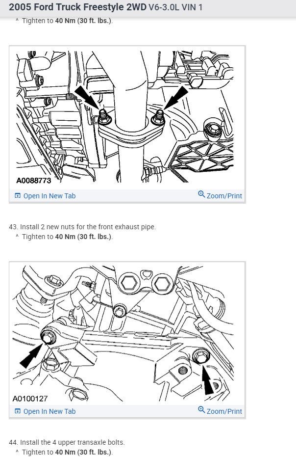

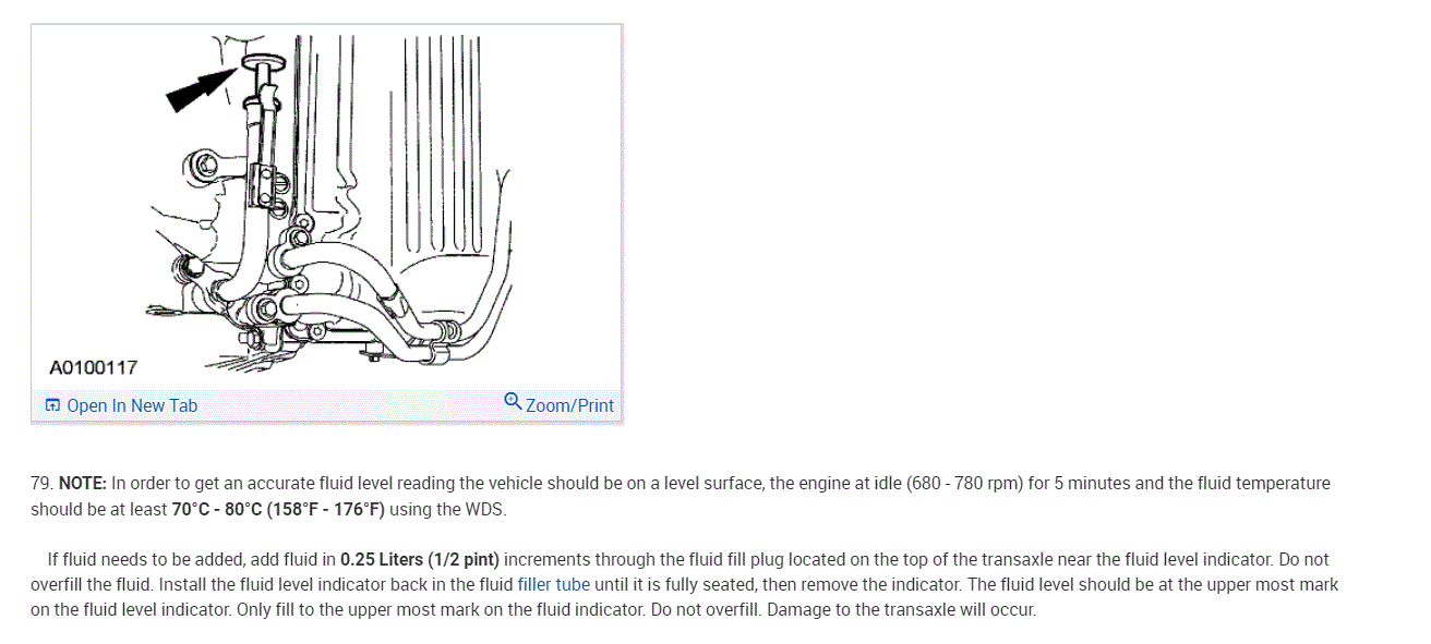

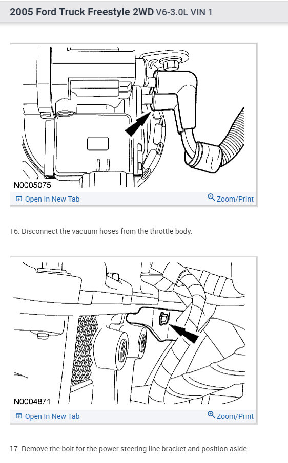

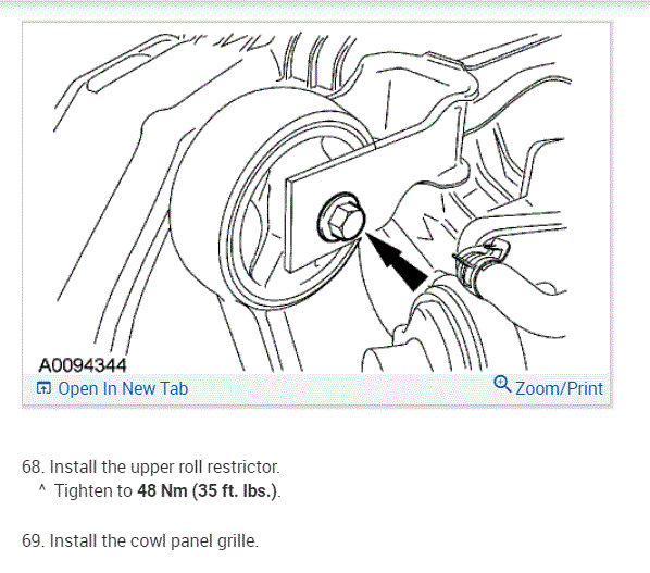

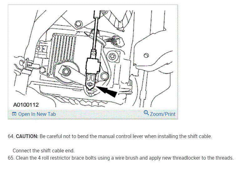

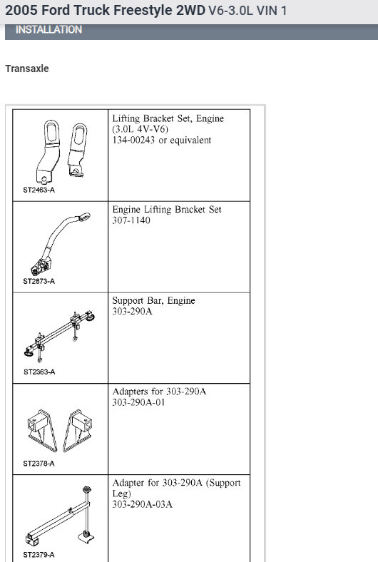

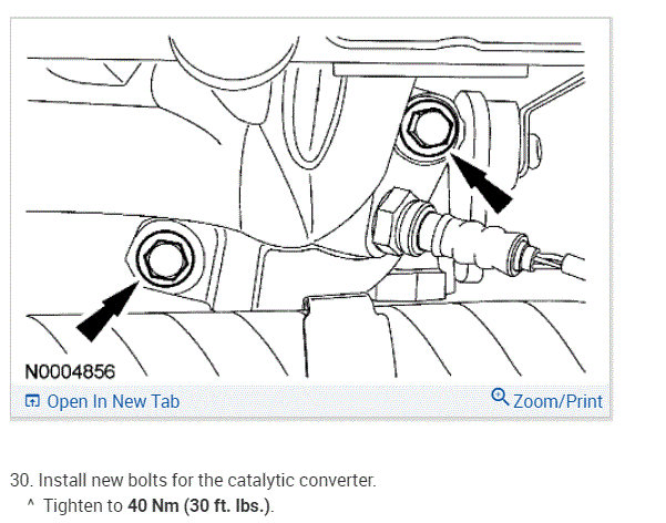

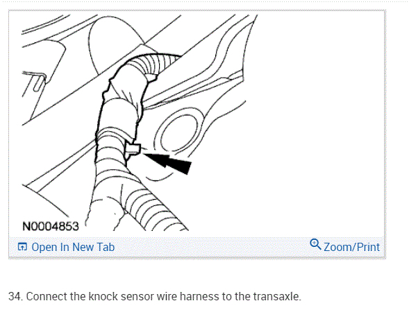

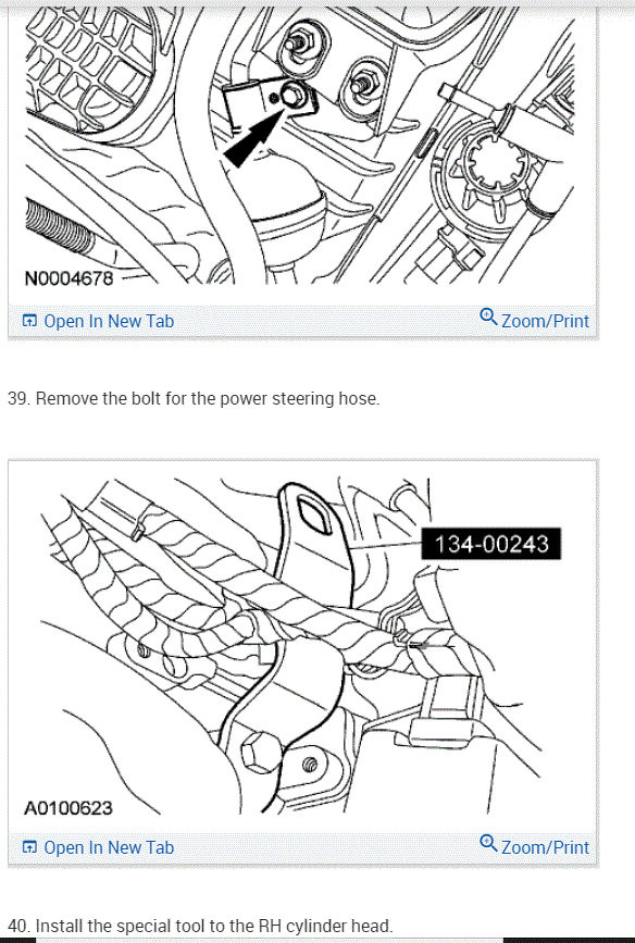

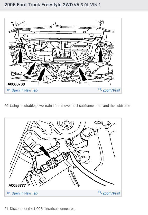

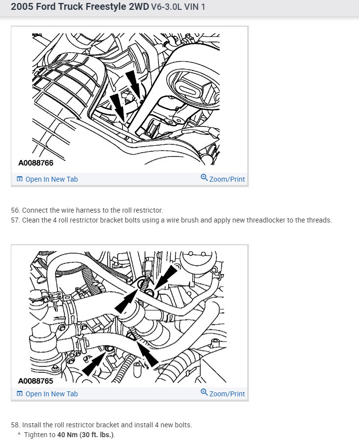

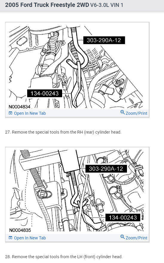

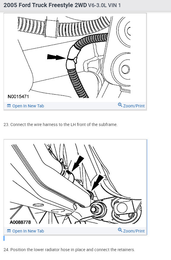

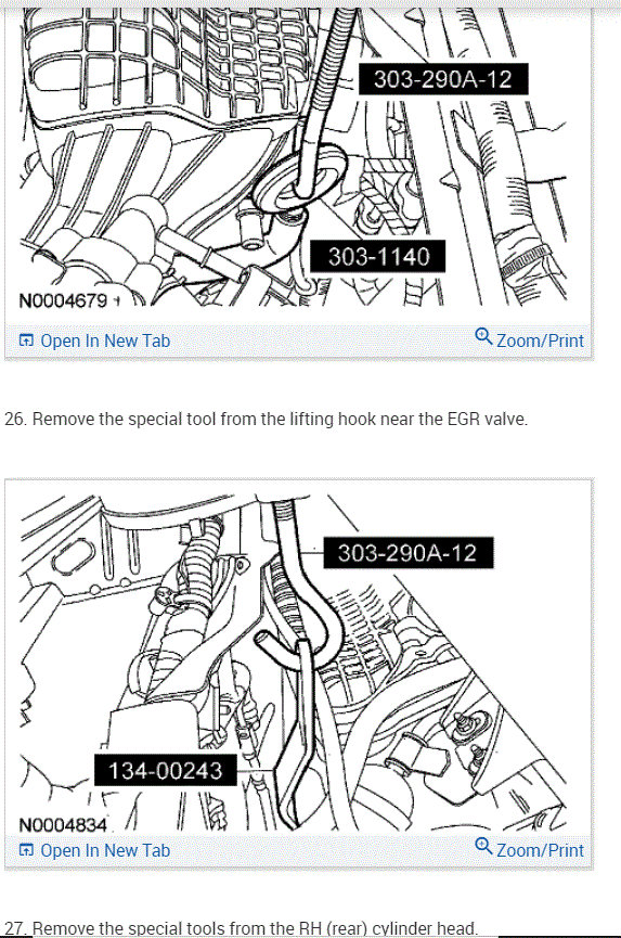

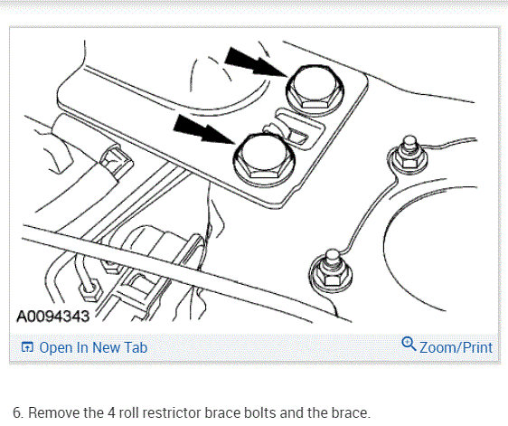

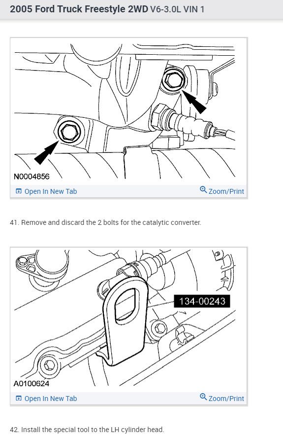

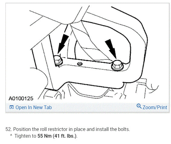

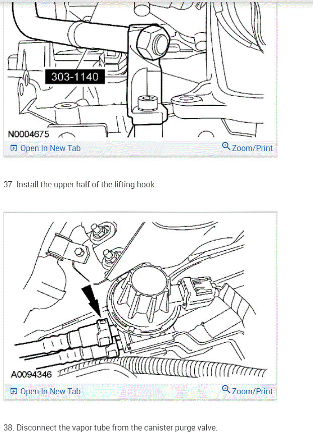

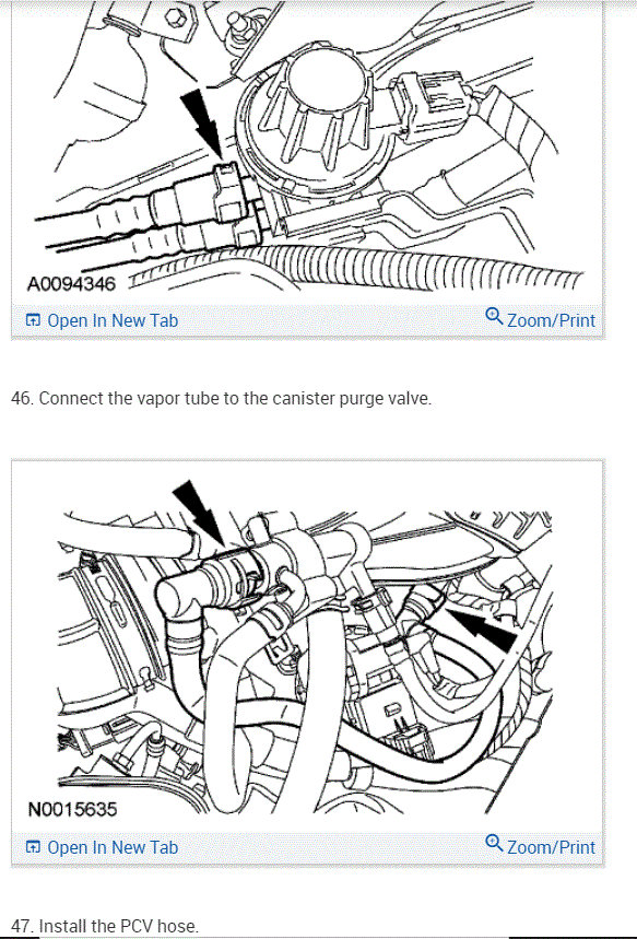

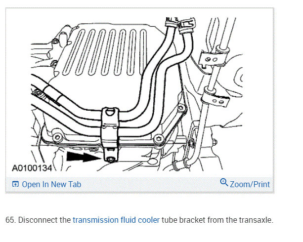

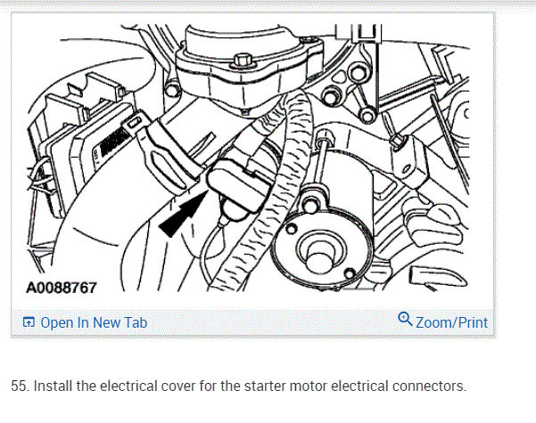

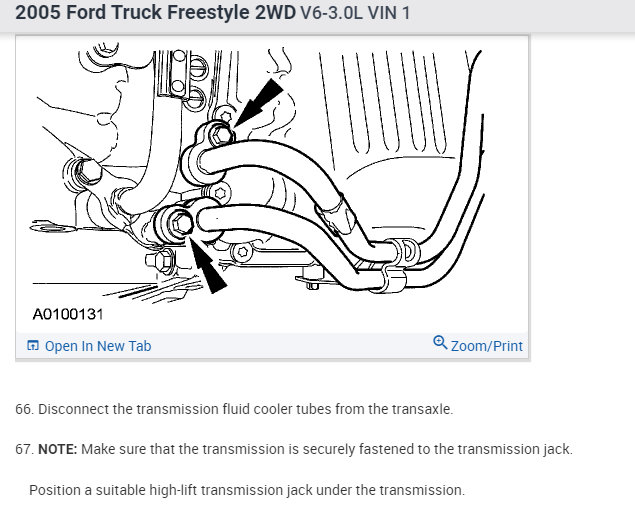

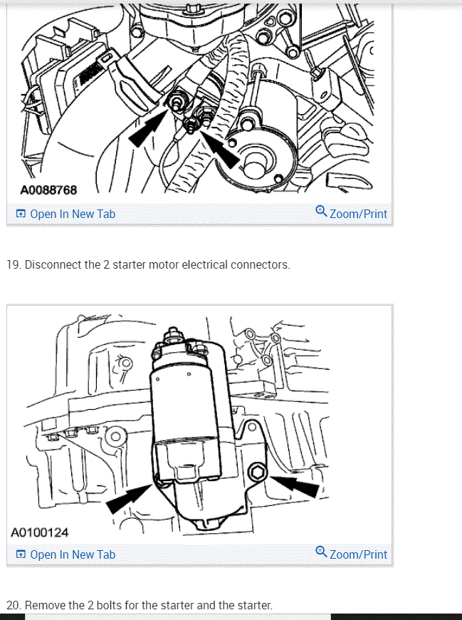

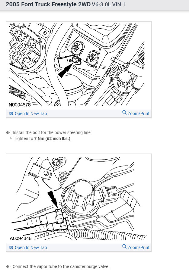

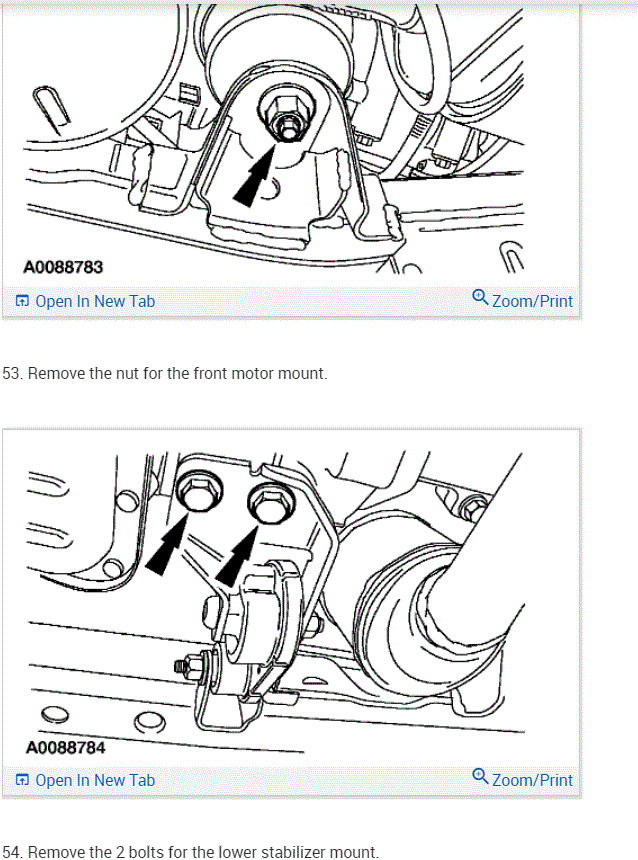

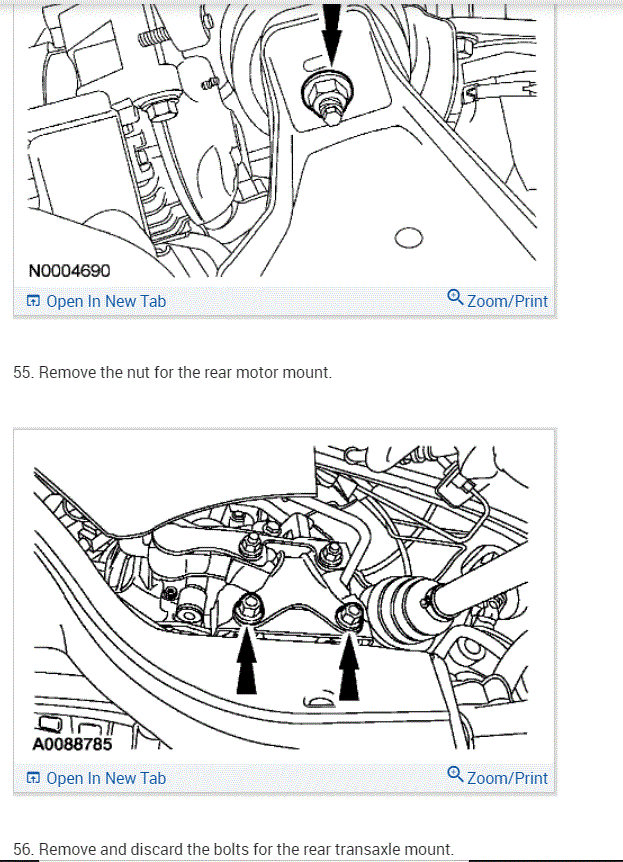

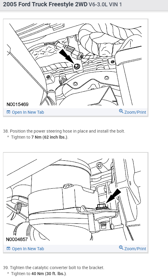

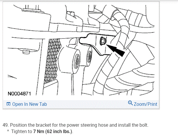

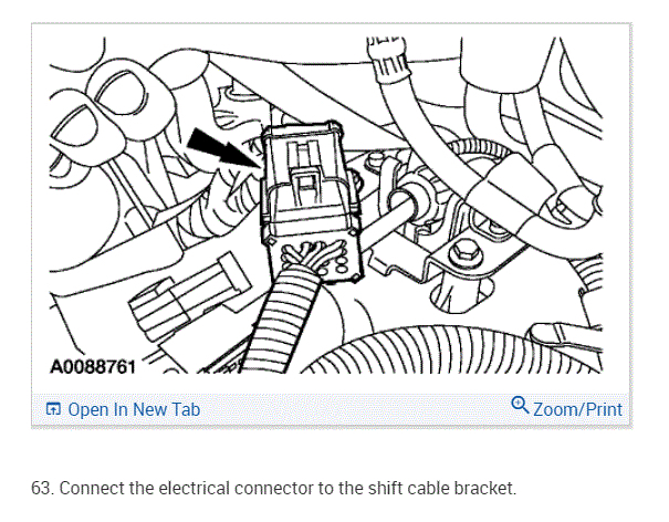

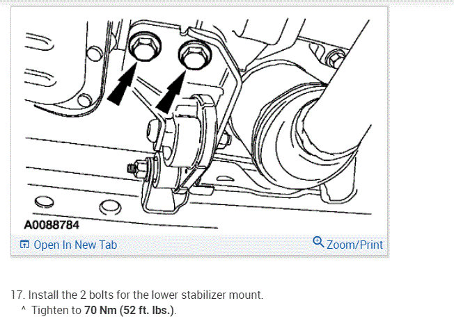

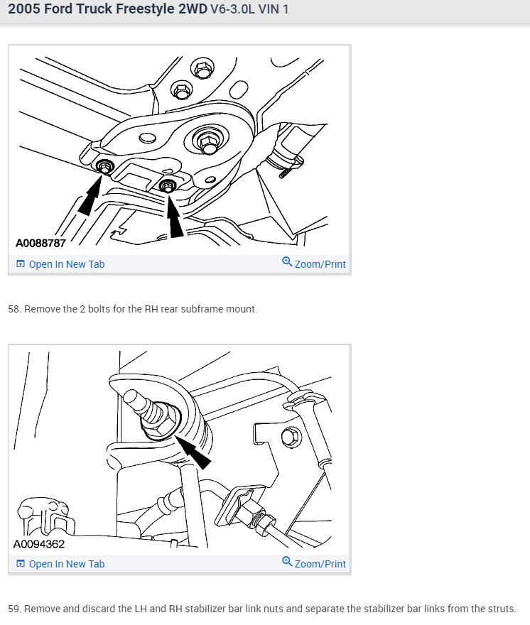

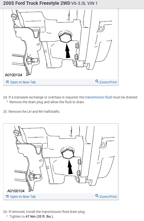

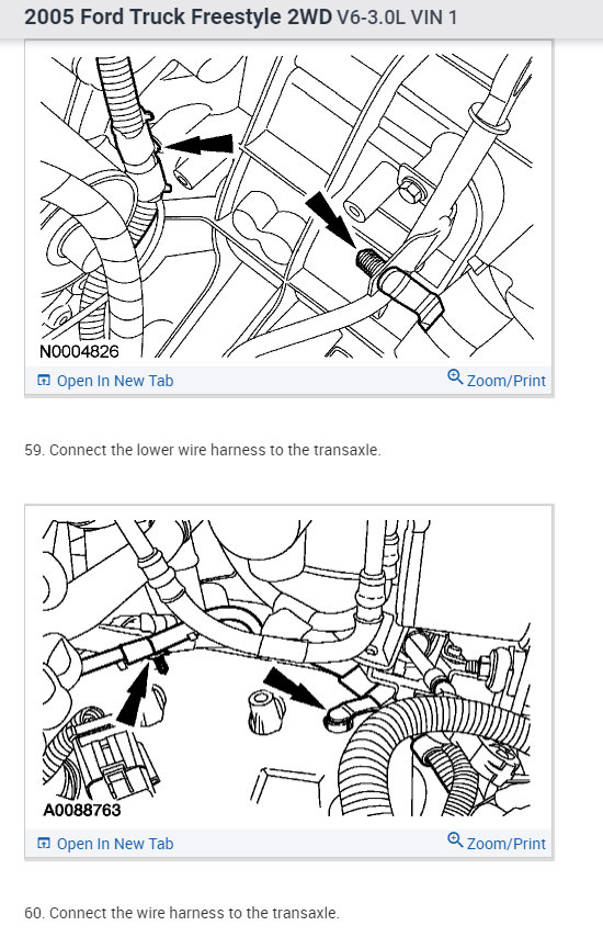

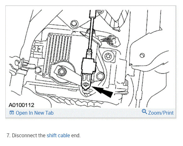

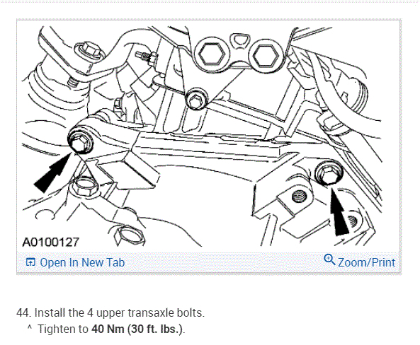

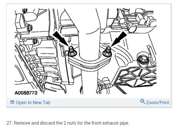

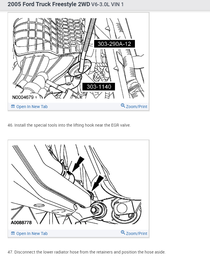

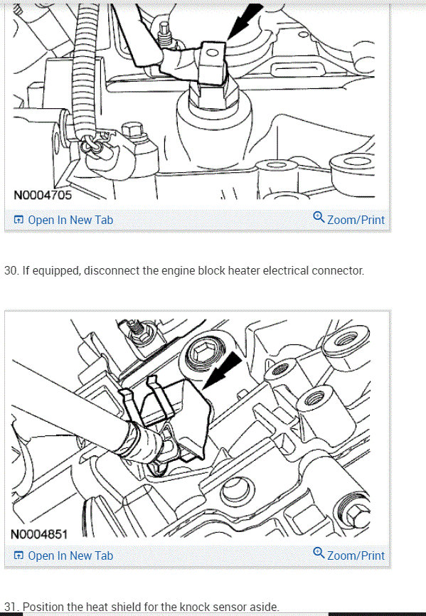

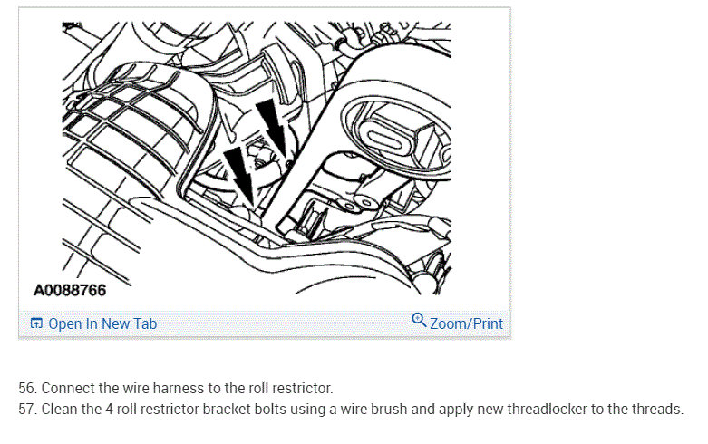

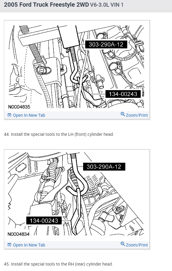

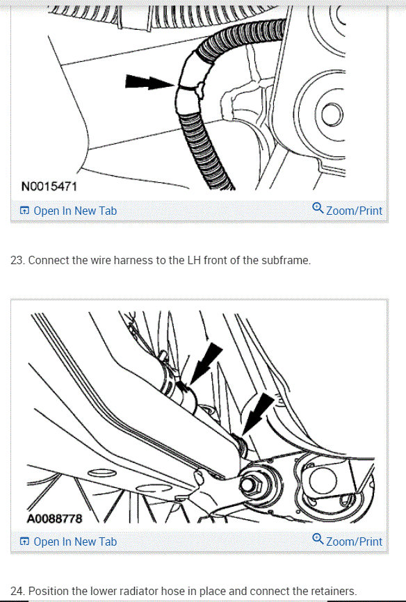

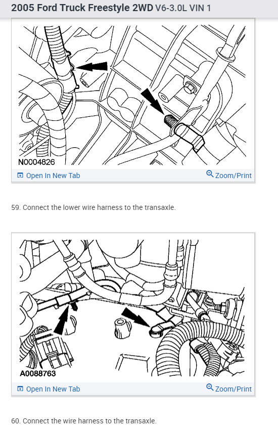

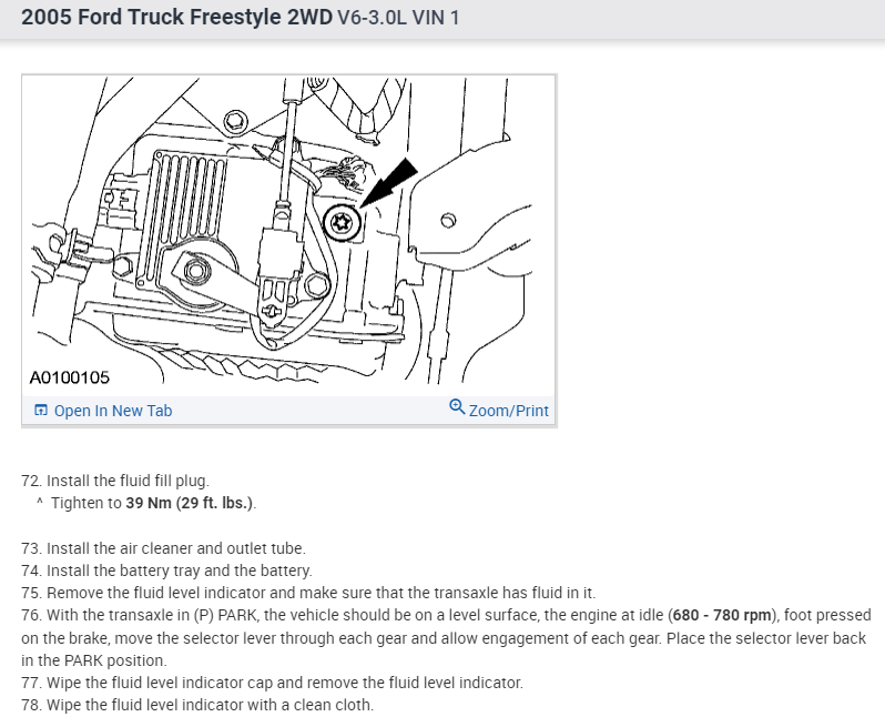

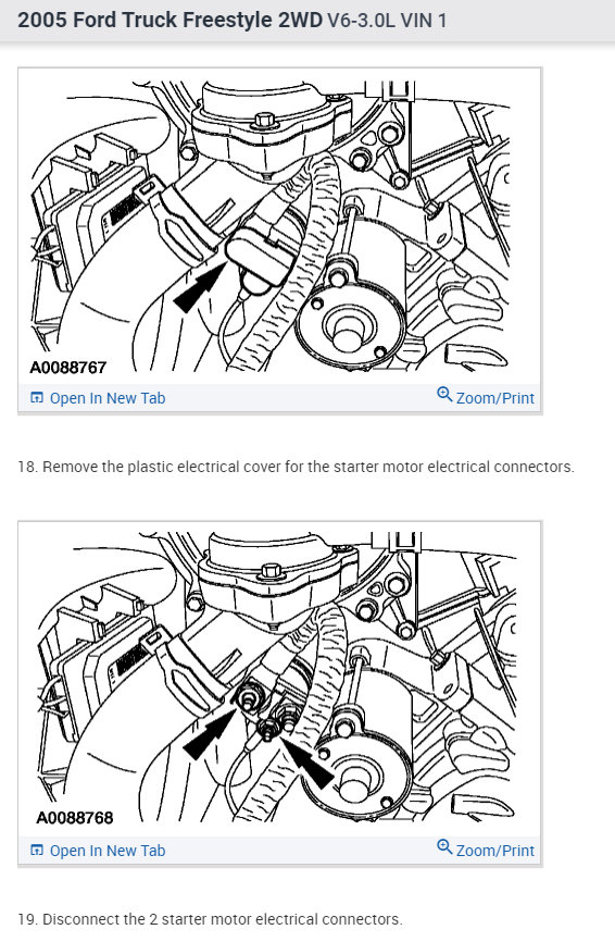

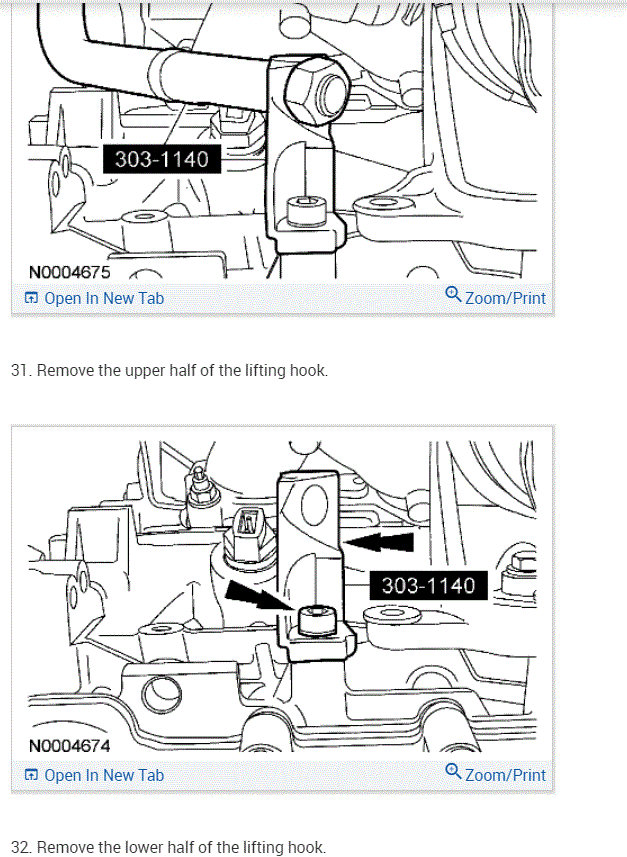

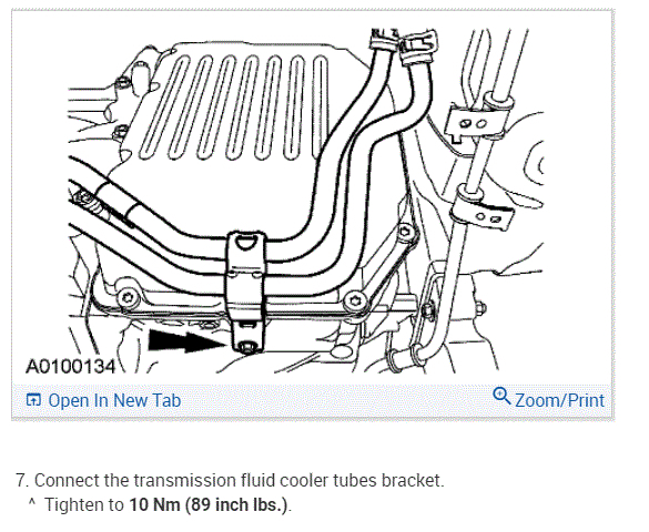

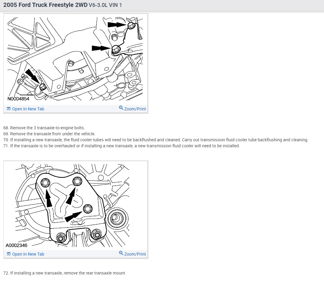

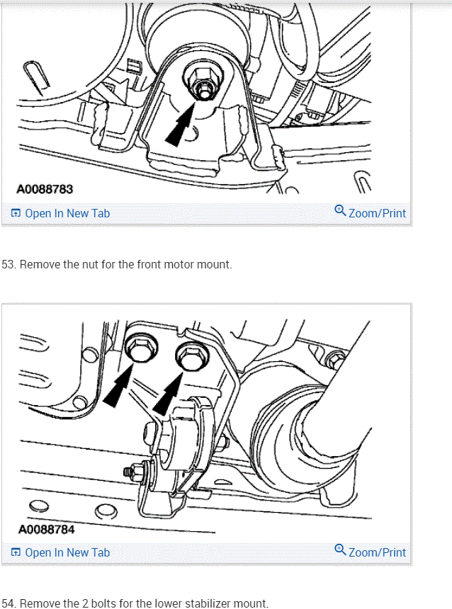

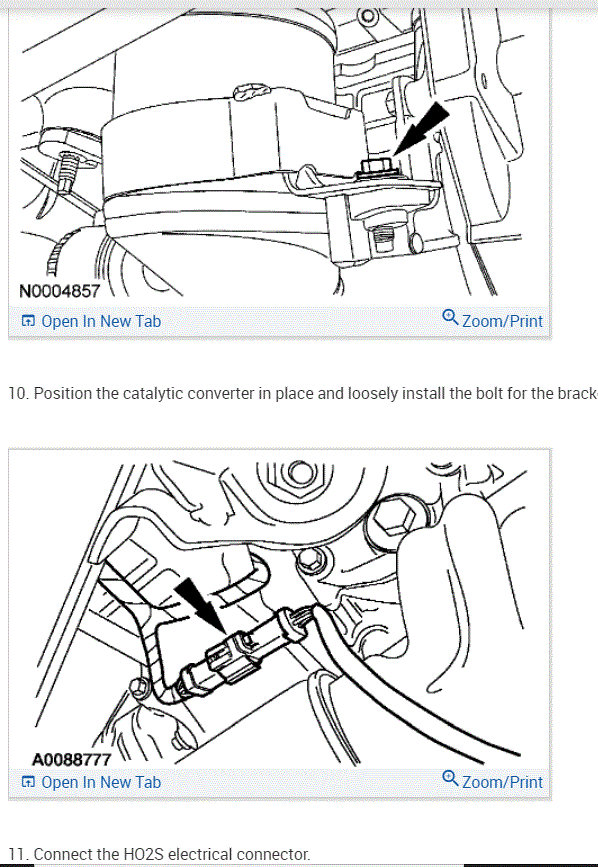

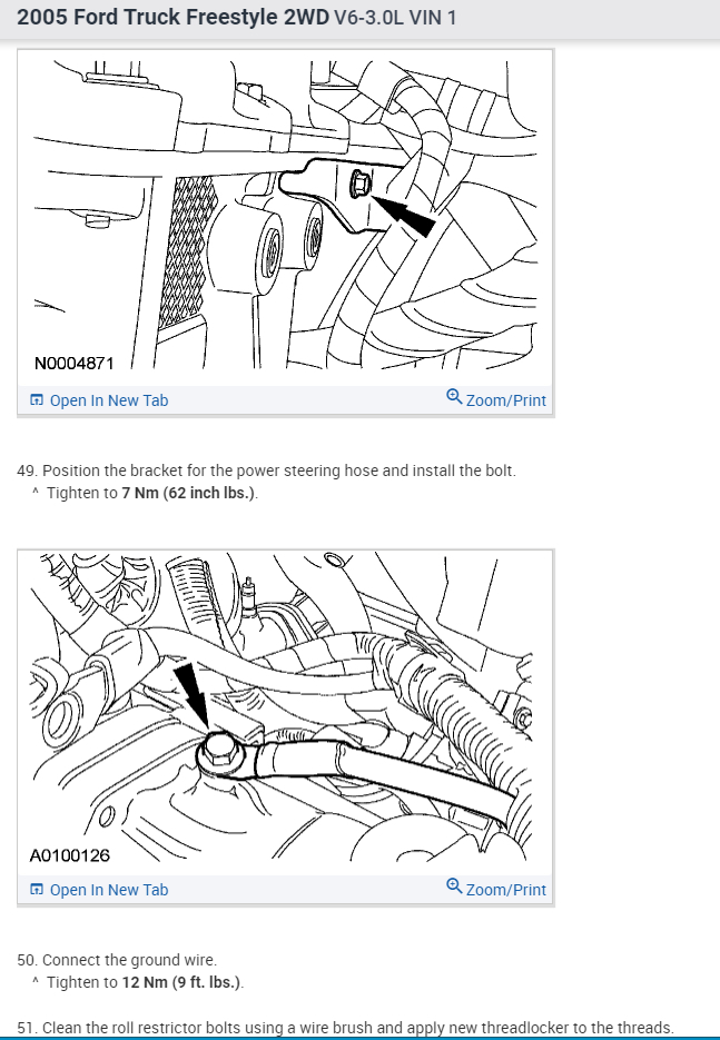

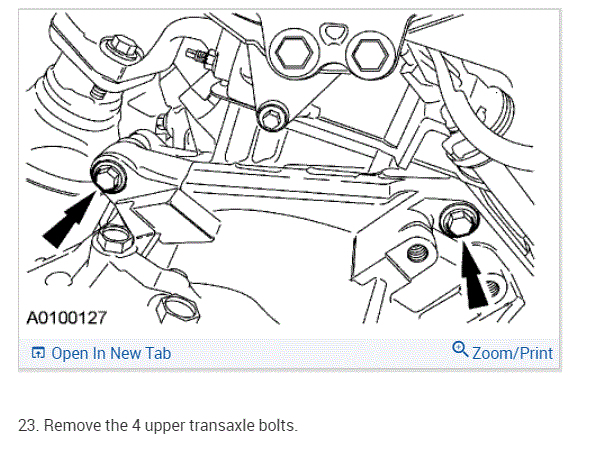

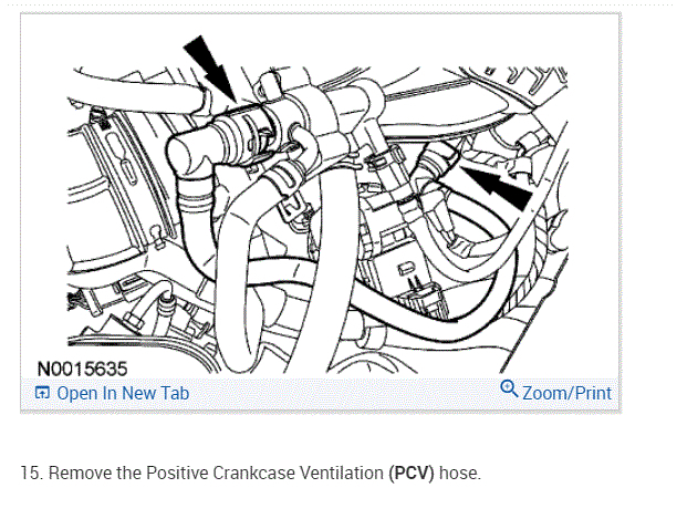

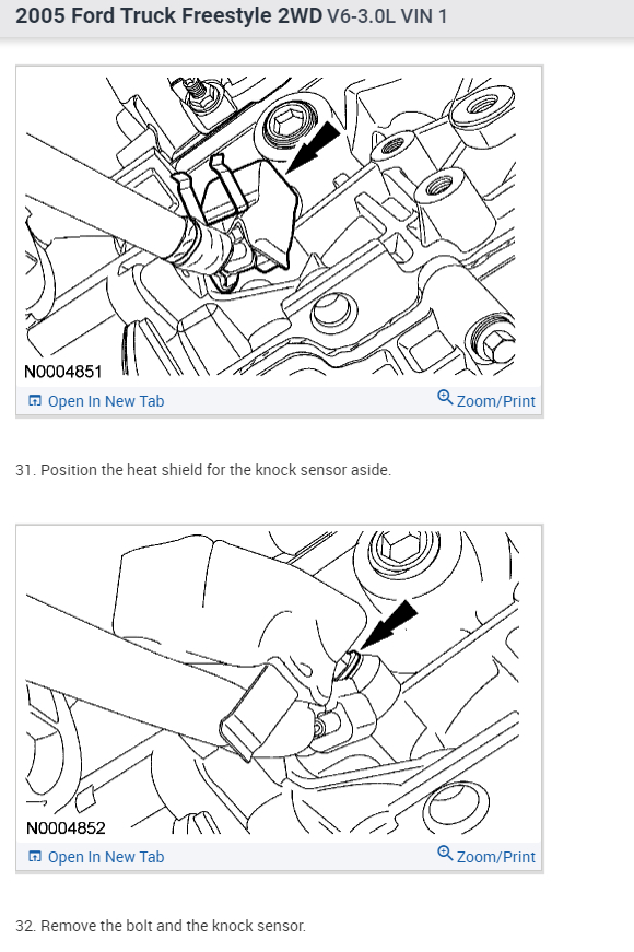

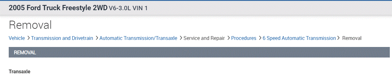

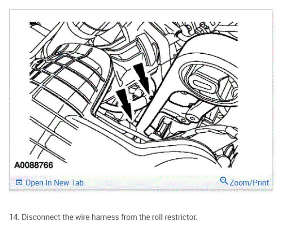

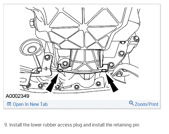

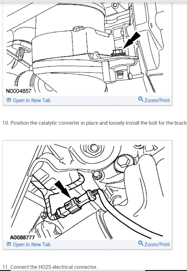

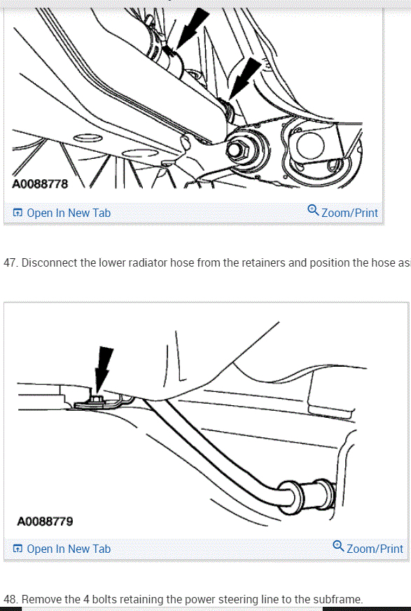

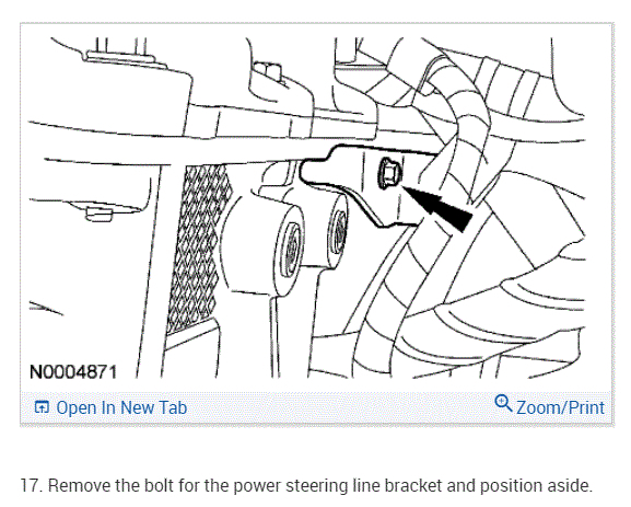

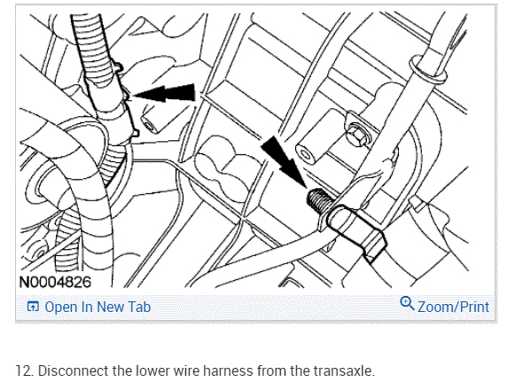

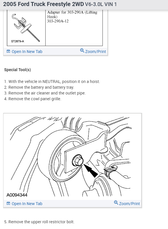

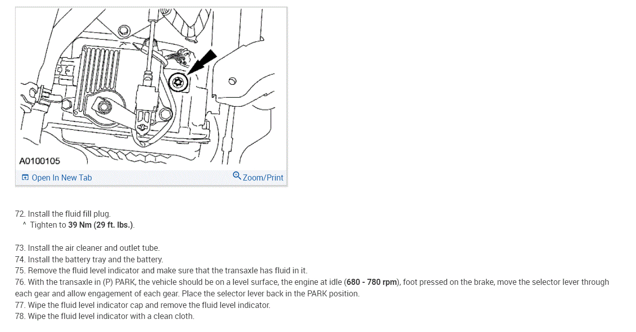

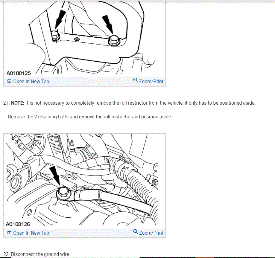

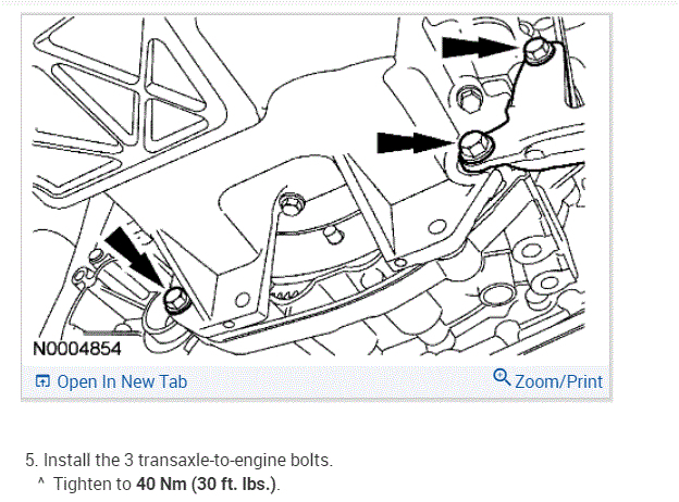

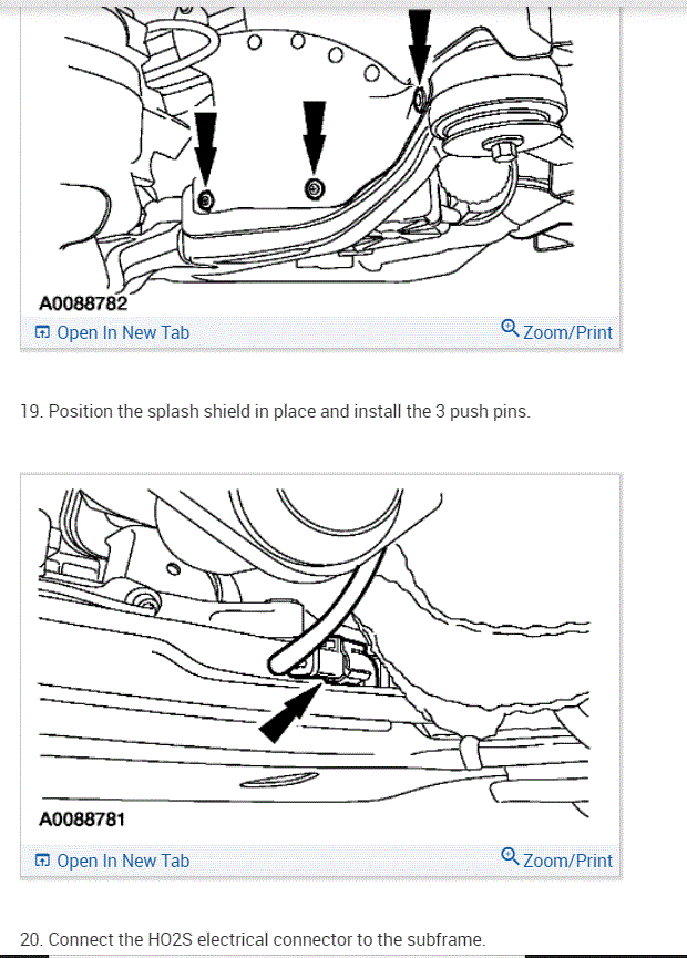

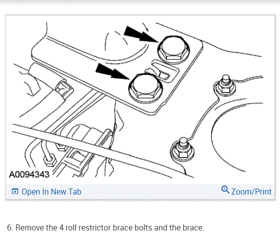

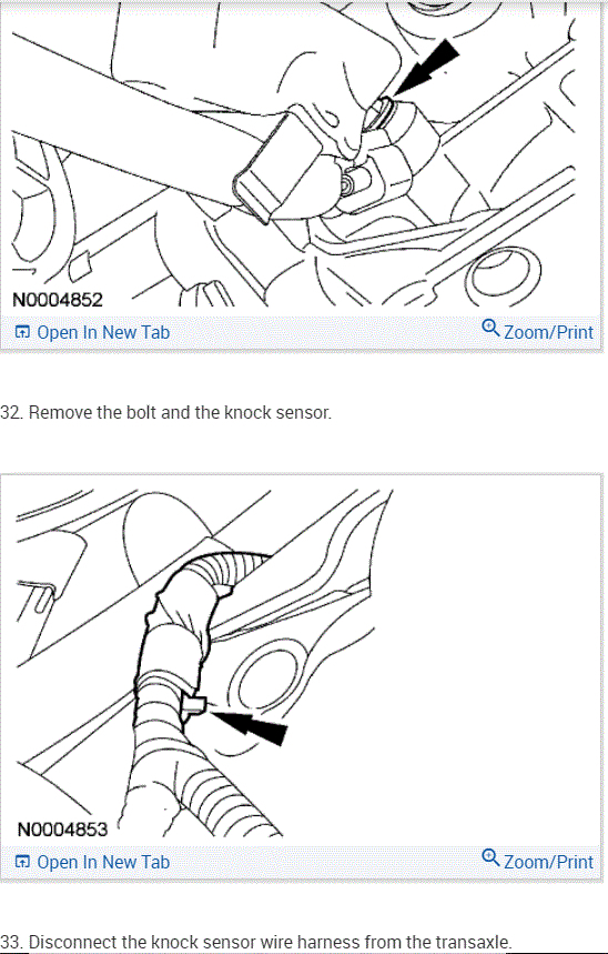

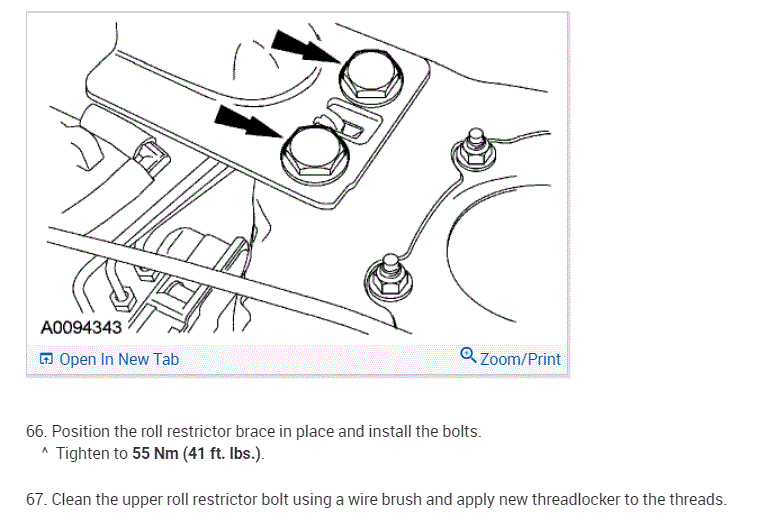

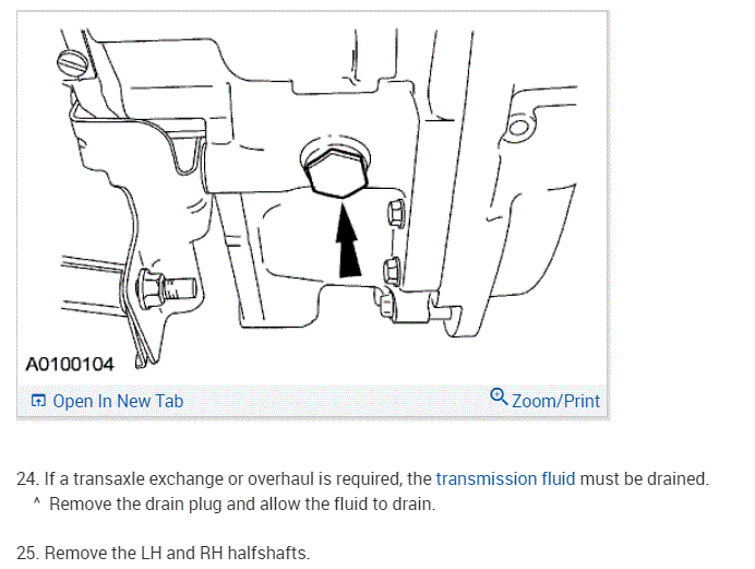

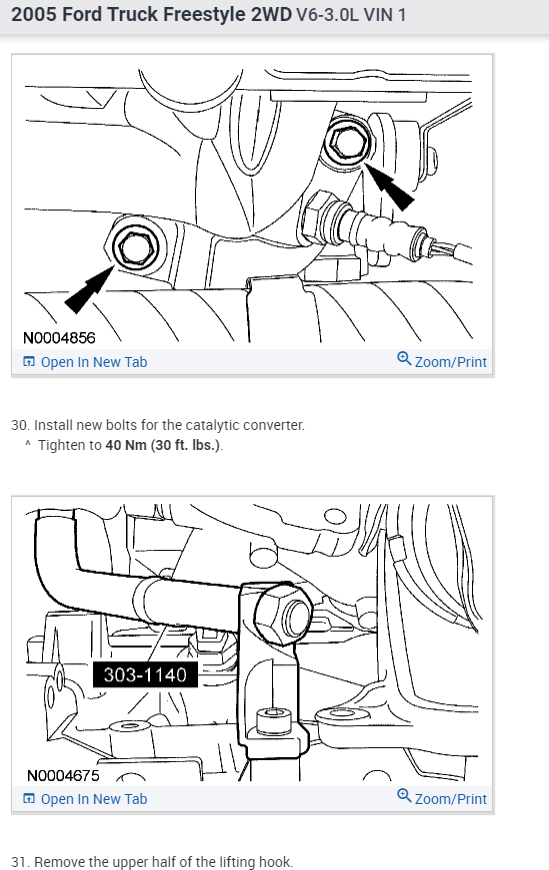

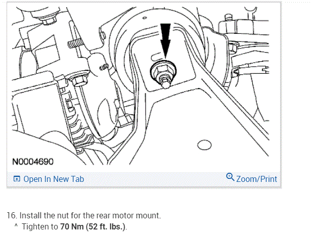

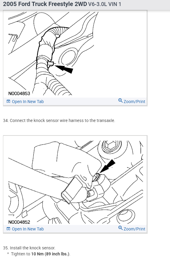

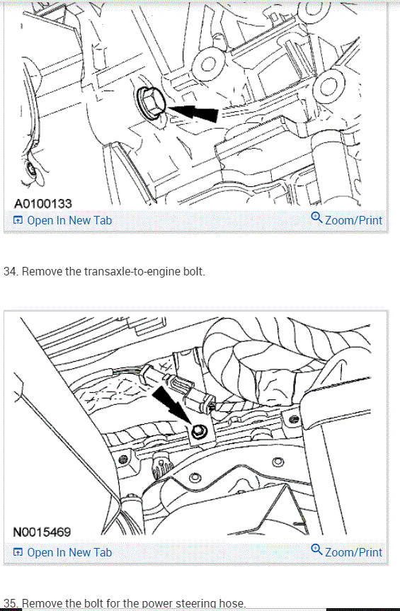

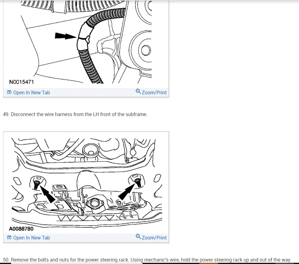

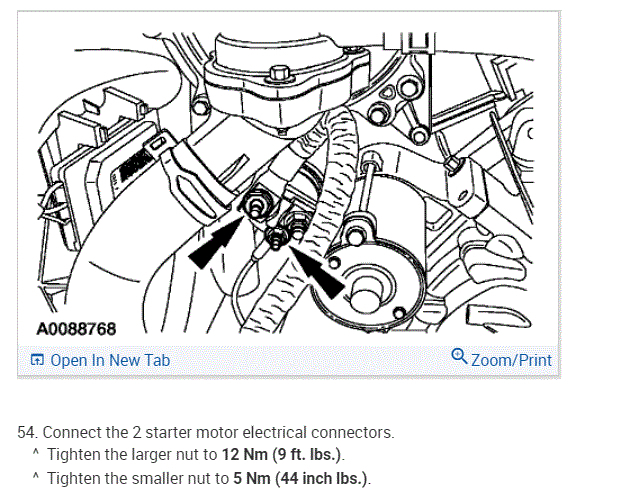

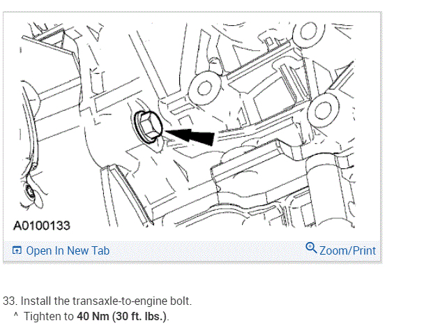

This is a big job that will require special tooling. You will need an engine support to hold the engine in place when removing the transmission.
I included the removal and installation directions below. They are quite extensive but don't be overwhelmed.
Take a look through these and let me know if you have questions.

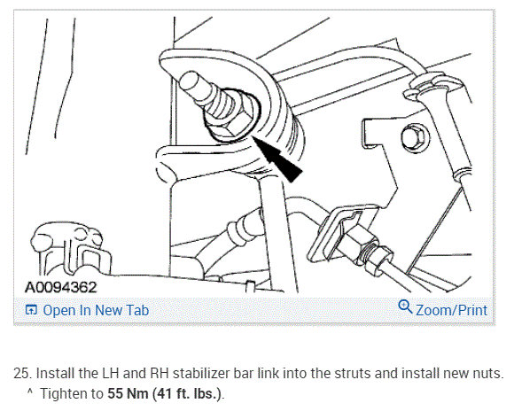

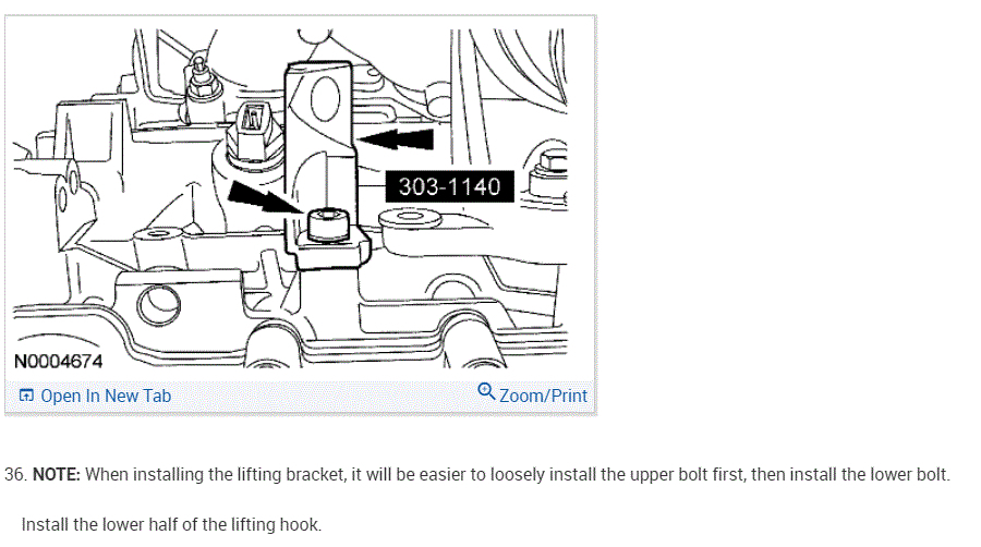

See attached for the complete replacement procedure for the transmission, including all the torque specifications and needed special tools.
Let me know of any questions.
https://www.2carpros.com/articles/how-to-remove-an-automatic-transmission-rwd
