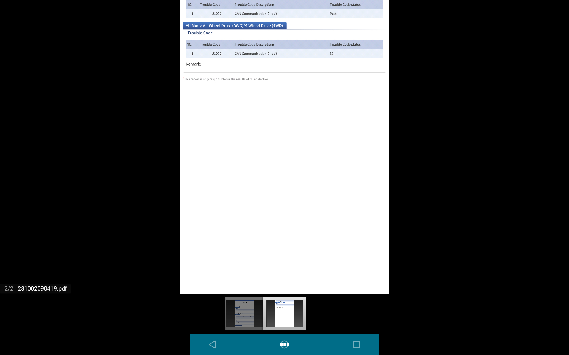

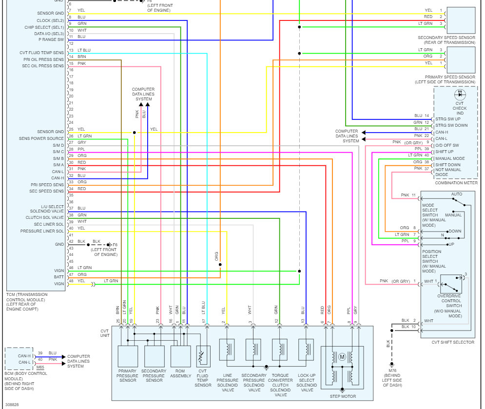

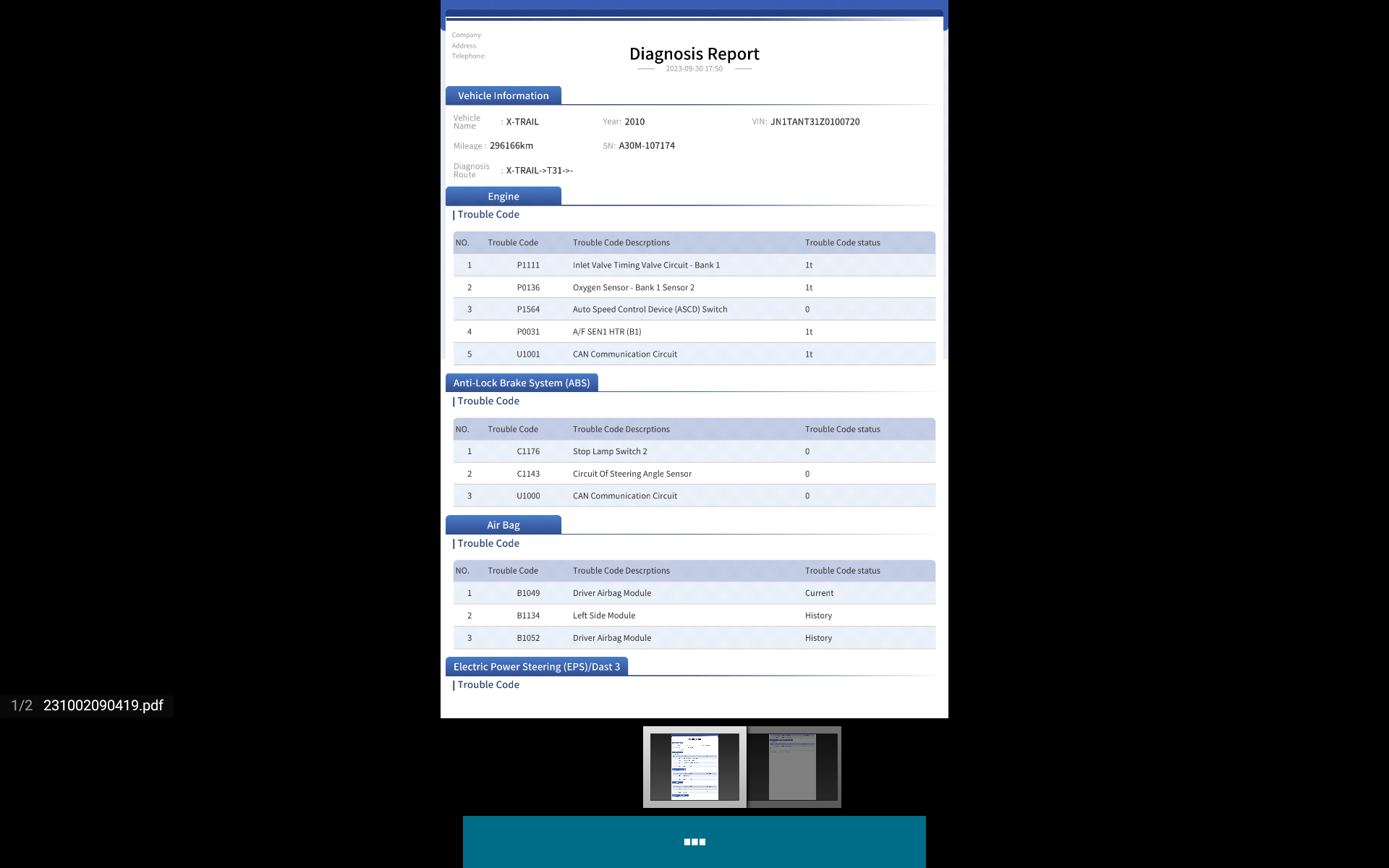

This vehicle started slow movement when engage gear and depressed the throttle pedal, later the transmission was replaced but problem still exist, then when I came to diagnose it, there was abnormal communication with TCM, I tried it many times and it fails to communicate. Please I need TC.
Oct 2, 2023 at 1:06 AM
  • 54,840 POSTS

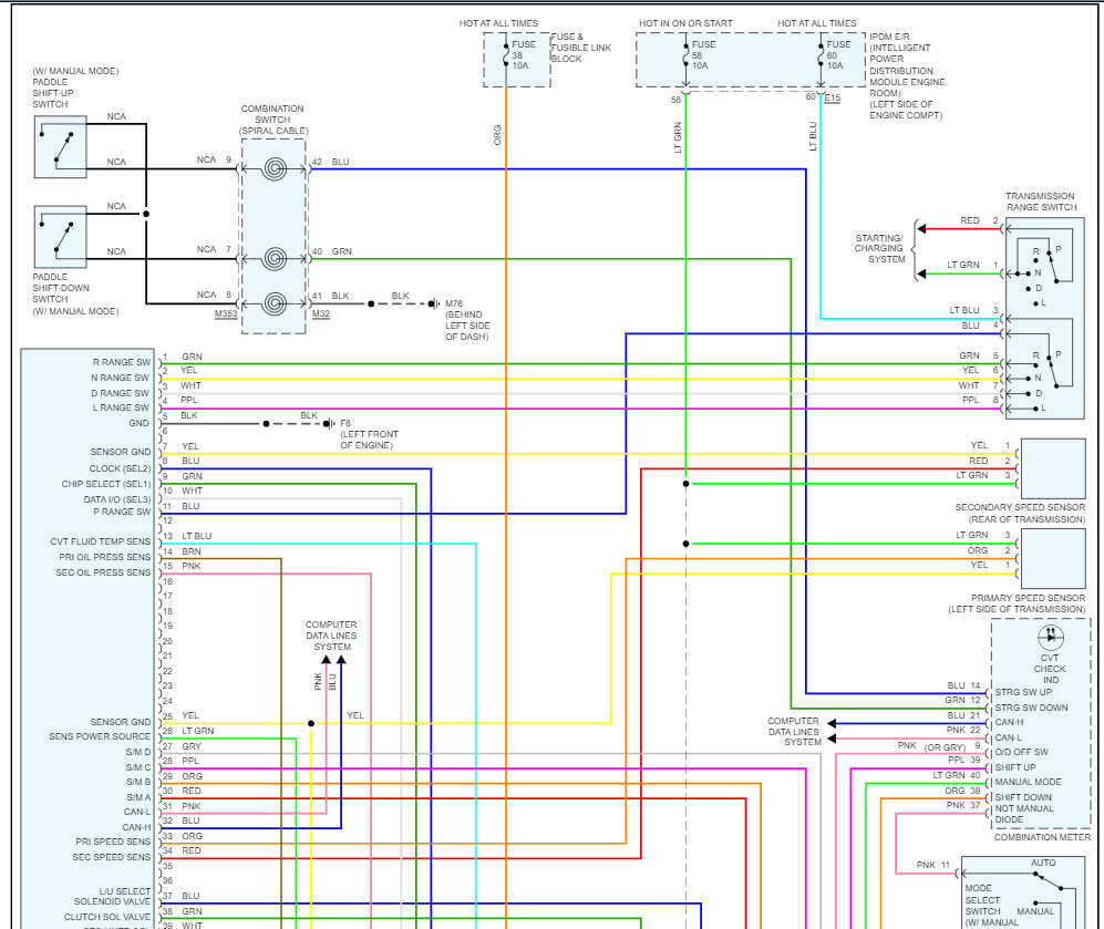

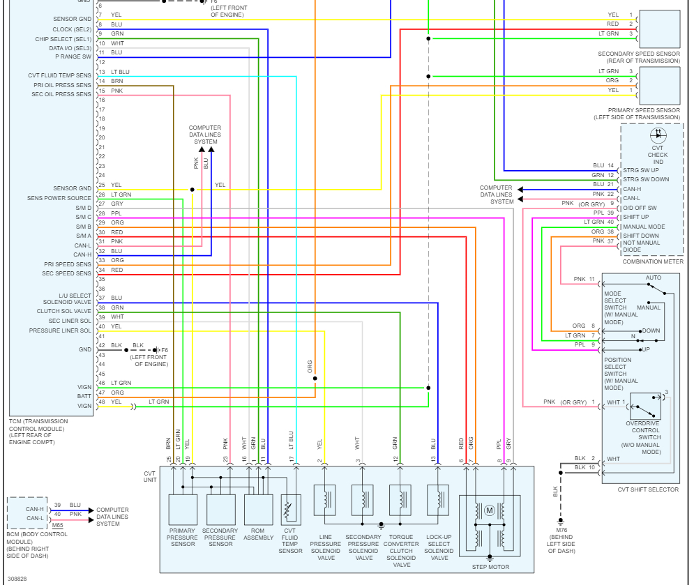

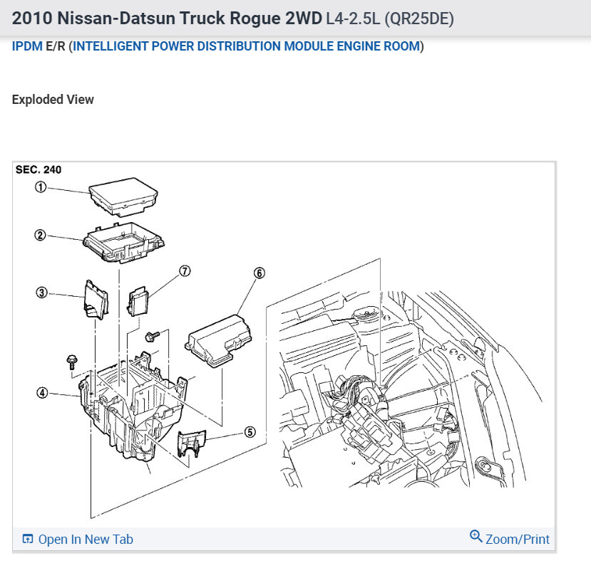

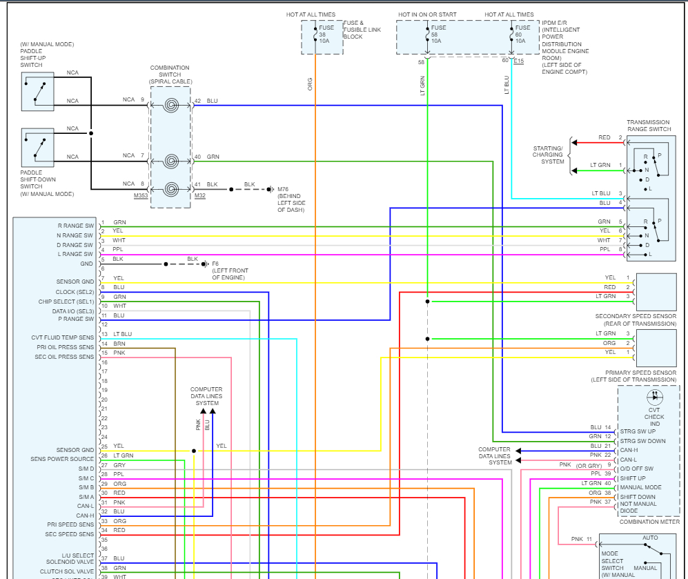

Yep, first check all fuses to make sure the modules have power, here is a guide to help and I have included the TCM wiring diagrams below. The TCM gets it power from fuse # 38 form the under-hood fuse panel. I do see more power for the TCM is from the IPDM which can go out causing the other communication errors as well FYI.
and
Oct 2, 2023 at 11:34 AM
MALLYBOY
  • 329 POSTS
I have checked for power at TCM and there's power I.e. I used test lamp to check for Battery Voltage and it illuminates brightly, I check ignition voltage with ignition on and the test lamp illuminates.

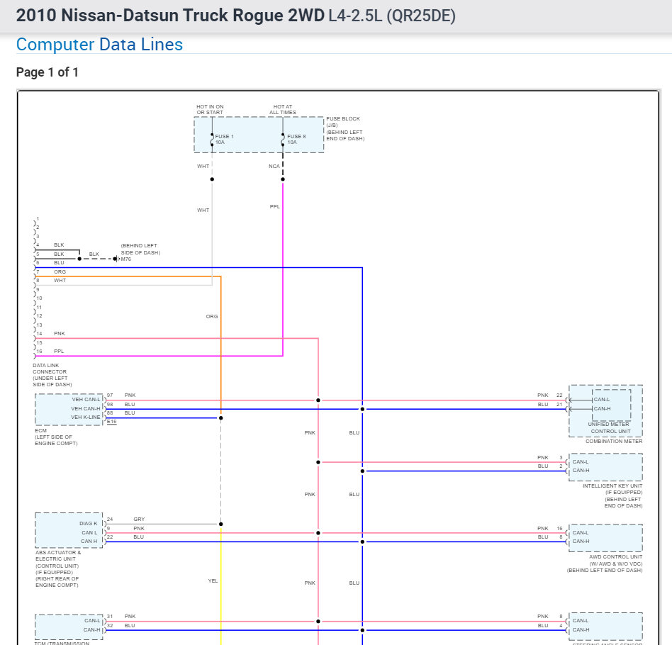

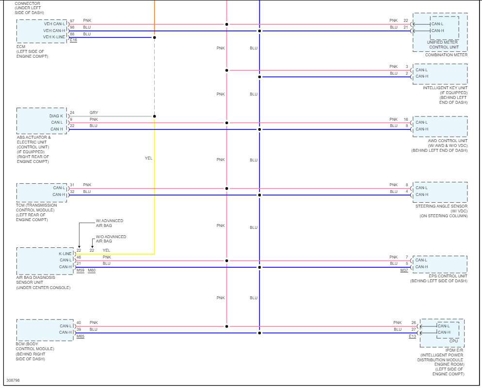

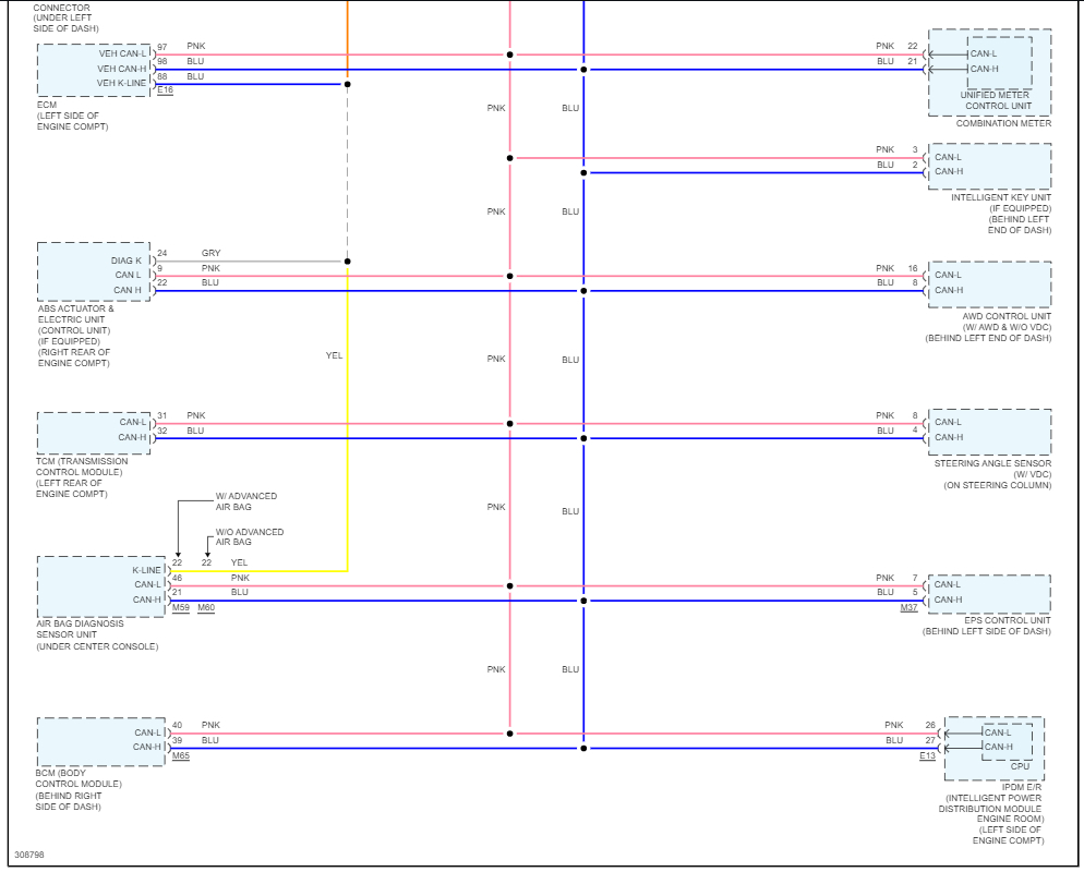

So, I also need the Communication Diagram to trace the communication between ECM and TCM.
Thanks
Oct 3, 2023 at 12:15 AM
  • 54,840 POSTS
Sure, here are the data communication lines between the ECM and TCM.
Oct 3, 2023 at 11:06 AM
MALLYBOY
  • 329 POSTS
I replaced TCM and the problem solved.
