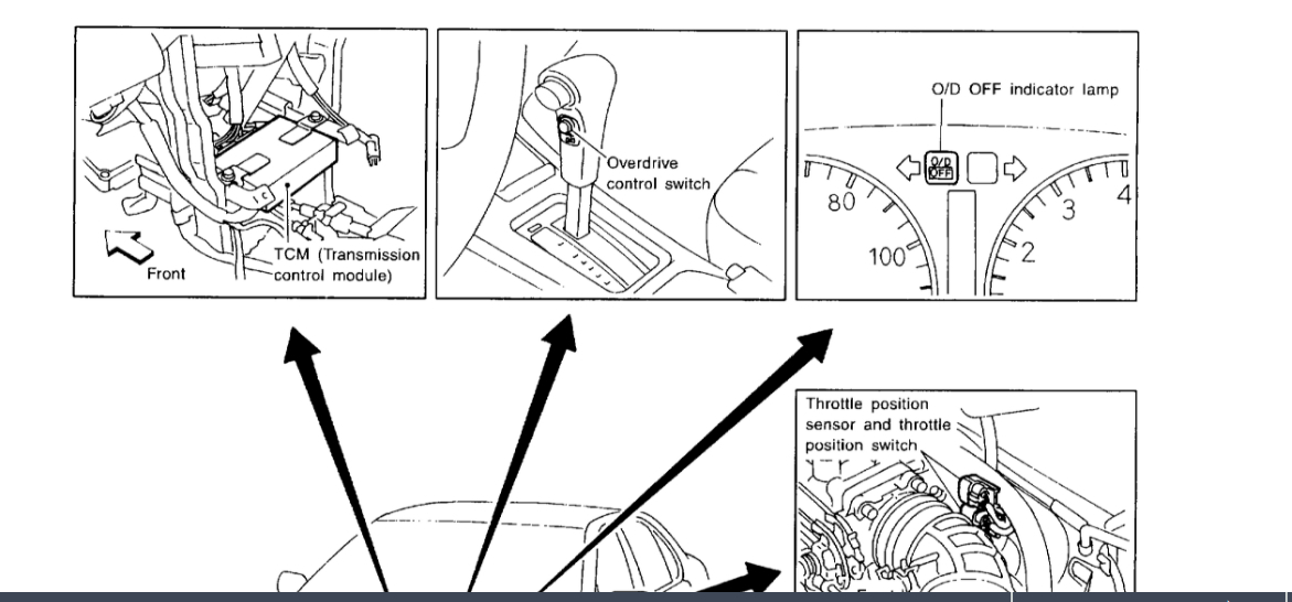

I just need to know where the transmission relay is and if it easy to change?
Mar 10, 2018 at 12:55 PM
good evening.
the control relay is part of the transmission control module. you cannot service it separately.
Picture attached.
Mar 10, 2018 at 3:15 PM
TFISHER14
Okay, I have a new question then. My car will not go into first gear. When you shift it into first gear it just will not move. If you put it into second or D it will drive but its like it is in limp mode. I got a p0731 code on my code reader.if you unplug what i think is the transmission resistor it will move in first gear but still seems to be in limp mode. When you first start the car the overdrive light flashes a few times. any ideas?
Mar 10, 2018 at 3:38 PM
