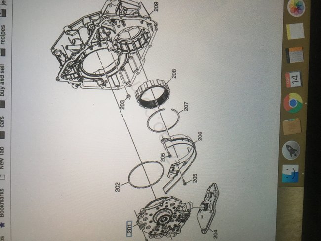

When I jack either front wheel off the ground and spin it by hand in neutral I can hear a rattling noise. This noise is heard when accelerating from a stop to about 30 mph. It is getting worse in the last month or so. I changed the transmission fluid this morning and it was black. I ran a magnet in the oil and discovered some metal filings.
Other than the rattle it seems to shift fine.
Just want to know if the transmission is on its way out or is this a simple fix?

This is an AWD So it has a FWD tranny with a small gearbox at the rear wheels.
Its definitely not the cv shafts. I’m familiar with that sound from previous cars.
I found a tranny breakdown diagram 0n 7zap.com and found a part in the tranny that could be the culprit. Number 206 in the diagram. It’s called a baffle, part number 24246165.
Number 204 is the tranny filter. No access to it.
Anyhow, I will jack up both wheel and put it in drive this evening and get some audio with a stethoscope on the tranny.
May 13, 2019 at 9:29 PM
Okay. If it is FWD then yes. Something most likely inside the differential is what I would suspect. Thanks
