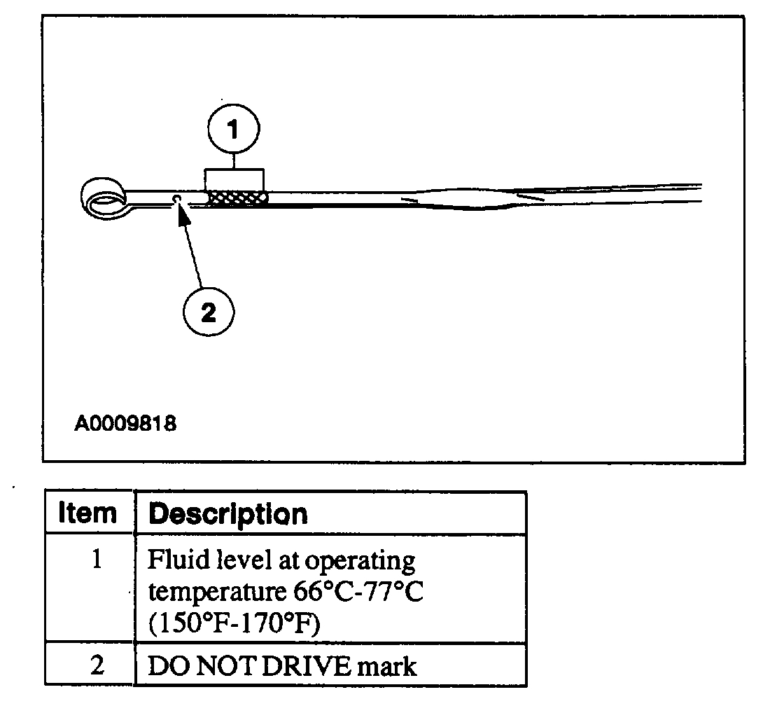

No issues before this. I went through a stop sign and then it sounds like it's in neutral; no gears will catch.
Please help me.

The first thing you need to check is the transmission fluid. Make sure it is clean and full. Here are the directions to checking it. Pic 1 correlates with the directions.

pic 1
4. Install the fluid level indicator back in the fluid filler tube until it is fully seated, then remove the indicator. The fluid level should be within the normal operating range.

If the fluid is full and clean, we will need to try flushing the cooler. It could be plugged and causing low pressure.
