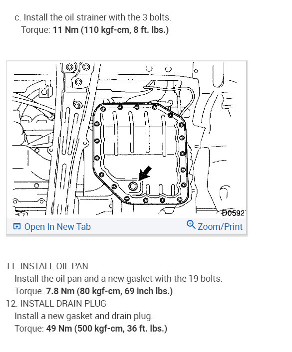

When the car has been sitting for more than three hours or more and the motor is cool, when I shift to drive the car does not move but very slowly if I have high RPMs. Reverse it immediately is fine. Once it changes to 3rd gear after slowly reach that gear. it jolts a little and then 5 minutes later it drives like a charm. no problem. I can stop for an hour and then drive with no issue. I checked the transmission fluid it was low. So, I put some via the dip stick hole. Not sure if that was the place to put it. I was told by a friend to do it that way. Anyways fluid dip stick seems fine, but the problem still persists. I checked the dip stick when hot and it was in normal hot range. But it was very low before. The problem is only when the motor is cold. Once it changes gear to third and runs a little, there is no problem at all. Drives perfect with all gears.

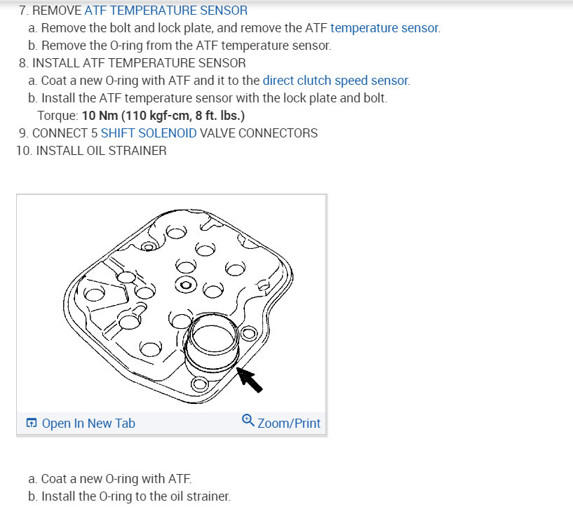

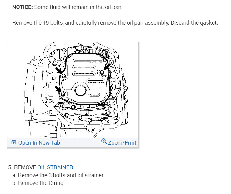

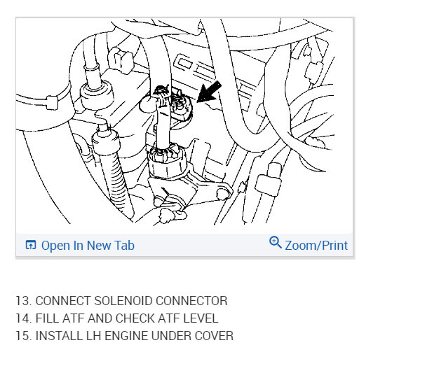

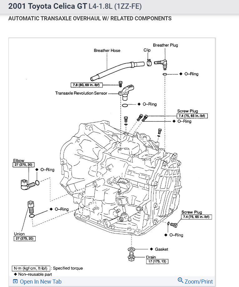

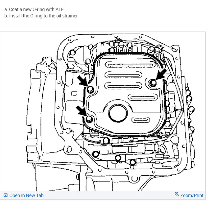

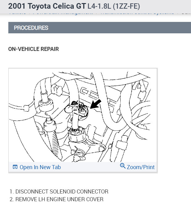

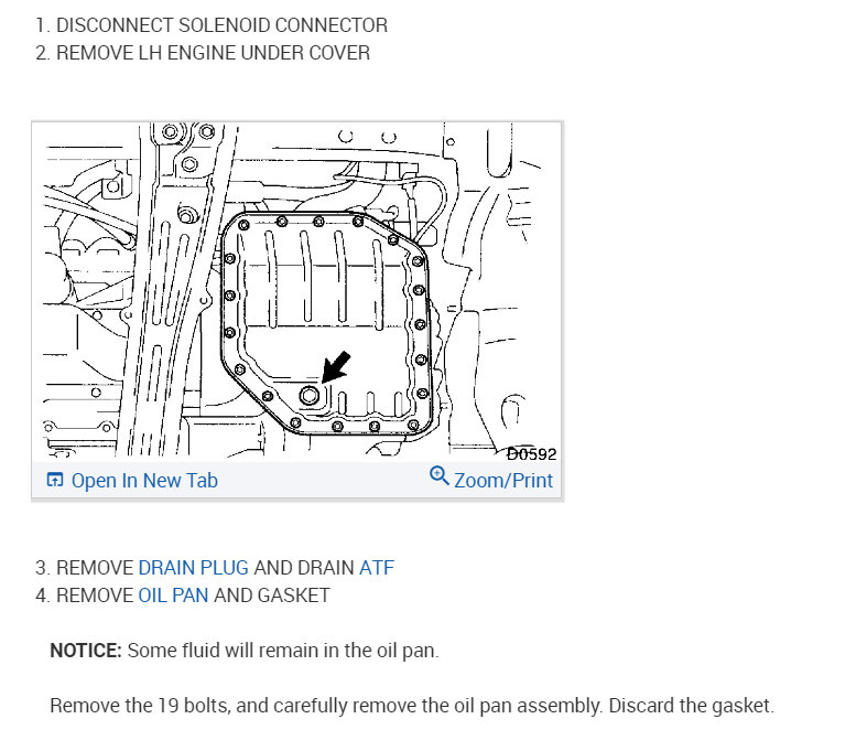

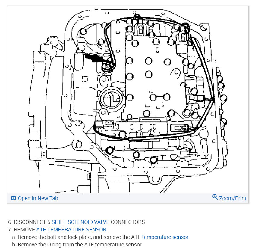

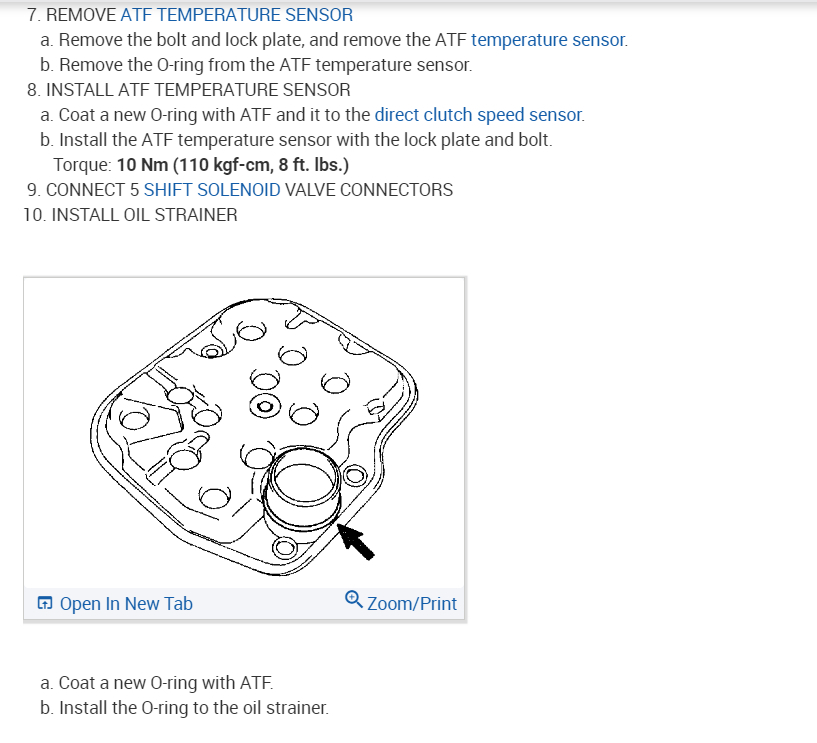

The dip stick is where you add fluid yes, it sounds like the transmission temperature sensor is not working correctly but before we replace it, we should scan the car for codes. here is a guide to help:
Also, I have included the how to change the temperature sensor out and i would change the filter and fluid as well. This guide can help walk you through the steps with instructions for your car in the images below as well.
Fluid Types
ATF TYPE: .................... Type T-IV
Capacities
CAPACITY: U341 Transmission
Dry Fill: .................... 6.9 liters (7.3 US qts.)
Drain and Fill: .................... 2.9 liters (3.1 US qts.)
It could be the revolution sensor as well; the scan should have a code for it if that is the problem. Check out the images (below). Please let us know what you find. We are interested to see what it is.
