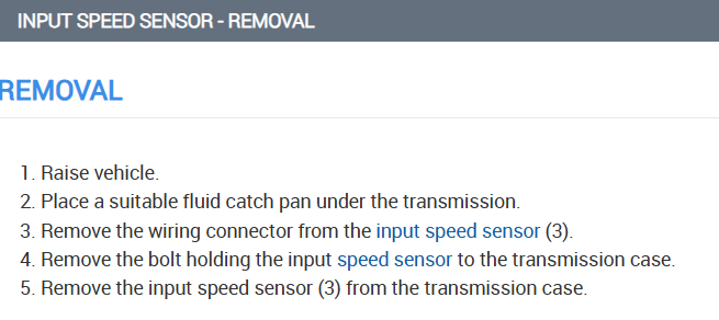

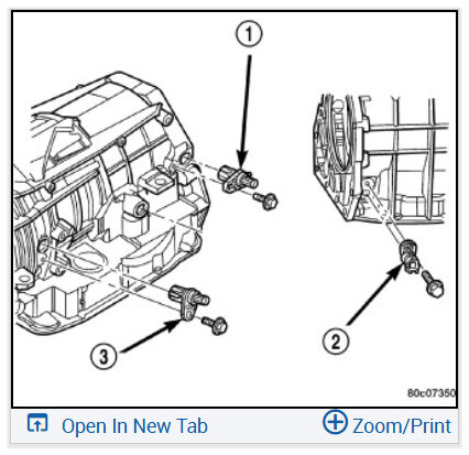

It might have broken something inside the transmission, or the input shaft sensor needs to be replaced, we should run the codes to see what numbers are present, here is a guide to help:
Here is the location of the input shaft sensor so you can check it out. Check out the images (below). Please let us know what happens.
