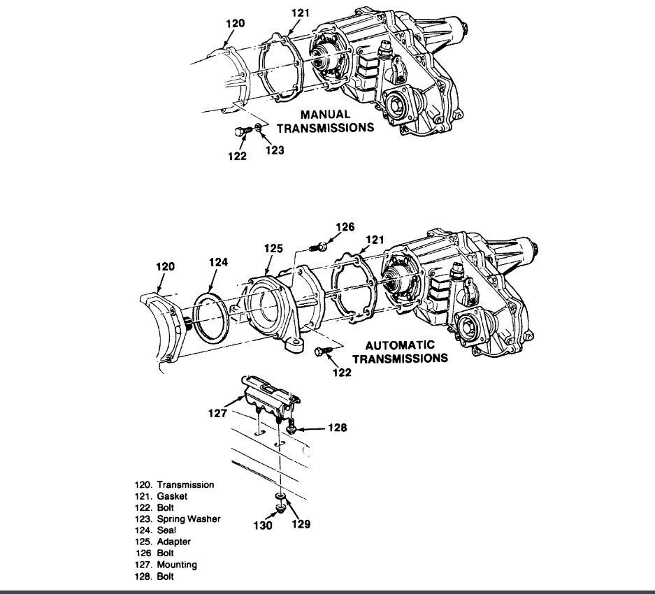

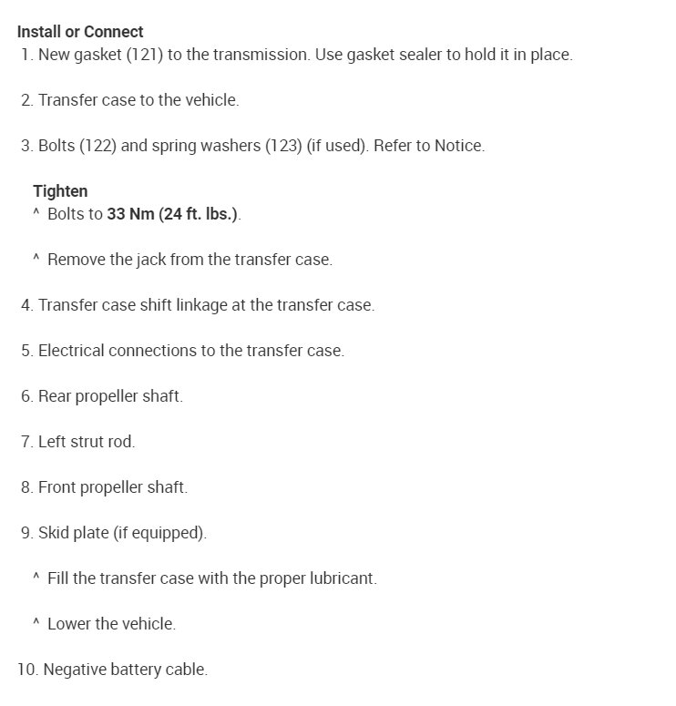

I have the truck listed above k2500 4x4 with the 350 and standard cab. I think I know the issue but hopefully someone can confirm before I spend money. Recently replaced the input and output shaft seals and transmission adapter gasket on my transfer case to fix some leaks. Also, I replaced the transmission filter and pan gasket. Since then, I can't seem to get fluid to stay in my transmission. 3rd and 4th gear slip horribly now but no issues in 1st or 2nd. I'm pretty sure I need to have it rebuilt. I added the 5 quarts back the book said but after driving and checking it the fluid didn't show on the dip stick. I added another half quart and it was still low. So, I topped it off, but 3rd and 4th gear still slip. There is no sign of an external leak so I believe it may be leaking through the input shaft seal but I'm not sure. Is there anywhere else it could be going? Is there anything else I should be checking before having the transmission rebuilt? I will say prior to changing those seals it shifted fine until it got low from the leaks. The first week after changing those seals it had no issues either. The problems shifting started in the last 2 days along with the low fluid issue. The transmission is an MD8 with 16 bolt pan. Thanks in advance for any advice!

Is the leak coming from the front? If so, you have a front pump seal that is leaking, and the transmission will need to be removed but with the 3rd and 4th gear slipping I would have the unit rebuilt. here is a video that shows the steps on how to remove the transmission on a similar vehicle with instruction for your truck in the images below.

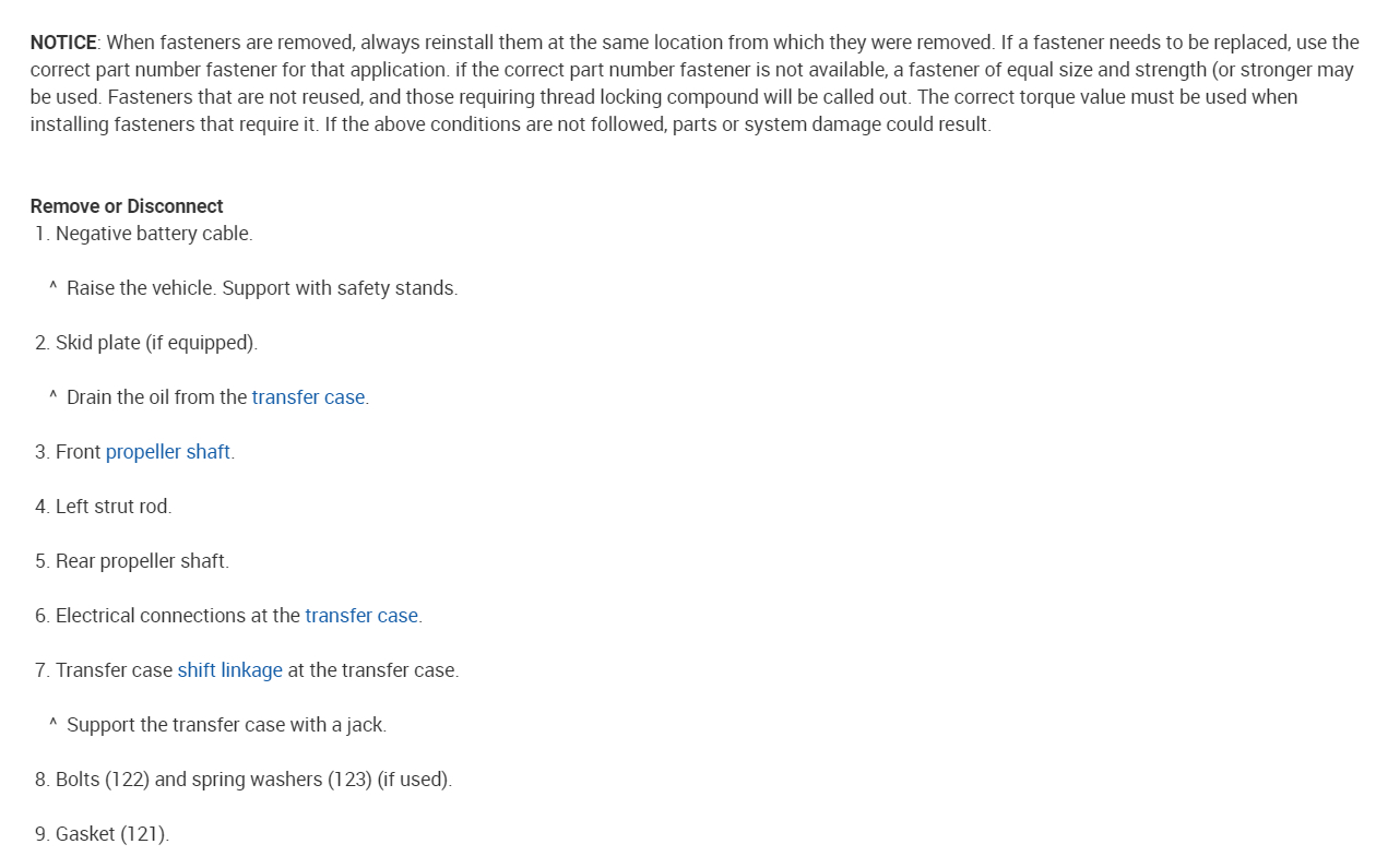

Check out the images (below). Please let us know if you need anything else to get the problem fixed.
