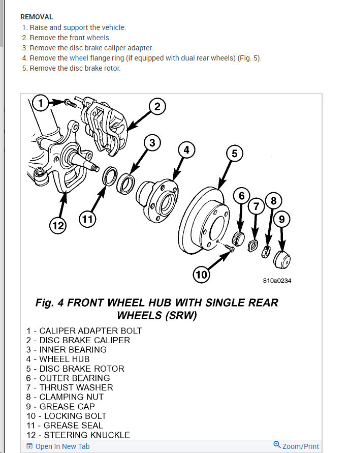

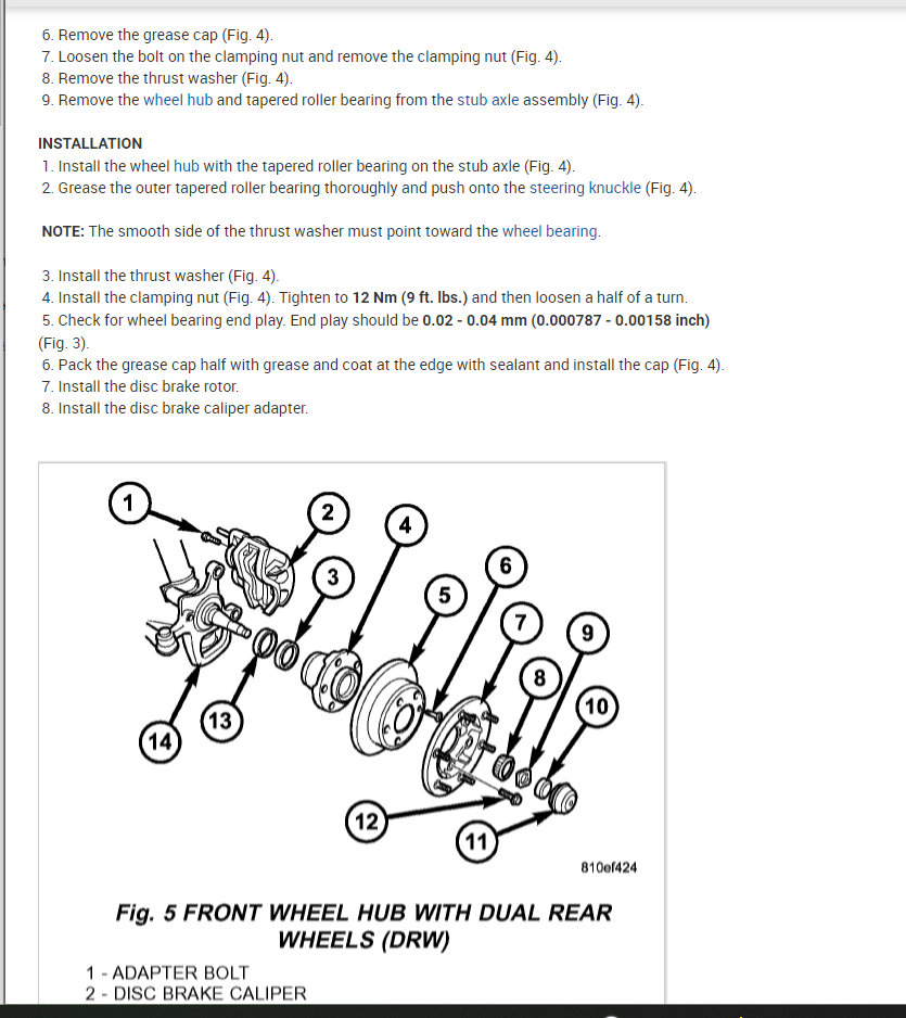

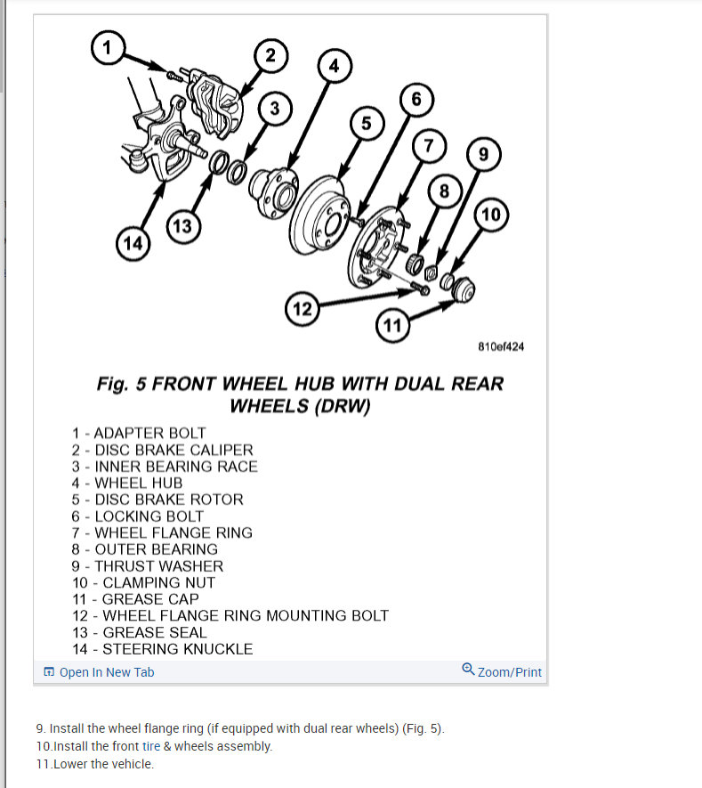

Okay. That is great info and you are correct. I am attaching a process from the manual on a similar vehicle just in case you or someone else needs it.
Please let us know if you have other questions and how you make out once you get it repaired. Thanks again for the clarification.

Just a clarification - this is a rear drive axle issue so information from this link (https://www.2carpros.com/articles/rear-axle-seal-replacement) would be handy in my case.
Jul 27, 2021 at 2:20 PM
Sorry. You said that earlier. Thanks for clarifying that for us and attaching that article.
Please let us know how this turns out. Thanks
