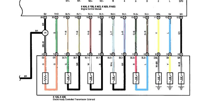

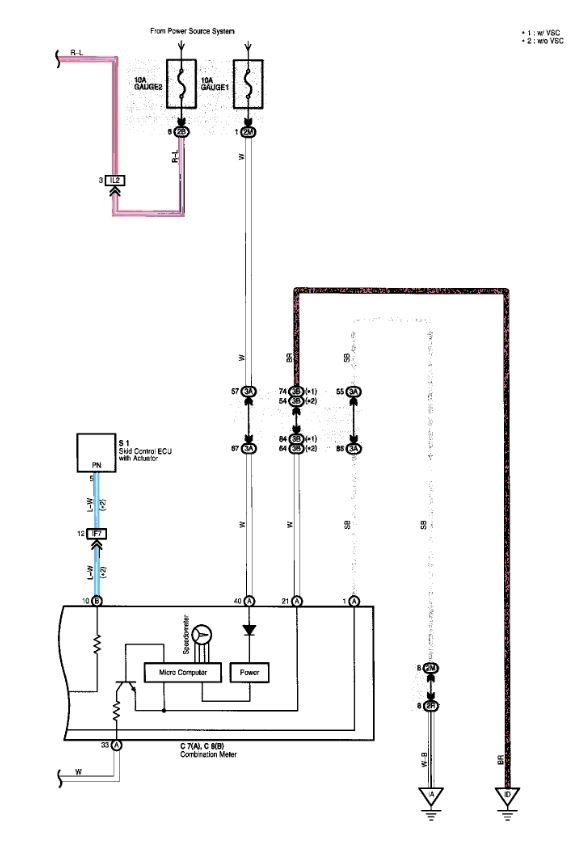

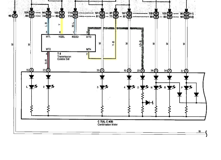

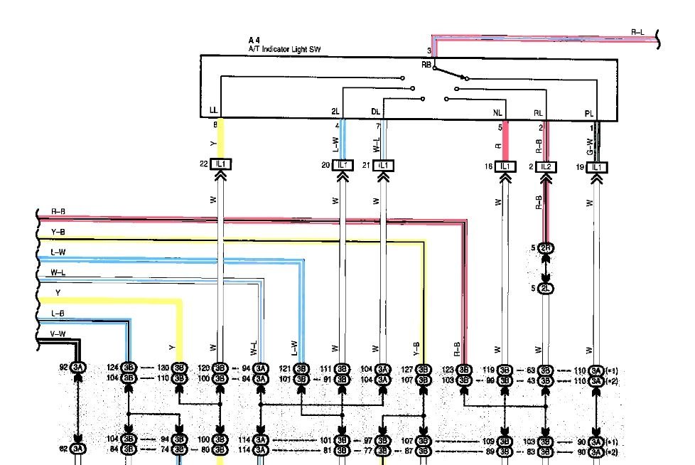

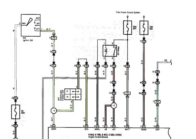

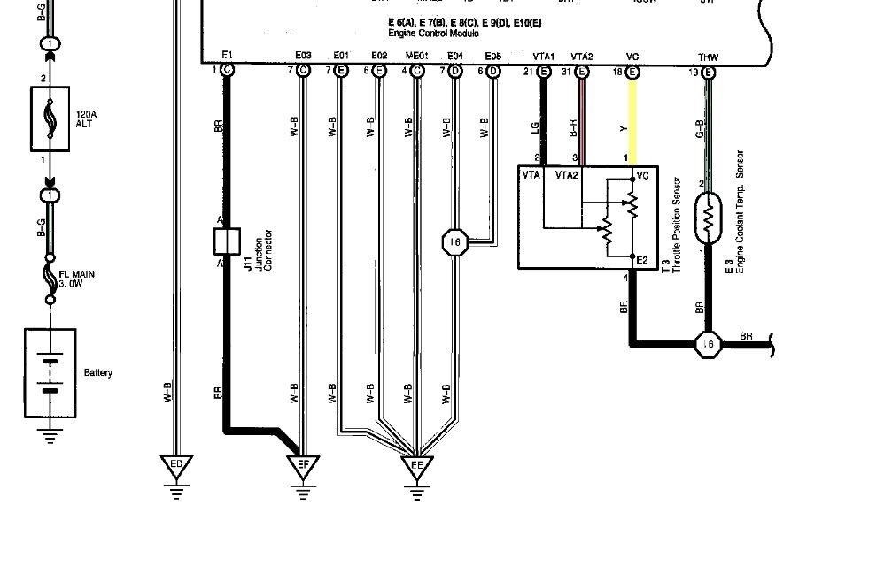

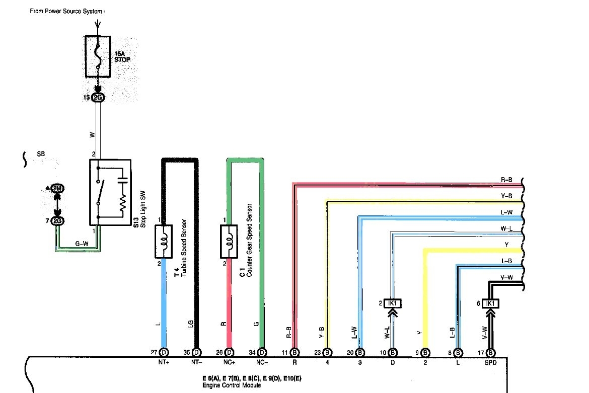

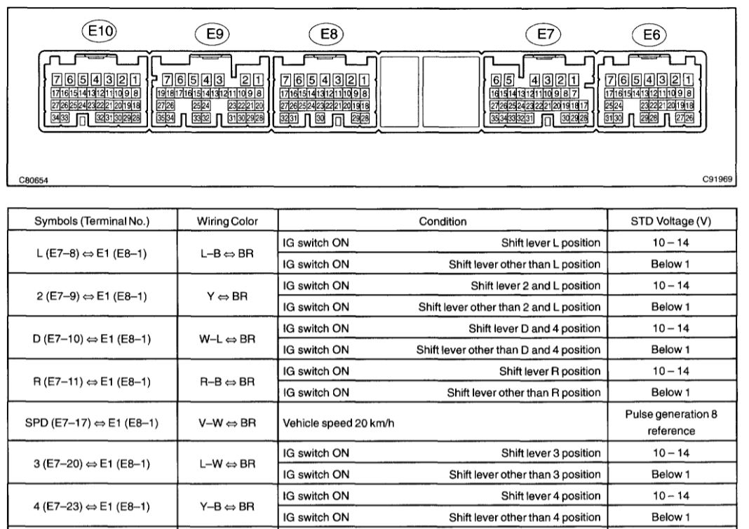

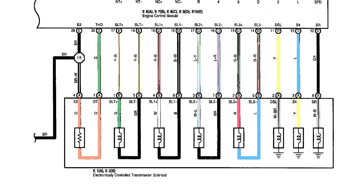

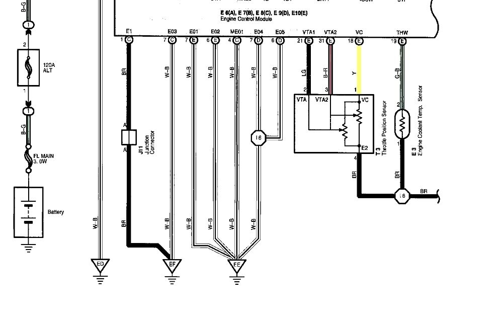

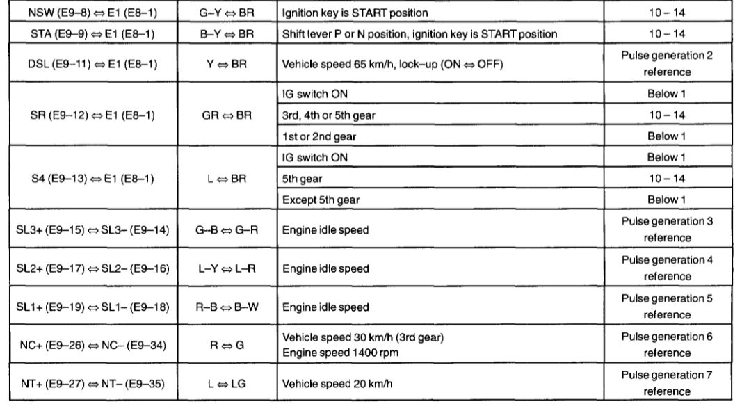

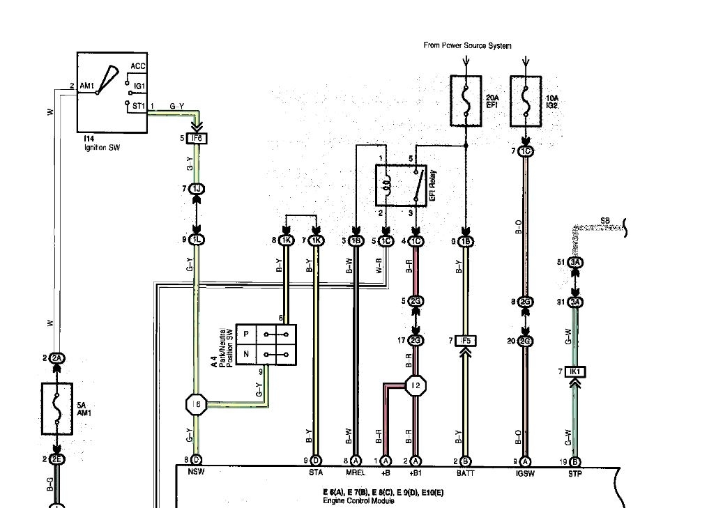

Good afternoon,
The vehicle's transmission had issues, it was replaced but during the replacement the connector of the transmission was broken which makes the pins disordered. I don't know if I can get a circuit diagram on it from the PCM to the Transmission and the PCM circuit diagram, someone has connected some wires that I understand not.
Sep 5, 2021 at 3:49 AM
STEVE W.
  • 15,200 POSTS
These are the wiring diagrams for the ECU to transmission circuits, and the pinouts at the ECU. I don't find a connector view for the transmission end but I'll keep looking and update this if I find one.
Sep 5, 2021 at 7:56 AM

Good morning, thank you very much.
Sep 5, 2021 at 6:12 PM
BLESSING EWOBOR
  • 753 POSTS
The vehicle is working fine now. thank you
