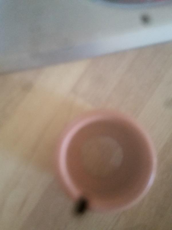

I am trying to identify this part from a TH475 trans on an 86' Chevy P30 (454). Could you please let me know what this piece is? I thought it might be an Accumulator Piston but all I find are metal one piece parts for that and this is a plastic part and it has two pieces. I have attached a photo.

CAN YOU RE-SIZE YOUR PIC A LITTLE SMALLER? IT'S NOT SHOWING AT ALL.
INSTALL IT BELOW YOUR ANSWER BOX UNDER "ADD IMAGE"

Does this work? I reattached using the jpg format.

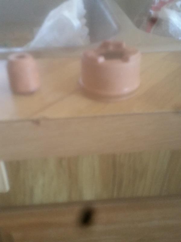

Here is the other photo as well.

DOES THIS DO ANYTHING FOR YOU?
http://www.shinseiauto.com/japanese/transtar/usgmth40004.pdf

No. I've looked at that one and a dozen others and have had no luck whatsoever. Any other ideas or clue as to what that is?

HOW 'BOUT A PLASTIC ONE OF THESE?
http://www.ebay.com/itm/ALUMINUM-Direct-Clutch-Accumulator-Piston-Fits-400-475-3L80-Transmissions-/111620619550?hash=item19fd1b7d1e&vxp=mtr

Yeah I have seen those all over the place but what about the 2nd piece that this part has in it? Is that included with this accumulator piston or is that smaller piece something else that I need which fits into the piston?

I LOOKED AT THE THREE VIEWS BELOW THE BIG PIC IN MY LINK
YOUR "BIGGER PART" LOOKS TO BE HOLLOW INSIDE, DOES THE LITTLE PART GO INSIDE OF IT, SO THAT IT LOOKS LIKE "VIEW 2" IN THE LINK?

I think that is the right part. Thanks!
