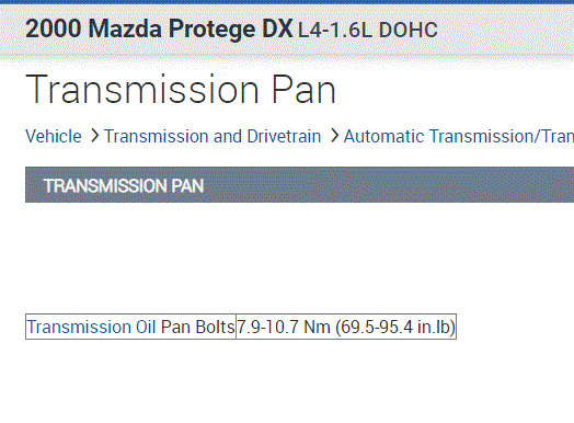

What you described as far as checking fluid level should work fine. The only suggestion I have is this. Fill it to the cold level. Start the engine and run through the gears. Turn the engine off and check to make sure it isn't low before driving.
I attached the torque specifications below. Let me know if there is anything I can do to help or if you have other questions.
See pic below.

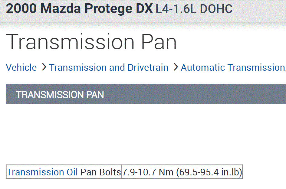

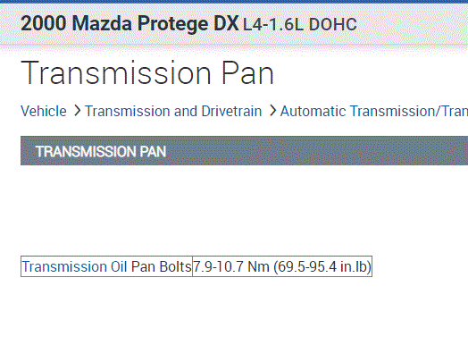

That sounds like it would be fine. I can't find the specs as far as the drain plug itself, but 10 ft/lbs should be good.
I did find the specs for the pan bolts and attached it below. It indicates the torque in inch-pounds rather than foot-pounds. Note it says 69.5 to 95.4 in/lbs. If you convert it to foot-pounds, 84 inch-pounds equals 7 foot-pounds. So, you sound like you are right on target.
Let me know if you have other questions or if there is something I can do to help.
See pic below.
